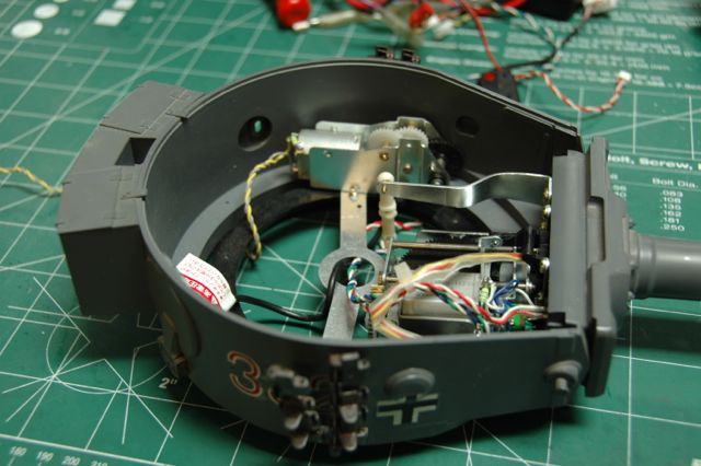

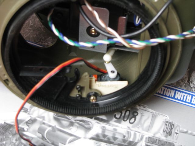

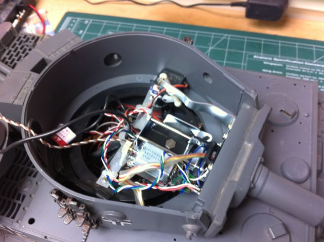

Here is another option:
http://heatarmor.com/joomla/index.ph...d=92&Itemid=29
This works if you use the ratcheted stick for gun elevation. Otherwise, every time you let go of the stick, the main gun will return to the neutral position.
If you want to use a self-centering stick for the main gun, then you just need to add Camera Position Controller. It should also take the place of the rate reducer
http://dionysusdesign.com/product_in...988d676be9f629
I used a Small Spektrum Servo (far right in photo), on a wood platform (Tiger I did not need the platform). With the Spektrum or any other programable radio you are able dial in the min and max elevation so as to not over stress the mechanism.

The good thing is there are numerous options to fit your budget/skill level/desire to try something new.
I went with the servo option because;
a) I had some spare Spektrum servos from when I purchased my Tx. Some tanks need SMALL servos. I did have to purchase the Camera Controller and Y cable.
b) Some of the turrets are very tight, and installing micro switches would be a challenge.
The Panzer IV is very tight, while the Tiger I is a piece of cake with it's removable turret lid.
If you have a programable radio, that makes it an even easier decision as you can program servo throw to fine tune the Min/Max elevation.
