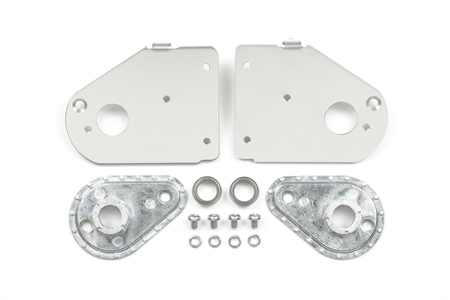

So I just bought(nothere yet)a Tammy Panther kit from a member here (Thanks Tim!!!), and as many of you already know, he graciously included many extras. What I was wondering is if the kit needs a track tensioner? I have bought several sets from DT for my KT and Tiger and I love how much better they are than stock. I will be using metal tracks for my new kitty and was wondering where I could score a track tension system or should I just stick with the factory offering? Many Thanks!

I have the Tamiya Panther G as well. The track tensioner works like the one in the Tamiya Tiger I, which I also have. For me it would be enough, but I do like the idea of having a sprung track tensioner like the design DT has created.

I've had no issues with mine! The hentec actually has some issues with keeping tension, so upgradings not always the best idea.<br type="_moz" />

Not having the kit in front of me I cannot tell, but do you guys think the DT system for the Tiger would work in the Panther?

Mine has worked fine for over 3 years with no issues. as always a DT tensioning system is always the best way to go but not a nessesity on this kit and i have Impact metal tracks which are quite heavy.

ORIGINAL: Cruiser133
Double check with Daryl but I believe he said it would, along with using the TI idler too for it's made of steel and much stronger than the stock Panther idler.

To be perfectly honest thought your money is better spent else where. The dt system isn't cheap!

ORIGINAL: tomhugill
Performance doesn't come cheap.
The Panther idler is made of cheap metal and when it breaks you'll wish you had spent the money PLUS using Daryl's system. I don't battle on a consistent basis so mine does not have them... the battlefield at Danville is the testing ground!

Looking good Jeff. Btw, DT just responded and the tiger tensioning system will work on the panther. He said a little clearance on the speaker box is needed.
Yup... that's exactly what he told me but I won't be battling mine so I didn't go for one.
