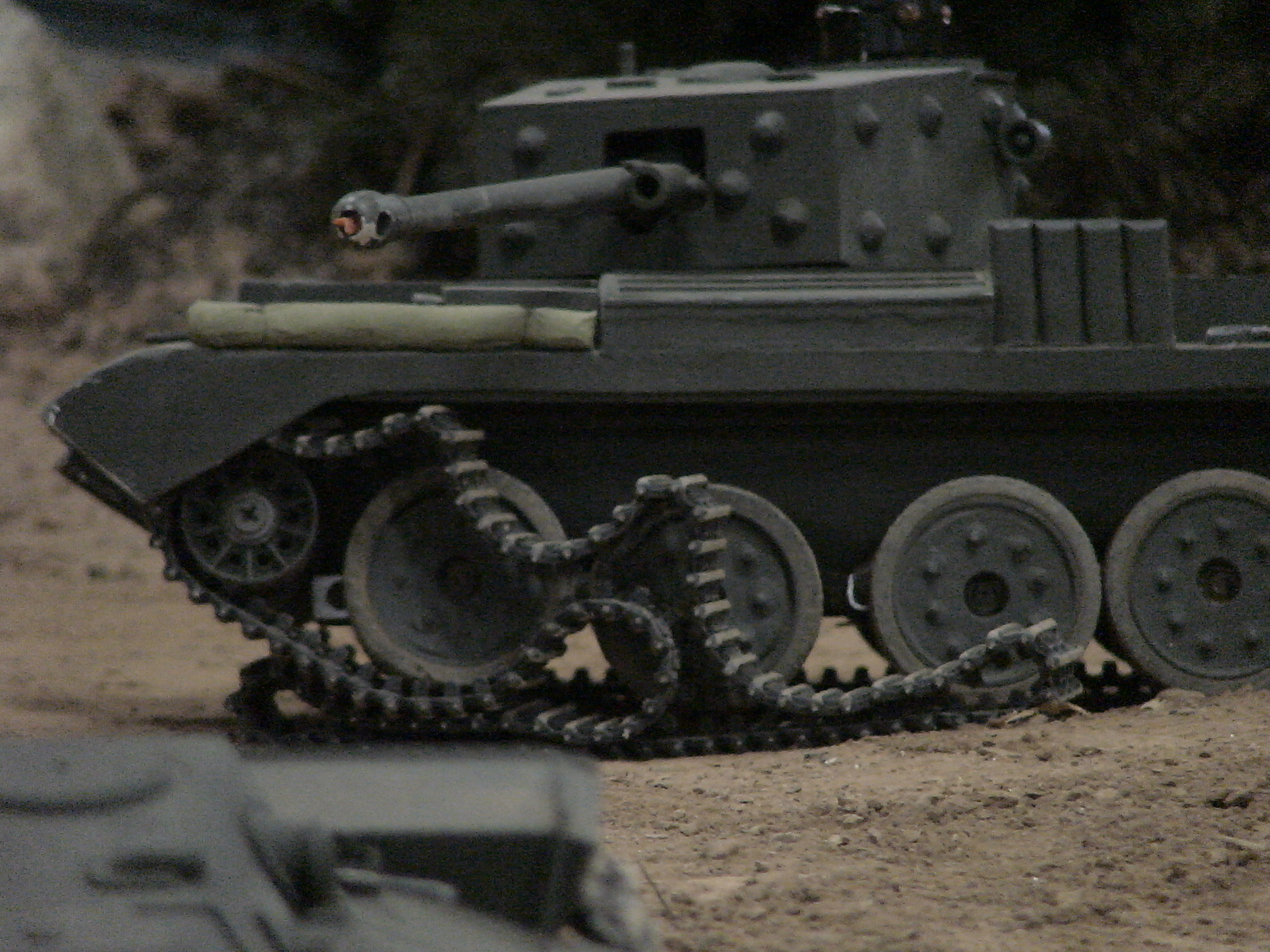

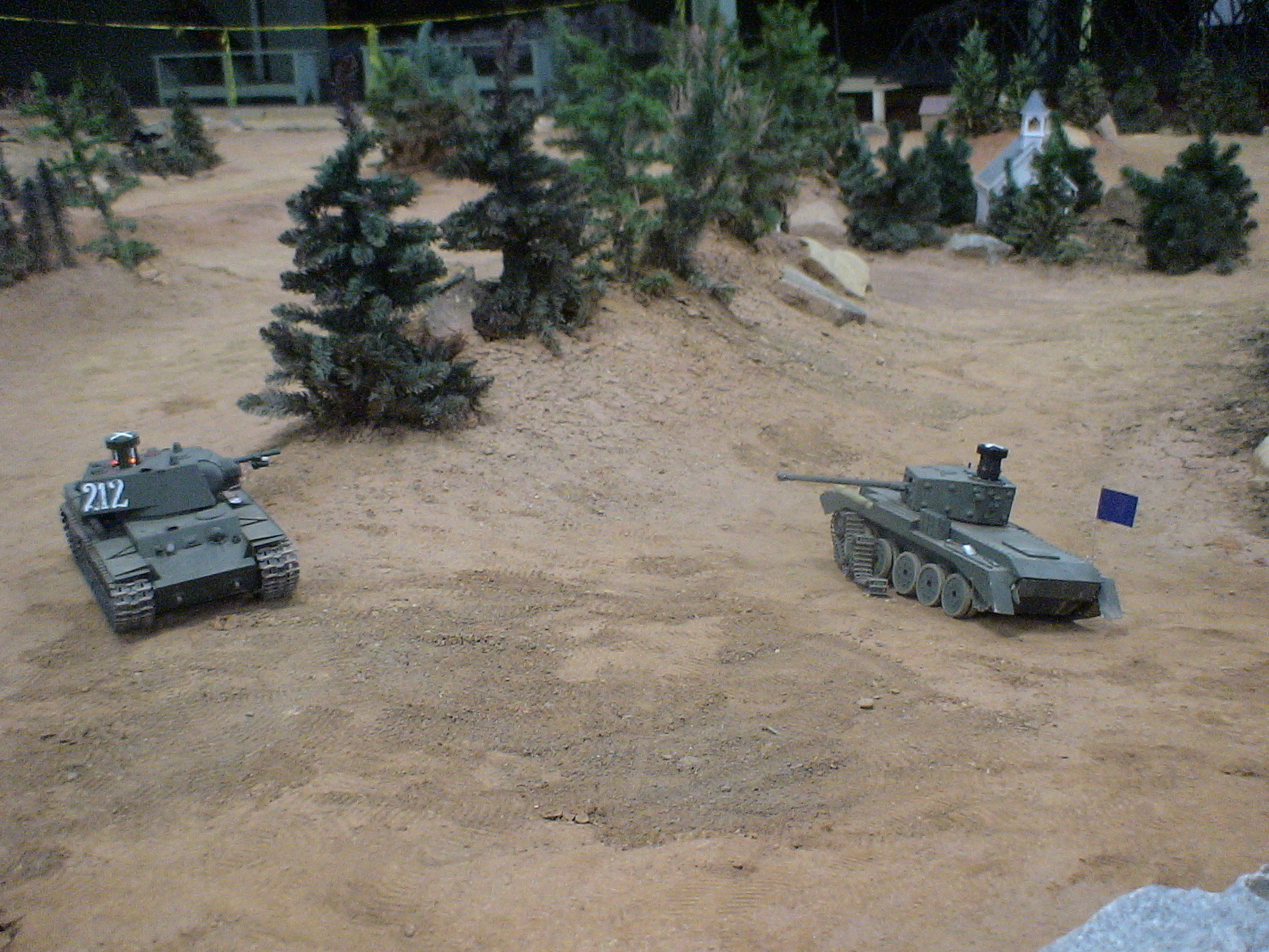

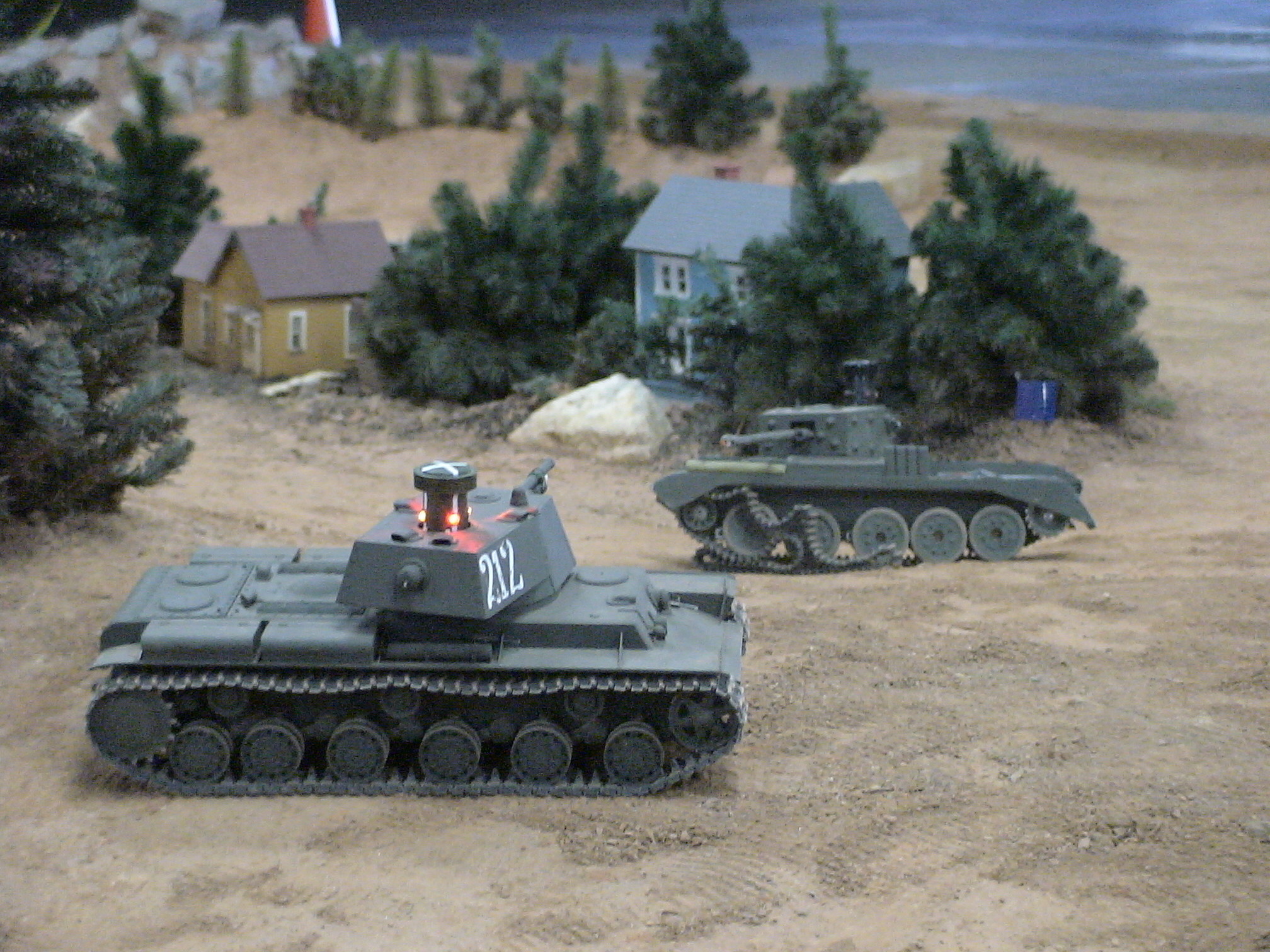

Prima....I love it. I would have some British armor if they were not so damned slow. Please keep posting pix.

That looks more like driver error!!
One of our club members is knee deep in a Cromwell build and I have to say I'm pretty jealous, it's a gorgeous and unique Rc tank. Super detailed as ALL ludwig's / chris' kits are.
One day!!
Nice to see a Comet, the turret looks great.

moin
Thank you :-)
The Cromwell slow? it was one of the fastest tanks in wwII.
But this is a lidel problem to relice in the Kit. The Kit is made for the 3:1 flat gearboxes from asiatam, these gears are strong but with the motor a lidel bit slow.
If you put in a standart gerbox you need to modivi it a bit.
cu christian
