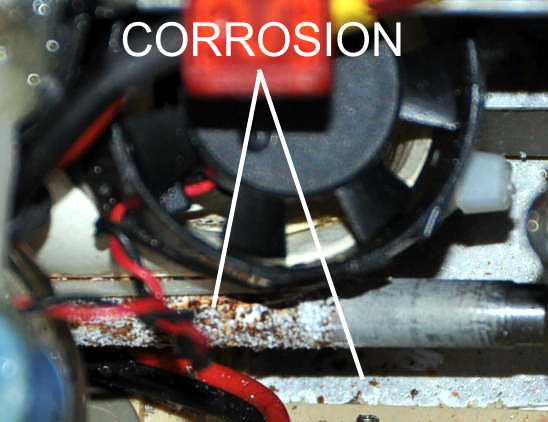

Attached is a picture of the rear axle area of my Tamiya KT. The smoker is a mini-design I made. It has a very small amount of "fog" backflow. The tank doesn't have many hours (maybe 20) of run time. You can see the effect on the axle (steel) and on the body pan. Even aluminum stiffening struts have a cloudy surface film. I've made and run a lot of smokers and have tested a lot of fluids, etc. Internal damage - or at least a mess - will eventually occur even with limited internal "smoke" release.

When the vapor gets trapped inside a model, it will condense. Same effect as spraying sugar water over everything. The result is mold, corrosion and a general mess. That's why smokers are built tight - hopefully with no leaks, and with discharge outside the model only thru the tubes.

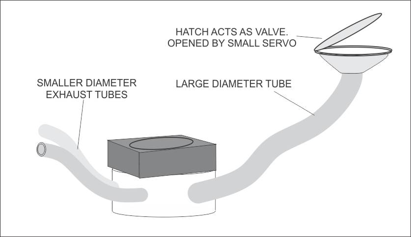

Thanks for all of the good information. Would your system have enough power to blow open a hatch and exhaust the smoke upward? I have on order several Supersmoker IIs.
I have no connection with the improved SS2. I don't think the fan should be used to blow open the hatch. The airflow thru the smoker and tubing is likely way too low to do that. BUT, if a tube is run from the smoker to the hatch, the hatch itself could be the valve mechanism. Hatch closed - all smoke goes out exhaust tubes. Hatch open - smoke blows out hatch thru larger tube from the smoker. A simple small servo could open the hatch. Having a second higher wattage resistor/wick evaporator kick in would help produce more smoke. See sketch...
