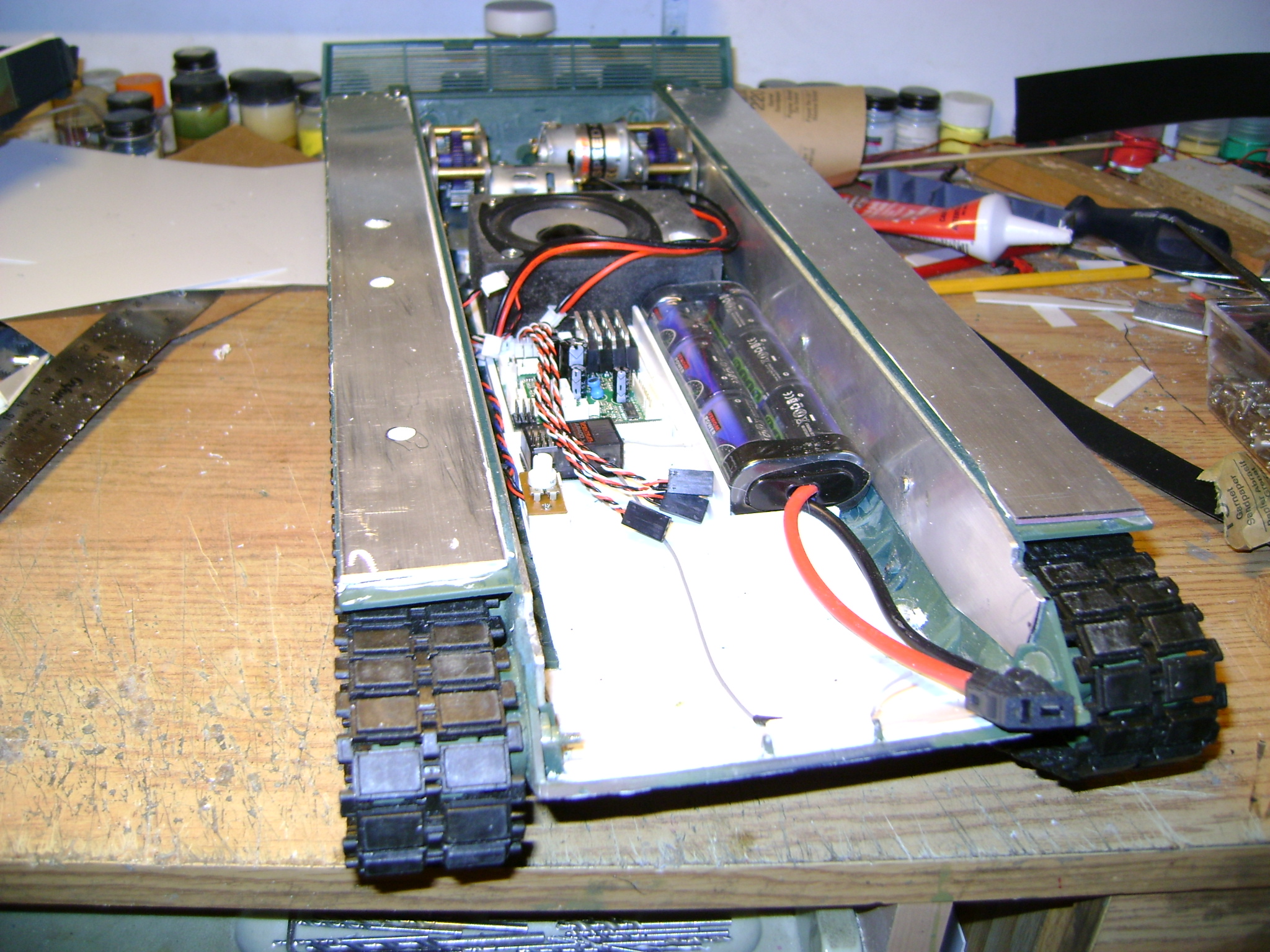

Any of you guys changed out your return rollers for the metal ones? How did the plastic ones come off and the new metal go on ?? They look like press fit but not sure... Thanks in advance !

They are press fit and they are a bit tight. Putting the plastic rollers back on the pins was easyer for the mod I was doing

Yea, I found out..lol I probably shouldve kept the plastic rollers, the metal ones had to be tapped on with a hammer. Not sure if I will be able to remove them again unless I cut the pin head off inside the hull.

I kept the plastic return rollers on mine. I used the metal ones on my old HE Leopard. I drilled them out and ran an threaded axle through them that had the head countersunk into the wheel.
