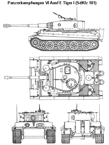

I want to convert a tamiya tiger into a late version. what would I need to make it an official "late" version tiger? I've found these, the cupola. Would the Taigan wheels fit onto the tamiya suspension pieces? http://etoarmour.com/product_detail....oductID=T10016

There's quite a bit more than just wheels and copula. Headlight needs to be relocated. Armor turret ring guard needs to be added. You should really do some research on the Tiger versions if you are that set on an "official' late Tiger. And no the Taigen wheels do not fit Tamiya axles.

There is rather a lot more to it than that also Panther, which theatre do you wish to depict which branch as in Waffen SS or Heer, there really isn’t such a thing as an “official late” version as these tanks changed month on month, what I’m really asking is do you want to depict a replica or just slap something together as cheap as possible

I would like to make a later tiger like what the tigers near the end of production looked like. Like this picture

Mmm I see this is not a good depiction of a June 44 Tiger, it’s an early model Tiger with steel wheels and the later commanders cupola, another words this is an appalling rendition, did it come from a Polish book.

A good resource on the conversion would be Jentz' book. He gives a timeline with changes and how they overlap.
Just off the top of my head: the turret roof vents, sights and armor, close proximity weapon, S mines, track hangers, cupola and loaders hatch, anti aircraft MG. Then there are minor barrel and muzzle brake.
Rivetcounter has the best advice, decide what era or even better, an actual tank via photo and go from there. Tigers were constantly evolving depending of development, need and material shortcomings.
