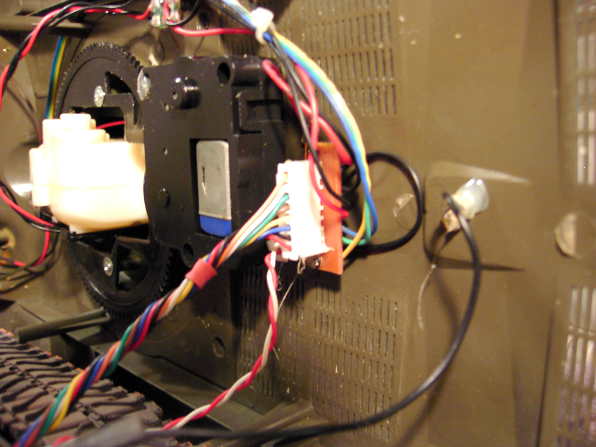

I pulled out all of the wires in the turret of my heng long panther G when I was trying to replace the gun. I need help knowing where they go. Do anyone of you have a detailed wiring diagram or are able to provide detailed instructions.

i don't have my Panther anymore this is my Pershing hope it can help

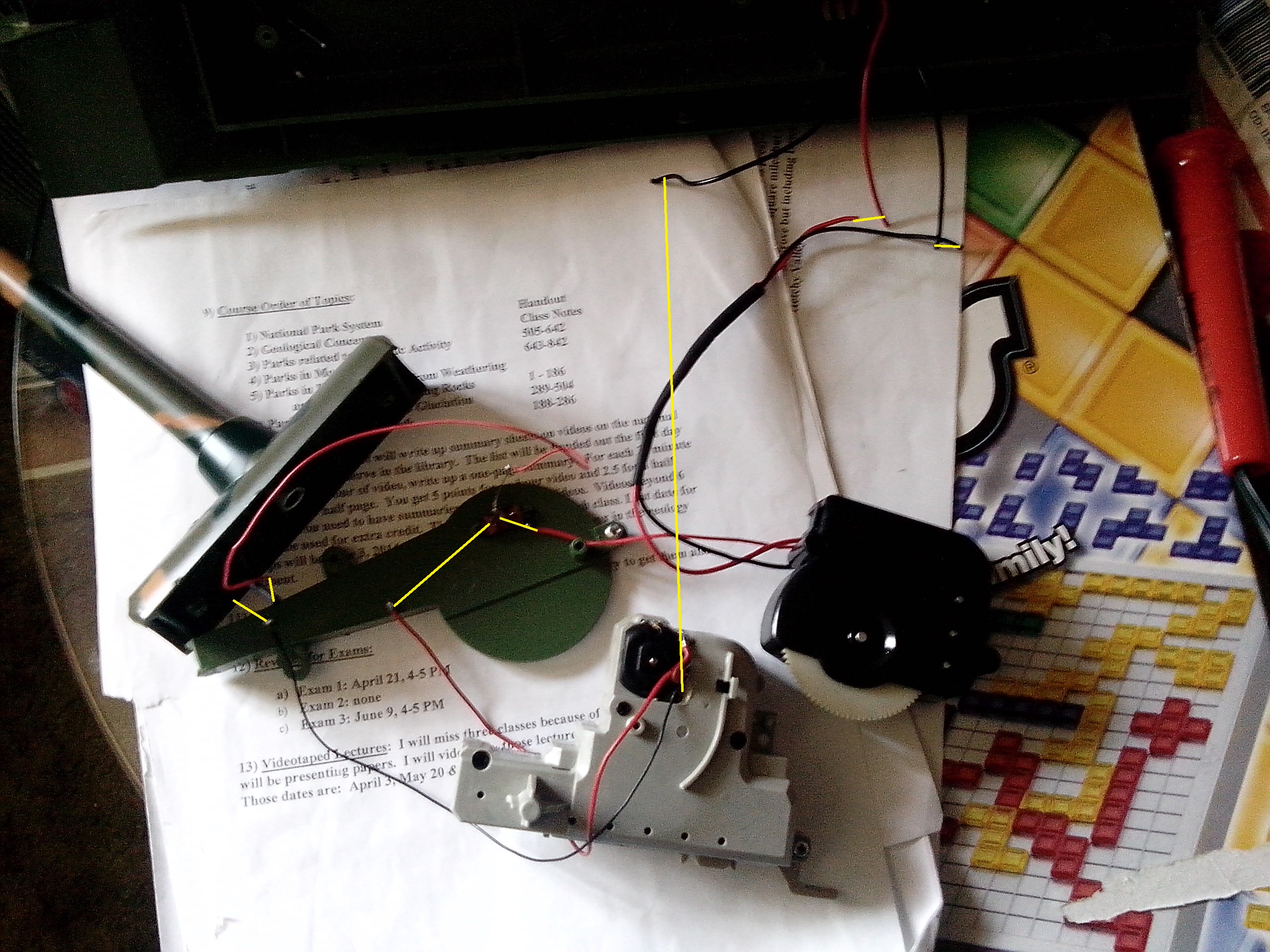

This is were I think the wires go is this right?

I think I understand. The 3 wires come up into the turret 2 blacks and red. one black goes to the gun and other black and red go to the elevation motor. Than another red wire goes to the red wire on the elevation motor and then it connects to the turret gun power switch and another red wire that is connected to the switch goes to the gun. From where the black wire that is connected to the gun their is another black wire that connects to the tanks LED. Their is a small red wire that comes from the LED and connects to a small capacitor that connect to the turret gun switch. Is this set up right. I circled the capacitor in red
