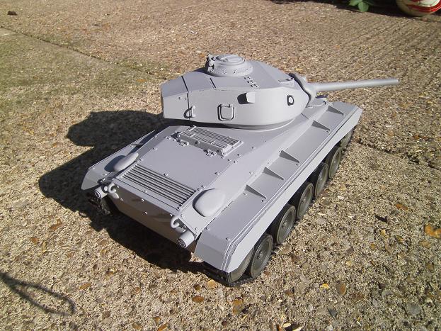

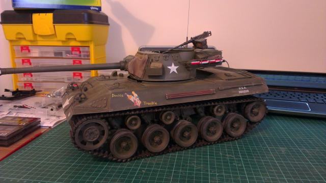

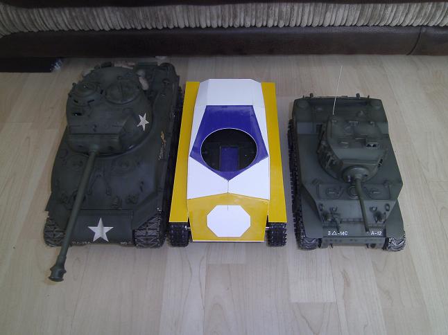

...made a start on my latest build. Basic hull work is done.....

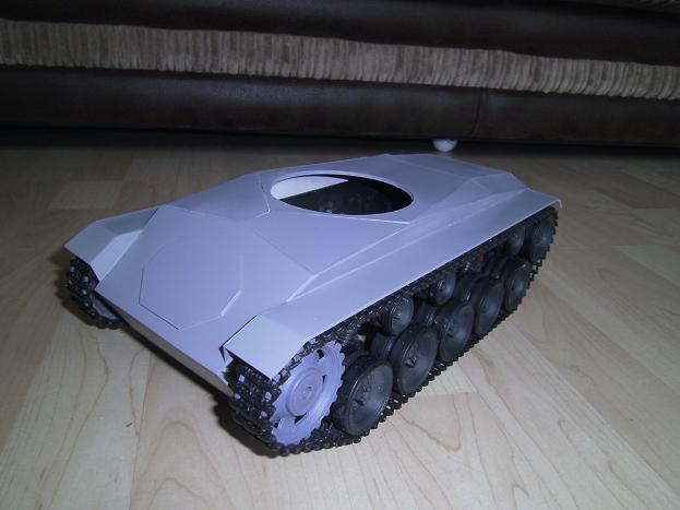

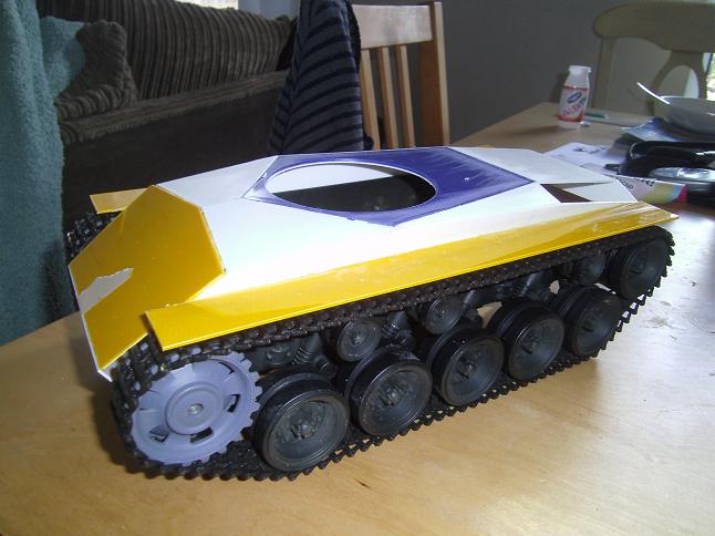

not too much to say...
.....shortened, narrowed HL chassis..(the Pzr3 wheel will be disguised later)
plasticard upper hull...
Started on the turret tonight.....
BTW...here's a Hellcat I did a while ago.....

Hi Fynsdad
Nice. Is that an M26 hull you've used as the basis - wheel spacing suggests that, rather than the M41?
Mal
Old 05-26-2014, 01:53 PM
fynsdad
Join Date: Mar 2008
Location: kettering, UNITED KINGDOM
Posts: 995
Received 8 Likes on 4 Posts
Originally Posted by afv aficionado
Hi Fynsdad
Mal
Yes it is. The M26's wheels are closer together allowing the chassis to be shorter than it would be with the M41 one

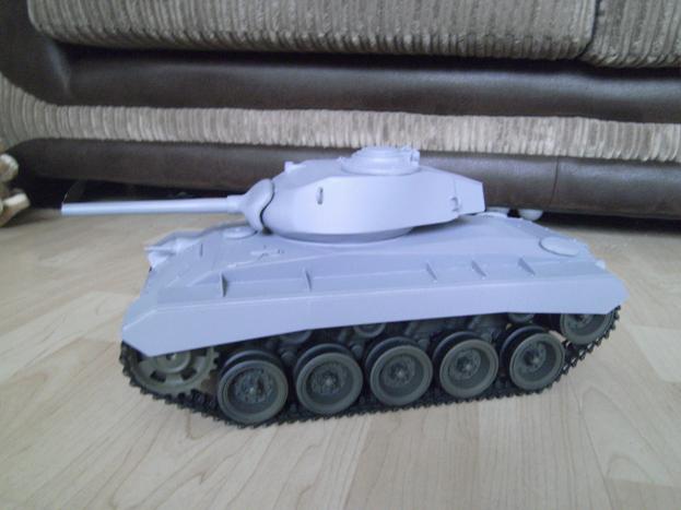

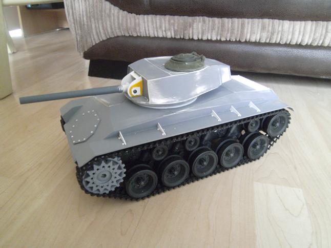

...fair bit done on the turret.....

Sorry Jim,due to the lack of response I didn't think anyone was interested.....
Here's a couple of pics in primer,
ID:	2008299   Click image for larger version

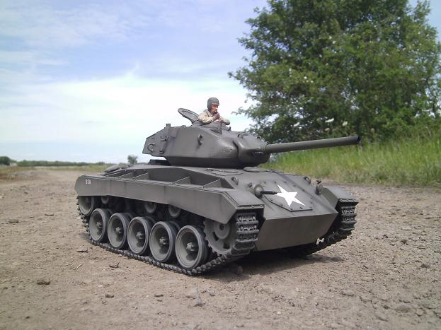

...and finished...

There's not too many more pics I'm afraid. This was a strange build, I didn't really enjoy it as I took a lot of stick from a couple of guys on another forum because, for reliability, I used a Pzr3 sprocket, and how I should have scratchbuilt one, even though I don't think these "experts" have done much more than sprayed a couple of Heng longs so it was just a case of get it finished and sell it on, (to someone who's very happy with it).
...as to the turret it's just plasticard with a lot of filler/sanding to the cast "nose".......

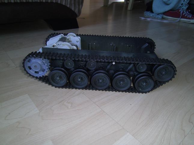

Well I think it looks great. Would also like to know the cuts you made to the M-26 Chassis??
Jim
Old 06-25-2014, 05:25 AM
fynsdad
Join Date: Mar 2008
Posts: 995
That I can show... basically took the last roadwheel off, and a strip down the middle to get her narrower and shorter. Gearboxes on a plate which is then fixed into position...

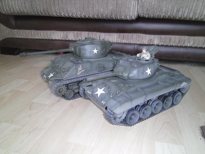

...and a pic to show the size difference between her and a Sherman...

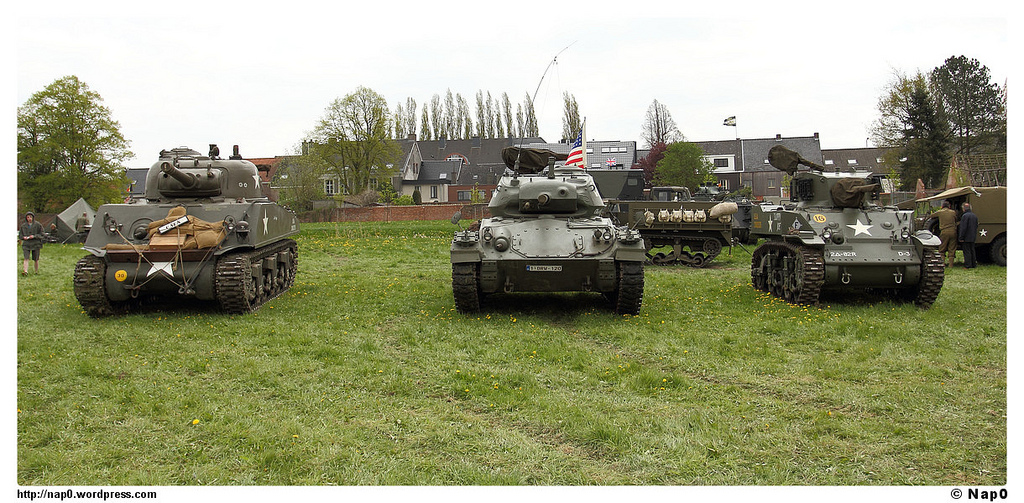

its a great work nicely done , three years ago i saw a real chaffee next to a sherman ... it looks as if yours is a little to big ... but still its beautiful scratch work
what i remembered of the chaffee he was even tiny against a sherman (105mm) honestly i was disappointed then of it ... can it be a bit to width or is that optical disillusion ?
this year he will be back on Wings and wheels in 23-24 august i bet ... but still my favourite although a hellcat is the max ...

on the pics not realy see it like should
http://nap0.wordpress.com/2013/05/04...2013-in-ename/
i was there too
