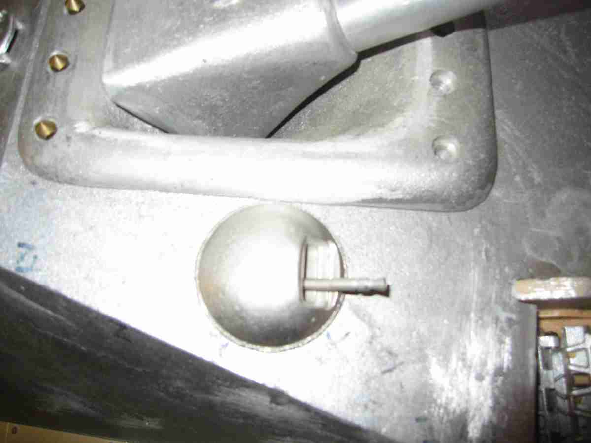

No matter how many times I do operations like this I still get nervous. One of the concerns is how to mount the large casting securely
with just enough force without distorting it. Cutting a large hole like this with a boring head is a somewhat rigorous operation that
has the potential to do violence to a casting such as this.
  • cutting the hole
  • setting the alignment key
  • the mg mount trial fit
The ball mg mount is from das Geisswerk in Germany. I plan to nickel plate the larger surface of the assembly although it isn't really necessary.
Jerry

Just in case anyone want to see how a boring head works here's a short video.
https://www.youtube.com/watch?v=fCX-wuAIFvE&feature=youtu.be Jerry

I decided to throw on a thin nickel plate to the mg mount to allow the base color to blend in with the aluminum better. It will all be painted but with the inevitable
paint chipping I thought it would be better to have a non bronze color below.
Jerry
