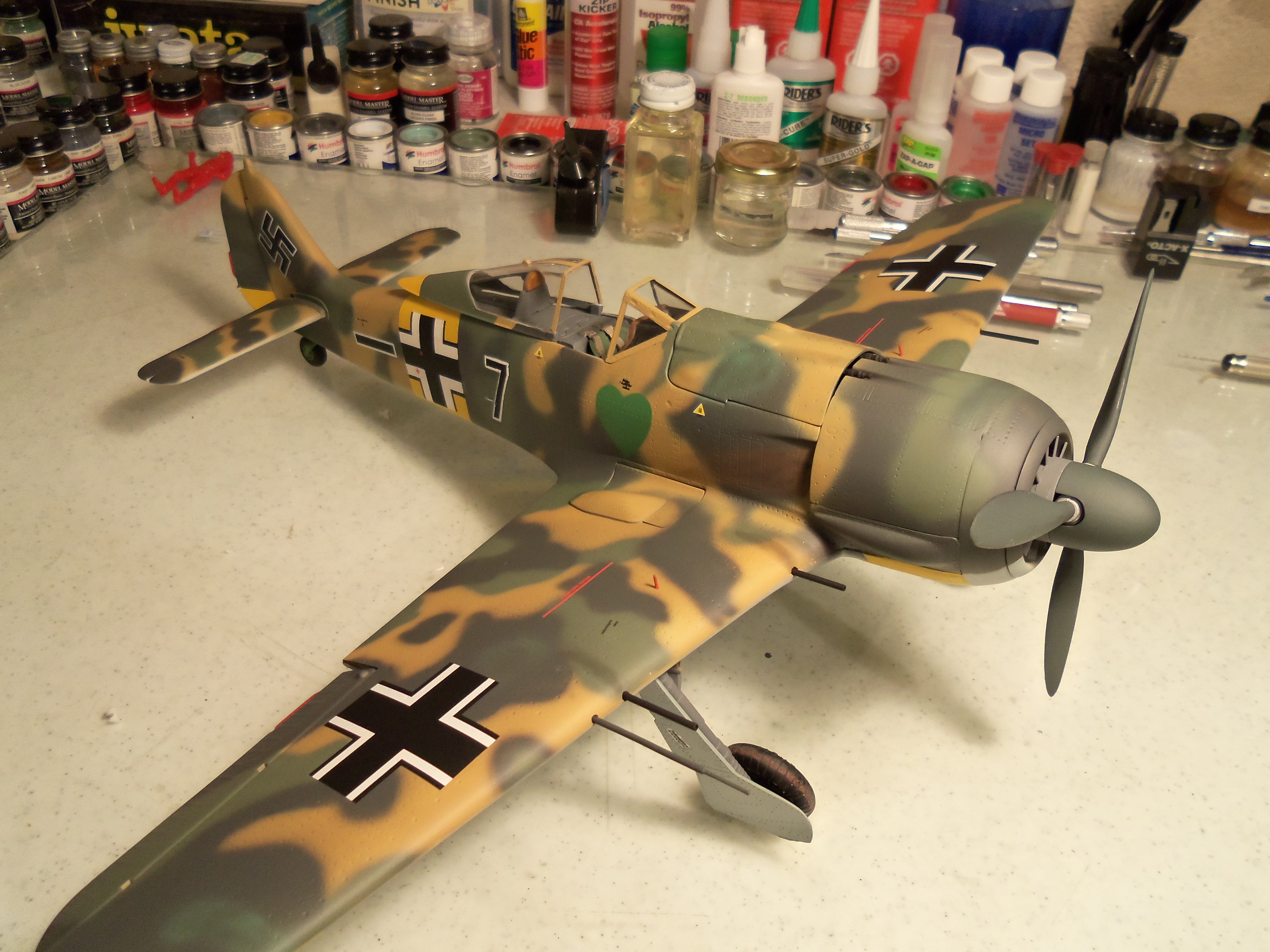

Hey Gus,
I'm still new to R/C Tanks, but I've been building static models for 45 years. Not to brag, but I've actually had work displayed at the Yankee Air Museum. I've tried just about every airbrush there is from Testors to Badger and I use an Iwata Eclipse HP-CS. You can get them online for very reasonable prices or you can get them at Hobby Lobby, just make sure you get the 40% off coupon. The Iwata is a tad more expensive (around $120 is a good price) but it's the finest all around airbrush I've used. I did this FW190 in 1/24 scale, mostly freehand. As for compressors, I use the $40 pancake compressor (3 gallon) from Harbor Freight. You can spend hundreds on a compressor but I'm very happy with my el-cheapo job. Just make sure to invest in a water trap, no matter what compressor you use.
Hope that helps, and if you have more questions just fire away. :-)

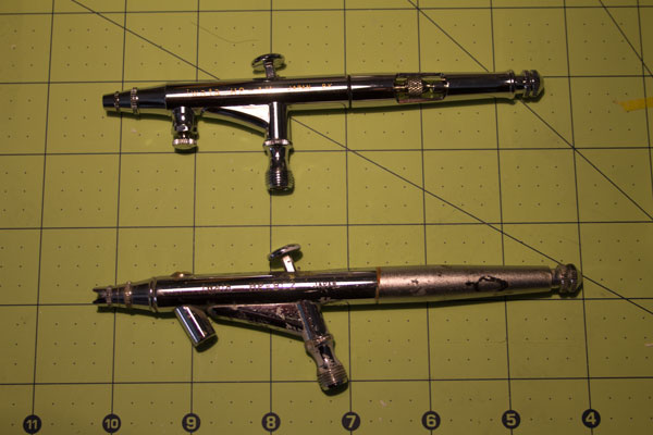

Here are my two Iwatas. The lower one was bought from the original NYC Pearl Paint in the Village in 1982. It's still going strong, all original: needle, nozzle, etc.
Both spray like a dream and have great balance. The bottom is a siphon, uses cup or bottle on either side. Top is a gravity with a fine tuning air valve underneath the cup (really just a slot for paint in the body).

Yes Sir!
Thank You Ausf...
Your Iwatas look Sweet.
Thank You also, for the Explaination...
I have the Paasche Talon Set on order, it's Gravity.
The set I've had stashed away is a Badger Vega, it's Syphon.
