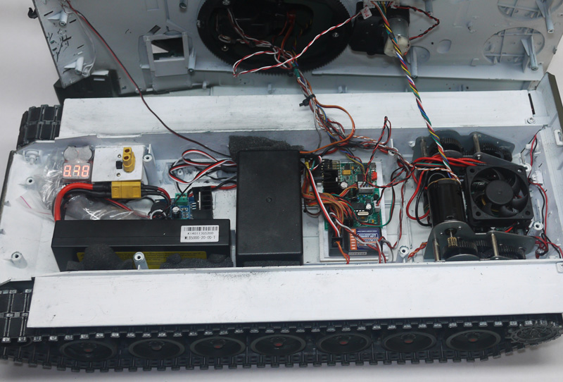

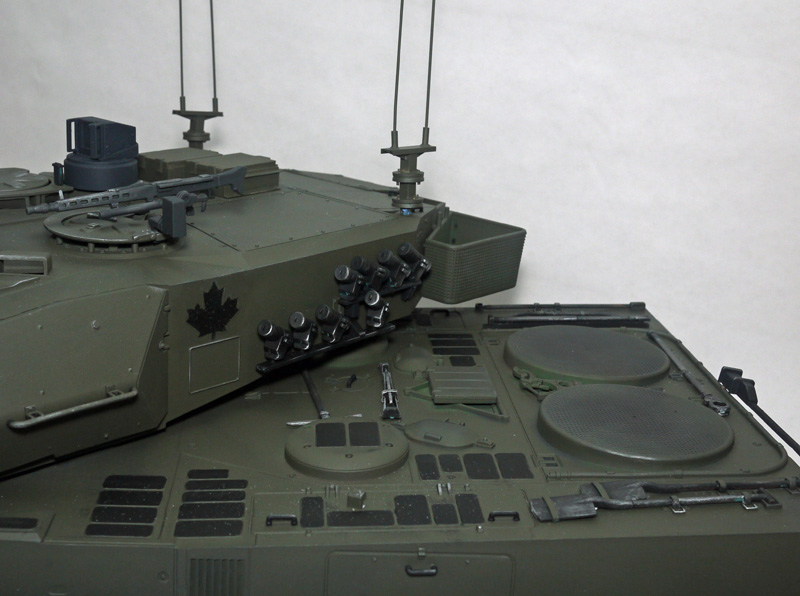

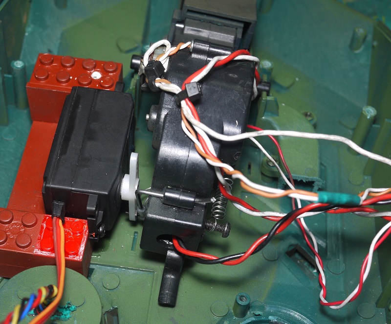

After getting the mechanics all worked out (which included speeding up the turret rotation) I focused on Canadianizing the HL Leopard.
First picture is the Slow motion servo elevation, and then A shot of the internal layout.
Lipo Battery
Amp
Speaker
DBC3/Benedini TBS/ Receiver
RX18 is mounted between the gear boxes and a fan installed. I don't normally do this, but with the high torgue motors, 12+ pounds, and metal track with Rubber pad inserts there can be a lot of current draw.

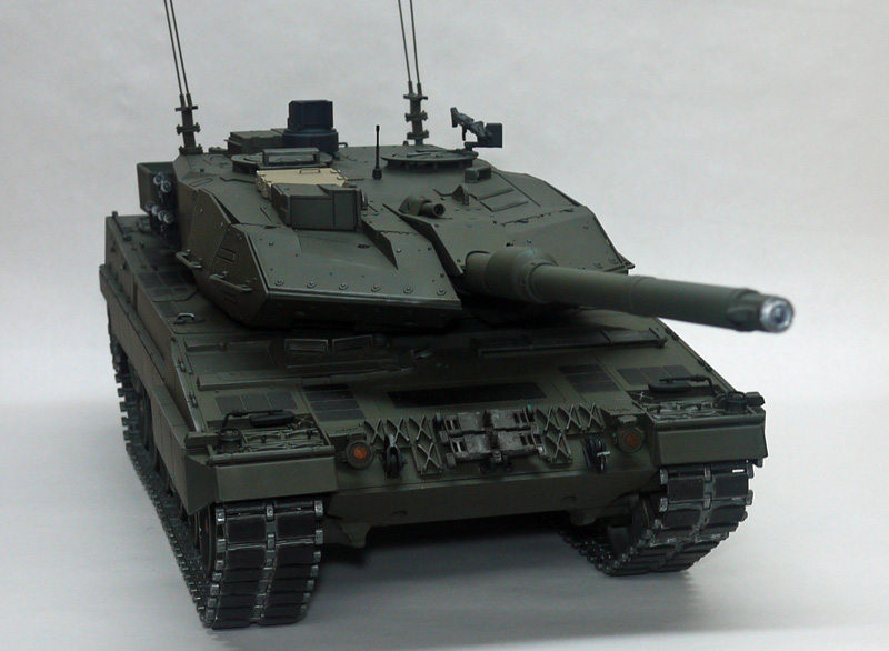

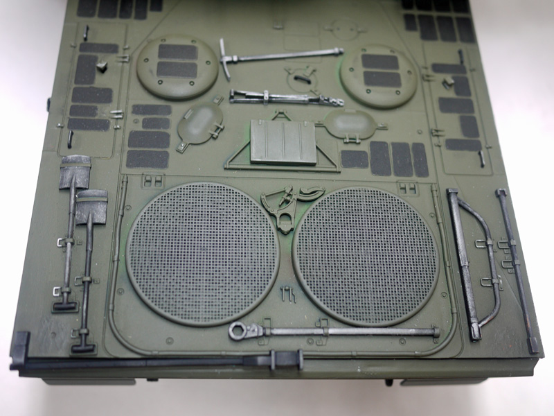

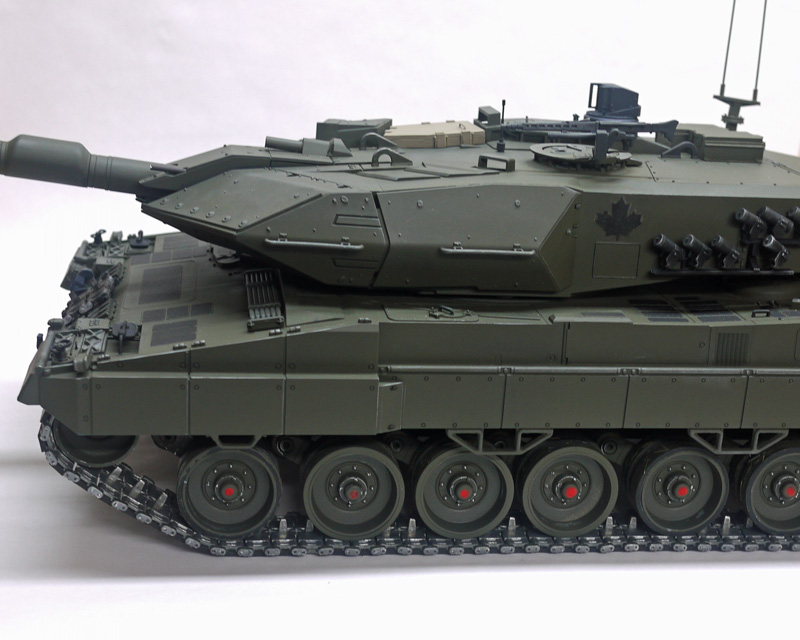

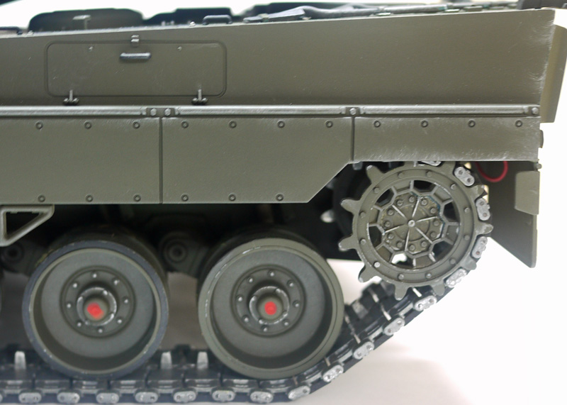

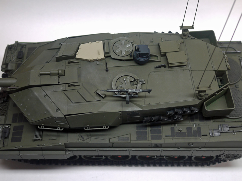

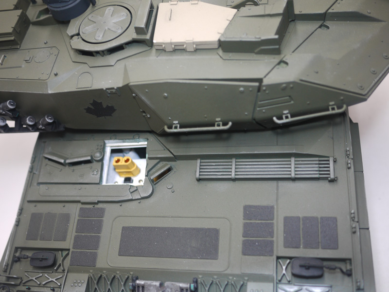

I made some maple leaf decals, gave it a coat of paint, and then detailed it.
Canadian Antenna's installed as well as some roof top electronics and a locker.
Back to the shop to fine tune the Benedini. Going to change the volume ratio between the cannon and the engine as well as make the turret sounds quieter.

Are you using Legos there for the Elevation Servo mounting platform?

Lego is a great thing. Any time you are looking for a ready built square box made out of styrene, look no further then lego!!!!

Great work indeed. Where did you get the accessories from - the antennae mounts/weapons box/ecm boxes? The video is incredible as well, 12+ pounds in weight!

Can you tell me what gear boxes you are using?
thanks
Here is the thread on them
http://www.rcuniverse.com/forum/rc-t...raw-video.html
I built those and am planning on doing some resin copies.

Looks great. Did you get early access to one of Taigen's 360 turret rings? How did you speed up the turret rotation? Different motor?

I used the HL mechanism and changed the layout . The motor is mounted vertically and engages primary gear with a differnt pinion gear. No slip ring. I can wrap this thing about three turns, before wires start pulling out. I just don't do that.
