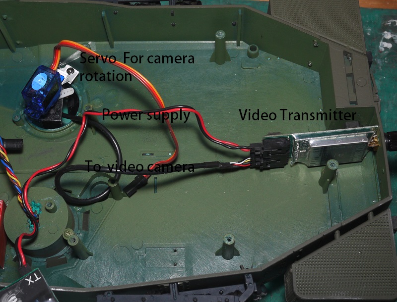

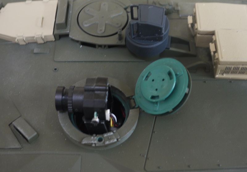

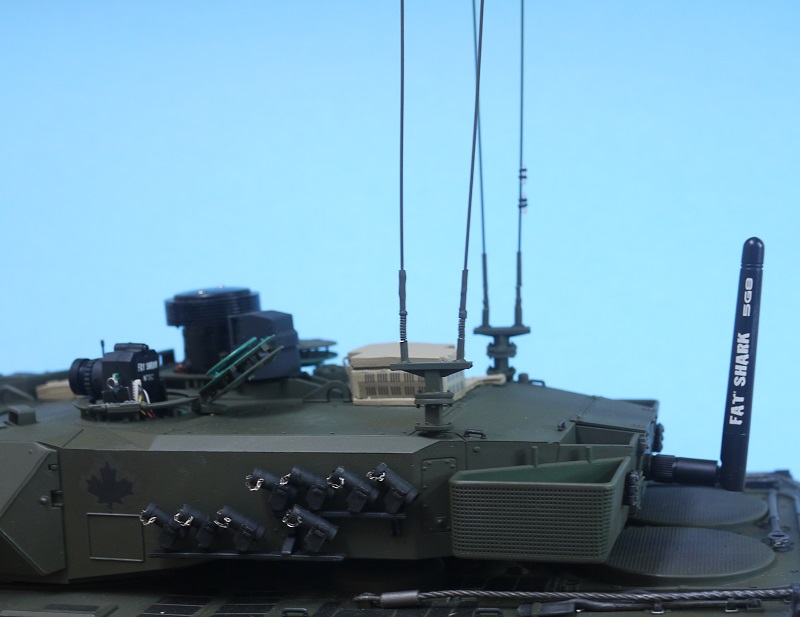

I installed the Fat Shark video system in my HL Leopard 2. There is lots of room for this small component based system.
What you see in the pictures is all there is to it. This system has a price tag of about $225 and comes with a set of video goggles that moves you to the top of the turret when you put them on.
Fat shark now has a camera that has an SD card in it if you want to record your journey as well.
The servo used for rotating the camera I supplied and is hooked up to the proportional channel 6 on the HKT6A
I took it out in the yard to run it, and my wife threatened to snap chat the image of her doofus husband sitting on the couch with the video goggles, playing with his tank running somewhere in the backyard. Oh I also had earbuds in too. With this system the pick up mikes are the little buds you see on the side of the camera. This moves then away for the gears, and actually all I could hear were the tank sounds with next to no gear noise. This tanks has the bearinged up gear boxes and the noise from these is very low.
I did get video glitches though and annoying static intermittently. I am running this set up of the same battery as the tank electronics I may try a dedicated battery to see if helps with the electrical noise This is a 5.8 gHZ system .

The limitations I see with the fat shark unit I have( V2 Predator)
Resolution is Ok but not great
Annoying glitches that effect audio and video. Not bad enough to spoil the effect, but still annoying. When this was happening in my Sherman I thought it was an antenna placement problem, so I purposely mounted the antenna in a prime spot on the Leopard, and I still have an issue. I am going to try a separte power source for the video equipment to day to see if this elimiates the problem

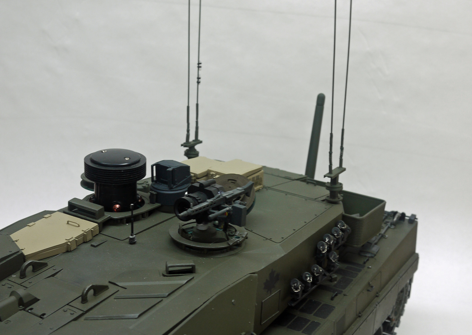

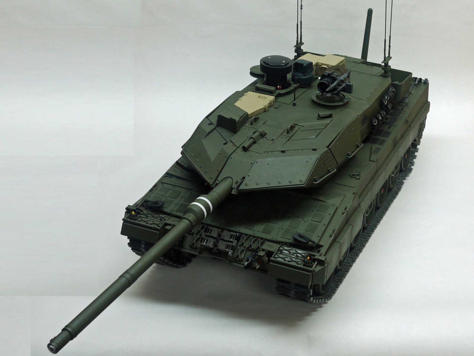

Follow up on my Leopard 2
Some Leopards and Abrams have remote controlled MG. If a person Mounted the camera in the same place as these units are mounted, It would be pretty easy to disguise the camera as a Remote M.G.
This Leopard is loaded up. TBS, 15 watt amp, running on 12 volts, Battle system, on board video with a panning servo on the camera.
