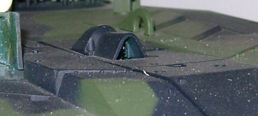

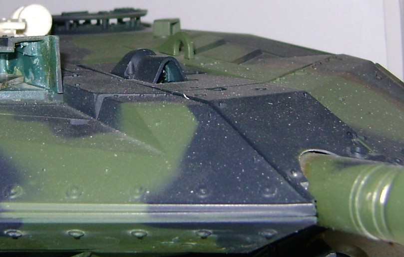

Hey Glen I have the IR Emitter.on the gun mantlet inline with the gun
Have a good one
Johnny

I was wondering if you can get the emitter recessed at least 9mm from the front end of its housing in that location.
Our club requires that an emitter must be recessed a minimum of 9mm inside its tube; I was eyeing up that location would provide that.
I don't have an HL Leopard to examine, I am checking some stuff out about them before I buy.
Old 11-26-2014 | 07:33 PM
Joined: Jul 2010
Posts: 3,148
From: West Grove, PA
May have to extend an IR bulb tube out a bit from that recess, but don't think it would be too much of an eye sore once you get some paint on it. Think you may be able to fit the bulb and tube in that recess though with a bit of dremel work, that's where the IR is located on the tammy.

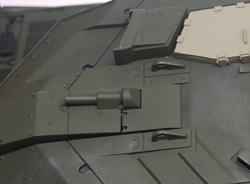

Here is mine installed.

Old 11-27-2014 | 03:46 AM
Glen B's Avatar
Joined: Jun 2010
Posts: 1,362
From: Fort Erie, ON, CANADA
Dan
Thanks, thats very helpful.
Usually I like a more discreet installation but sometimes that is not possible, that doesn't look too bad to me, it is something I would install.
