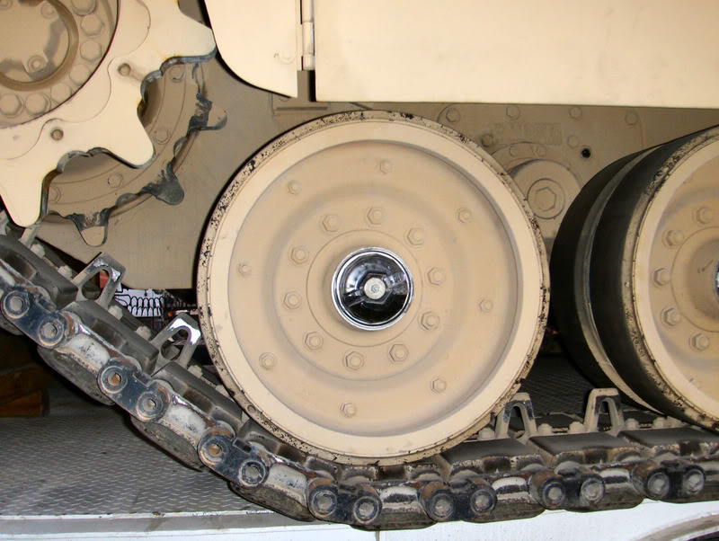

Old 01-27-2015 | 01:18 PM
Pah co chu puk's Avatar
Joined: Apr 2010
Posts: 3,260
Received 153 Likes on 99 Posts
From: Ridgway, CO
Originally Posted by Johnny Blaze
but I was trying to stick with Abrams look as much as possible. I know the Leos tracks are similar, but I would never be able to unsee the difference, keeping me unhappy.... .
The stock HL tracks are not correct, they are closer to Leo tracks than Abrams tracks. Abrams tracks have the center guidehorn on the connector link, not the track section.

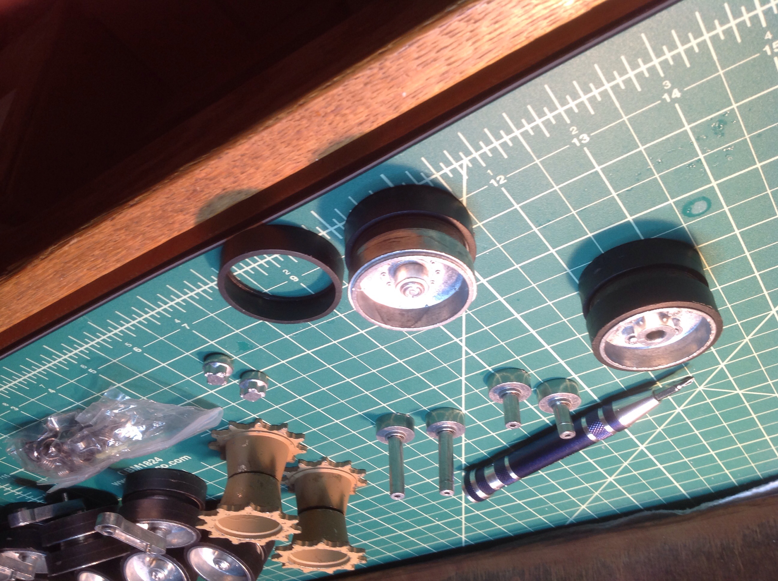

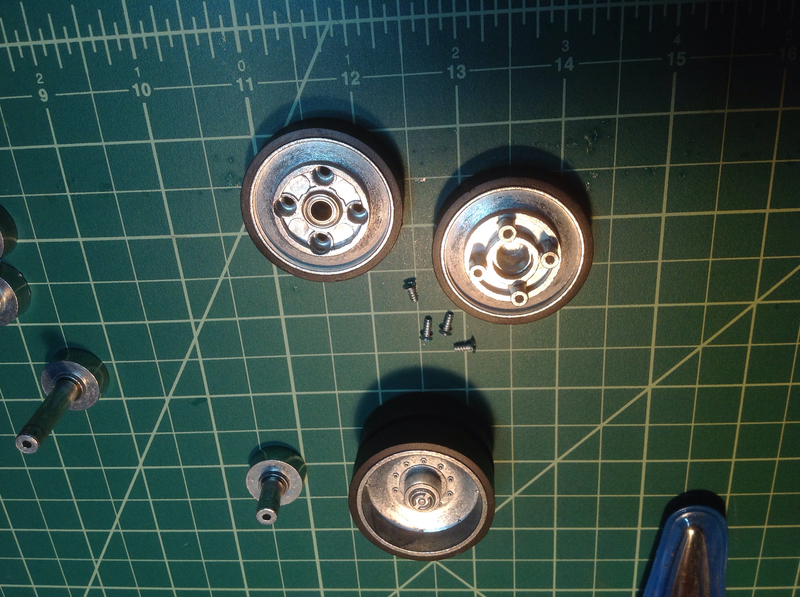

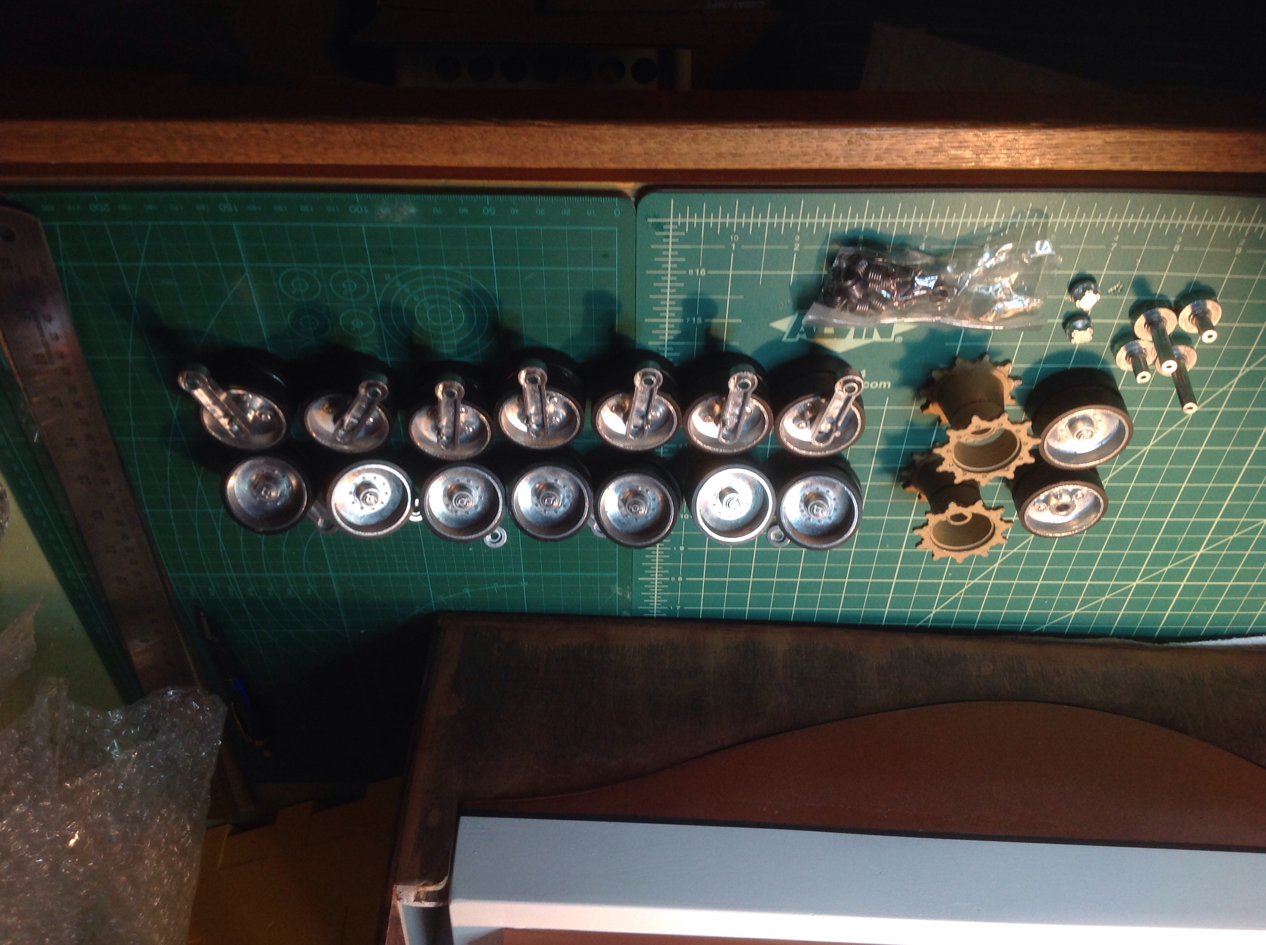

Old 01-28-2015 | 09:51 PM
Augustus1967's Avatar
Joined: Jun 2014
Posts: 368
From: Spring, Texas
Default Photos... Abrams Gear
Here are the Photos...
-gus
ID:	2068741   Click image for larger version
ID:	2068742   Click image for larger version
ID:	2068743   Click image for larger version
ID:	2068744   Click image for larger version
Old 01-28-2015 | 09:59 PM
Joined: Jun 2014
Posts: 368
From: Spring, Texas
And the Return Rollers have Bearings as well...
So far it all looks pretty nice...
The Rubber Tires are a Hard Rubber.
I don't think they are intended to be Removable for Painting.
Edit: After a closer look and Messing With, the Tires ARE Removable...
-gus
