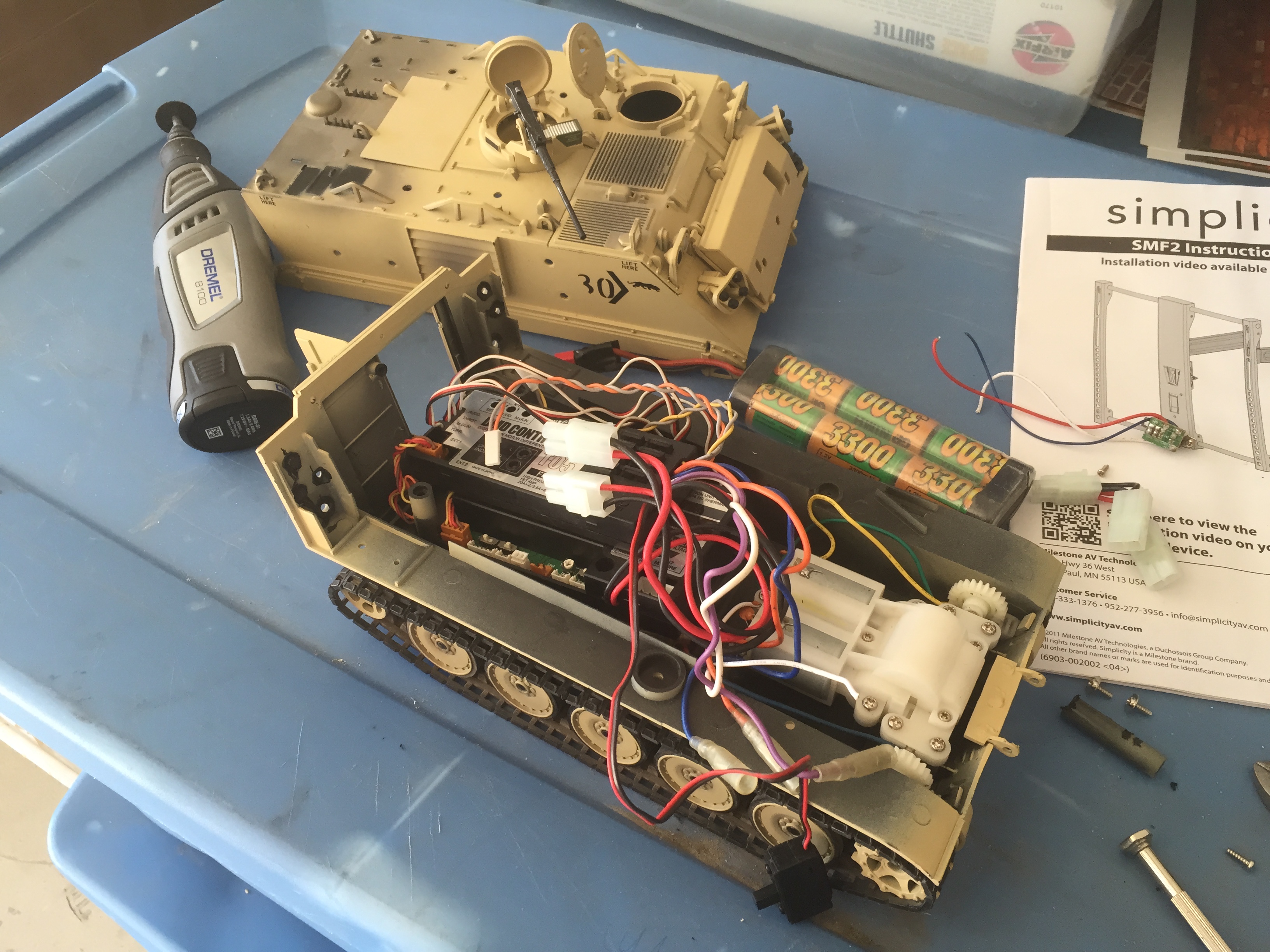

CountChocula from the DAK crowd is a twisted individual. He prefers scratch builds of eclectic vehicles and really small stuff. The SDKFZ 250, FT 17 and Rolls Royce Armored Car....etc
So the other day he trots out one of his overstock and gave me a 21st Century Toys RC M113 and talked about how cool it would be to get some modern armor going...
CHALLENGE ACCEPTED.

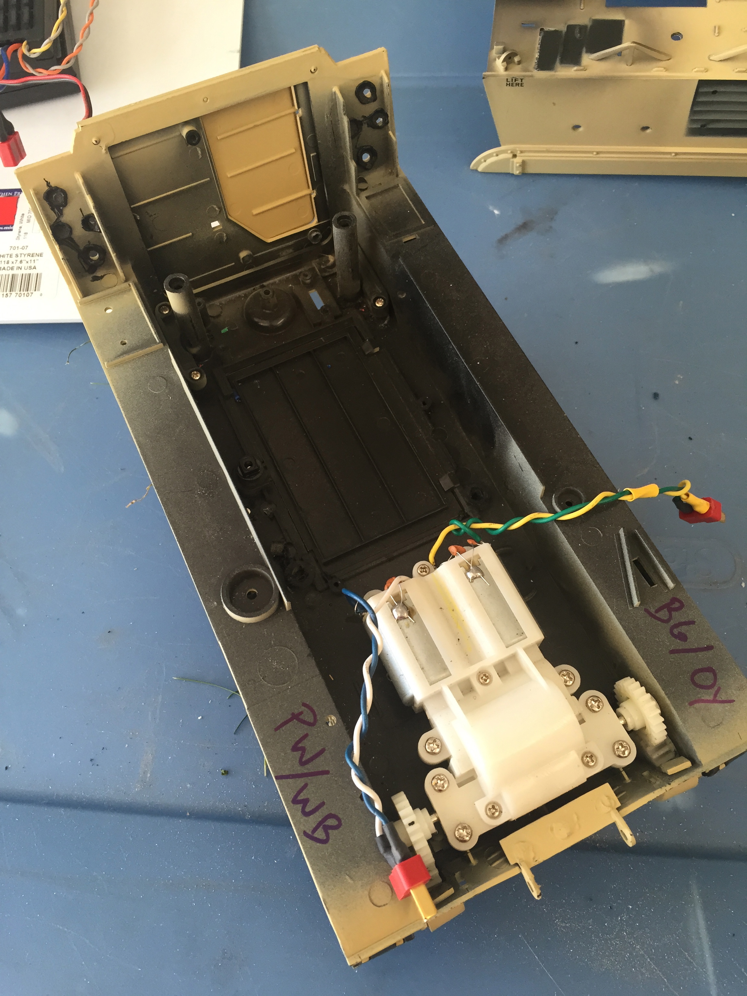

Gear box STOCK
Speaker STOCK
Tracks Stock
Parts Box raided for Tamiya Sherman Guts.
Deans Plugs to rewire MFU DMD and GEAR BOXES.
I did break down and buy a LiPo battery to fit.
My First....

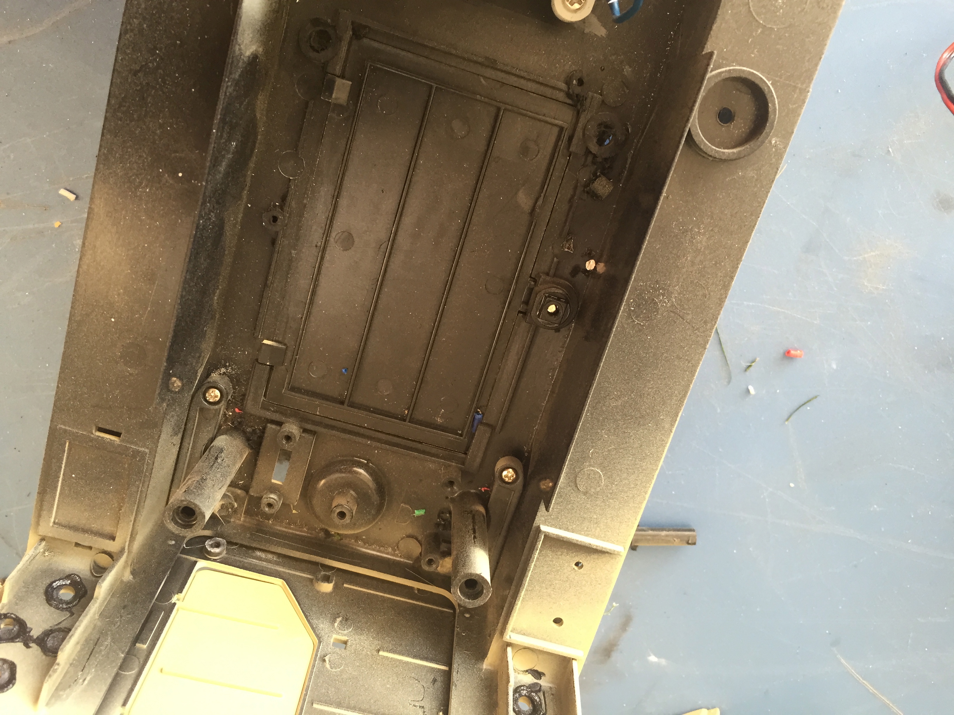

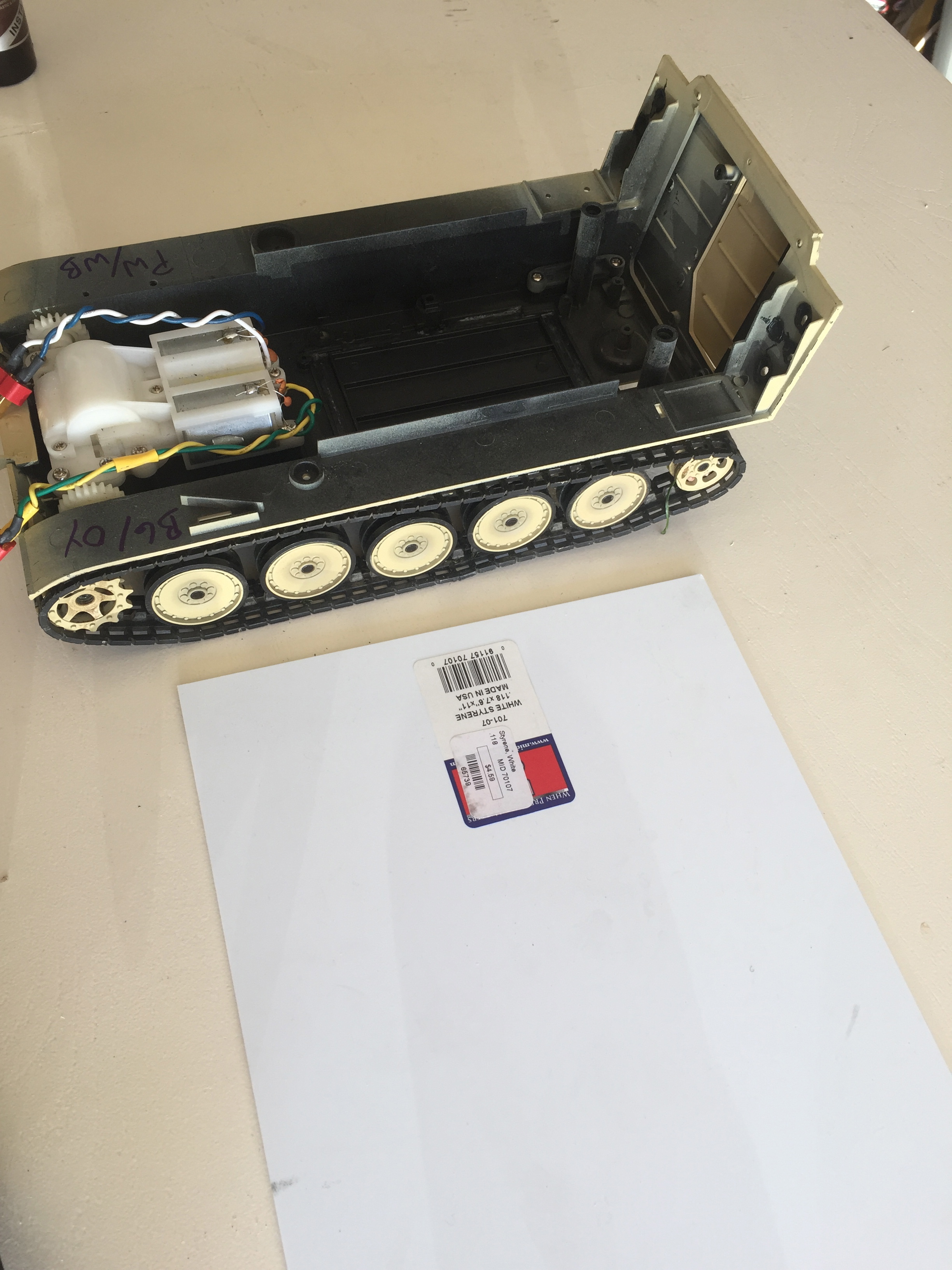

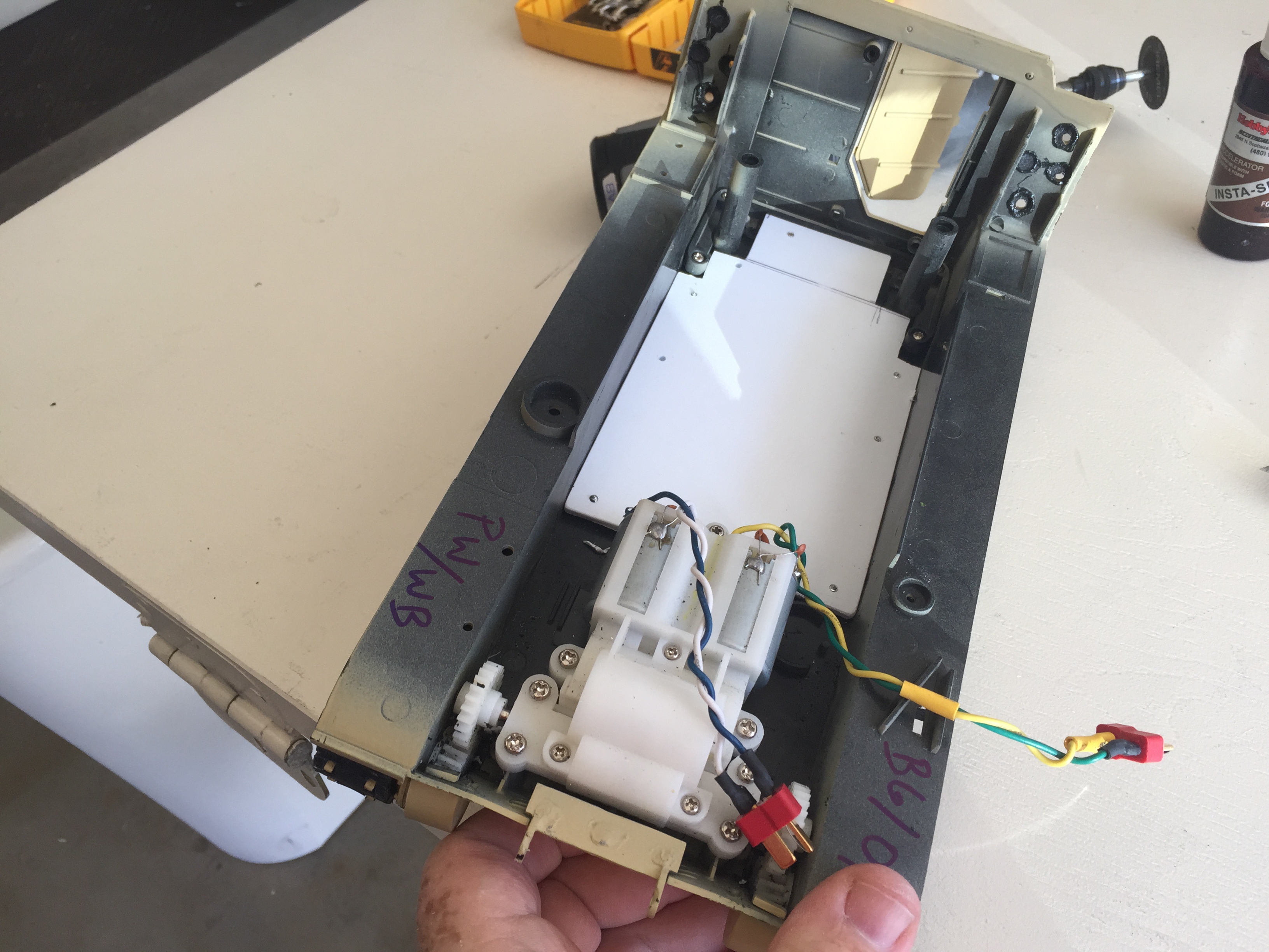

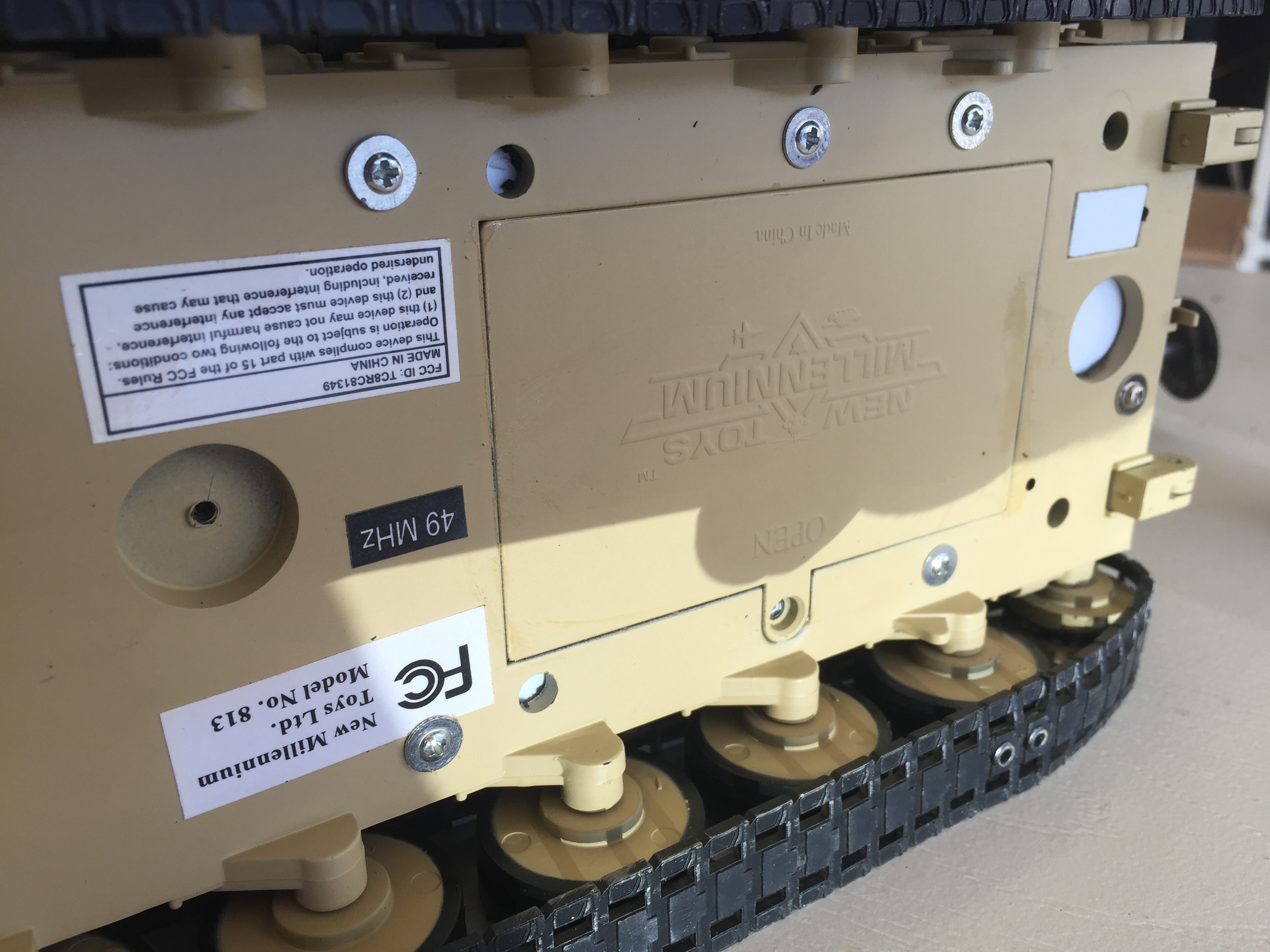

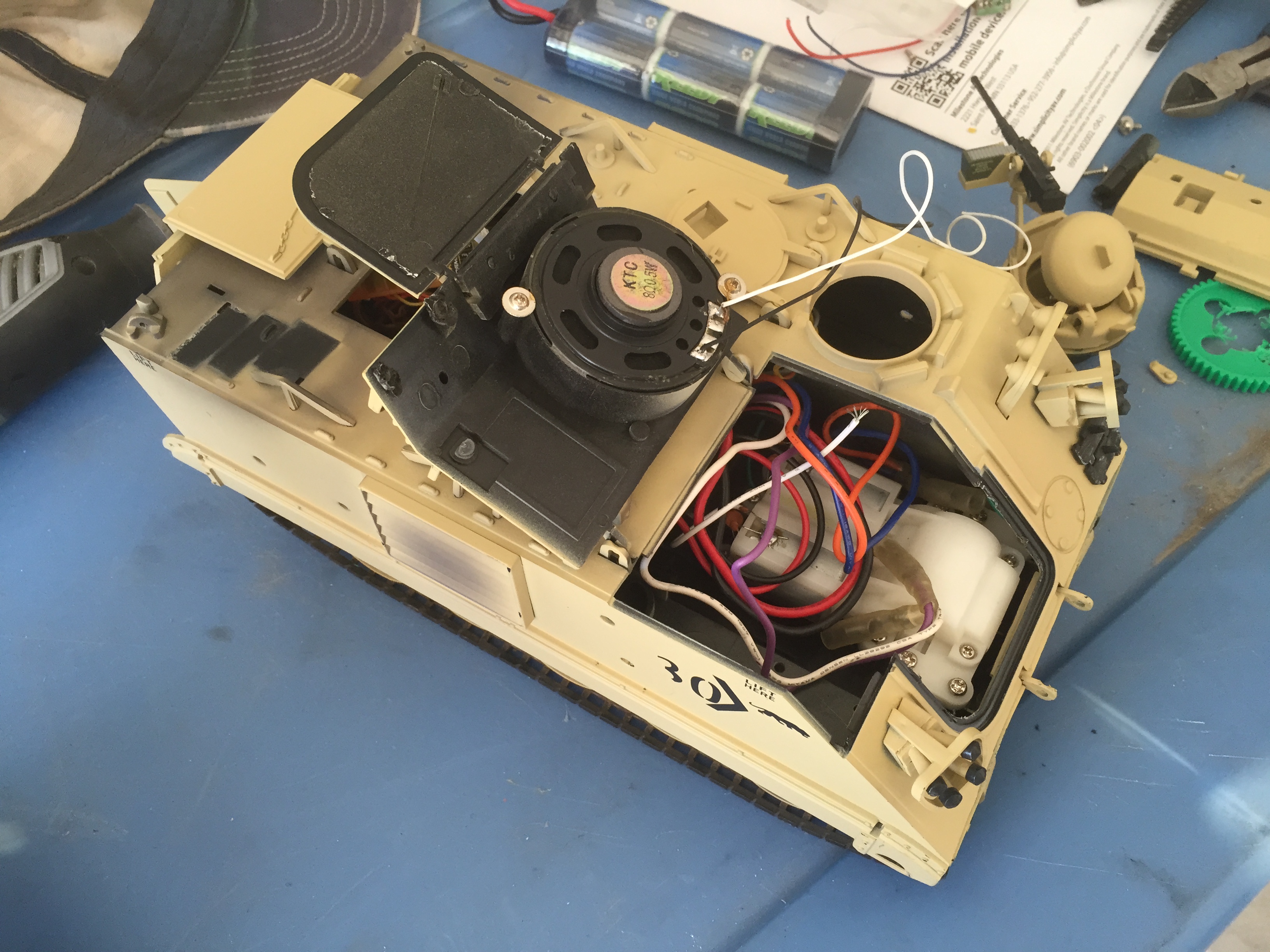

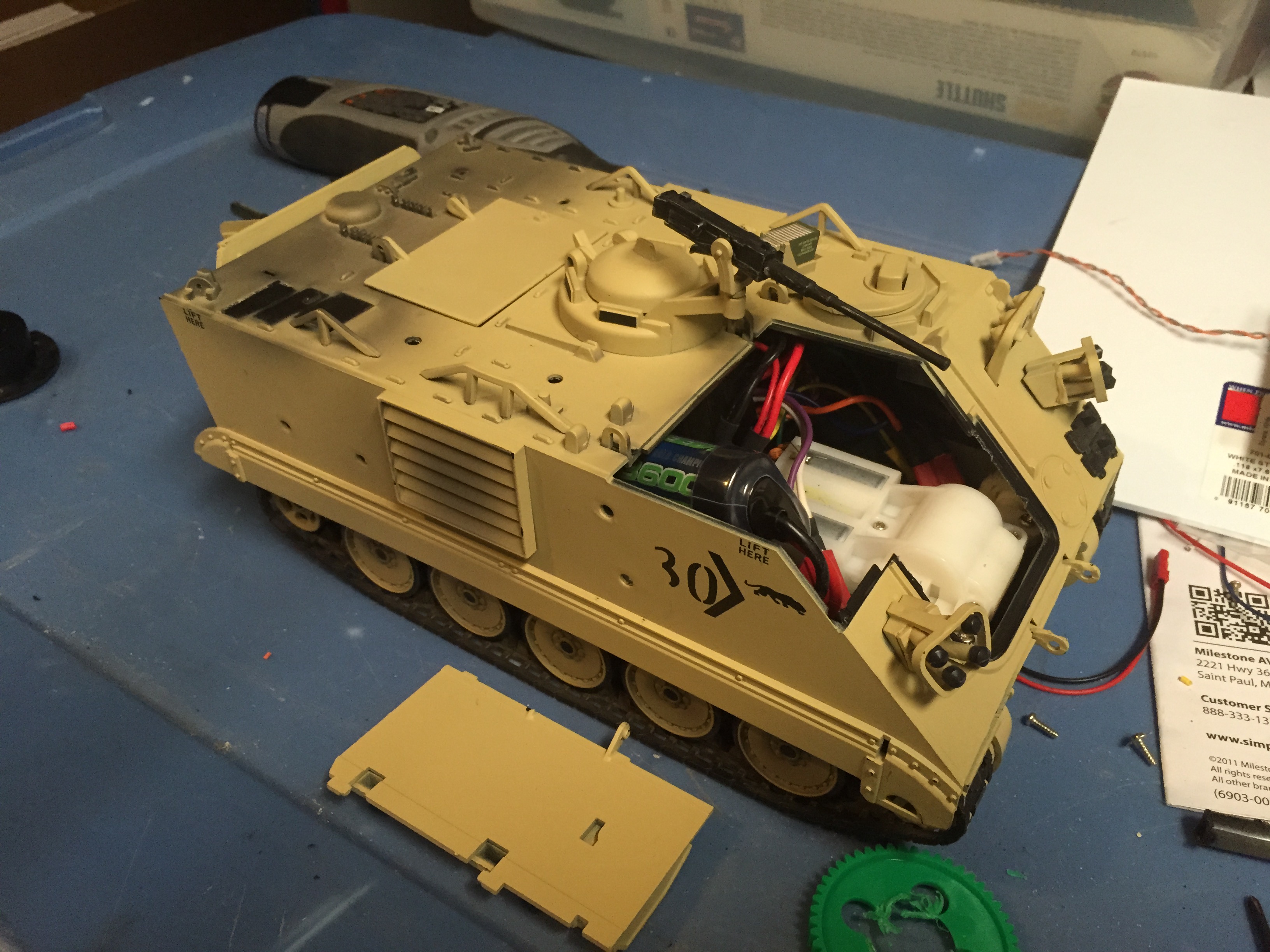

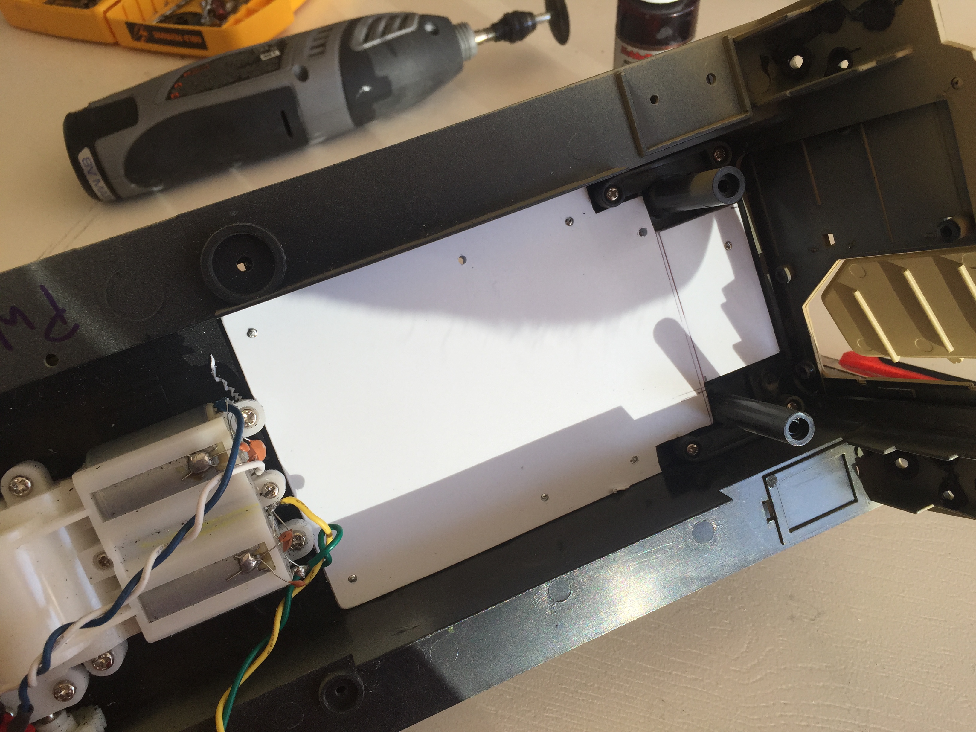

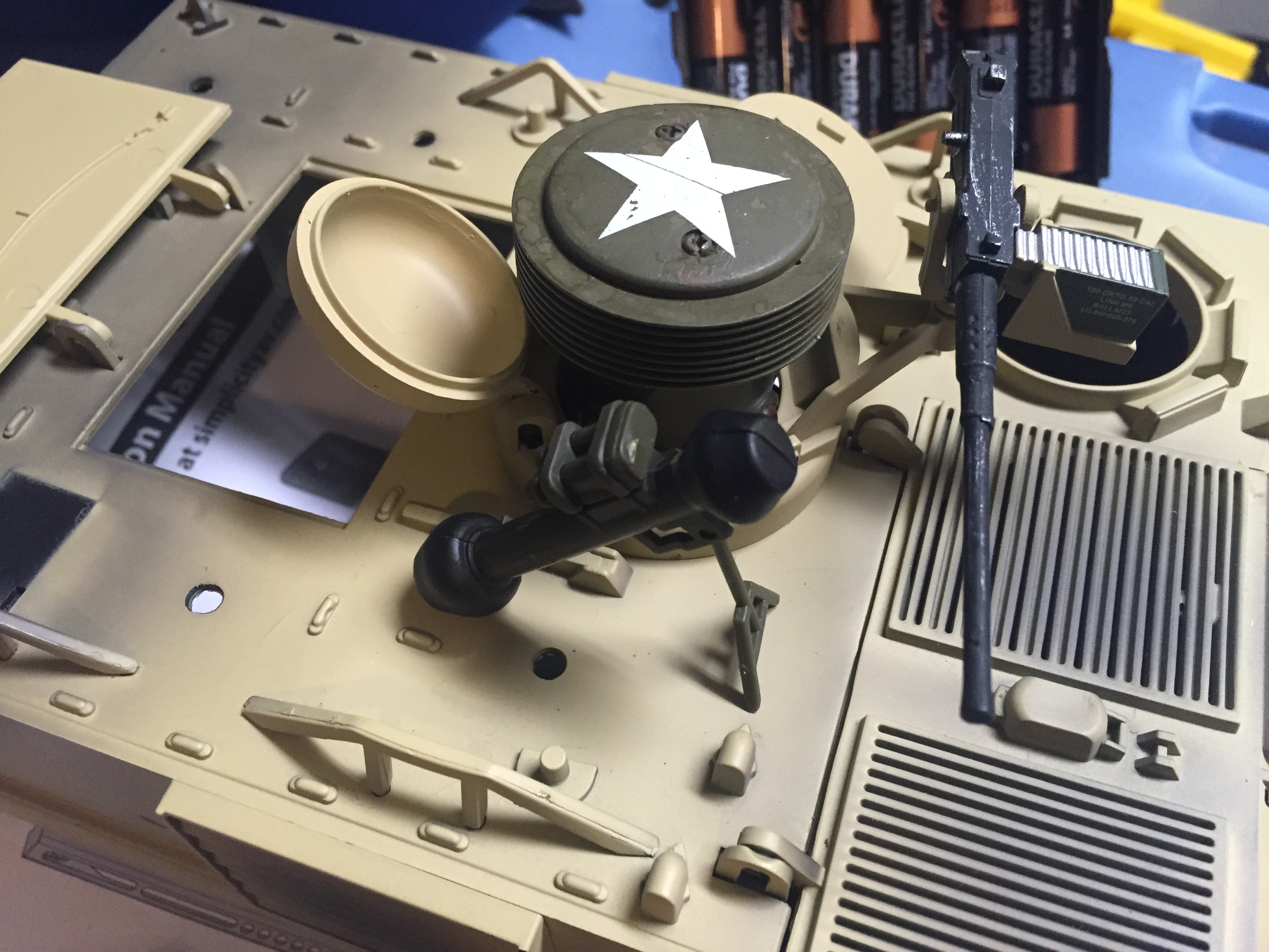

Sealed and removed Battery box. This one simple un screws!
Made a floor brace from styrene and screwed it in after leveling the hull.

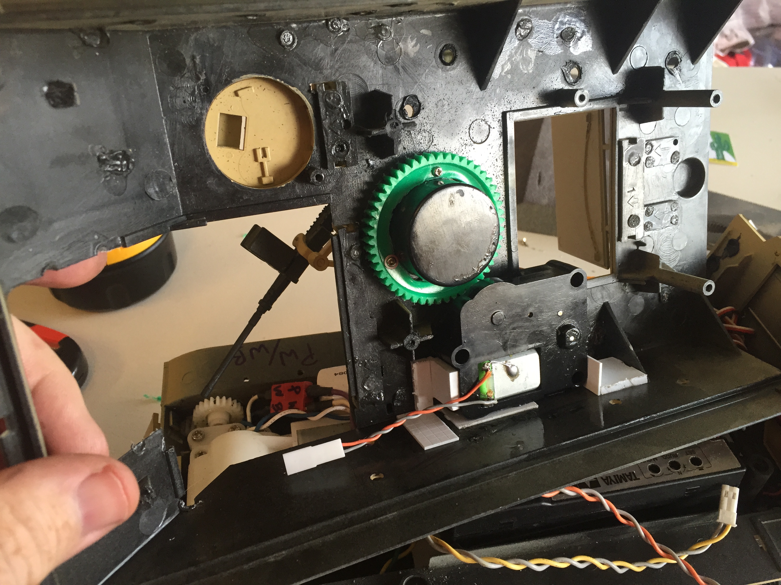

I got the traverse working with a gear from an educational set and a HL traverse.

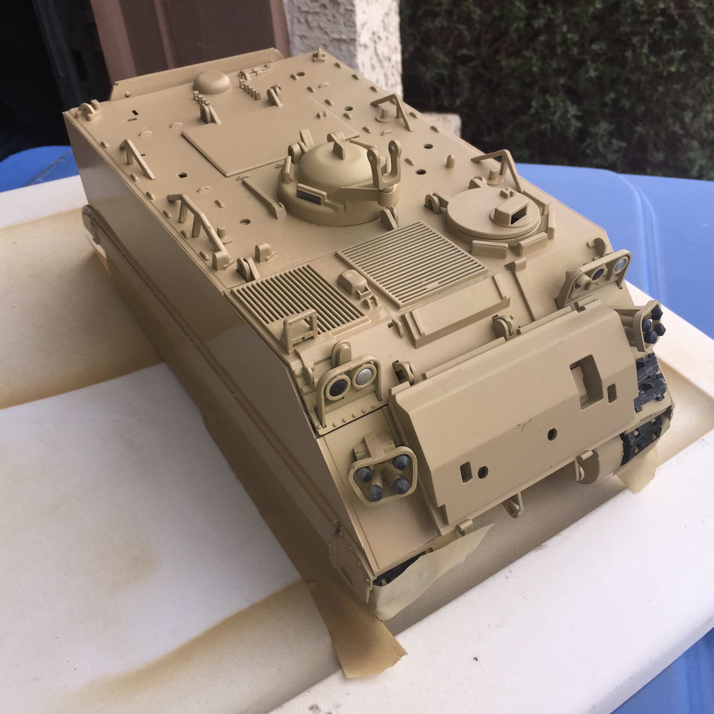

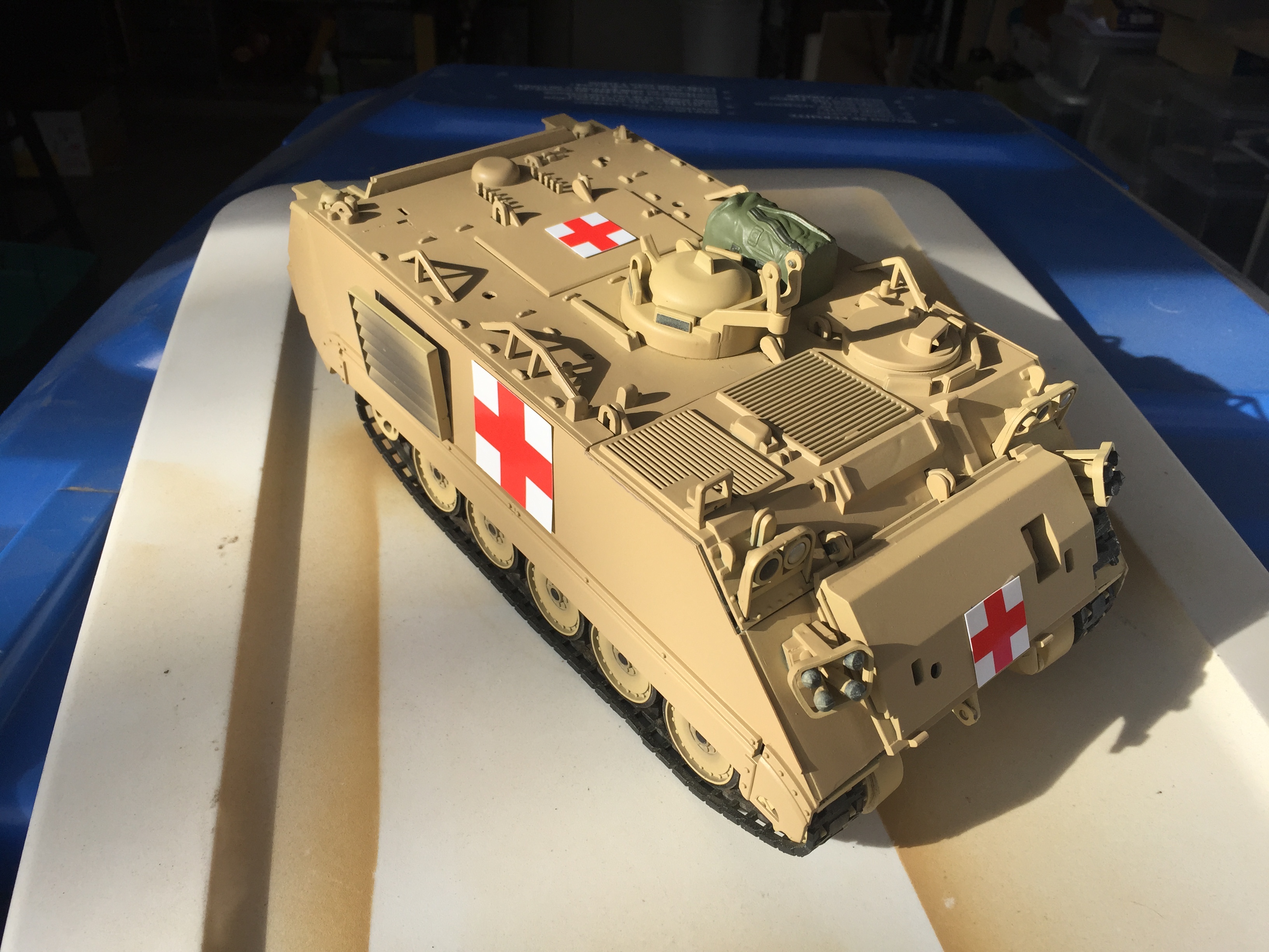

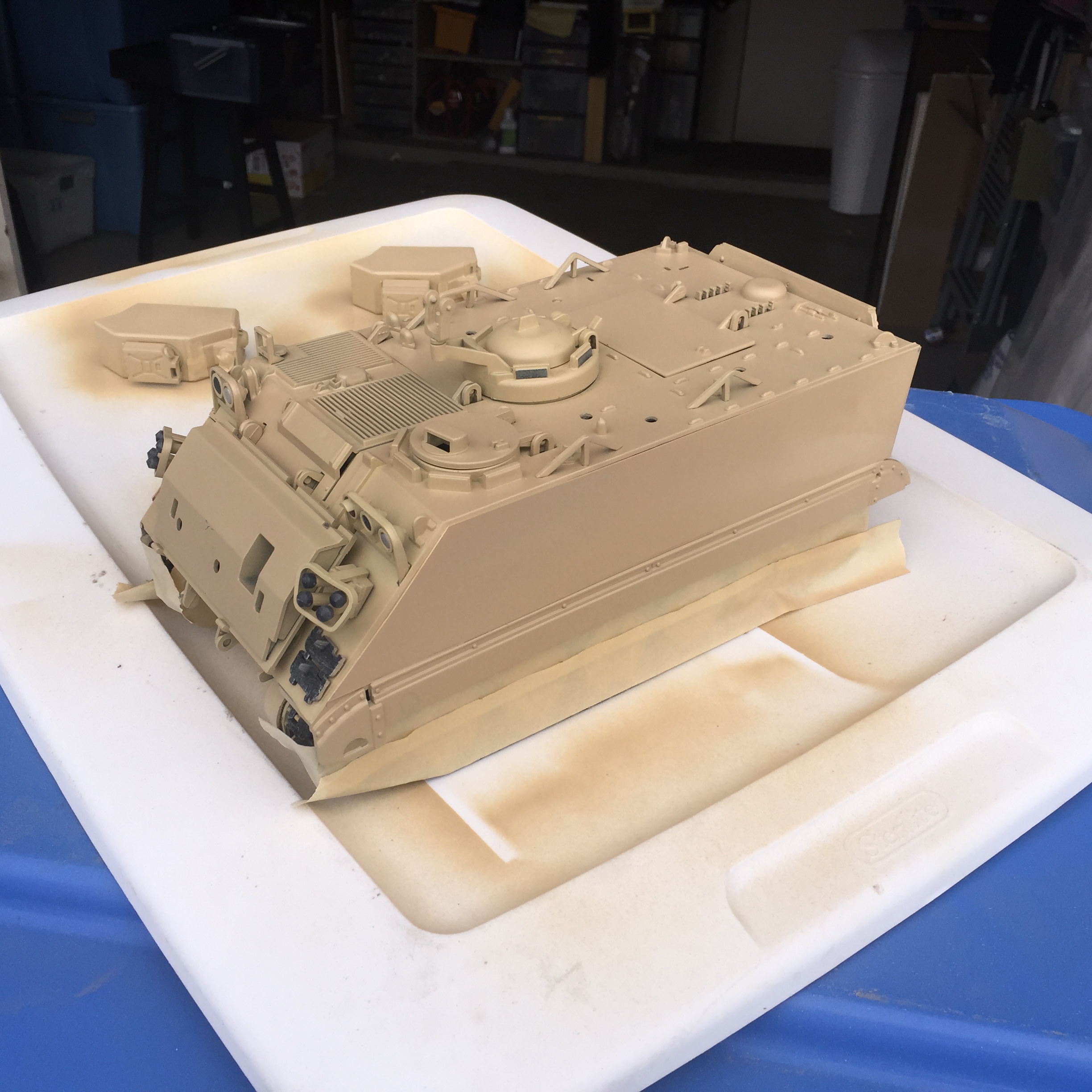

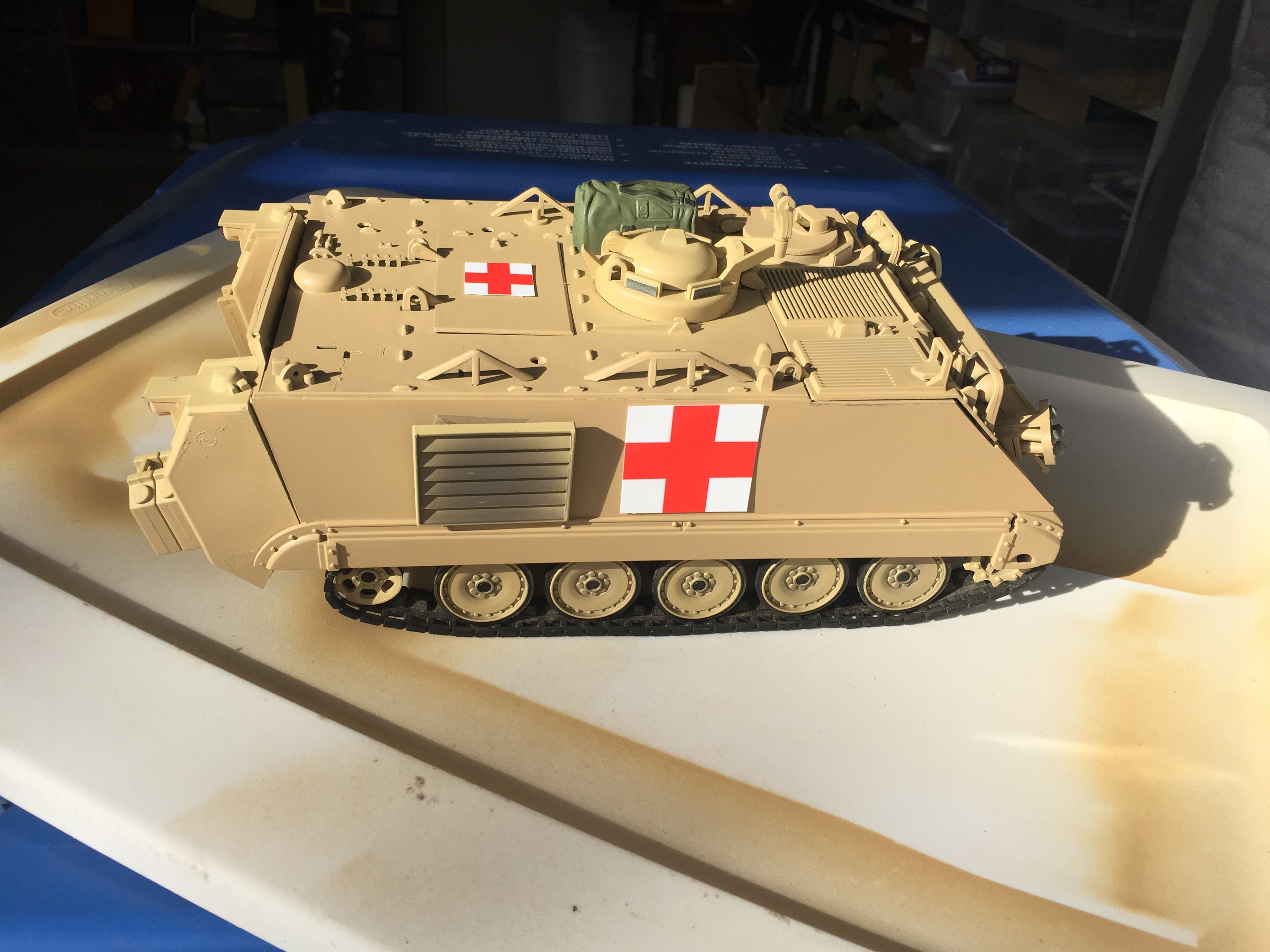

Buttoned up and a quick repaint with Tamiya Light Sand. Made some red crosses and used rubber cement to tack 'em on. A fun weekend project and now I can work on the scenario with my "rescue" track. If I need to, an emitter can be added to make it a scout.
