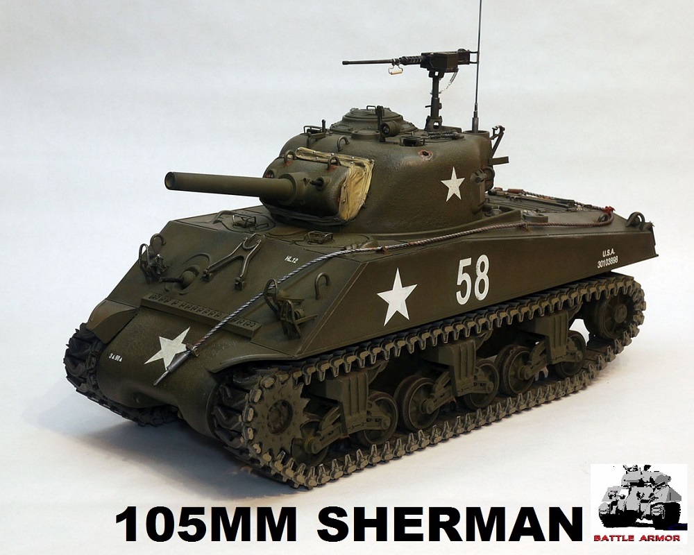

You can buy Mato Plastic track and sprokets. Their plastic track is bullet proof. I just used their sprokets and plastic tracks on my HL Sherman,.Here are a couple of examples.
the track blocks are a good quality plastic that has a rubber feel to it, and the connectors are metal. It is great track.

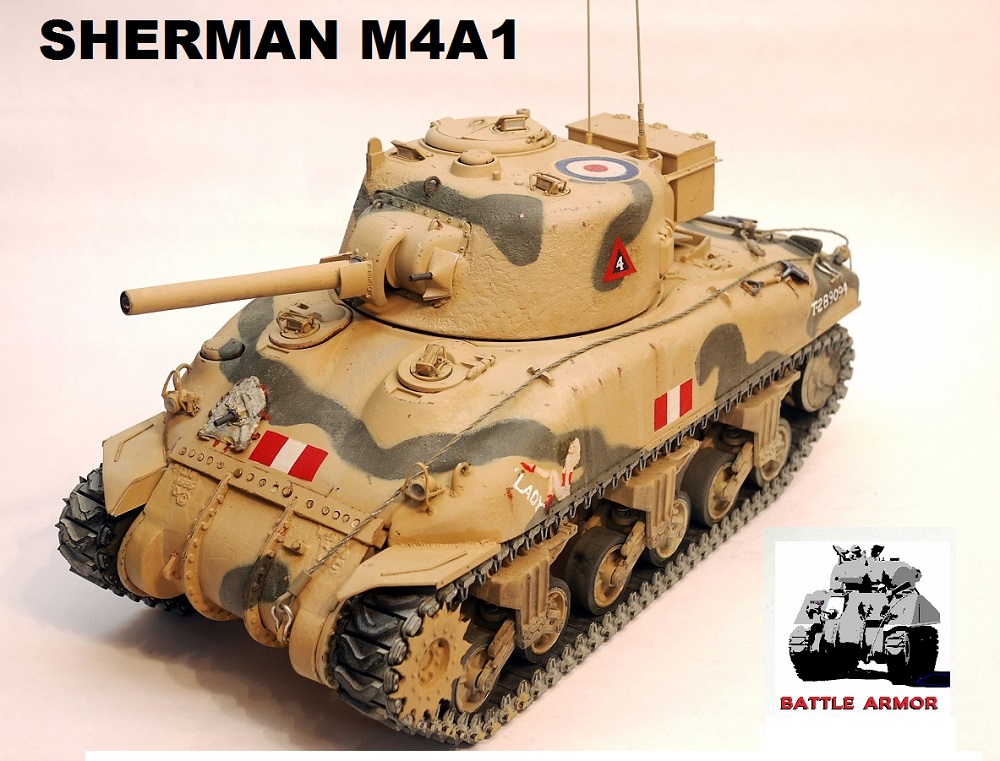

Dan where did you get the A1 small hatch hull on the desert sherman? That is badass, I want one.

That is a Profiline Resin hull. Best cast hull I have ever seen, Unfortunately I don't think they are available anymore. Although I think Taigen or Torro might have bought the molds.
The Tub is Mato with metal suspension
The 3 piece tranny cover was something I imported from the Netherlands
Mato Brass gear box
My own turret casting, and a lot of other Scratchbuilt features. All the headlight guards etc were fabricated out of flattened brass wire.
I have a pile of Sherman's Just putting the finish touches on Fury which can then be added to the stable..
Mato Brass gear box
