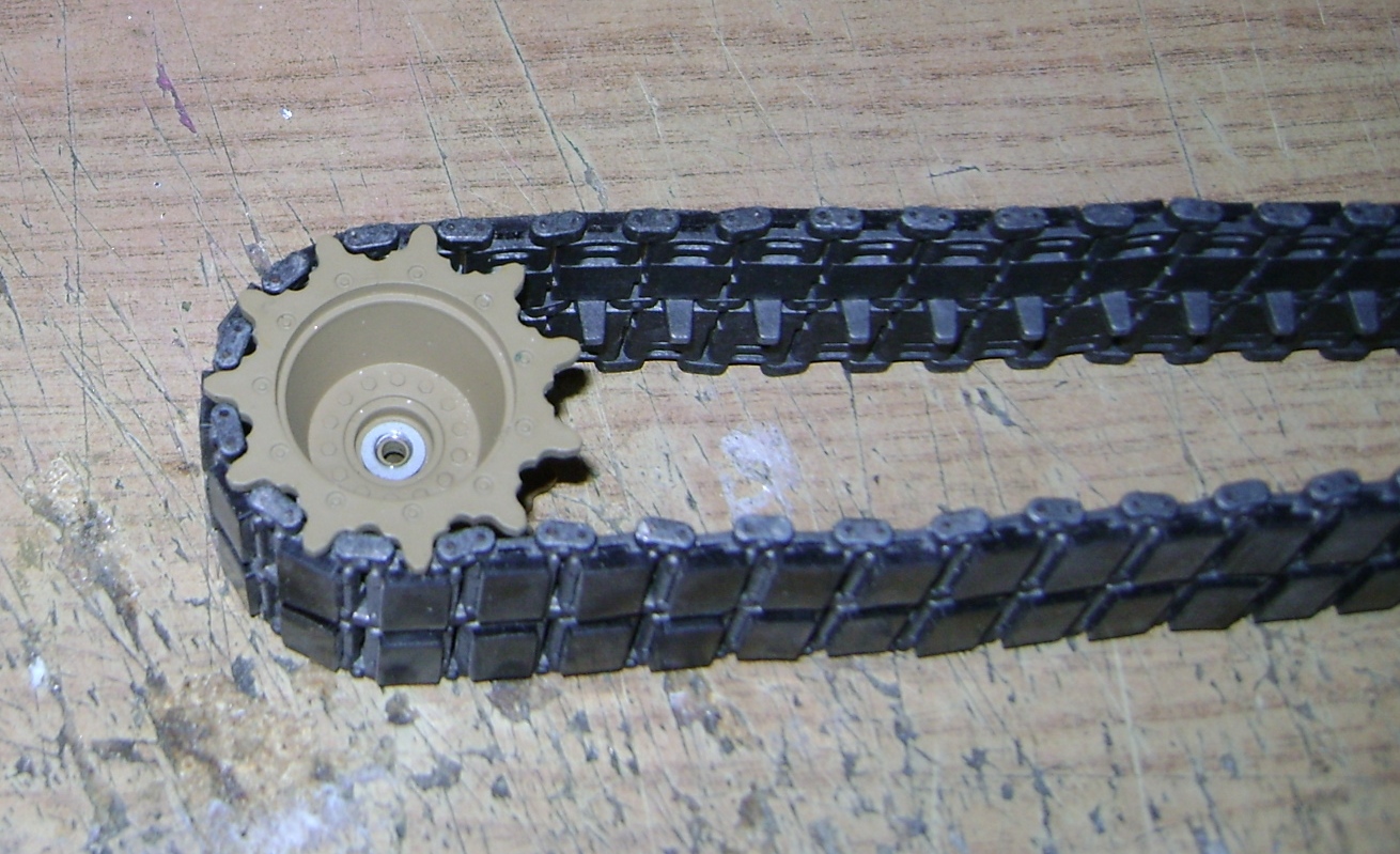

I have Tamiya Leo 2 tracks for me Abrams
