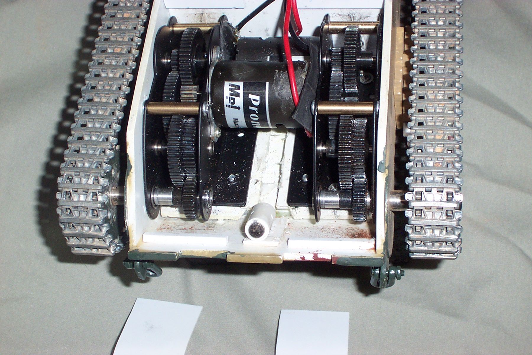

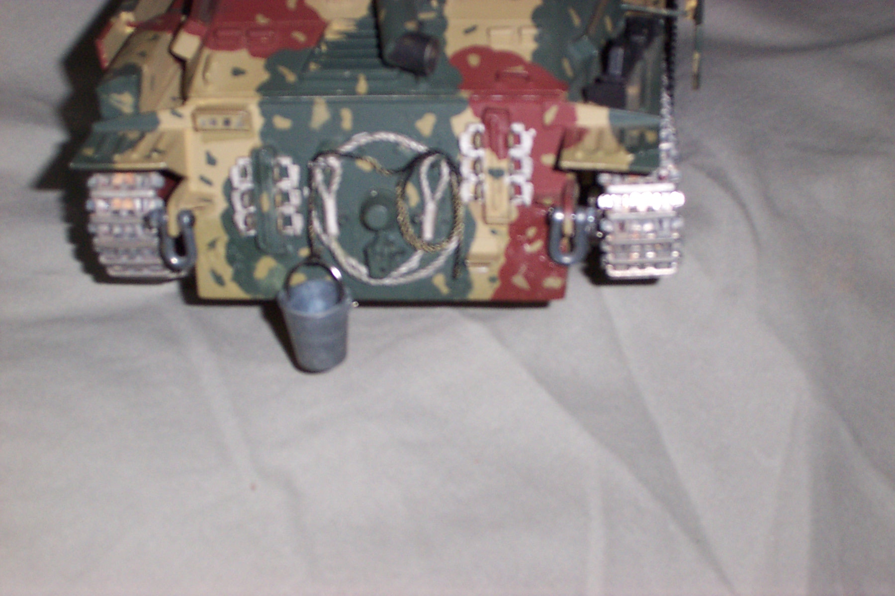

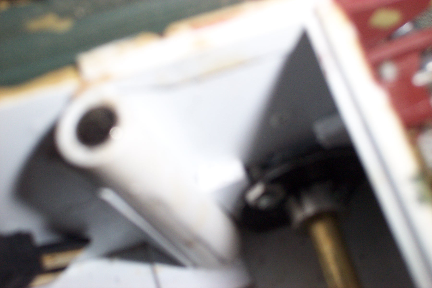

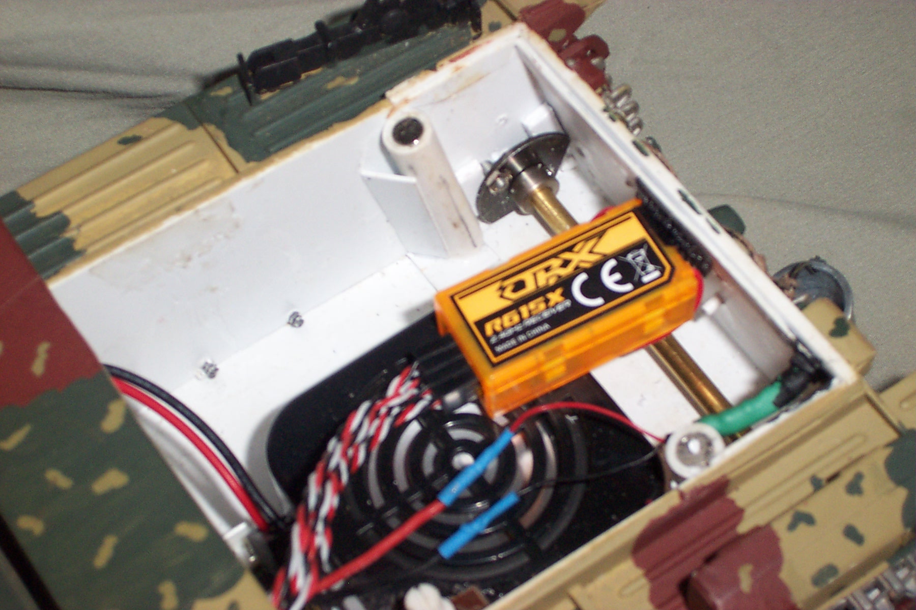

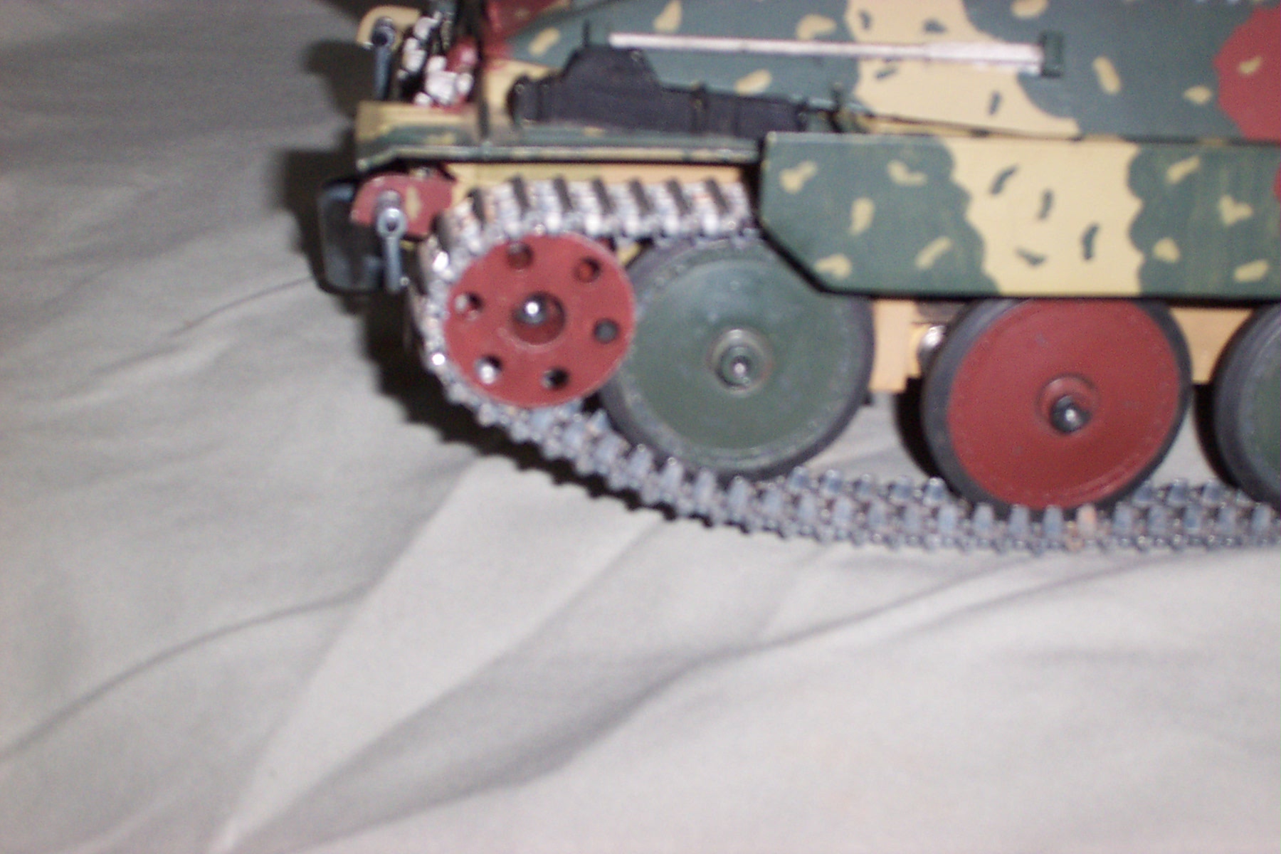

I have finally finished some modifications to my Hetzer. I had a pair of idlers made for bearings and modified a Henntec Tiger 1 idler adjuster to fit inside the hull. I also installed a set of the Taigen steel gearboxes with bearings and put 480 motors on them. Boy is it a smooth runner now! I didn't think it would make that much of a difference, but it did.
Herman

He tried that with me too Herman, dont trust him Looks good btw, I'm glad you like the gearboxes, they really make a huge difference. I've yet to run but just a few upgraded motors, which ones are you using?

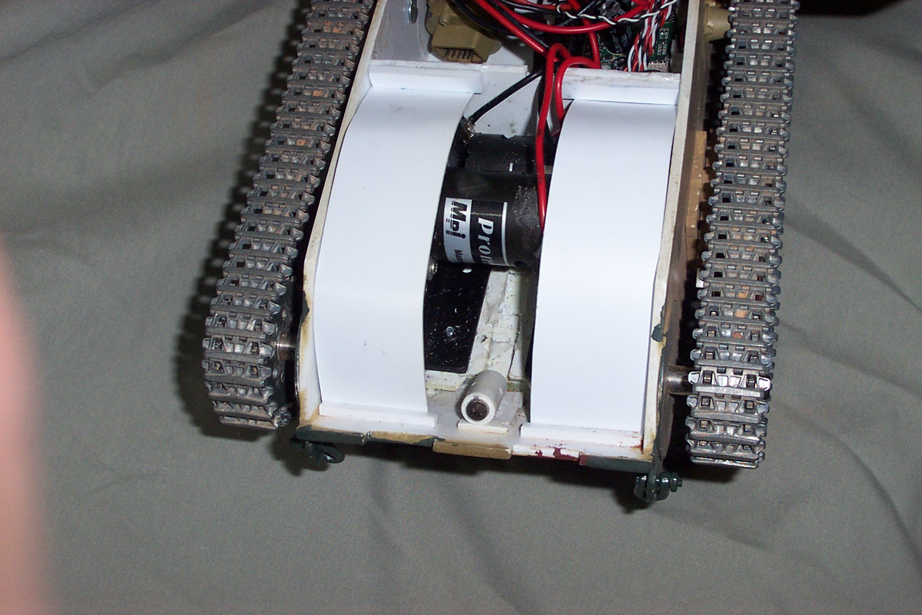

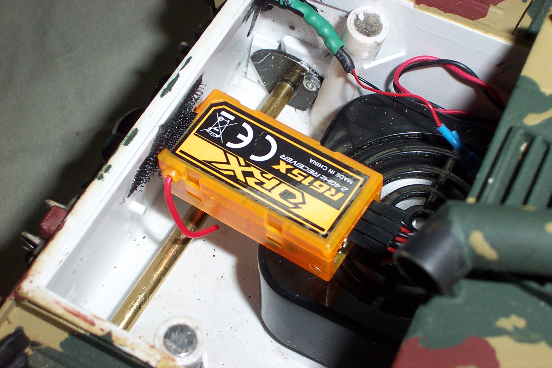

Hi Erik, Ya, I figured he would like to get his hands on it! I am using the Pro Max 480's in it. They have a bit more torque than the 400's and a little less speed. With only three hits, I really don't see a degradation of performance getting hits. I love the gearboxes smooth performance too. The only mod I had to do to the adjusters was to shorten the brass spacer tube to fit in the hull. Everything else was stock.

I have been running this around for a good while now and believe this is a great combination for the running gear. I only had one track try to jump the idler and that was because I was doing turns and doughnuts in 3" high grass. Cement, dirt, carpet are all OK with no problems.

Yes, it is quite snug, but everything does fit with a bit of finagling. I runs so much smoother with all the bearings in it it is almost like a new tank.

More and more as I use it and they wear in better. Really not to bad now at all. Still some though.
