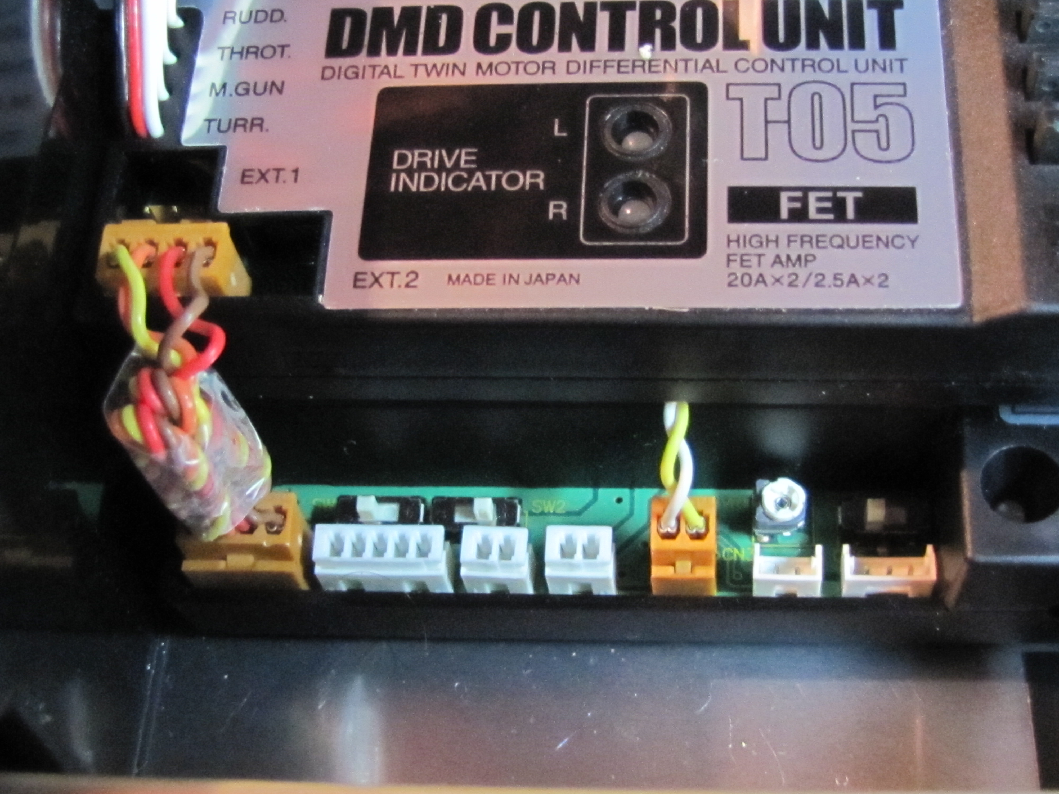

Hi, tankers!
I have a question...
I have Tamiya Pershing. It's working good, it's shooting and receiving hits, but ... it's not dying even after 15-20 hits...
Where could be a problem??

I suggest checking 2 things. First, when you turn the tank on and then plug the GFS receiver (aka "apple") in, it will run like that. Make sure the apple is plugged in, then turn on the tank.
Second, you might have it in 'test' mode. Check the dip switches on your MF unit and verify they are set correctly (dip switch settings will be covered in the little DMD manual that came with the tank).

Flip both switches in.
Here is a page from my RCTankCommand.com website with pix: http://www.rctankcommand.com/before-...er-photos.html
Remember.... like Jeff already said: ALL installations, changes and repairs should be done with the tank off. The Tamiya tank only remembers how it was set at start-up. Don't install or remove a apple with the tank on. Keep you wires and tank neat inside and you will have fewer problems in the future. I further recommend you disconnect your battery to prevent and "wiring shorts" and work atop a wood block to prevent a runaway tank. Safety first.

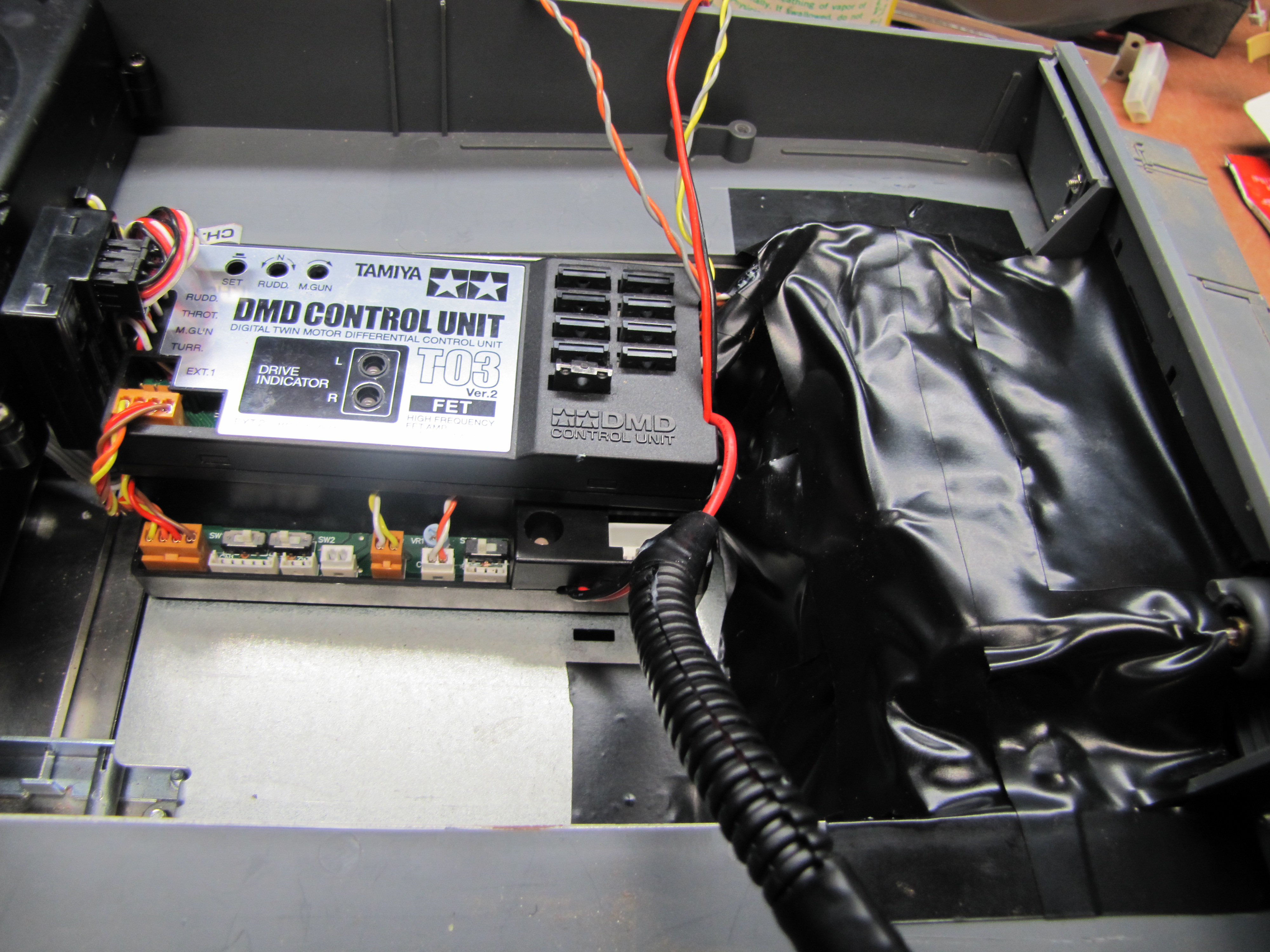

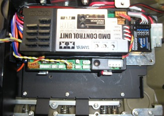

Both switches? I found three - SW1 and SW2 are for recoil and shooting interval adjusting and SW3 - for testing...
Old 10-31-2015 | 06:44 AM
Joined: Feb 2008
Posts: 3,143
From: hillsdale, NJ
SW 1 & 2 should be both in towards each other. SW 3 should be to the left. This will make your tank a "Heavy". That means 9 second reloading and 9 hits until KO'ed.
Heavy: M26 Pershing some others tanks... Heavy tank: Tiger 1, KT, KV etc....
Medium; M4 Sherman, Pzr III or IV, Stug etc.... Both switches "out". Five second reload & 5 hits to KO'ed.
