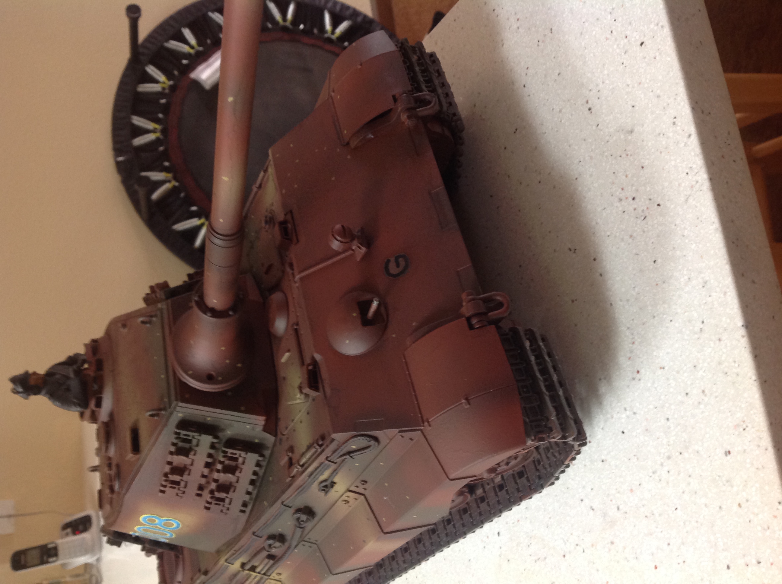

My first german. I engaged very well with green and moderns. This one seems to be more difficult than expected.

Looking good to me! Keep the pics coming.

Heh, The Early NON-DMD King Tiger was my 2nd R/C Tank decades ago. It was considerably MORE challenging than the early Tamiya Sherman but not too difficult with patience. I've got a more "modern' Tamiya DMD KT on my "tanks to build" list for next year.
Your KT is looking pretty GOOD so far. What issues are you having?

Looks great Mario!!!

No issues, just the weathering is tricky

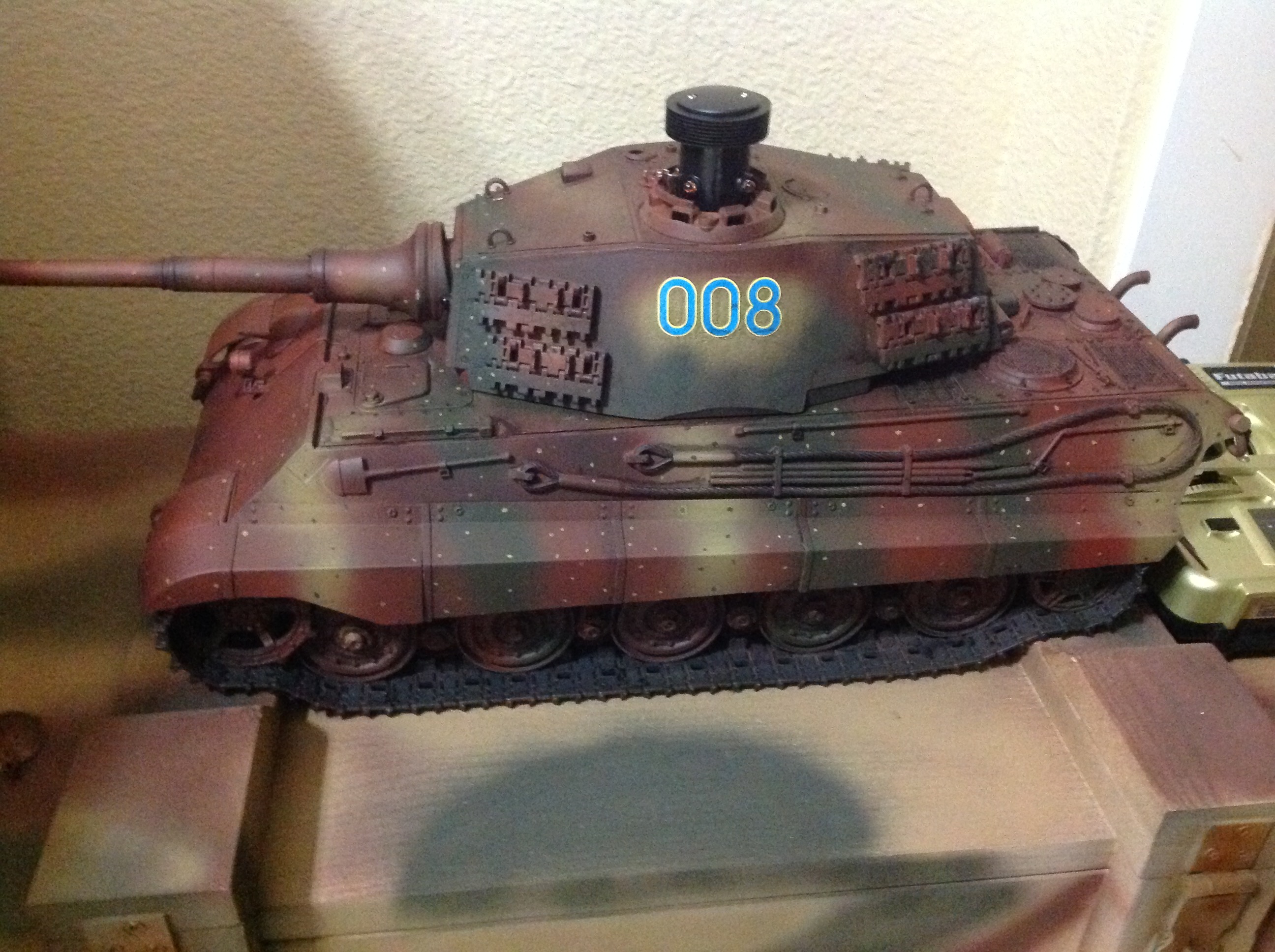

Almost finished

Looks good, I like the streaking. How does it run?

Hi Tanker 10, I use acrylics in the same way that oils.
I have at hand several brands, Vallejo, Windsor & Newton and local ones. As diluter, to replace the turpentine which is used with oils, the Tamiya X20A.
I moisten the surface, usually a full or half panel, then I take a flat soft brush and I moisten too, I take apart few hairs and let them to take Raw Umber from the W&N tube. The rest is quite simple I let the brush fly over the surface up to get the streaks.
Then with other brush you can soften them or make runs etc.
You can do that with any colour, vertical, horizontal...etc.
I suggest to do that after the filters were applied, and before pigments. T
his KT received several filters, very diluted paint. Raw Umber, black...etc.

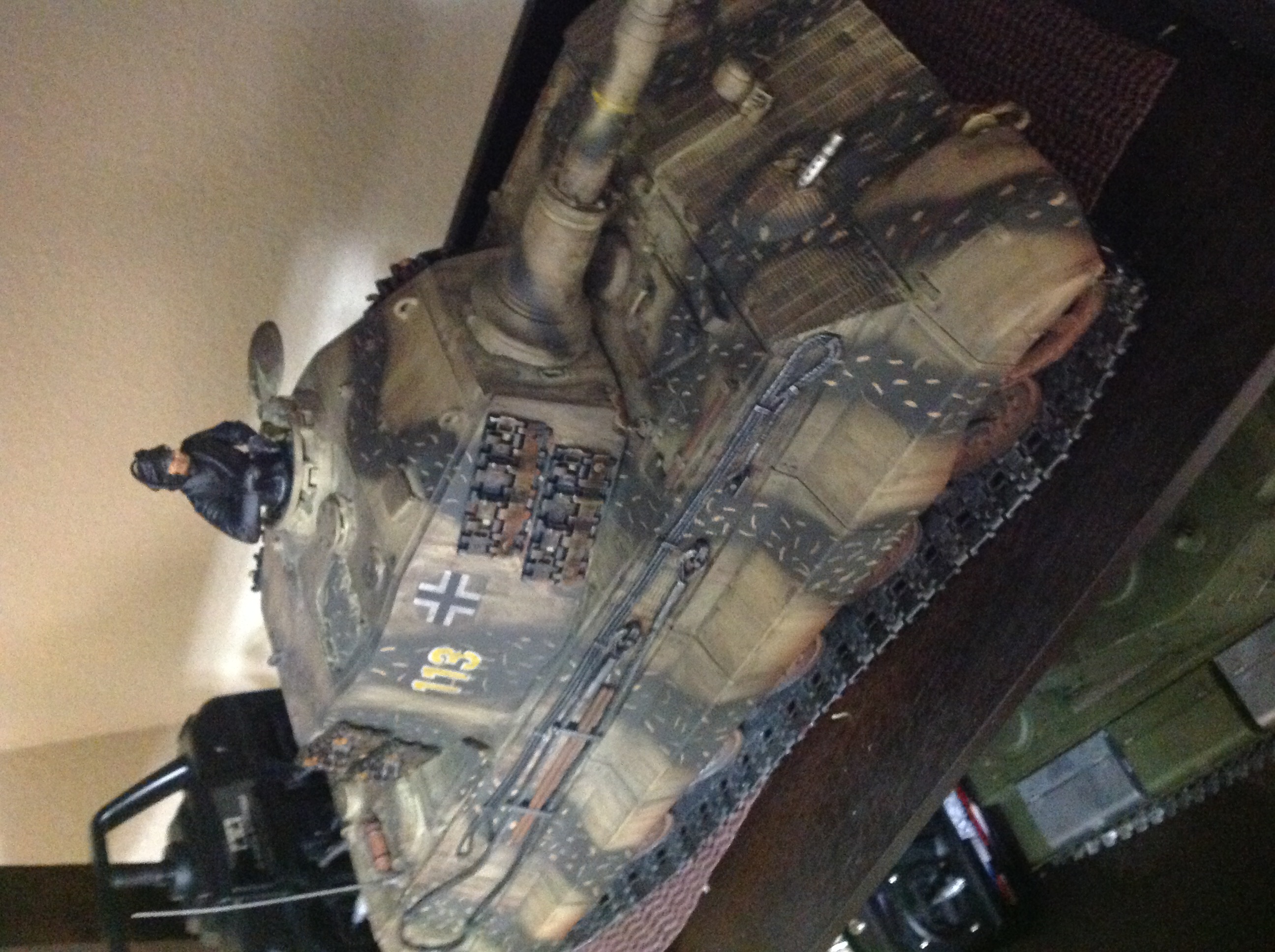

It looks very good. Here is one I did.
And my Torro
