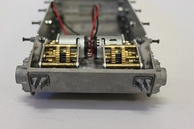

About the Panzer IV, Im using the asiatam lower metal hull, and the sprochet is in correct position (not like que Heng Long, this is rised up about a centimeter) but the bad thing about is that I can only fit the low profile two speed gearboxes, with that tiny motors.
I just added a home made photo of them:
I had no time to test them yet, so I dont know If they will have enought strenght once added all the weight and anyway are very very loud. If the stock heng long motors are 380 this ones maybe 290 or something. Correct me if Im wrong.

@Rad...looking at the motors, the red one looks like a 390, 395 or 480. They're all about the same length and have a lot more torque than the stock 380s. In fact, I have one of each and will be doing some subjective tests with my PzIV to see which I like better. That will take a little while to get to, though.
I considered the Asiatam metal lower when I started my PzIV build. But, it didn't get the best reviews on the European forums with some inaccuracies still there and I couldn't find confirmation that the sprocket height had been fixed. So, I figured I'd stay with a plastic lower hull that would be easier to work with if I needed to fix something. Even with the plastic hull, I found that I could only fit the flat gearboxes if I used the stock motors. I don't think you'll be happy with the power in them. That's what came with my PzIII metal hull and it didn't move it very well, especially not in the grass.
@pedzola...I think the strength of the flat gearboxes is what you already noticed and called out as a weakness. With smaller motors they give the same torque and speed as the stock HL setups. If it can match the performance of a gearbox with larger motors while using smaller motors, then it can outperform those gearboxes if you put bigger motors on them. I have the flat gearboxes in my PzIII with Speed400s and they are awesome! Much better than stock HLs with stock motors or even stock HL gearboxes with Speed400s, especially with the low-end control.
