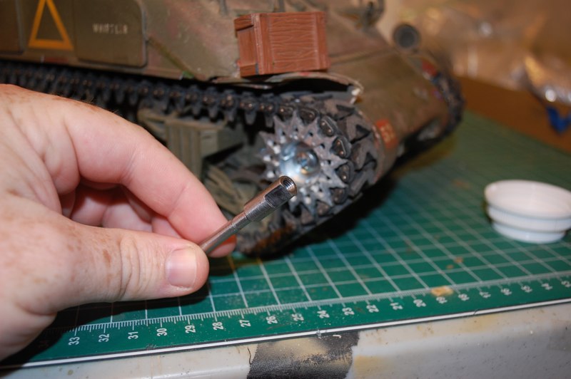

This is what we are talking about. (Although these were made by a DAK member, Sorry Herman)
Before Mato and HL/Taigen we modified the Tamiya gearboxes by replacing the final drive arm. This part works very well for a TAMIYA mod with a bit of work to attache the rest of the bogeys and idler. Mato and HengLong hulls have come along way though. My next project will try a Heng Long hull to save the extensive modification….

No need to be sorry. They solve the problem no matter who makes them. I certainly do not have a patent on them.
Herman
