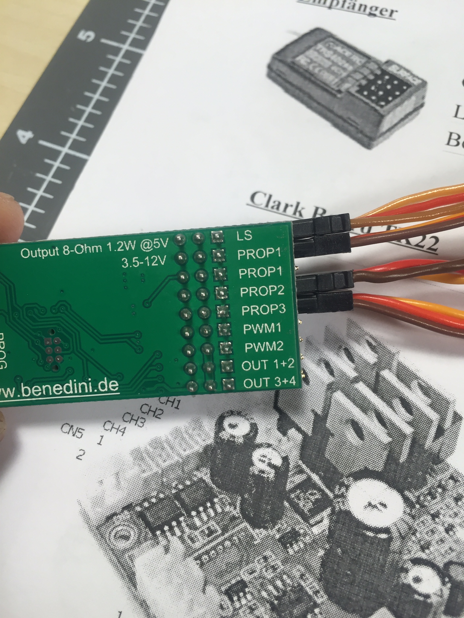

. For the life of me, I cannot figure the TBS mini to my Clark board. I'm using a Turnigy 9x and all is well but I just cannot get the sound from the mini at all. I've looked, emailed, scoured the Internet as well as looking through all the different tutorial videos. I'm stumped...
Here are my connections:
TK22. Rx
Ch1. Ch1
Ch2. Ch2
Ch3. Ch3
Ch4. Ch4
the mini came in as pictured:
I really don't know what else to do guys... Please help

It might be a stupid question, and please don't be insulted, but I've made a bunch simple mistakes over the years by not having the amp hooked up to the battery or a speaker lead loose.

It is hooked up wrong. Where did you get this TBS from?
The TBS has two "Prop 1" locations. Think of them and in and out, Your throttle channel for your radio goes into one of the Prop ones. The other prop one goes out to your Clark throttle channel. This effectively puts the TBS between the receiver and the Clark unit.
You also have to make sure the parameter file is programmed right, and of course you have to make sure the proper sound file is loaded on the TBS.
Just to make it simple I would have the parameter file set to auto start. A quick blip on the throttle channel will start up the TBS sound, Once you get it working then you can look at changing the parameter file to manual start and assigning the start feature to a radio function,
Email me if you need help. When I sell these to people I ask the question what they are going to be using it with. When they say a Clark I do all the programming for them, and it is just plug and play. I take it that you did not buy this from me? I say this because I usually don't let one go out the door unless I know what the intent of use is.. You will need a programing cable as well if you don't have one.
