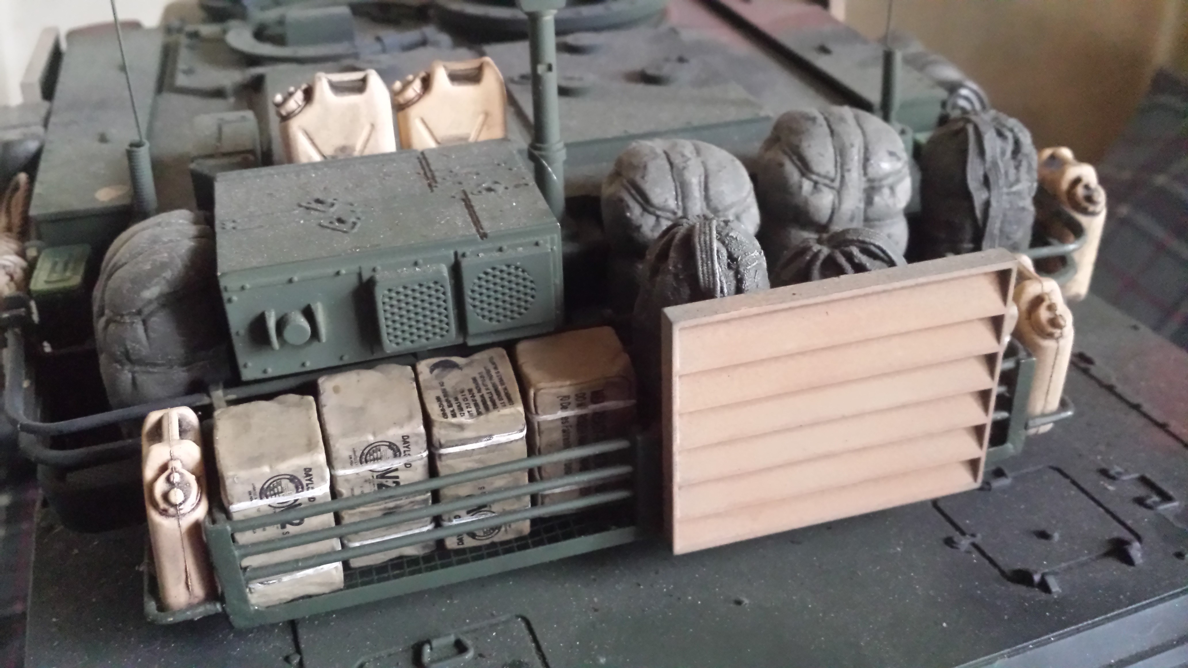

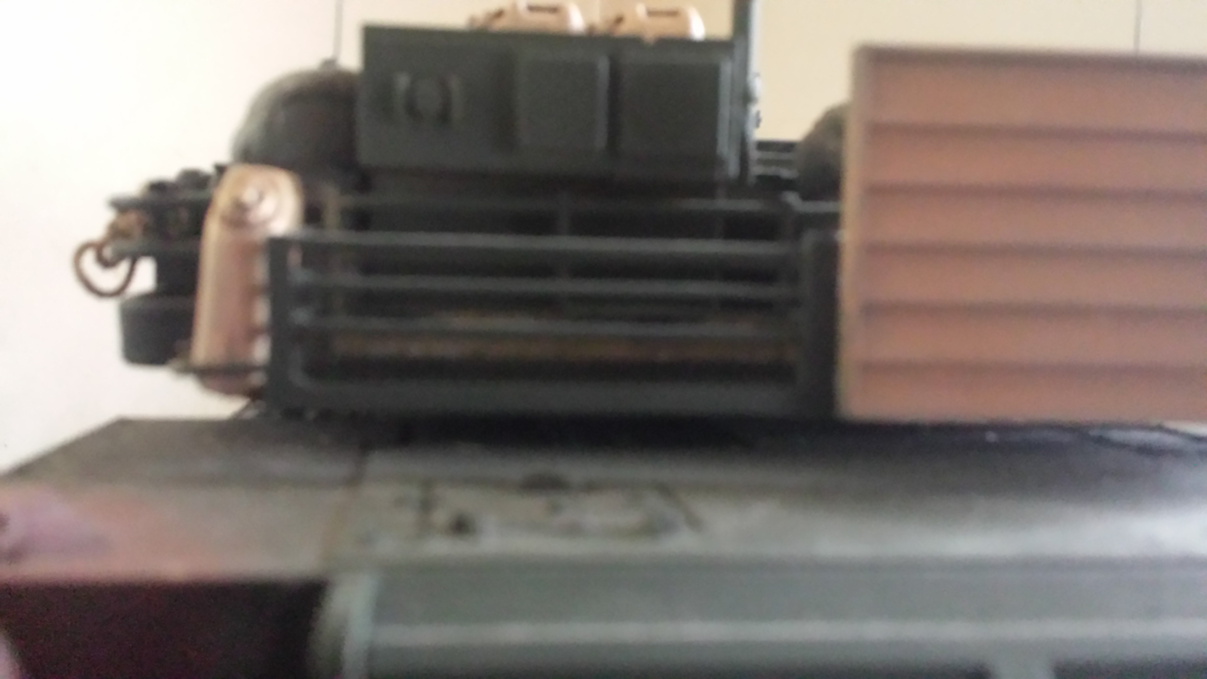

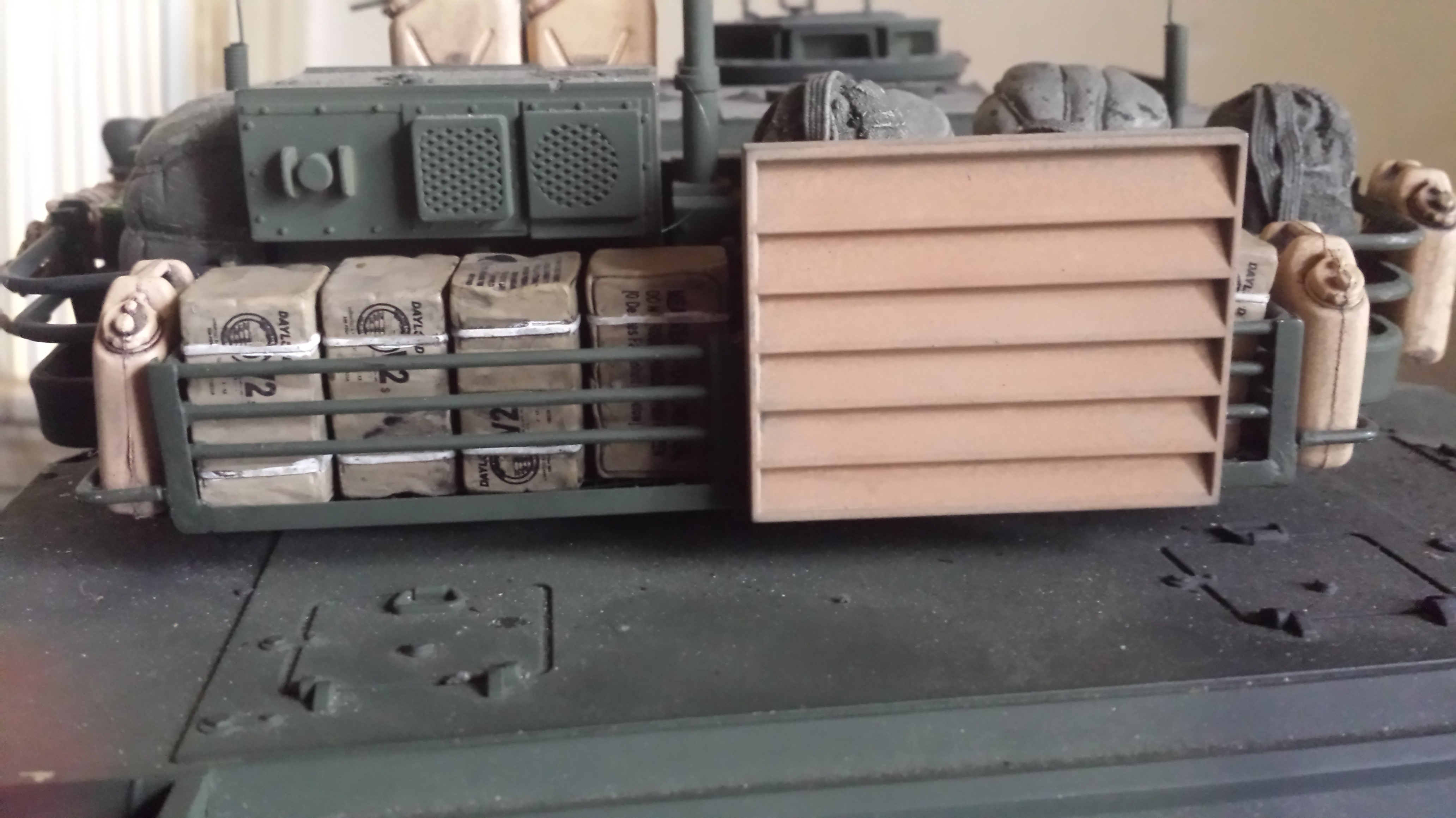

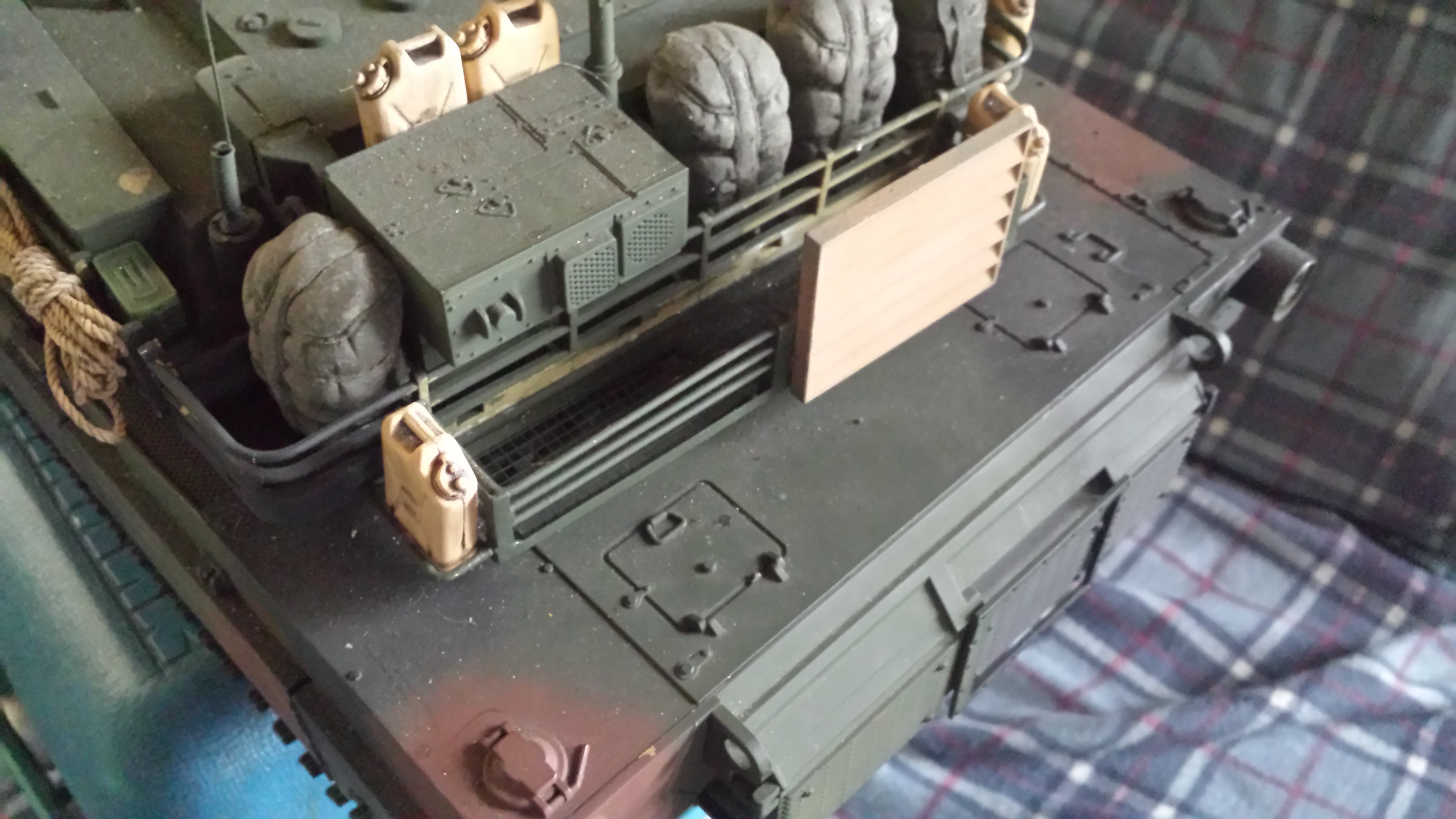

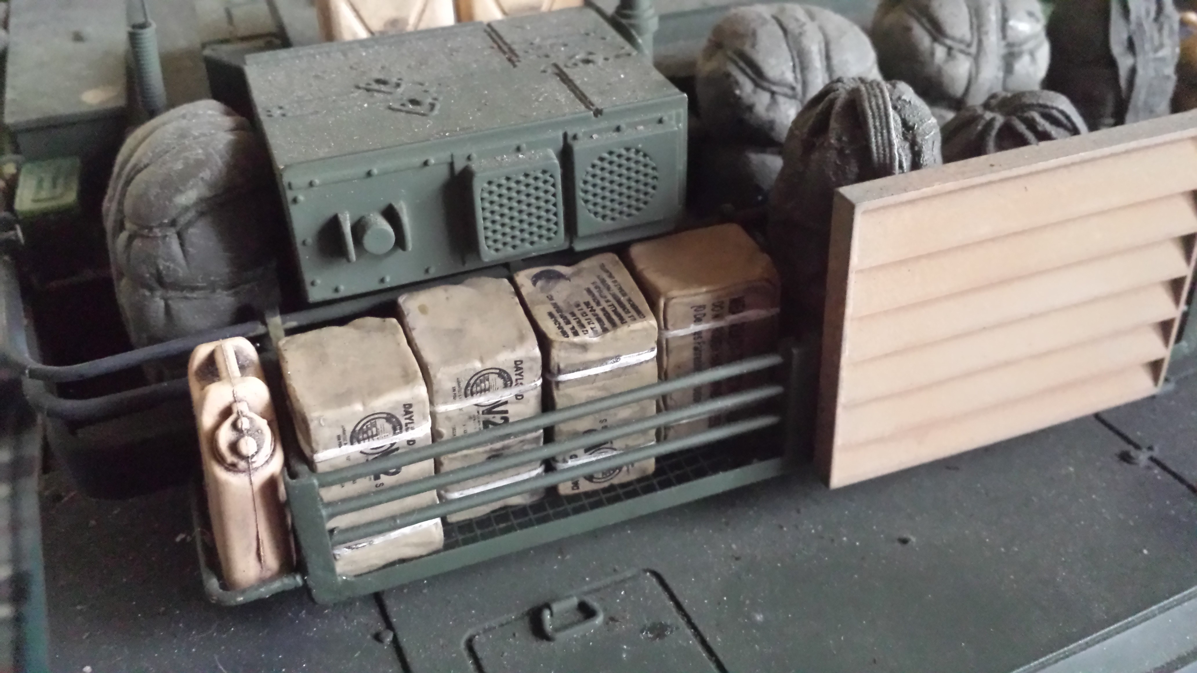

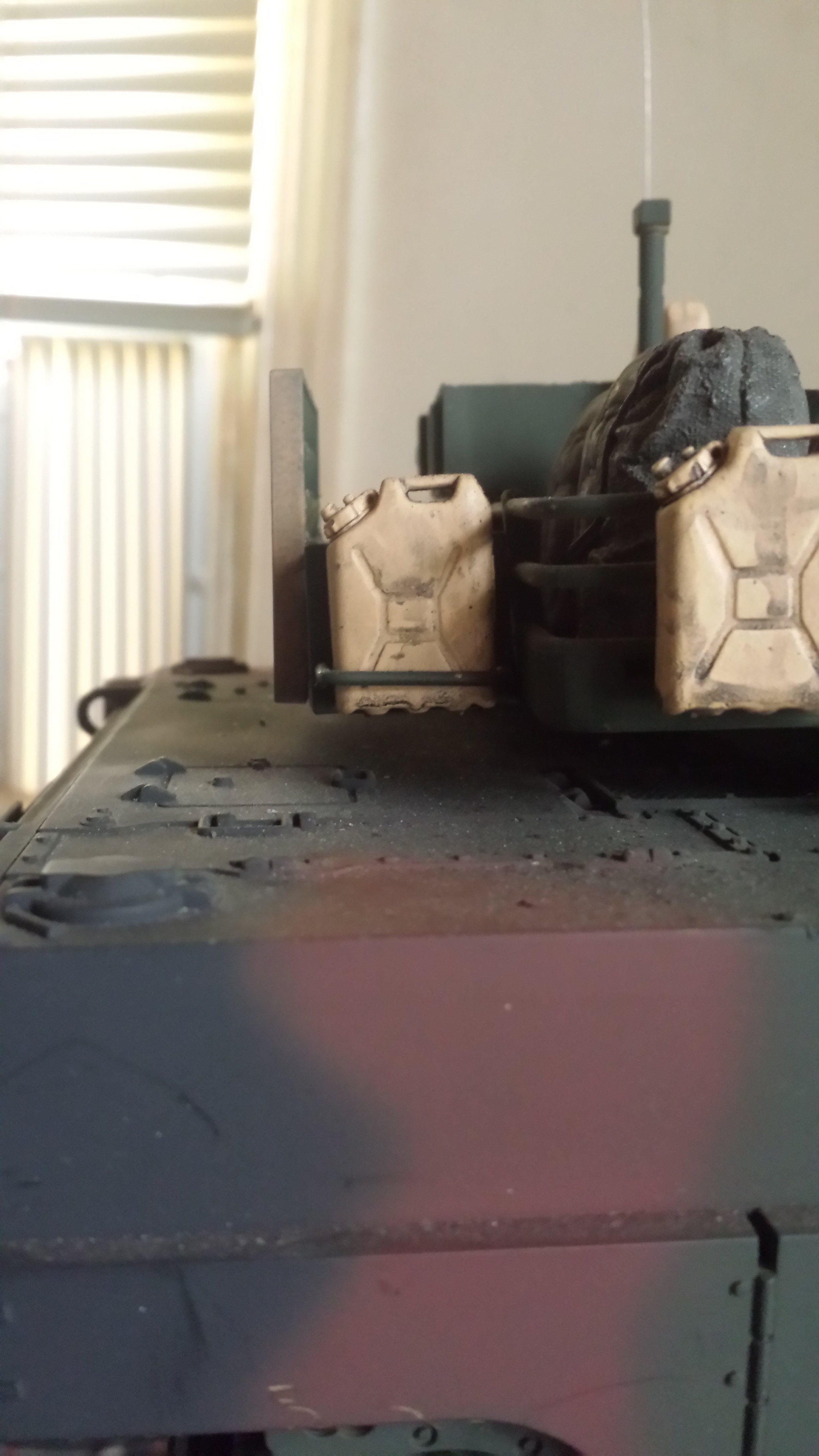

I added a little something to my new Abrams, HL did not incorporate the folding stowage rack on the back of the turret that extends the regular basket so i made my own.

Got any pictures showing how you attached the rack you made to the HL one?
Old 04-04-2016 | 03:21 PM
Joined: Jan 2008
Posts: 5,531
From: Florence, NJ
Well,since it is made of brass rod, angle and screen it really is not that heavy, so i simply removed any paint from the back of the original rack and used some thick CA. How i made the rack gave me very good mounting points to apply the glue since i tried to get very close to true scale with the basket. I thought of fabricating it with hooks at the upper corners to have it just hang fromthe basket but the HL plastic on the top rail is not very strong and i did not want to add too much extra weight to it. So when it was all said and done for me the best way was to just neatly glue it in places that had good structural points. This way when traveling over rough terrain i dont need to worry about the basket bouncing up and off of any hanging mounting points. I should have taken pictures as i was building the basket but never really gave it much thought until I was finished.
i just think it makes the model look much more current as compared to how HL represented it because it is actually an M1A2 not the A1 as advertised.

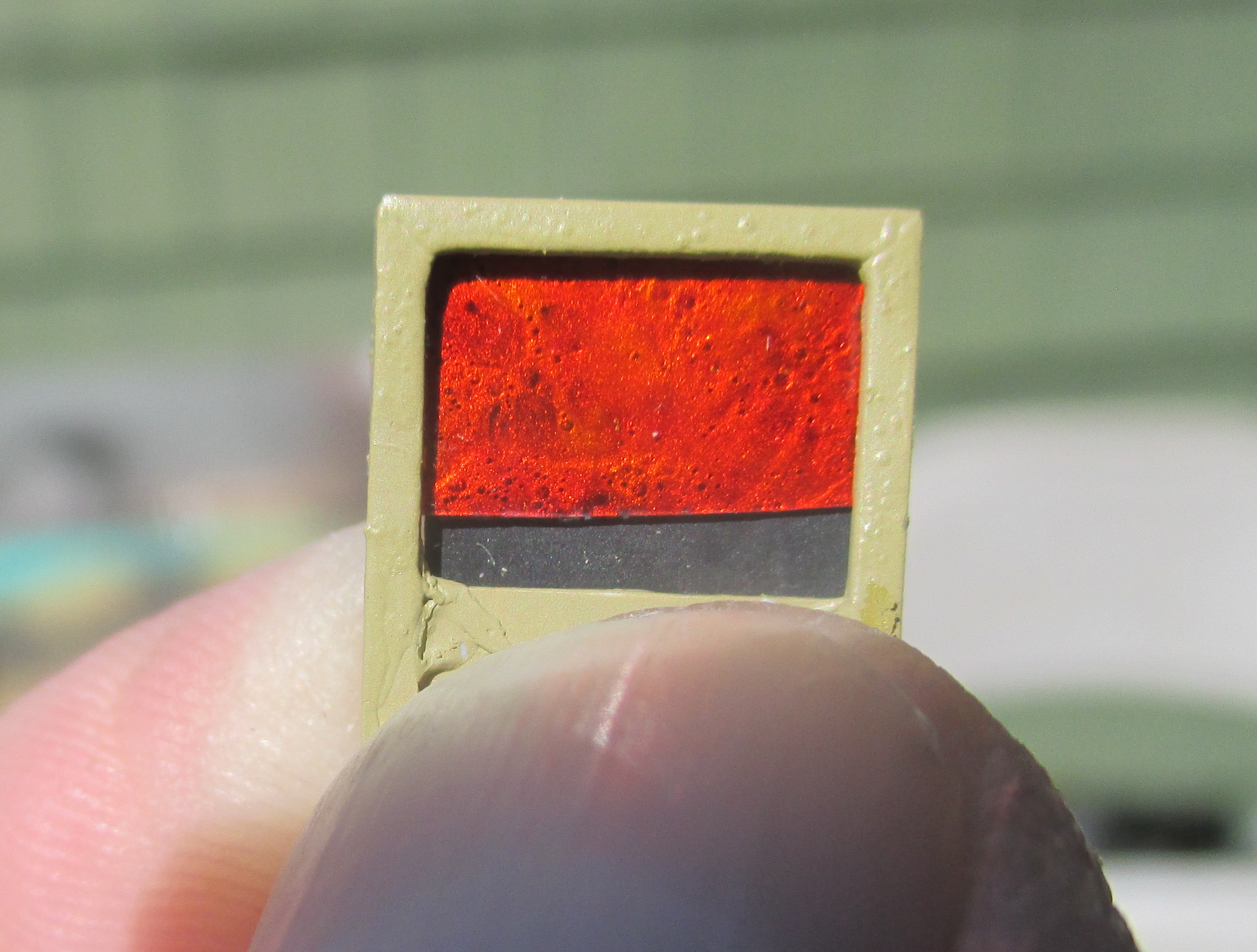

I would like to do the scopes but i havent been able to find a suitable material for the lenses. If you ever actually seen them the have almost a flip flop color between orange and purple and it is hard to find something that will have that effect when the light hits it the right way.

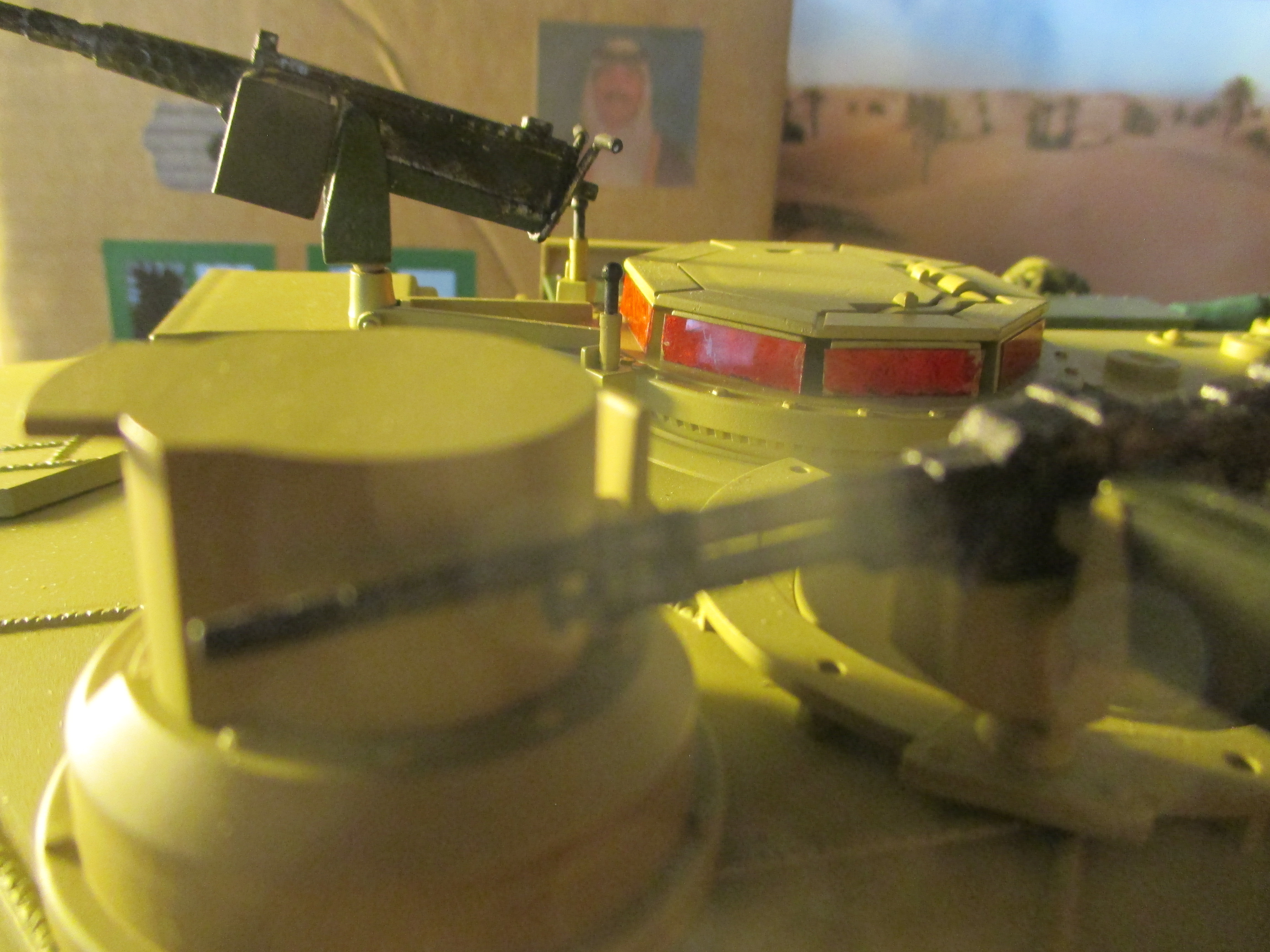

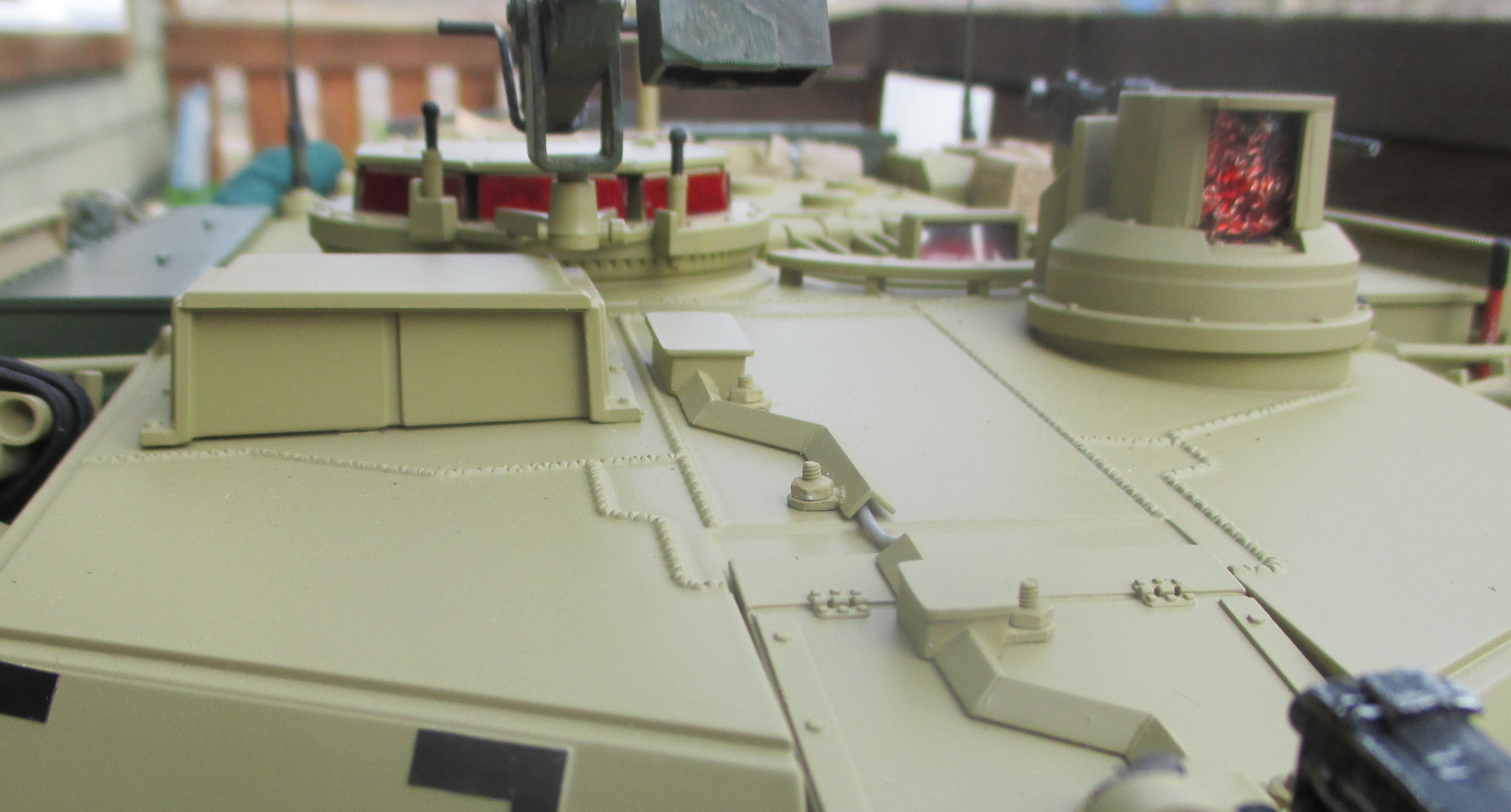

I went for mostly the red/orange color periscopes, but will do the drivers main one in the blue/purple color. I painted Tamiya clear red on a piece of clear plastic, then layered Tamiya chrome silver over the clear red to make a mirror effect with the red color. I did it with a blue color too. Put the un-painted side of the clear plastic to the outside and it looks like this...
They are not done yet, but add a lot to the look of the tank.

Yeah, we are thinking along the same lines. I was going to pretty much go about it the same way. I like it a little on the darker more purplish / blue color so im going to test a couple of different pieces. i have some orange clear plastic sheet that works well so i will try adding some blue tint on the back to see how that turns out.
