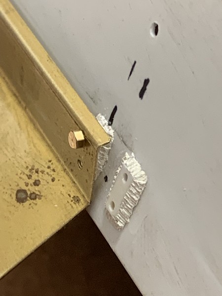

I wanted to make my jagdtiger a little 'schurzen' less' , and at the same push my comfortzone a little on chopping and rebuilding With evergreen.
So about a week of running it Stock, out came the Knife.
off With the molded on skirts.
New 1,5mm evergreen Board on the inside, and a 2mm 'fill inn ' pc in between.
Line up the Outer pc of 0,5mm ( would prefer 1mm, but LHS was out ) evergreen Board and cut to shape .
add a few Ludwigs parts , and this si were I'm at , at the moment .

Did a bit more to see if I could do some fenders on my own eventually.
made a few paper mock ups
Hope to get the lines transfered to sheet metal soon , like this .

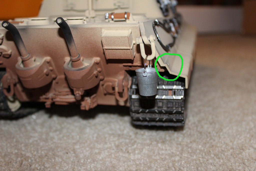

That said, why are you redoing the sides of the hull? angle not right? cutting off the skirts left the hull sides too short?

Philipat, I used a photo from Gary's unboxing of the Jagdtiger to show why sollie had to replace the whole side armor plate. I circled in green what needs to be updated if you want a Imex Jagdtiger without finders. When I get one I plan on doing the same thing. It would be difficult to glue a strip of plastic to the bottom of the side armor plate to extend it to the correct width after cutting off the finders.

Originally Posted by philipat
Most impressive!
angles are right on this one, but the cutting of the upper part of the molde skirst left it to short yes
and on the outside I wanted to use 1 mm, but my LHS only had 0,5mm that had the length to cover the hull side

I had maybe hoped to get away With only a backplate and filling in the cutaway at the front, but once I filled in the first pc, I just knew I had to make a full front plate also to cover my rather poor job. No way any filler would look good no mather the H spent sanding, hehe
Also if only 0,5mm it get's a tad thicker armor sides ;-)
Here you can see the sandwitch of evergreen sheets

Wow, so you didn't replace the whole side panel, you just added extra to the bottom and then covered it with a thin sheet of plastic.
I would be concerned with it flexing and cracking. Is it solid enough?
Old 04-04-2016 | 10:55 AM
sollie's Avatar
Joined: Mar 2006
Posts: 1,384
Received 38 Likes on 21 Posts
From: DRAMMENBuskerud, NORWAY
its a thin sheet of 0,5mm to cover the whole side panel and a 2mm fill in strip.
( To cut the Whole side and replace would be Beyond me :-) ) .
so 0,5mm outside as 'New' side panel , 2mm as fill in , and 1,5mm inside for added strength.
I can tell you taht it's much stiffer, even without the super strukture than it was first time I took it appart, I also added a few 1,5mm strips here and there to stiffen it up

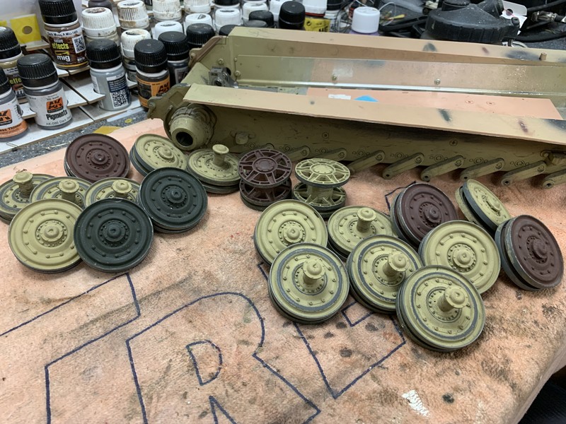

Time flies .. But now I'm back on this kit
Wheels and lower hull now

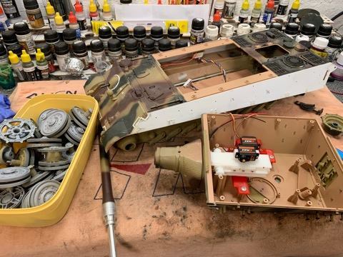

Recoil done . BB unit removed and barrel modified a little bit

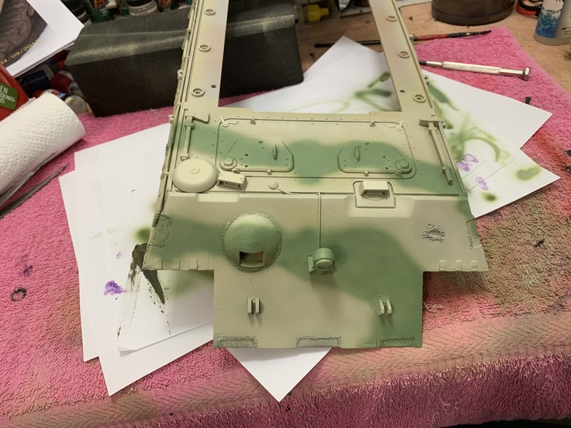

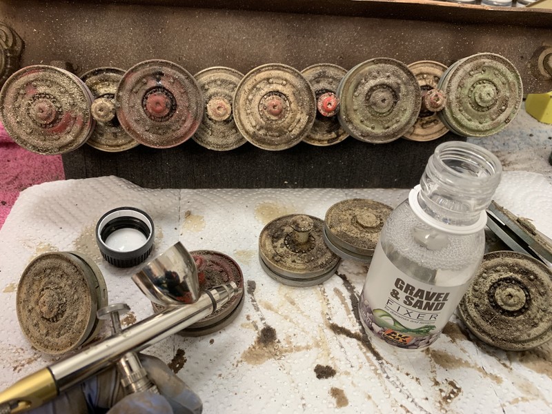

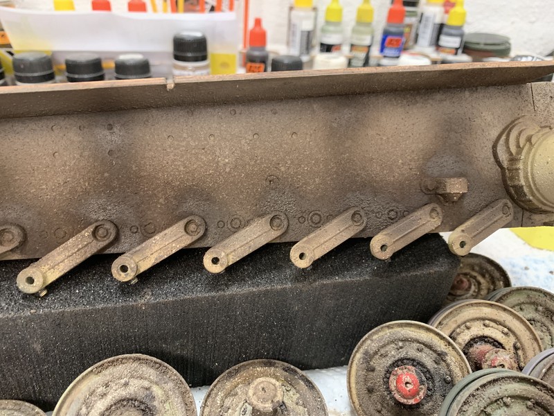

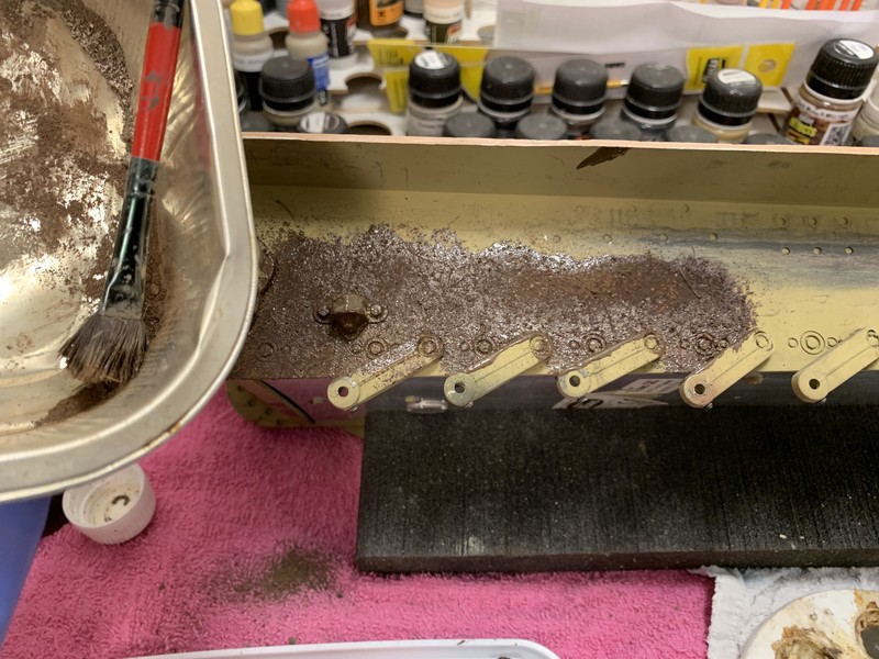

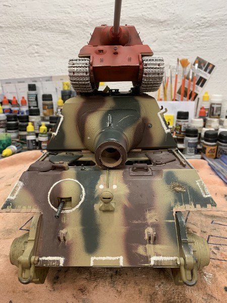

I'm back with some update on my JT :-)

Old 09-27-2019 | 08:02 AM
sollie's Avatar
Joined: Mar 2006
Posts: 1,384
Inside test drive before I started Painting
