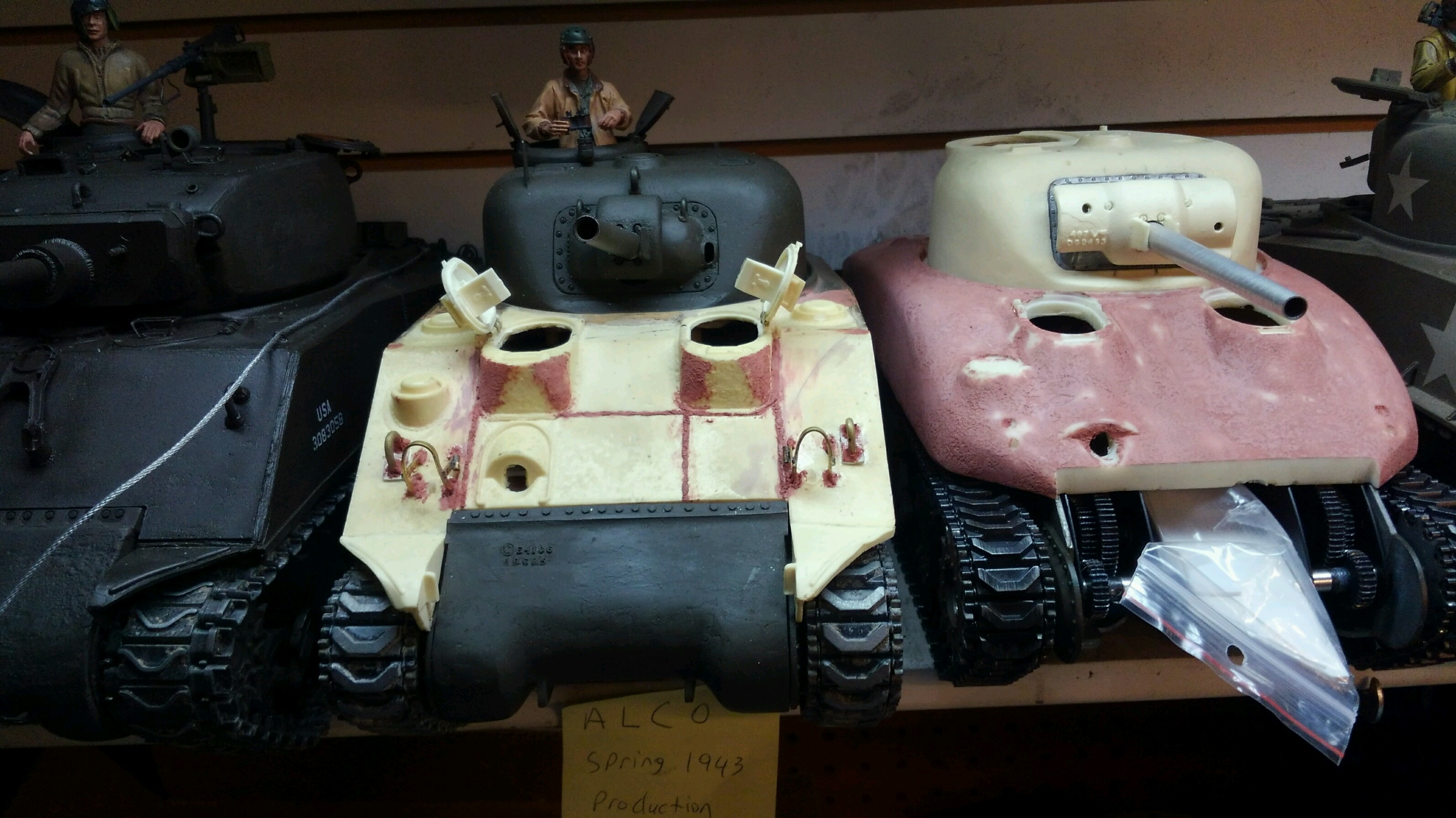

Well, Im working to get this tan finished by the summer D-Day Tank Fest at the LA museum. Its our biggest battle of the year.
Got around to starting all the front detail work. Im scratch building most of it either cause the parts aren't produced or Im just trying to save money and make them myself.
Still along way to go.....

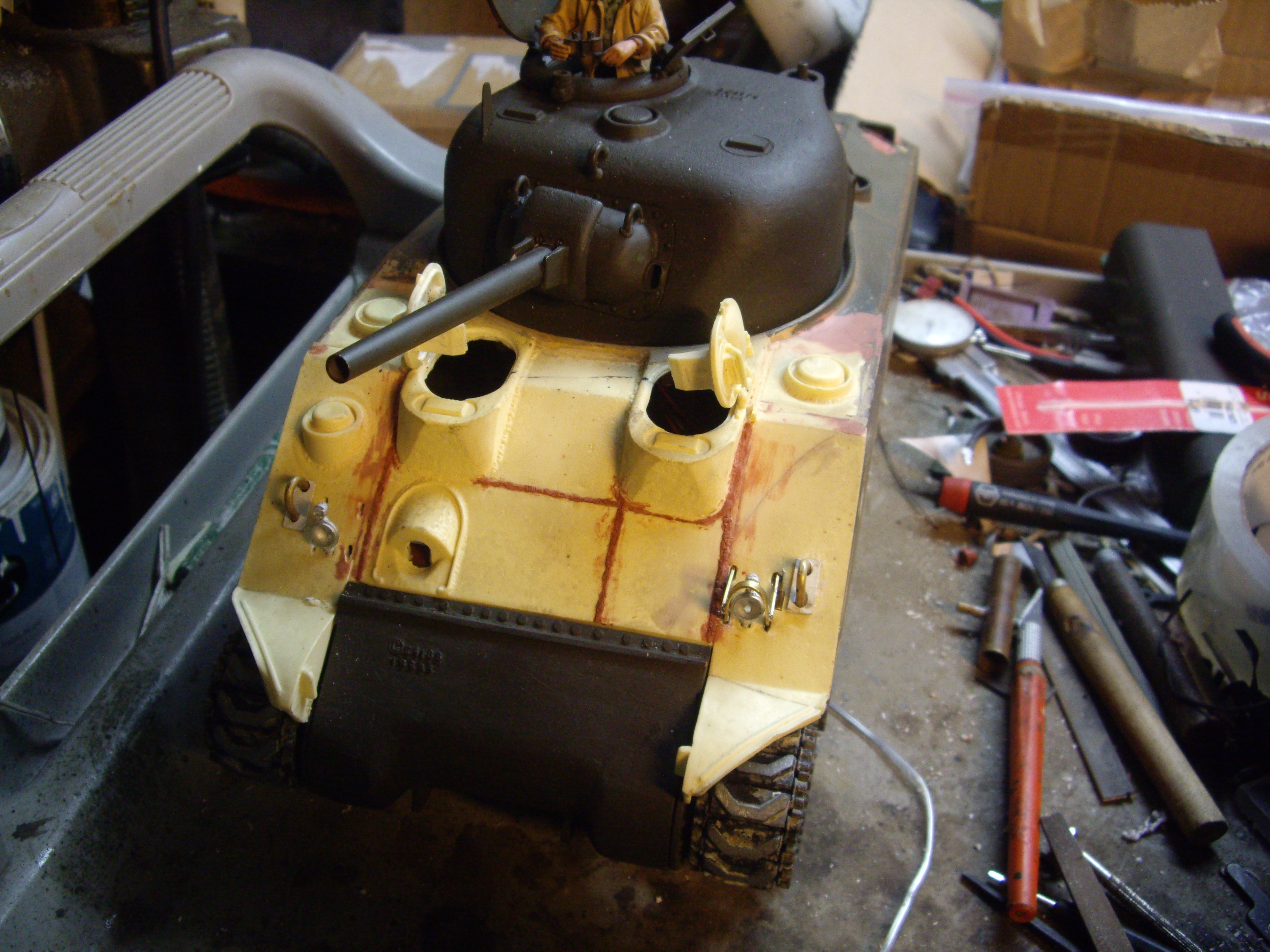

Ok the front is just about done now. I am really happy with my custom made brush guards. The hatches are drilled and hinge pinned now and all the bondo is on. Maybe a tad of cleanup on the weld joints on the brush guards and lift rings and I will move to the back and rear deck work. Trying really hard to get it done by DDay battle.

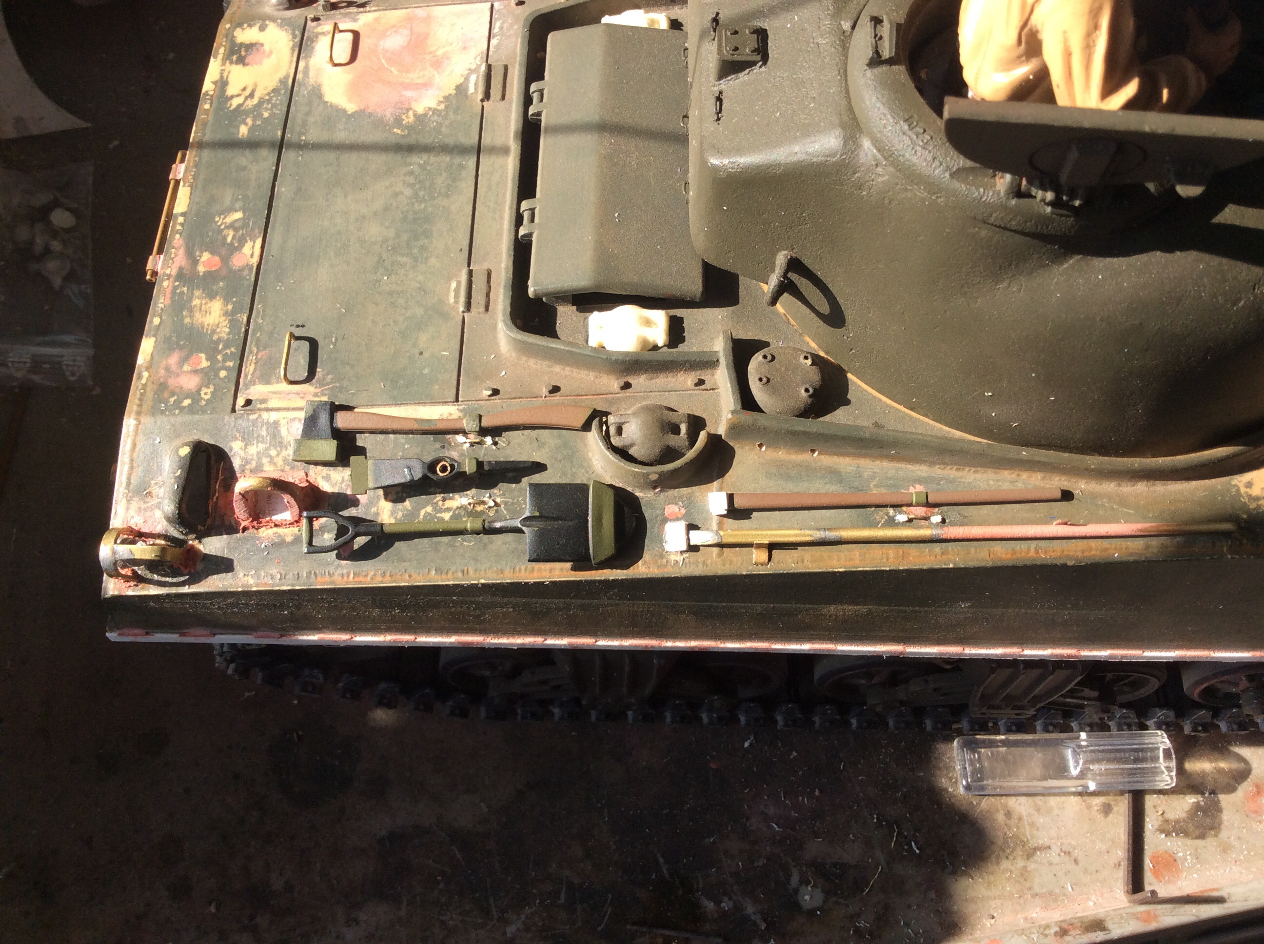

Ok trying the Ipad photos this time,lets see if it works.
got more work done on the tools and rear armor and lift rings and such. So much work to detail out this model. Stil plenty more work planned.

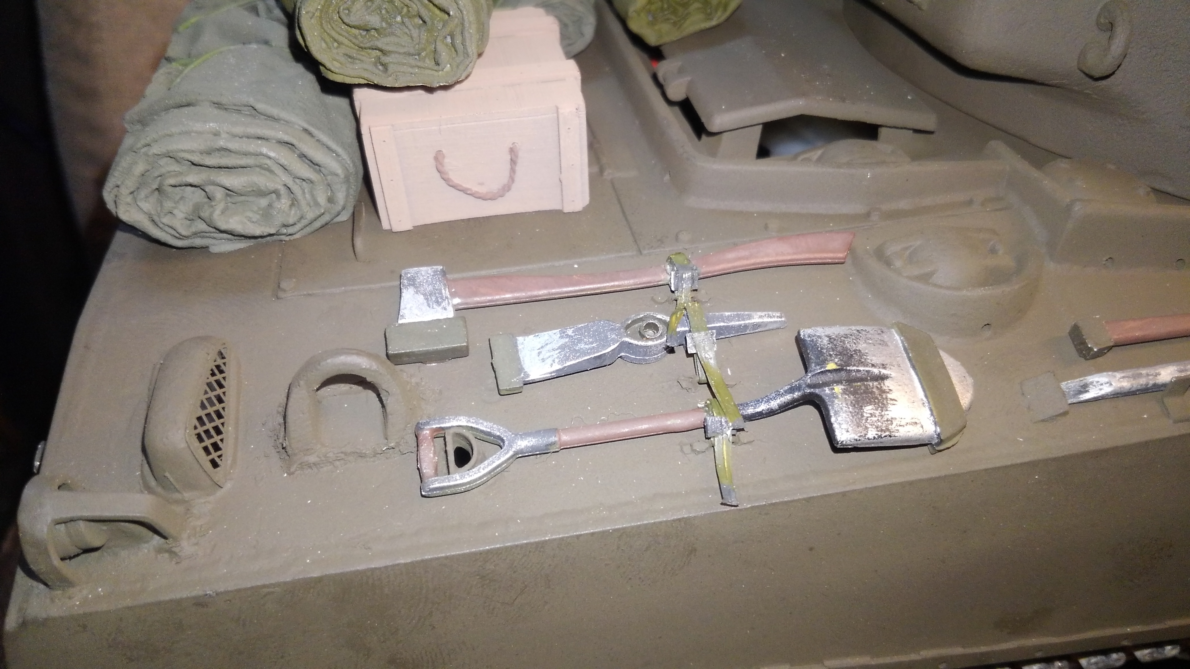

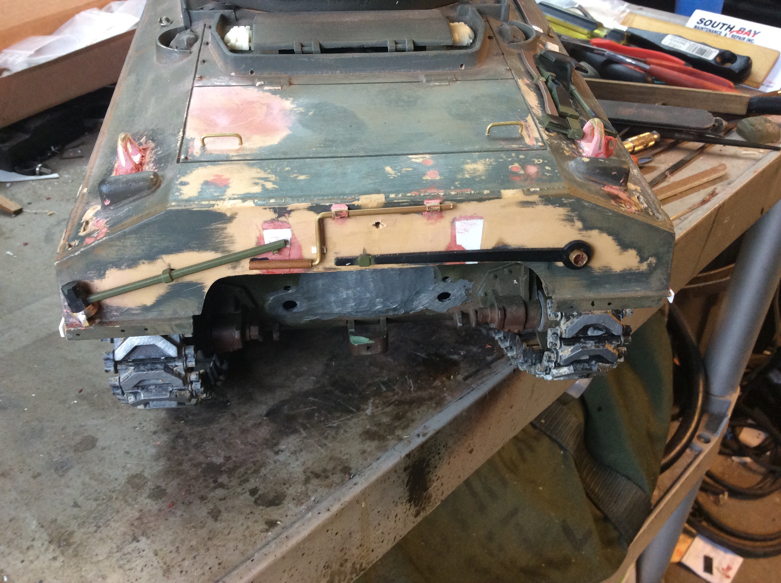

Just about done. Footman loops installed, tool mounting finished. Now just need maybe to make one more footman on the back, need to verify with photos then primer the hull.
still have to finish grinding the a3 door off the rear chassis but that will come while i paint.

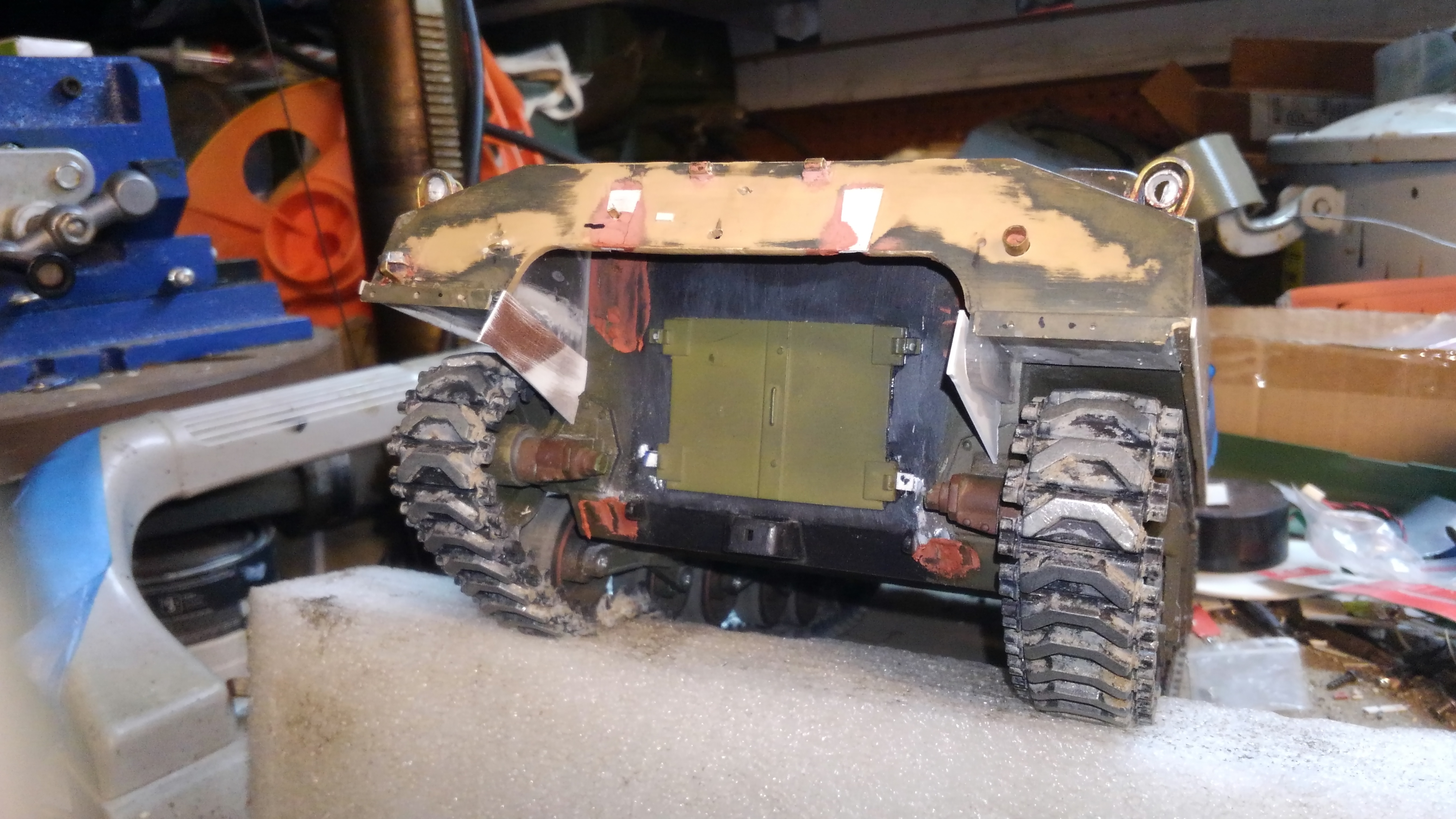

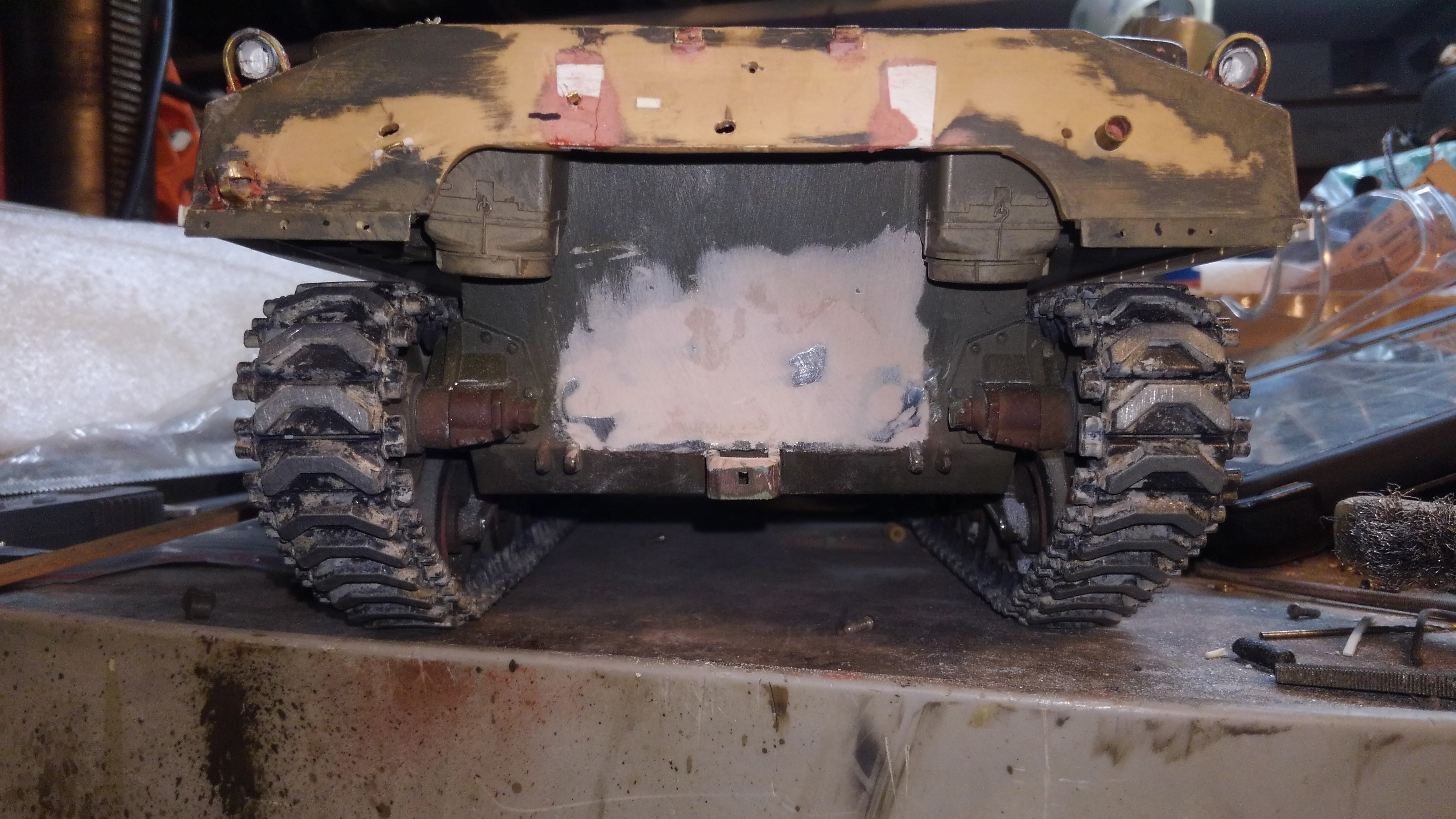

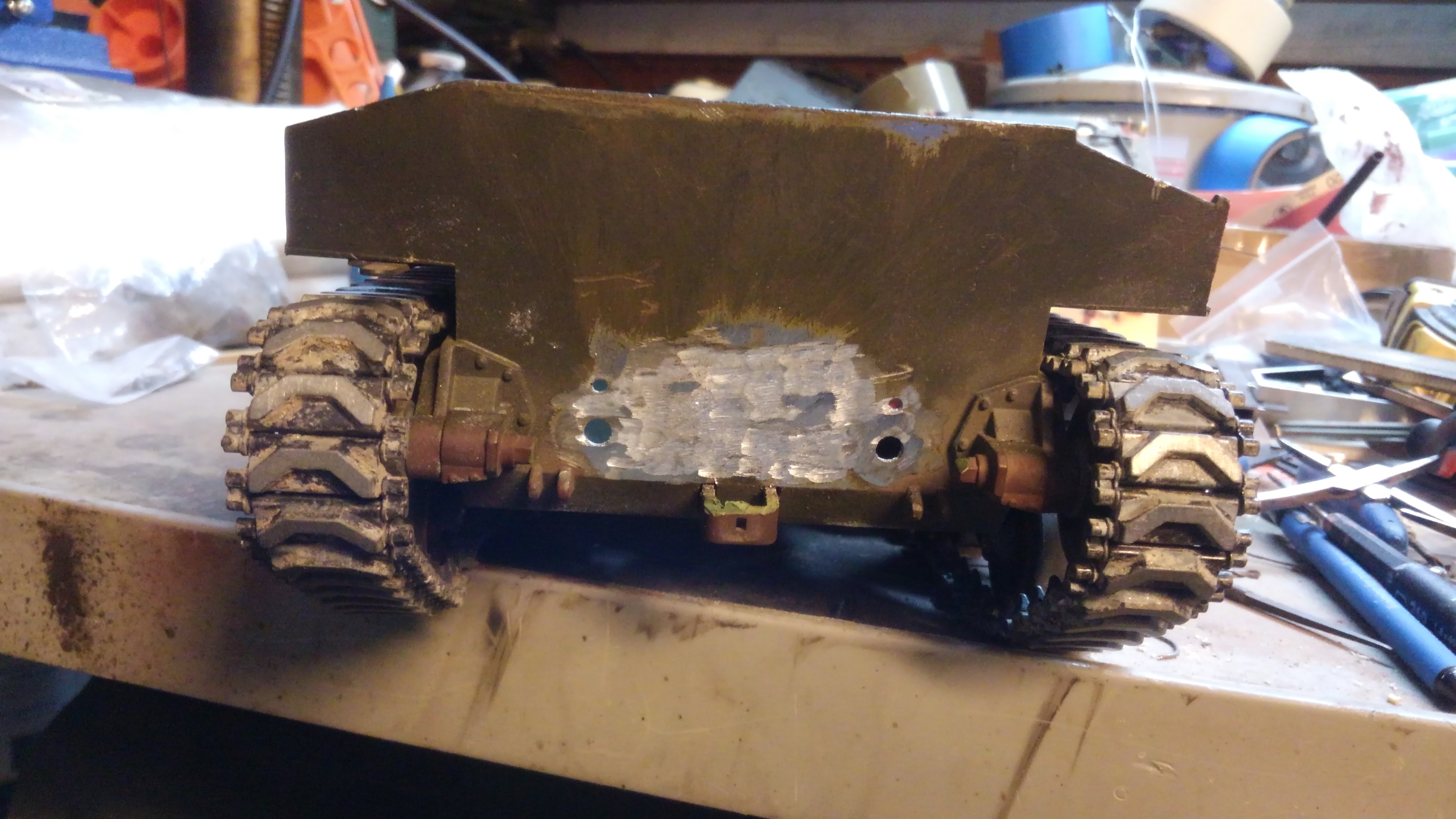

So I finished grinding off the A3 rear engine access door and one of the two tow shackle tabs. Then bondo and sand and paint. I added the rear armor plate on the sides that protects the filter boxes, that was fun as I accidently copied a Baldwin m4 then I found a better picture that was an Alco, so I re made them. I filled in the rear corners of the upper hull by boxing them in more just for support of the armor plate which I used plexi to make. Then the styrene angled pieces are the remanents of the sand shield system. Seems they were welded to the armor plates so they all lasted in some sort of condition to today as most photos show them still there, though usually bent up or cut down. I left them angled hanging out the rear as if the sand shields had been removed recently, it looks odd but that's what they look like.
The filter boxes are Tamiya but Im not using them, Alco had a stepped down cylinder type filter canister so I am going to have to fab that myself. Every time I look at the tank I see more work that needs to get done. Im going to paint the upper hull today, prime really, then paint this weekend. I will come back and fab the filter cans, I don't even have styrene tube that big on hand.

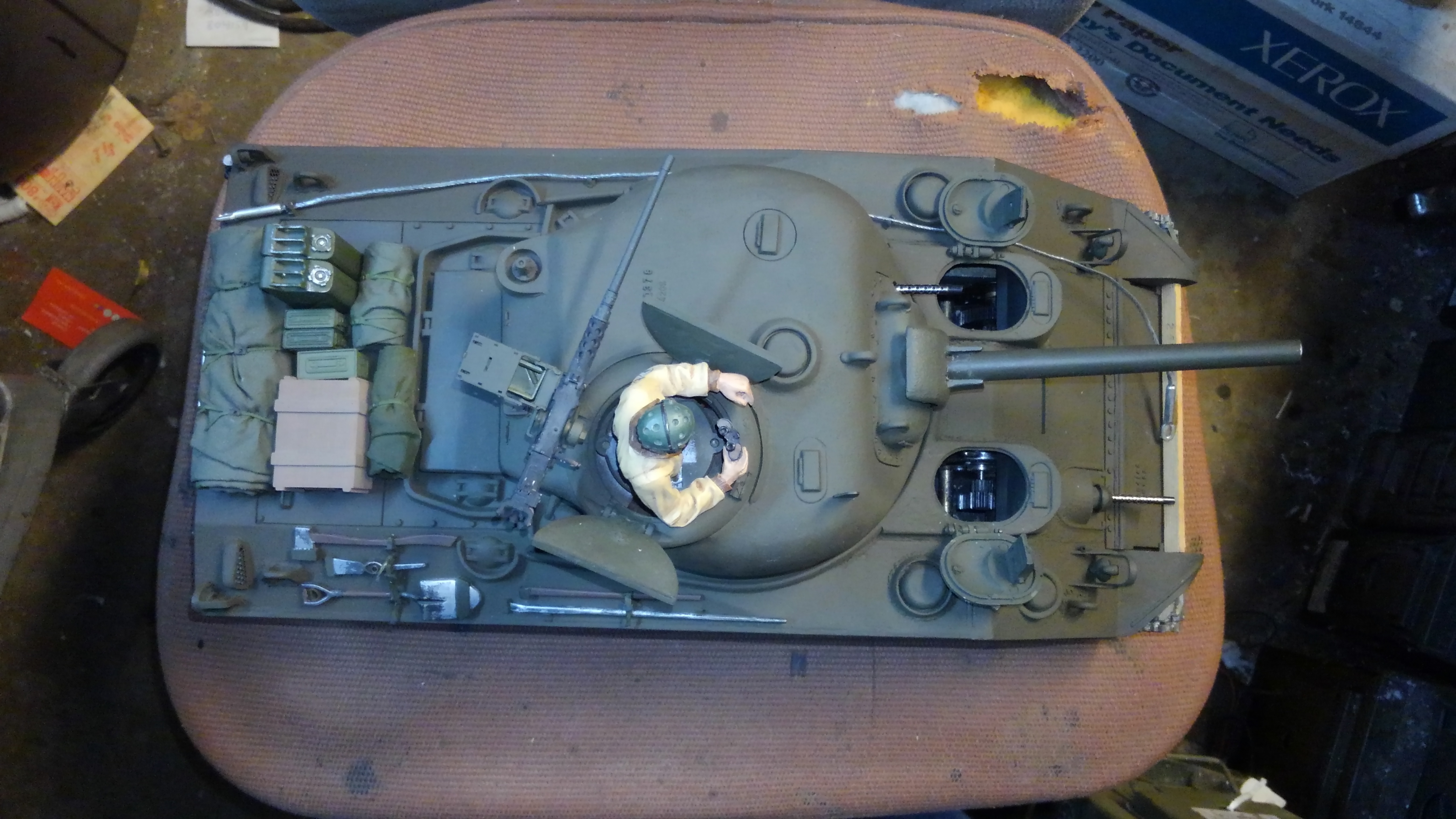

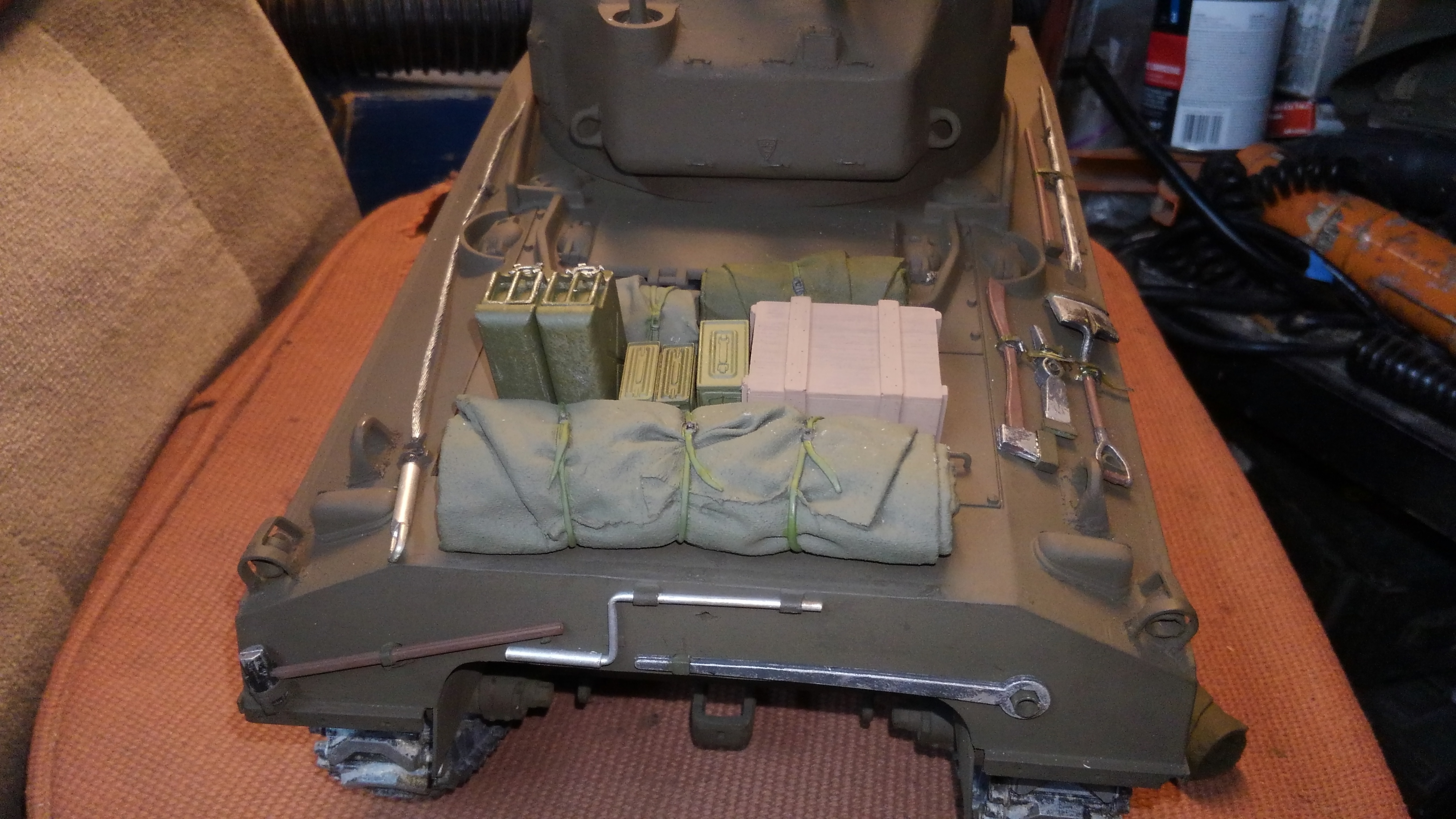

Ok been power building all weekend trying to finish by our big D Day battle at the El Monte Museum for LA Tank fest.
Got my paint job done, my tools installed and strapped and started working on my stowage while I was home. While I was mobile I was researching units to label it.
Im thinking 751st Tank Battalion B co Anzio 1943.
Yes, I have not finished the air filters. I need to fab the oil bath filter housings because they are different than tamyia and I just don't have time. That will have to come in the future.

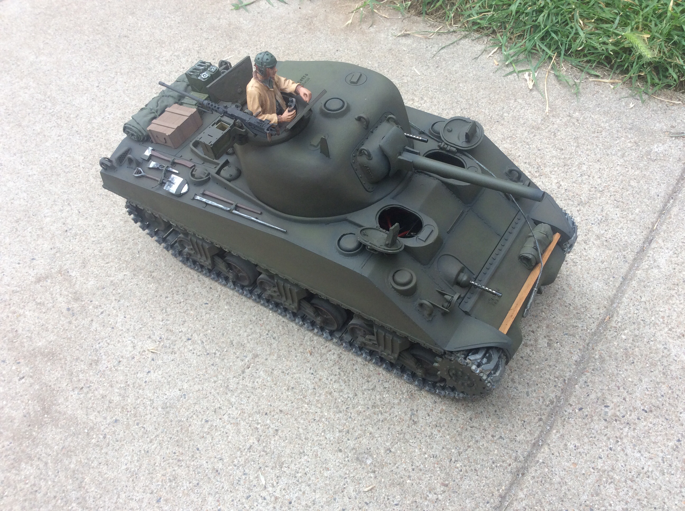

Finished up the paint. Going to do 751st TB. They did not have stars or USA numbers on their tanks, just unit numbers, that will come tonight.

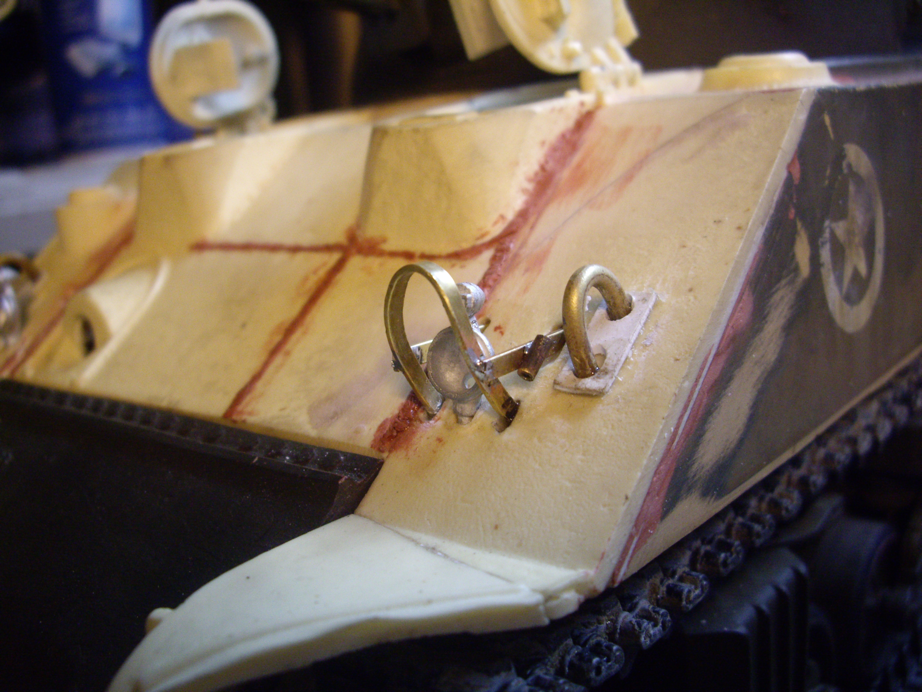

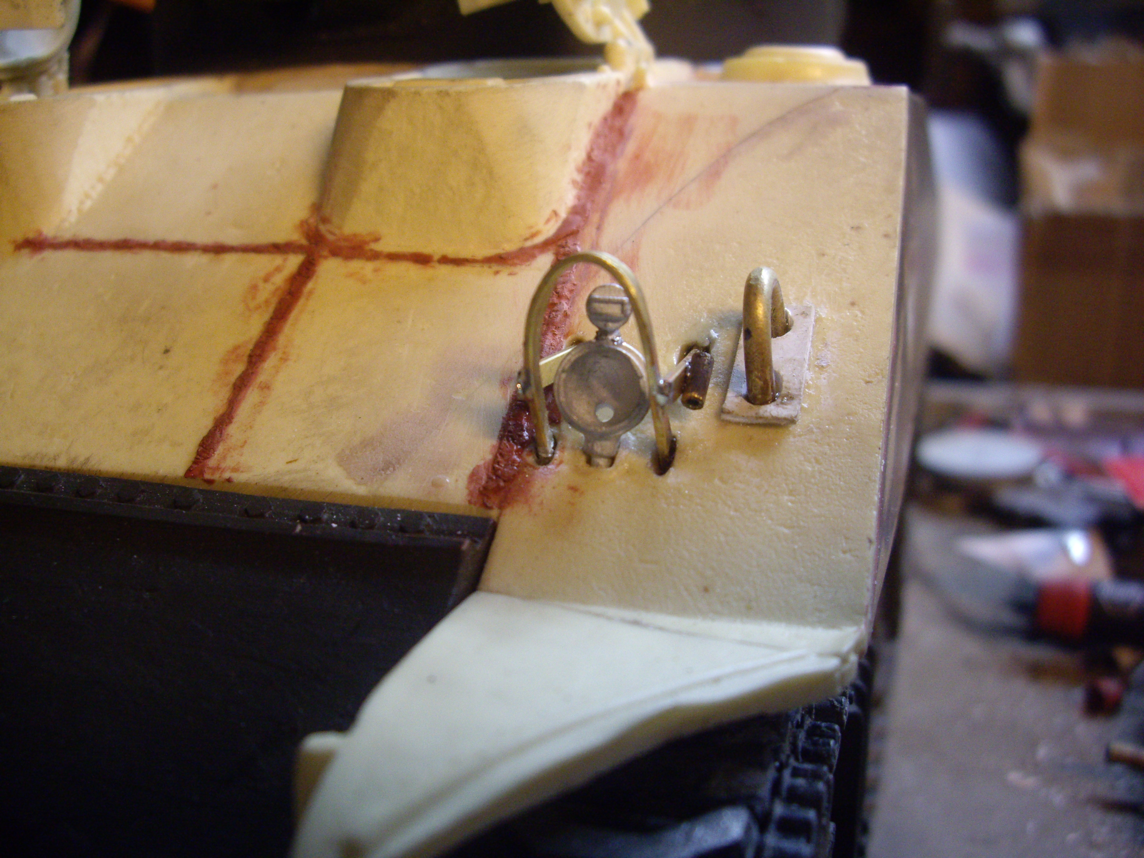

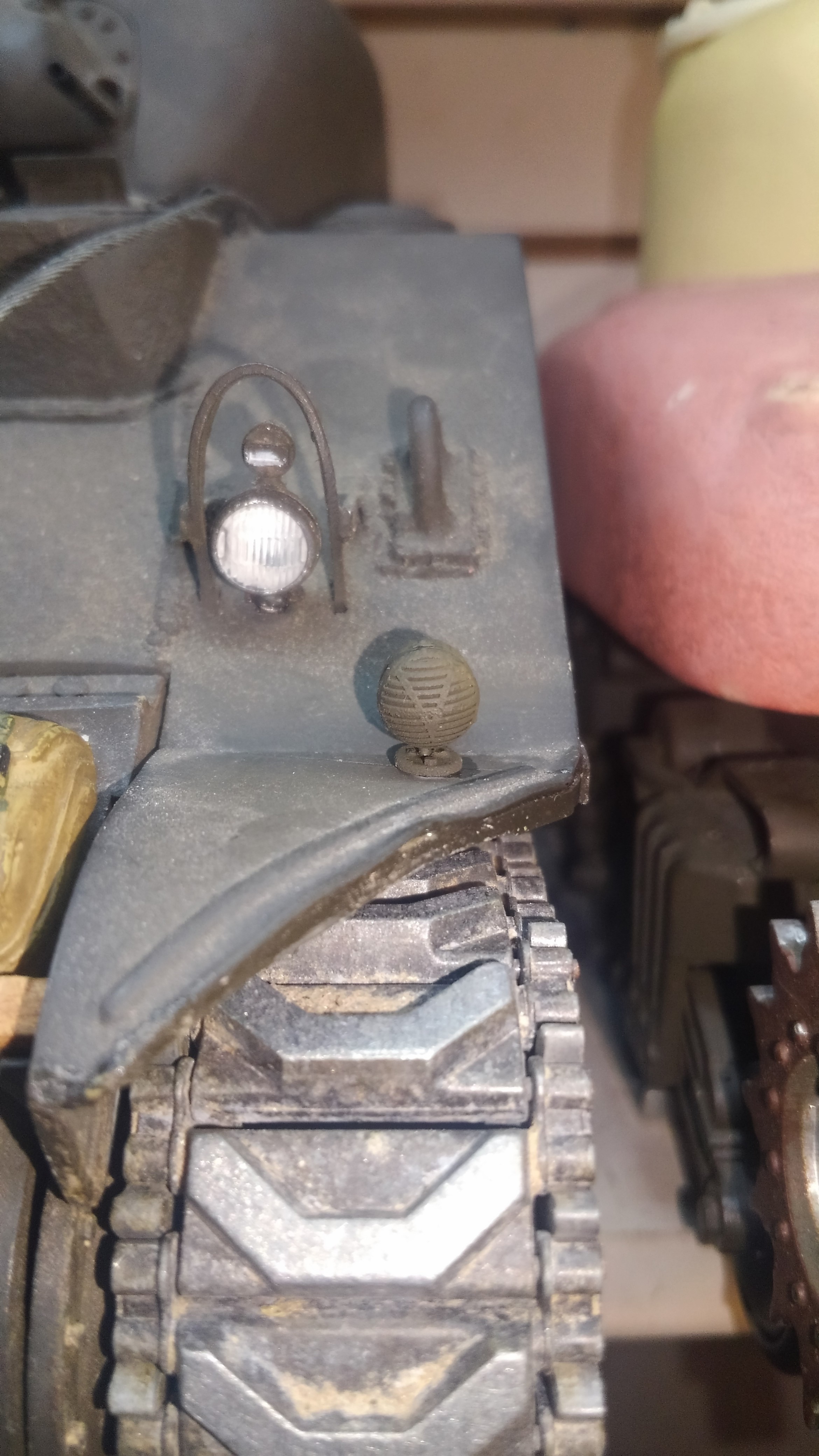

I finally got the siren installed. I had made two different ones that I didn't like and then two weeks ago I cam upon a new item on shapeways. Also found a new addition there of tow shackles for the Sherman so I bought both and got them set and installed. Now, she's done.
https://www.shapeways.com/product/85...li=marketplace
https://www.shapeways.com/product/RZ...118&li=ostatus
