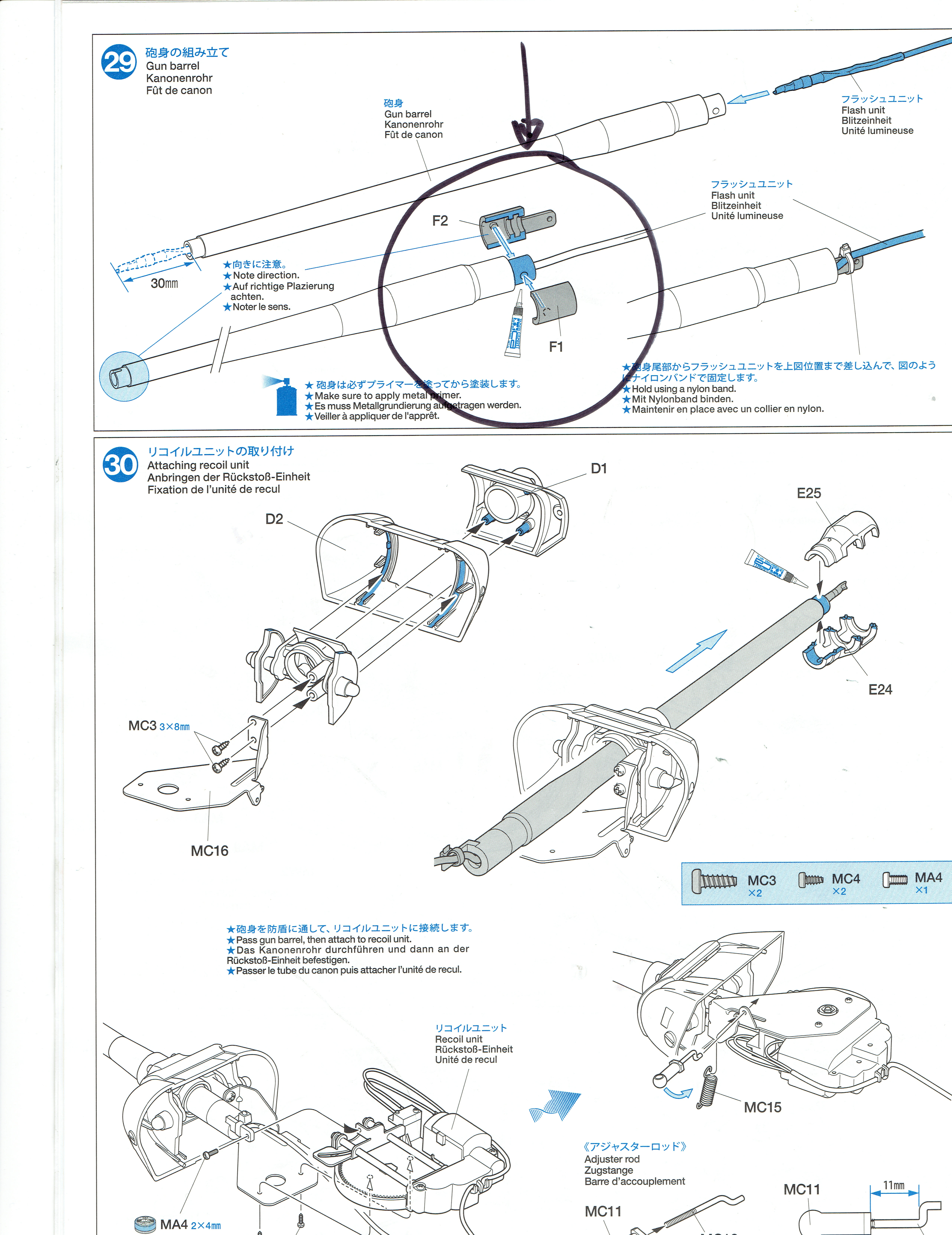

I have a Tamiya JS-2 whose recoil has stopped working.
I have checked all the usual things, everything else works as it should.
No obvious loose wires, jams, interference's etc.
When I fire the the gun the tracks recoil but there is no movement in the gearing assembly for the barrel.
I have checked the wires and plugs.
NO !! THERE IS NO SNOW AND ICE IN THE BREACH OR TRAVEL MECHANISM.
Any help would be appreciated.

I have been attempting to remove the recoil device from the turret but I can not see how to get at the screws on the back side.
I removed the motor and cover from the under side thinking i would try the new motor but there seems to be something restricting the sliding mechanism so I will need to replace the whole assembly.
I put grease on the slide bars but something is stopping it 1/3 from the front.( I will continue to play with the slide checking for bends, glue drops etc.)
My best guess is the plate that slides along the bars is twisted.
Any other ideas.
Wayne
Hi Wayne, take a look at the screw (the brass one with the large head) that is in the center of the recoil gear. Is it sticking up, stopping the mechanism from recoiling or going forward?
If I remember right, I took the two small black screws out of the recoil unit first. They are the ones holding the recoil unit to the bracket.
Also, before you install the new recoil unit, remove that big brass screw and put some loc- tite on the threads. That large screw backed out on mine and was causing some of my problems.
I'm going to go and look at mine again and see if it triggers a thought.
Never mind paragraph two, I see now you can't get to the two small screws. You're just going to have to find a way to get that bracket off. I used a 90 degree phillips screw driver to break them loose and then a long thin phillips.

Wayne,
I recommend you isolate the problem as either electrical or mechanical (if you haven't already)
If electrical, the unit won't do anything. If mechanical, the recoil motor will try to work (you can check this by touching the recoil motor during a recoil event. If it is trying to work, you'll feel it. If that's the case, pop the motor out of its cradle, and then hand cycle the recoil unit back and forth. You can easily bend the metal shuttle with a pair of long nose pliers. Once it works freely, reassemble.
If you need to take out the recoil unit, the recoil stay will need to come loose from the back side of the mantlet. You'll also need to disconnect the black ABS part that connects the barrel to the recoil unit (on the F sprue). Once you do all that, it should come out. Tight, but not impossible.
As to the F1 and F2 parts, I usually can repair them 80% of the time by melting them together using Tenax (which is MEK based). Just give it plenty of time to harden up after you do the repair.

Thank You for your suggestions. ( I was away for the last 5 days, we went North to our cottage and cut grass Friday and shoveled snow Sunday) (Just got back this afternoon. )
I have done all the above.
I took the motor out ( It was not working)
The recoil ass'y only slides 2/3 of its travel and roughly
Then F1 & F2 attachment tab was previously broken into 3 parts, I super glued the remainder to the metal bracket and screw. I would say the ass'y is pretty much trashed by the time I get it all apart. ( I might salvage the screw )
I will try tomorrow to separate the pieces.
I have a new recoil ass'y
Wayne

Reading your explanation below I can not see how the device can be removed once the barrel has been disconnected from F1 & F2.
There still 2 screws attaching the backside of the device to the bracket attached to elevation ass'y behind the mantlet.

I won, I have it back together and it works.
Unfortunately I could have fixed it without buying recoil system. (Oh well EH !!)
Quite often over the years I have fixed many things by taking them apart and reassembling them with good success.
That is exactly what happened this time. If I had done this in the beginning I may not have fried the motor and/or wiring for the recoil.( Since I bought a new recoil I just replaced the motor and wiring and left the old recoil assembly in place.)
The problem was fairly simple but not obvious to me. The turret nose includes 3 major parts which all fit together with the barrel sliding through all three.( Assy #'s 28, 29 and 30 in the manual if you have one D1 & D2)
Inside the turret there is the elevation ass'y then the Turret nose D2 and the exterior mantlet.
All three fit tightly together with the barrel sliding through with little clearance.
The exterior mantlet D1 came loose and bound against the barrel and stopped it from returning to after fire position.
I glued the offending pieces together and now everything works.
Thanks for all the help
Wayne
