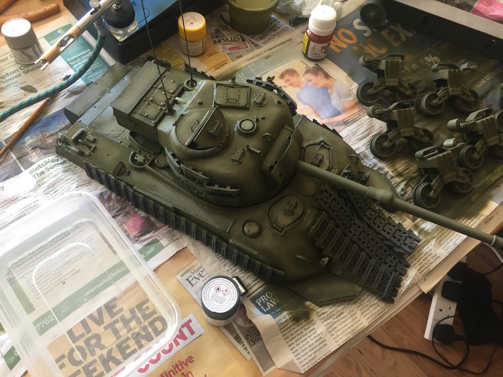

It's been a while since I have had any progress to post about owing to lack of facilities, however thanks to Gary "the tank man" page and his dinner table I've managed to make some progress.
The firefly was bought from flamme with no electronics, provision for recoil or proper elevation. It's on the Mato chassis which is mechanically crude, so an upgrade was required.
I was impressed with the Mato m36b1 so I managed to get forgebear to get me just the chassis
Next up was replacement of the damaged fender, using the old one as a template I made a replacement out of styrene.
A Mato metal mantlet was added. I had to make some modifications however to achieve suitable depression. As the tank will be a battler the ir led tube has been added in place of the mg in the mantlet. To help assist the recoil I've added a brass sleeve to support the barrel
It looks a bit Heath Robinson but it works well and will be finessed with I detail her
The Mato mantlet looks to support the henglong recoil unit, so the dklm one should fit too.
Here's the tank as she sits so far. The upper is all made of resin cast by flamme, the only of the shelf bit is the engine deck taken from an Tamiya Sherman.
The tracks are proper Churchill tracks, and I'm very lucky to have a whole bag of extra links!

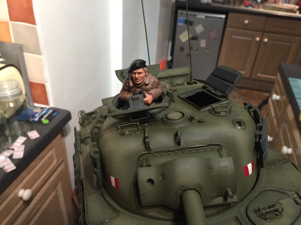

Battle unit and ibus in! And commander courtesy of Fynsdad.

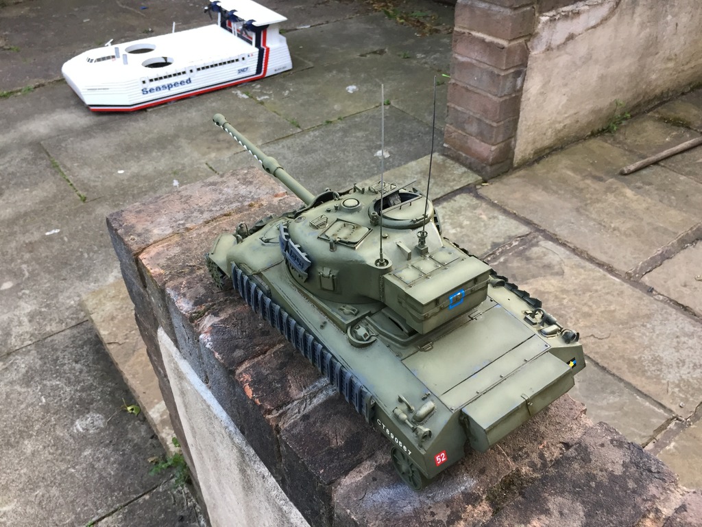

A little update, making the rear a little more radial! Parts stolen from one of my tamiya Sherman lowers. I've made the loaders hatch functional, need to cut out turret but it's getting there!
Hatch
Old 01-28-2017 | 03:22 AM
Joined: Mar 2010
Posts: 2,384
Received 23 Likes on 14 Posts
From: , UNITED KINGDOM
Fitted the perescope guards:
Some work to get the commander to fit
And refitted the appliqué Churchill tracks:

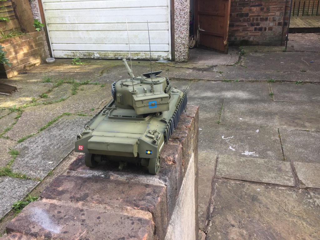

Missus at her mums this evening so time to make some progress on detailing the firefly. Reworked and detailed the rear stowage bin, detailing the turret bustle and the beginnings of the turret bustle stowage bin.
Old 02-10-2017 | 10:24 AM
Joined: Mar 2010
Posts: 2,384
More work complete, I've added detail to the bustle bin, removed the cupola and rotated it so the commander didn't keep bashing his arms, added weld seams to the bustle extension and made an antenna base and guard (which was a monster PITA).

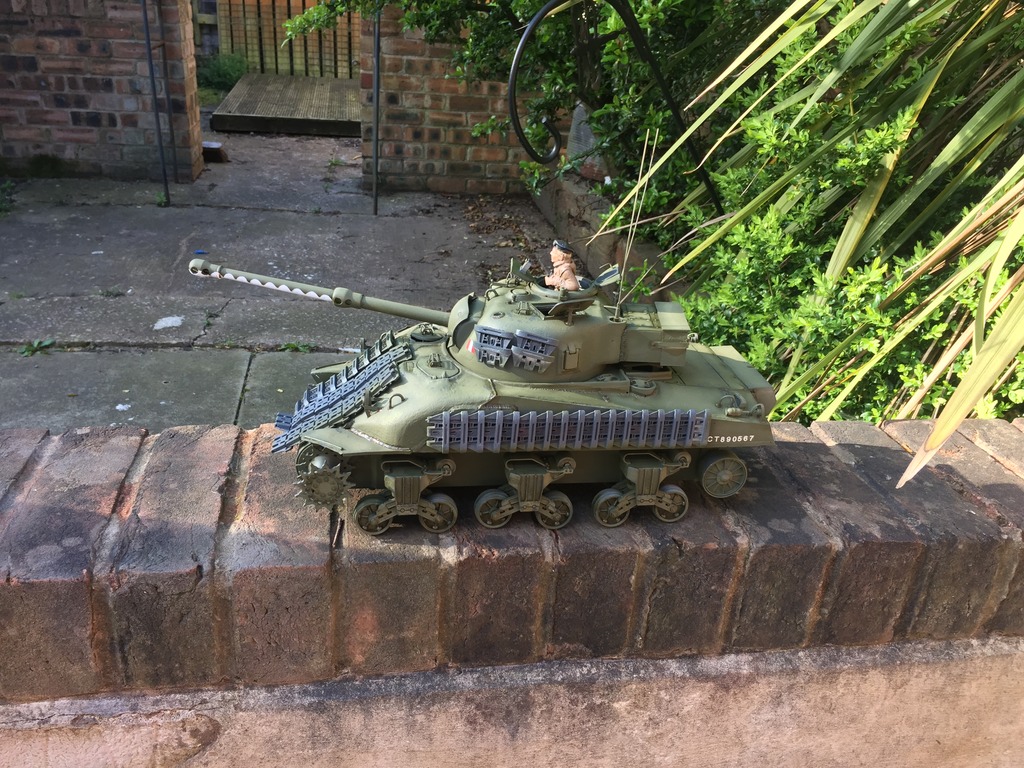

Hey folks, I've skipped ahead a few steps. Finished the detailing, some work on the hatches, added detail to the loaders hatch, fire extinguishers etc. Then started on painting. Primed in grey tamiya surface primer. Then metal coat of gunship grey with hairspray over the top. Green is a mix I got online for British scc 15, modulated adding buff. Then chipped lightly. Filter of sin industries brown for dark green. Lastly a pin wash. Also added decals, barrel camo and added Canadian identification mark. Loads left to do but cracking on.
