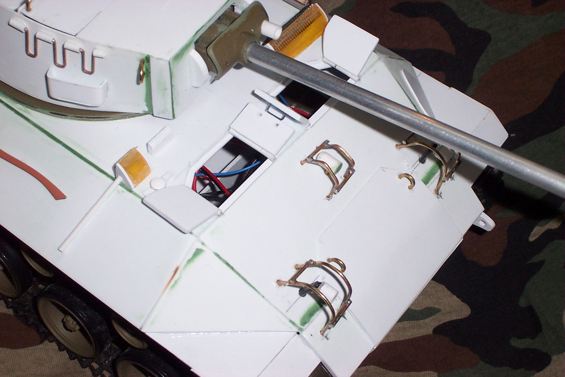

I have a question.. Maybe some one out there has pondered this and can comment...
It is very (Very) early in the thought process, but
I have been thinking of doing an M-18 Hellcat...could the
Walker Bulldog chassis, wheels, suspension, and Tracks
be used for this? I think the upper Hull and Turret and
gun could be 3D printed..

I know there have been a couple hellcat builds on here... Do you know what chassis they used?
Personally I think styrene for the upper hull and a proper metal or styrene barrel with a 3d printed turret, muzzle break, and detail parts would be the best. Stronger hull and smoother barrel for recoil, with nice detail on small parts and turret. Just printing it all could be faster though.

Here's a Hellcat build on another forum that can give you some ideas. Bulldog chassis; styrene upper hull; and Nick Aguilar's resin turret. http://www.rctankregiment.com/rctank...hilit=hellcats

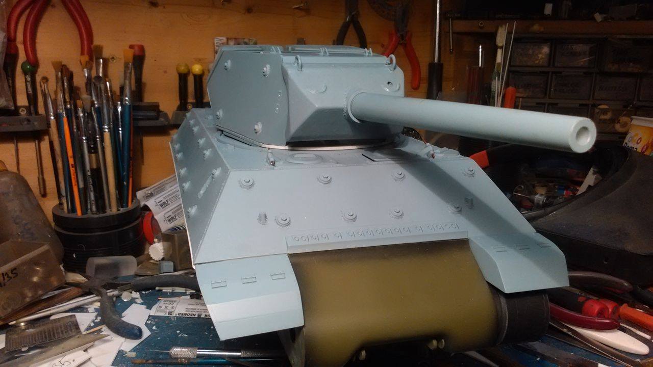

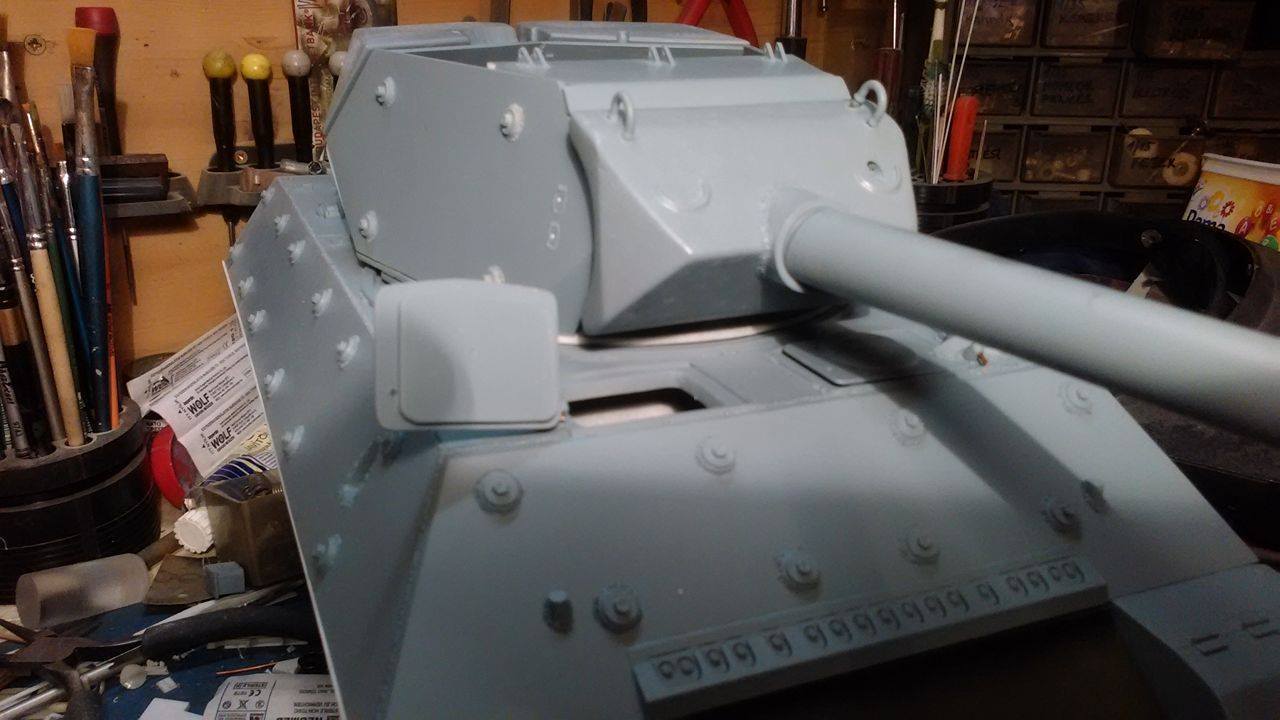

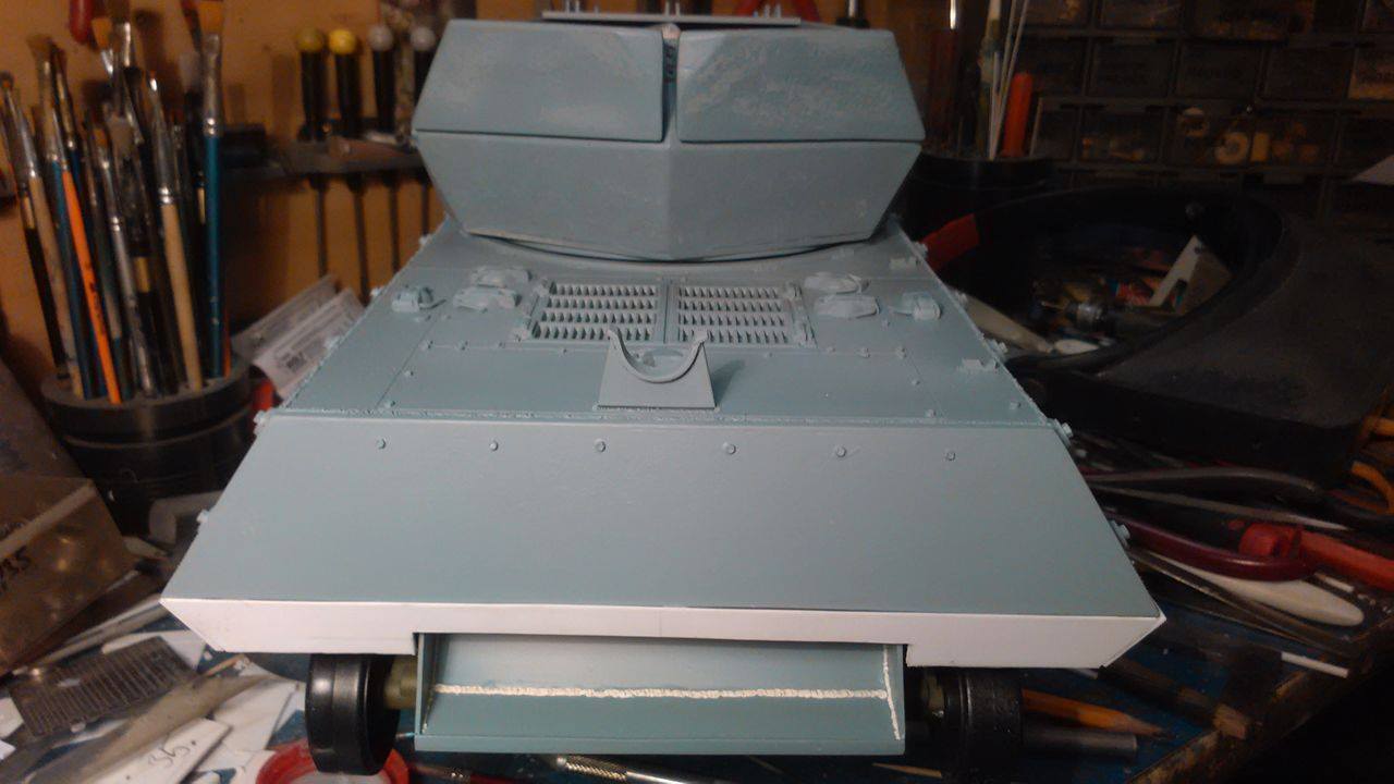

So Check this out... I asked Attilia if he planned on doing an M-10 and pleaded the case a few months ago... I never heard anything back and thought it was just a
request that would go un-heeded.., so I am simply blown-away that this is nearly finished... Looks like the too-build list is gonna get one more added to it... Very Excited..Joe

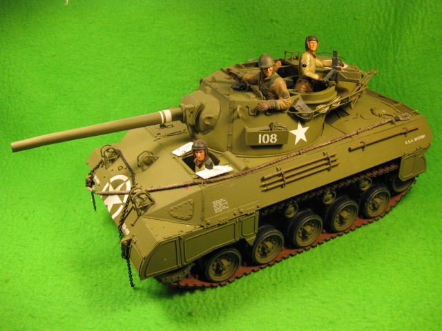

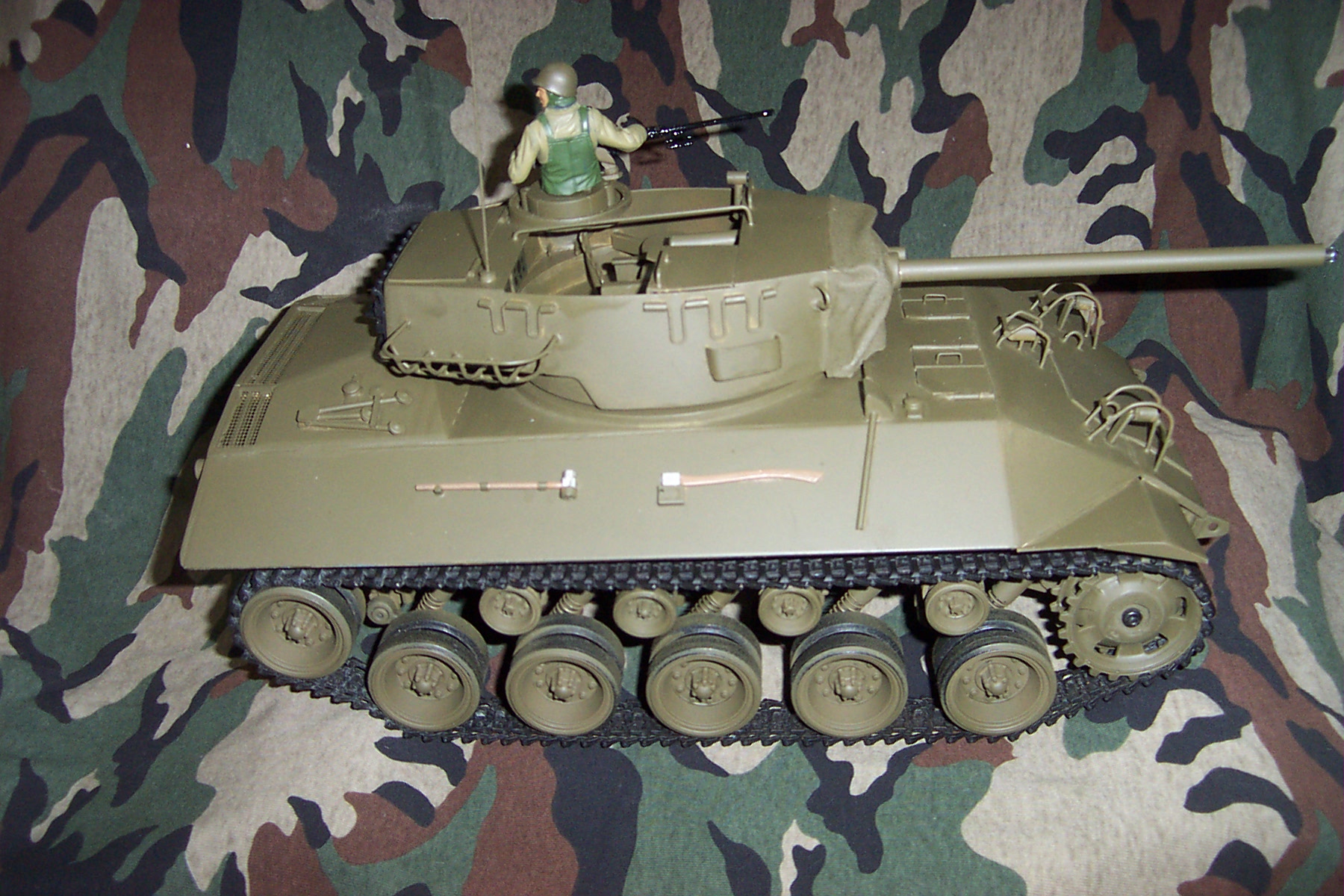

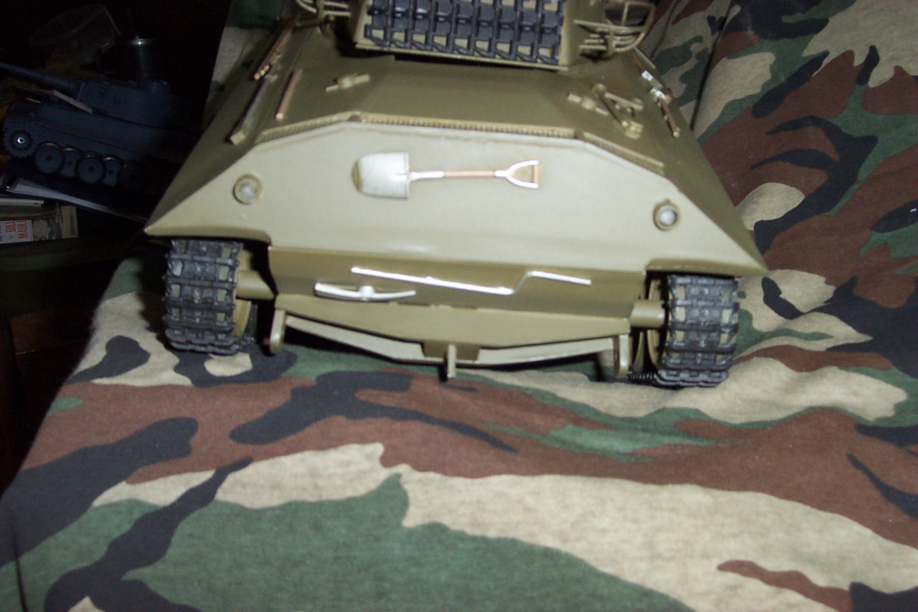

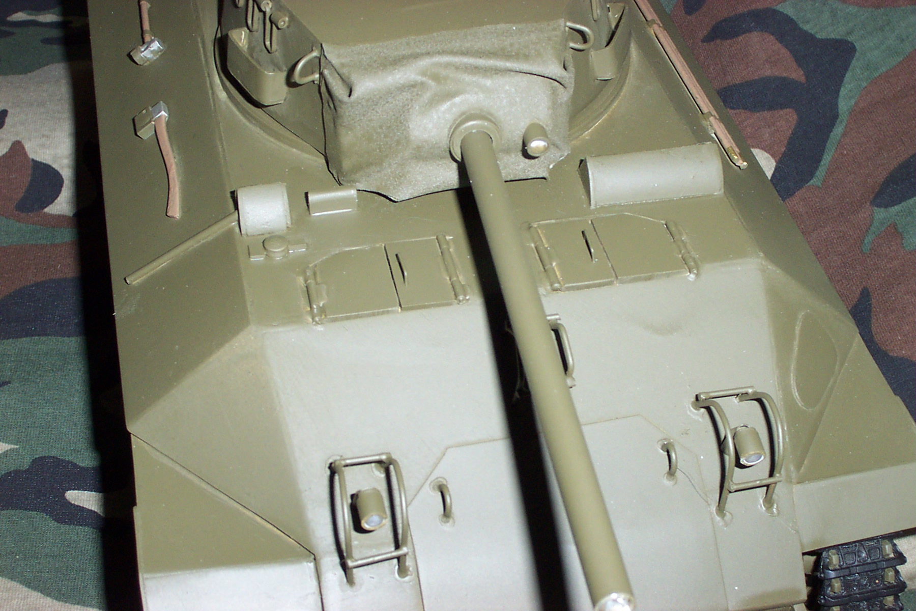

I made an M18 from a bulldog. Scratch built the upper and the turret and used Pziv tracks.
Name:	Jeff's M18 Hellcat002 - Copy.jpg

Did you do it all on an unmodified Bulldog Chassis? Either way.. I love it!... Very Cool! I want one>>> Joe

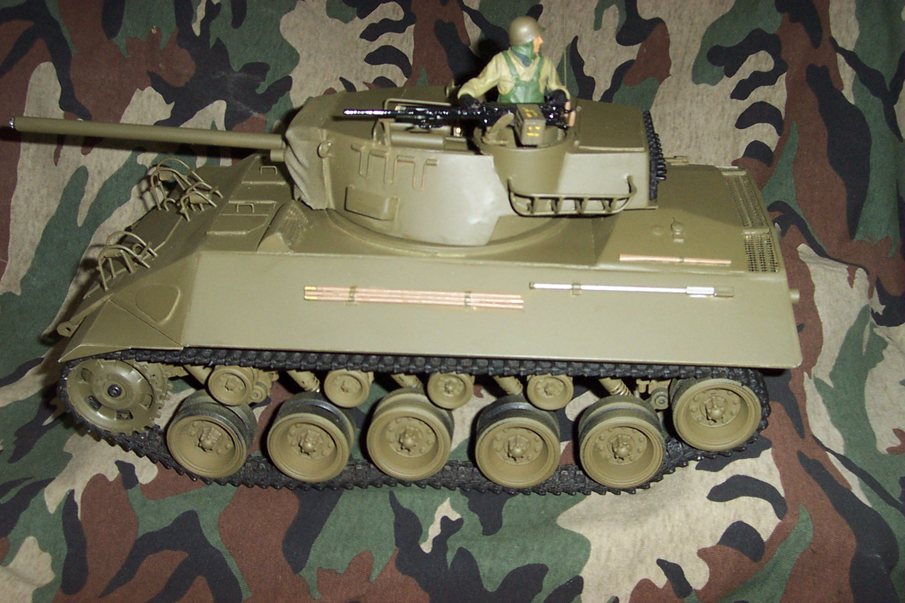

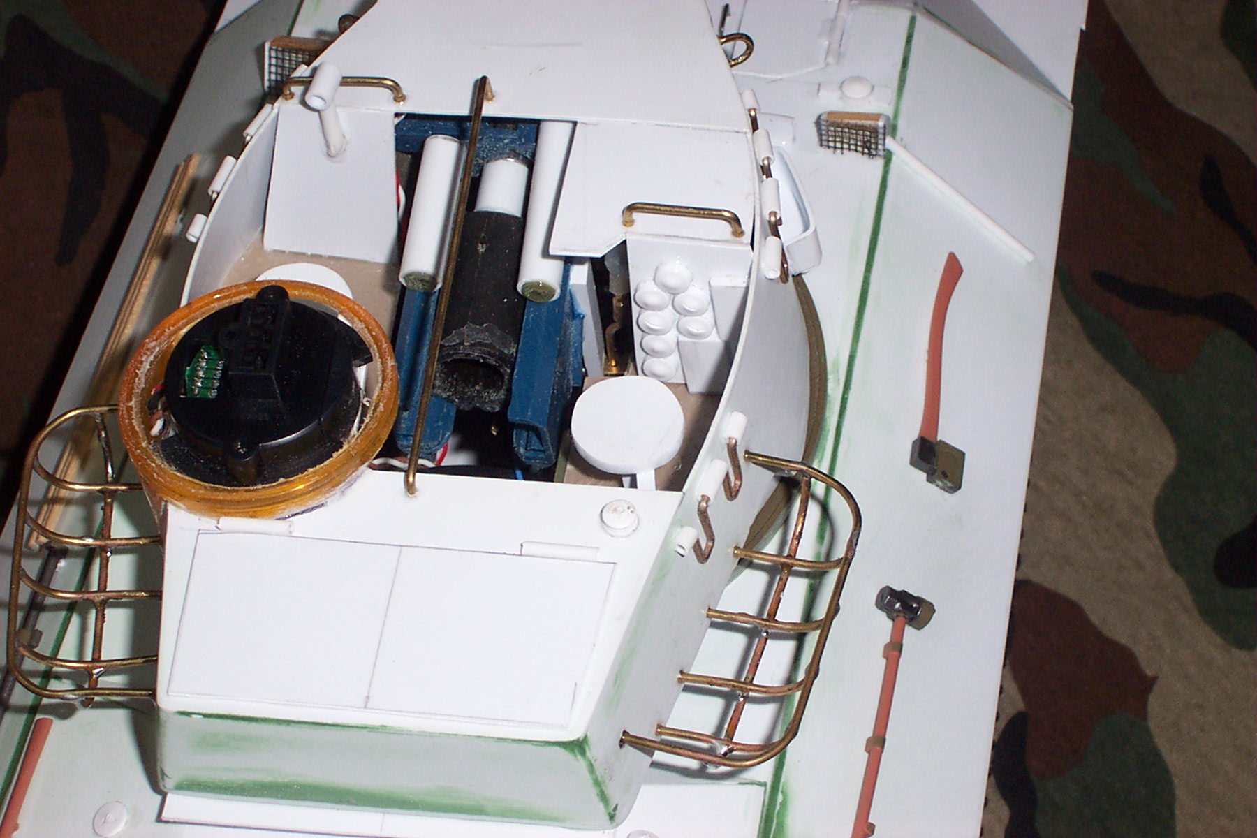

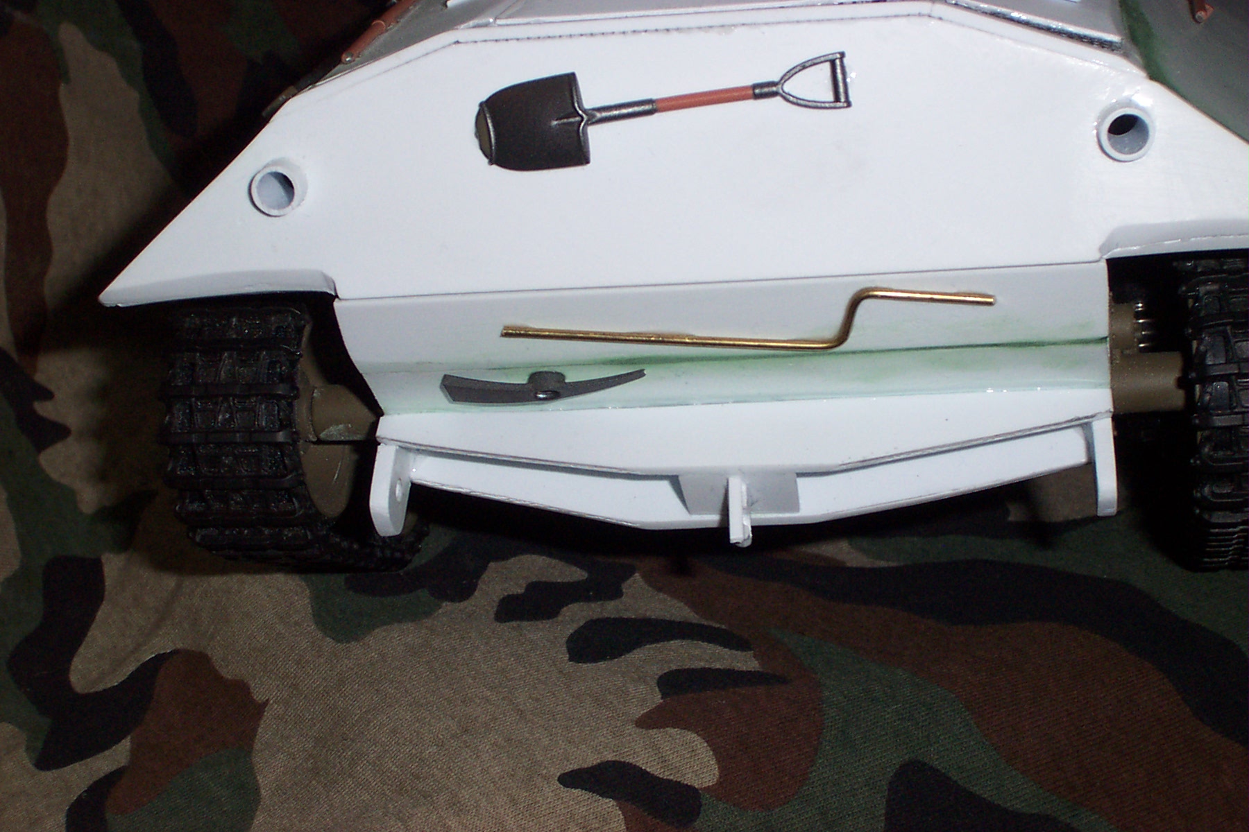

I also had the fun of building one ---
rex
Looks like all of them swapped out the frontal idler with either a pz3 or pz4 drive sprocket and pz3 or 4 tracks to replicate the hellcats front wheel drive, except Rex, I cant tell what he is using. What are you using Rex?
Also that M10 is awesome! Great news to see one finally going to be released

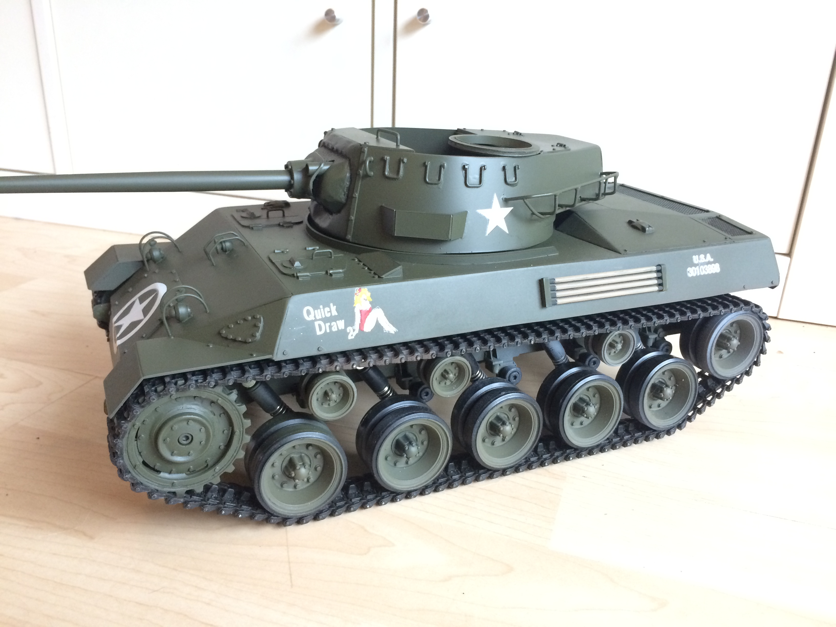

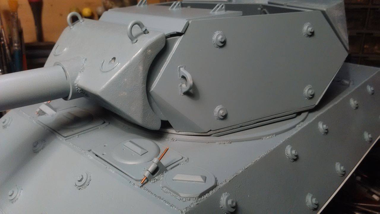

I used a bulldog chassis (narrowed by 10mm), pzr3 sprockets/tracks and a scratchbuilt upper

How is the gearbox setup in that? Looks like it would be a real tight fit with the angle of the upper plate
Old 07-09-2016 | 08:47 AM
Joined: Mar 2008
Posts: 995
Received 8 Likes on 4 Posts
From: kettering, UNITED KINGDOM
It is tight but I still used std HL boxes..

What was tight was stuffing a Tamiya DMD and MFU plus a speaker into that thing

Martellus --
I built my Hellcat from a 21st Century Toys Walker Bulldog lower hull. It (and the crew) are 1/18th scale. The track is a rubber band type of thing. Since the dimensions of a real Walker are longer and wider than a Hellcat, the 1/18 model comes out to be about 1/17 scale. I built it long before HL came out with their Walker Bulldog. I wish I had another 21st Century Walker, they are asking big bucks for them on eBay.

I did not modify the hull on the one I did. I was very concerned with the gearboxes not fitting. I think it looks and came out great anyway.
Herman
