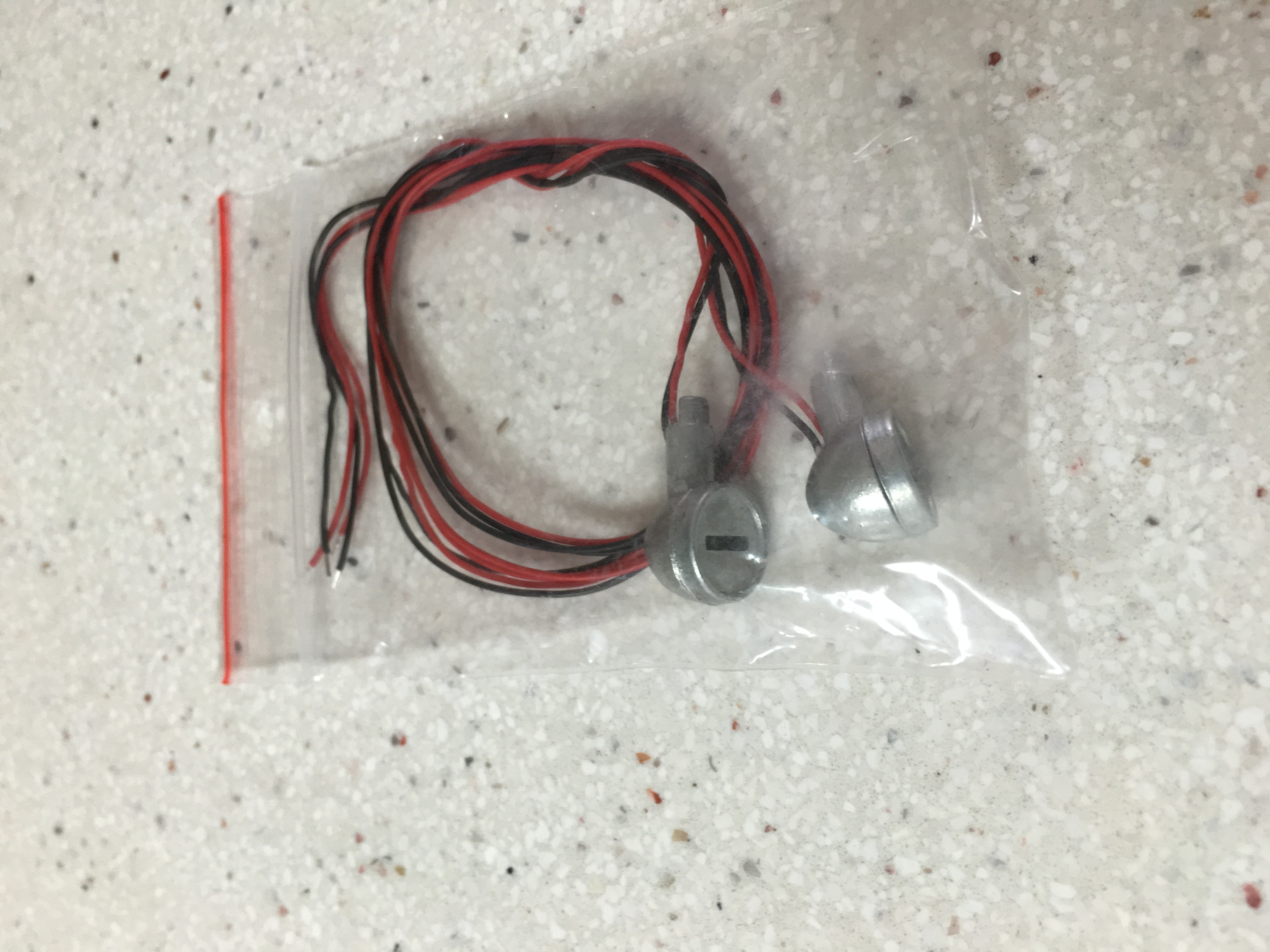

Has anyone taken one of these apart. I can't tell if it's glued or soldered.

I would guess that is probably glued shut. On the factory side of things that would be much more cost effective than soldering. Taigen's are glued, but this doesn't look like one of ours. Who makes these?

Joe I've done a bunch of those. They're glued. A little "uncure" will soften it up in about four or five minutes and then a #10 blade will pry it right off. I always open those up and put in the 3mm warm white LEDs.

Thanks Gary, a little "uncure" and a blade it will be then. Thank you.

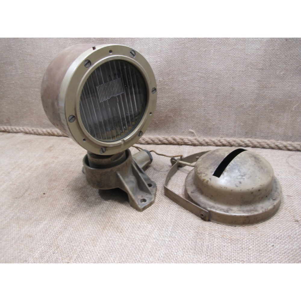

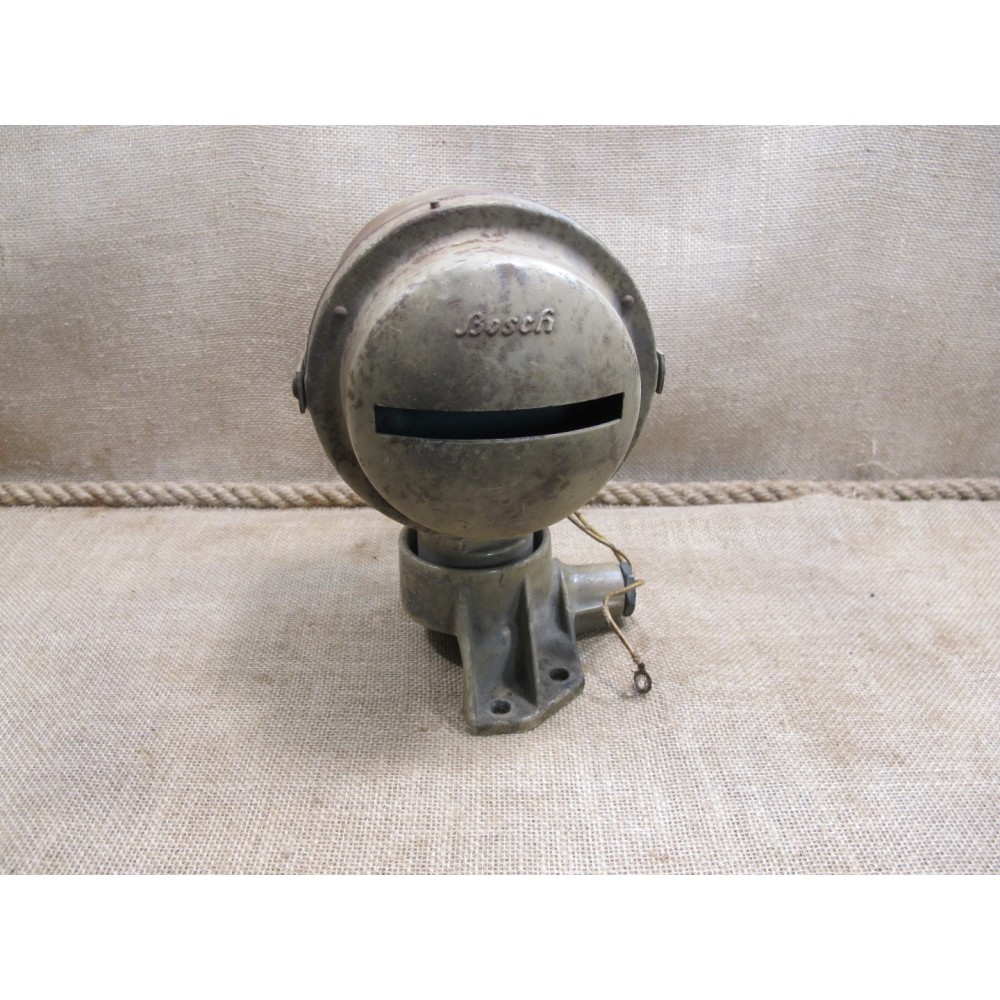

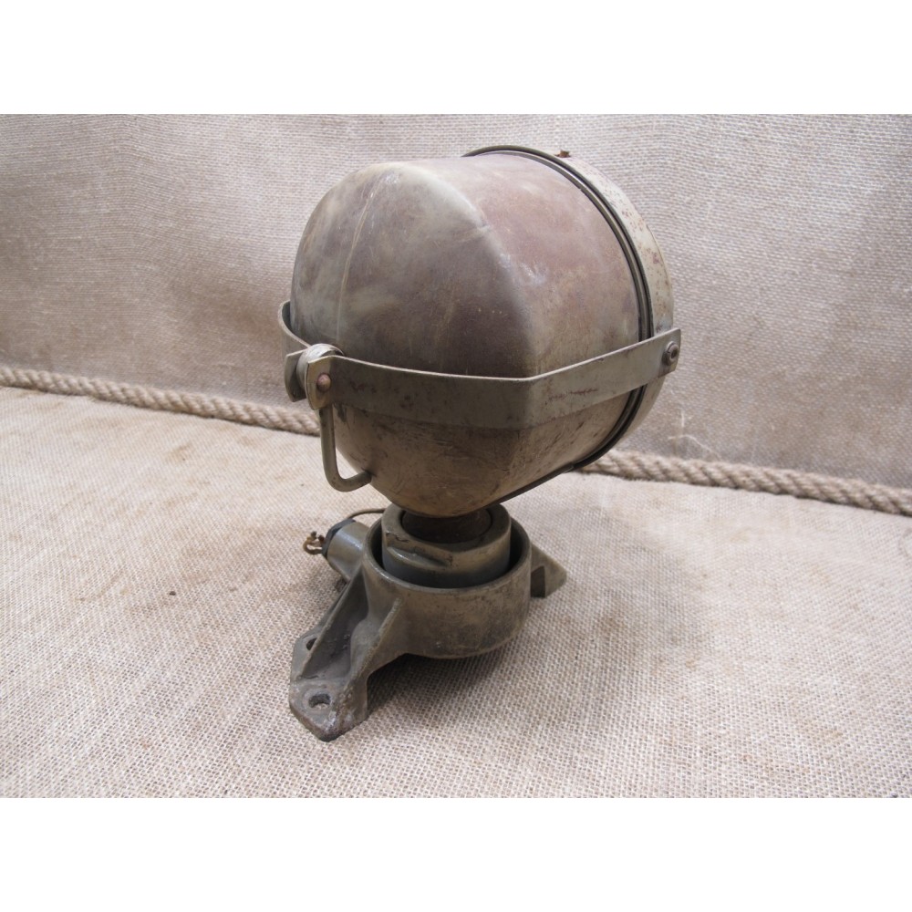

If it's a Bosch type head light you are looking to simulate it should look like this original.
And that is exactly the "SCHUMO" headlight that www.axels-modellbau-shop.de
are selling.
Shaun.
