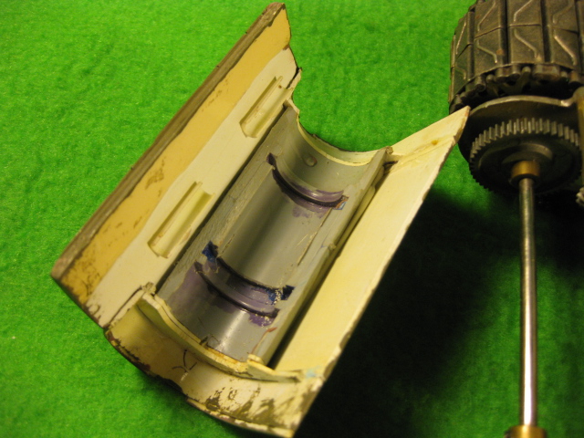

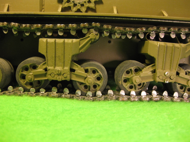

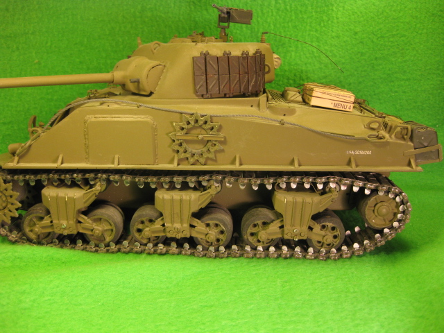

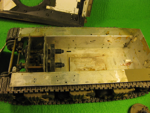

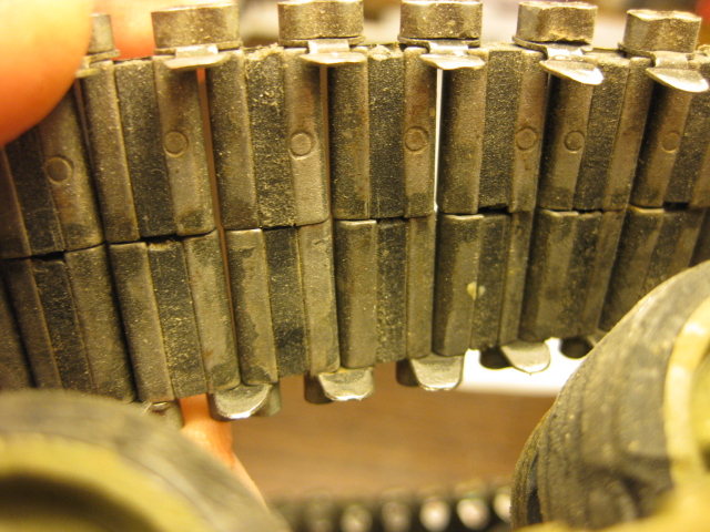

No mystery here ---- it wasn't a real one found submerged in a swamp somewhere, or buried under a desert sand dune. It was one I totally forgot about because it was the first conversion I ever built --- about 25 years ago. I found it in the corner of the top shelf in my hobby room. It had a layer of dust on it thick enough to plow and plant corn. It's the first production release of the Tamiya Sherman with the 105mm howitzer. I know it was their production model #1 and I think it may be close to serial #1. Back then it was the only game in town and I wanted one that was different from the same Sherman all of the other guys had. At that time I had better eyesight, steadier fingers and more patience than I have today. This Sherman M4A4 would be the correct version for a Crab mine clearing flail tank, but I think I would rather leave it alone rather than maybe mess it up with a flail rig add on. Finding this critter and remembering how I built it caused me (allowed me) to have a wonderful trip down memory lane about those good old days -------
I have decided to try and build a way I thought of to make the chain drum spin, I'm going to use my Mato cast hull M4A1(76)W as a test bed to see if my Mickey Mouse rig will function. One way or another it will satisfy my curiosity, and probably give everyone a good laugh. Hey --- every village needs an idiot. I'll post those photos later ----
The rubber tires in the road wheels are made from the rubber washers that you find on your garden hose end that screws on to the faucet.

This conversion was r/c when I got it but I apparently used the r/c stuff to run something else. I really can't afford to r/c everything I build since everything ends up on a shelf to collect dust. The early Tamiya Shermans had a tranny that had clutches that engaged the motors and ran the tank. It also had a 3 position step switch that was moved by a servo. Thank goodness they developed the MF electronics.

That is pretty cool man, what a lot of work. Those bogies blow me away because I know at that time you had to completely scratch them. The track makes me laugh, it looks like you conjoined the two metal pads into a make shift older style track. Good work for the day.

[QUOTE=RichJohnson;12255526]That is pretty cool man, what a lot of work. Those bogies blow me away because I know at that time you had to completely scratch them. The track makes me laugh, it looks like you conjoined the two metal pads into a make shift older style track.
Yeah --- I did butt the track halves together and then I cut the center track guide in half to make the outside guide horns. That took forever and a day of cutting, grinding, flattening, reshaping and assembling as a continuous track loop. I must have been suffering from some kind of brain damage when I thought of doing that. Or maybe it was the Gin and Tonic.
