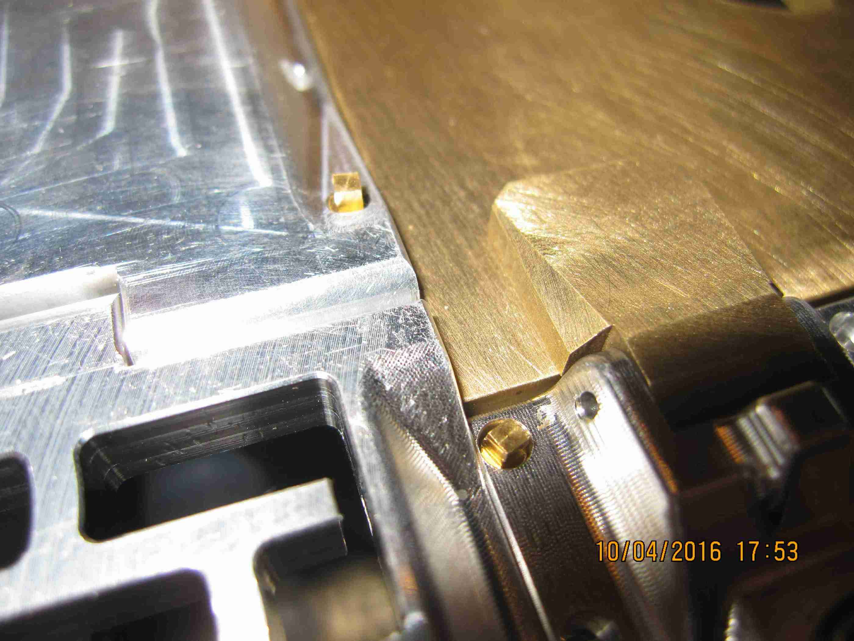

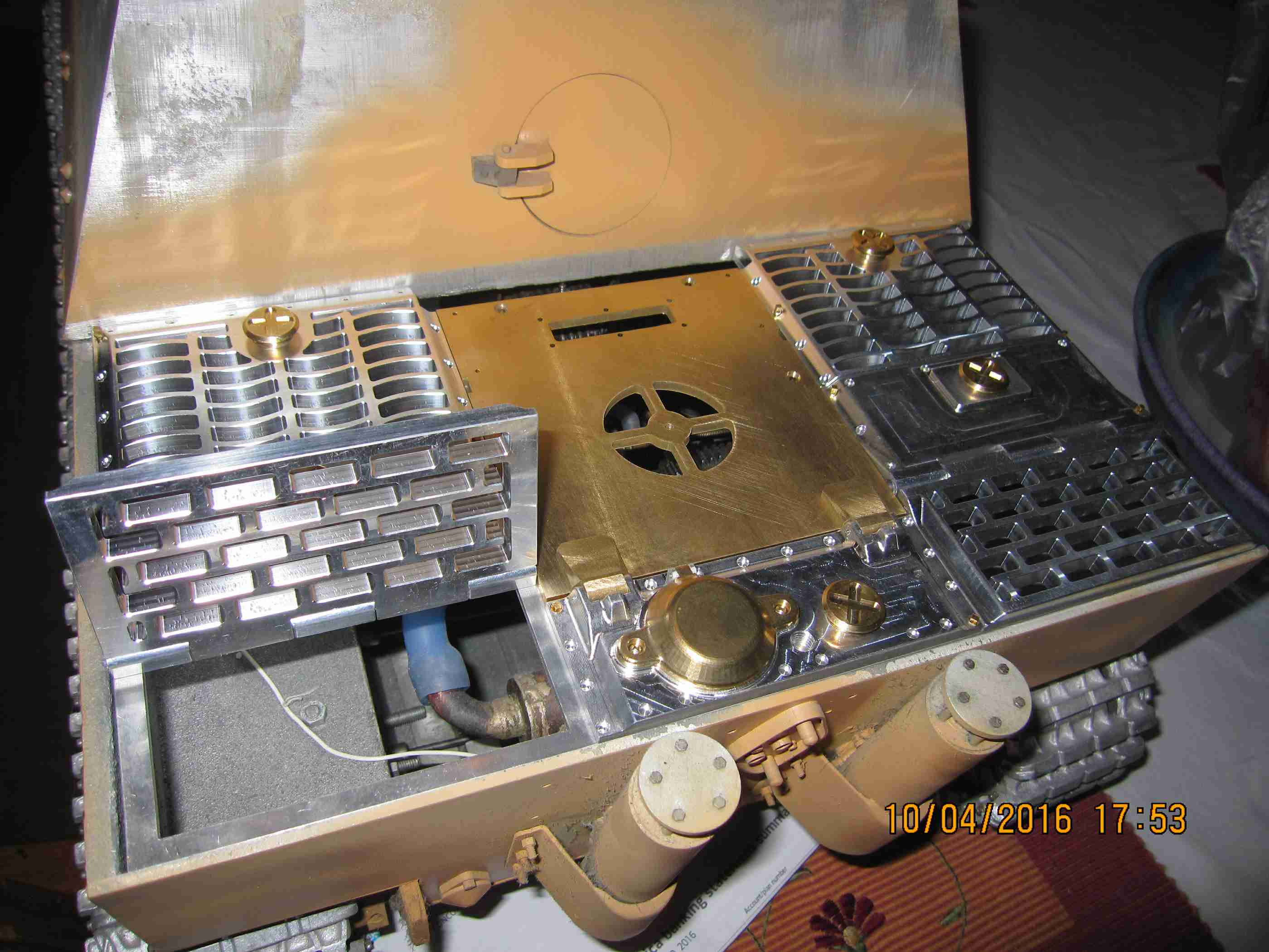

The photos above show the deck on my SturmTiger. I worked with Alex to get a compromise set of parts that
could work on either a 1/10 scale Tiger I with a cast hull as found by Wittgrebe or other makers in Europe OR
the Seiki Tiger Is of which there are quite a number. Alex not only provided a set of grates and hatch but a frame
on which to mount them all, functional filler caps, hinged cap and all the square head bolys ( with tool) with which to mount them. This is better than great! I can't say enough good things about those guys! They basically accepted
my 'commission' and produced a minimum number of sets for me. I will likely have a few sets left over which I can sell
however they won't be inexpensive and there will be some mods needed to a person's model. The result is worth it...

Those are some beautiful parts Jerry!!!!
