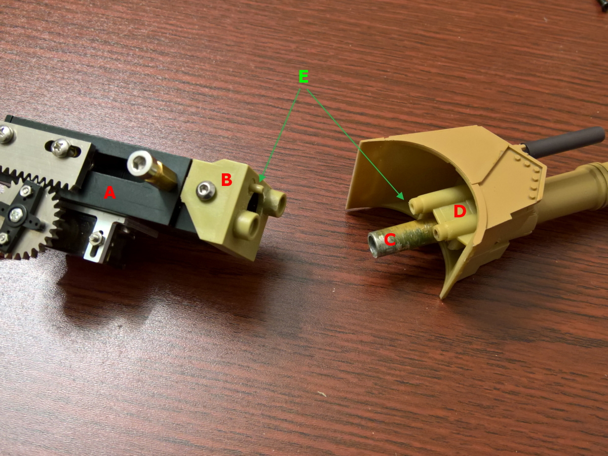

Hi all,
Finally i started working on my abrams HL tank...
I want to use a recoil unit and got the metal one that is sold at several shops, i guess they are all the same ?
Problem is that the cannon and the moving "extension" within the recoil unit are not aligned in a straight line.
There is an offset of about 1 mm so that the cannon is jammed and can not be moved.
Maybe i did something wrong or the recoil unit just does not fit to the abrams tank ?
I made two photos...
A is the recoil unit
B is the inner most plastic part
C cannon
D cannon mount
E pin and hole which needs to line up
There is only one way to attach B to A because the moving part of A and the hole in B are not centered.
There is only one way to attach D to B.

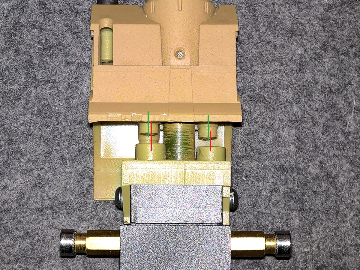

In photo 2 i tried to show that the parts are misaligned for about 1mm.
I have no idea how i could fix that, but maybe its just the wrong recoil unit ?
What do you guys think ?
Regards,
Olaf

I had this same issue when I tried to install on in my firefly, I think I had to do lots of filing to get it to fit. I don't know why they've made it offset. I haven't seen a model where the recoils aligned like this. If you can I would send this back and look into the Clark universal recoil. Same idea but not stupidly offset.

I will give it a try with filing... also thought about getting the one from clark, but was not shure if it has the same problem.
But if not it would be an alternative.
