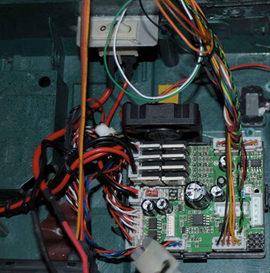

The recoil servo has always been there. The pictures you show also seem to show the jumper on the same pins.
Old 02-14-2017 | 09:39 AM
Joined: Mar 2010
Posts: 2,384
Received 23 Likes on 14 Posts
From: , UNITED KINGDOM
J3 has always been the IR emitter. J2 the servo recoil (which is where you put the jump and always have).

You placed jumper like this ?
I have both tk22-24-60 and use that position for the jumper when using Sony remote . Nothing have changed on the layout on the boards .

If you look at this page for the TK20-series:
http://www.clark-model.com/eng/prod_rx20/index.html
They show:
But if you look at this TK22 Tutorial:
http://www.clark-model.com/eng/prod_rx20_tu/index.html
They show:
So it looks to me like:
1) There is a difference between the TK20-series page board and the TK22-series page board.
2) The jumper is in the same location, but a different jumper designation (J2 on the TK20, J3 on the TK22).
So I would be confused trying to figure out where to put the jumper. I probably would have ignored the picture and gone by the jumper designation. If the instructions said jumper J2, then I would jumper J2 as designated on the board, rather than what the instructions show.
Steve

The picture is referenced for the jumper for the recoil servo, not the elevation servo. And it does look like the TK20 and TK22 boards have different jumper locations. Shows the importance of RTFM and not just looking at pictures.

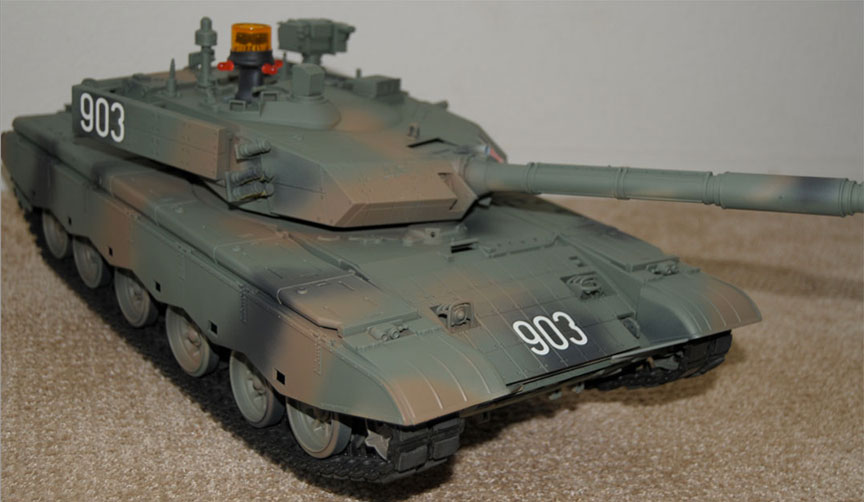

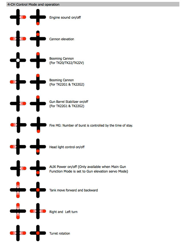

Another Clark Board Warning!
I do have some successful first time experience with the Clark Board Setup (photos below) and I found the following to be the undeniable truth: purchase ELMOD and that is my best recommend to solve any Clark Board problems:
Find the solution here: https://www.elmod.eu/index.php?langu...u97mbreehhc1t3
You got to love the Clark stick commands though, OK, maybe not.
John

Although no everyone has a computer radio, those with can transfer all those fiddly stick commands onto switches instead which I find a big help.
