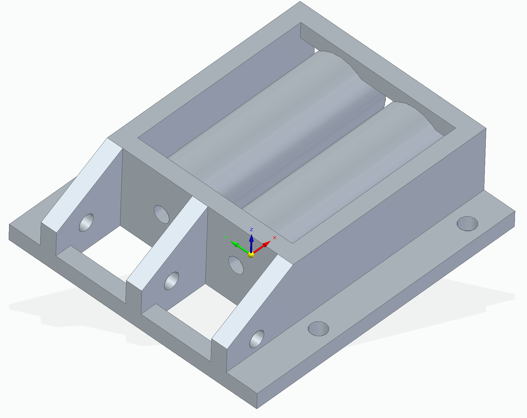

Old 02-28-2017 | 11:55 AM
Joined: Dec 2015
Posts: 723
Received 14 Likes on 12 Posts
Here is a quick something I banged up in CAD that could be printed. And more reinforcing structure could be easily added. Just have to figure out the shafting and gearing and such. Some of the new 3D printing materials are quite strong. I think some of them even have carbon fiber in them.
Steve

Old 02-28-2017 | 12:05 PM
Joined: Dec 2015
Posts: 723
A couple mods.

Old 02-28-2017 | 12:21 PM
Joined: Dec 2014
Posts: 192
Originally Posted by maillemaker
A couple mods.
Awesome - i knew we had some 3d modeing experts here. So what else is needed to turn this into a functional gearbox? 2 gearmotors, 2 shafts, some screws, and (4?) bearings?
Can shafts be lifted from 3:1 gearboxes? Where to get gearboxes? Possibility for some kind of worm drive instead of planetary gearmotors?

Old 02-28-2017 | 01:08 PM
Joined: Dec 2015
Posts: 723
Unfortunately, I don't know anything about motors, gearboxes, gear ratios, shafts, shaft couplings - nada. Which is part of what you are paying for when you buy someone's gearbox - the engineering knowledge that went into making it.
Does anyone know a source for electric motors and gearboxes and such, preferably with dimensions?
I wonder if the aluminum components can be replaced with bent sheet metal (if its good enough for an AK47 receiver...). But I assume the motor gearboxes are the expensive part.
The first time I looked at the ETO box I figured sheet metal would be cheaper than the machined billet frame he's got now.
