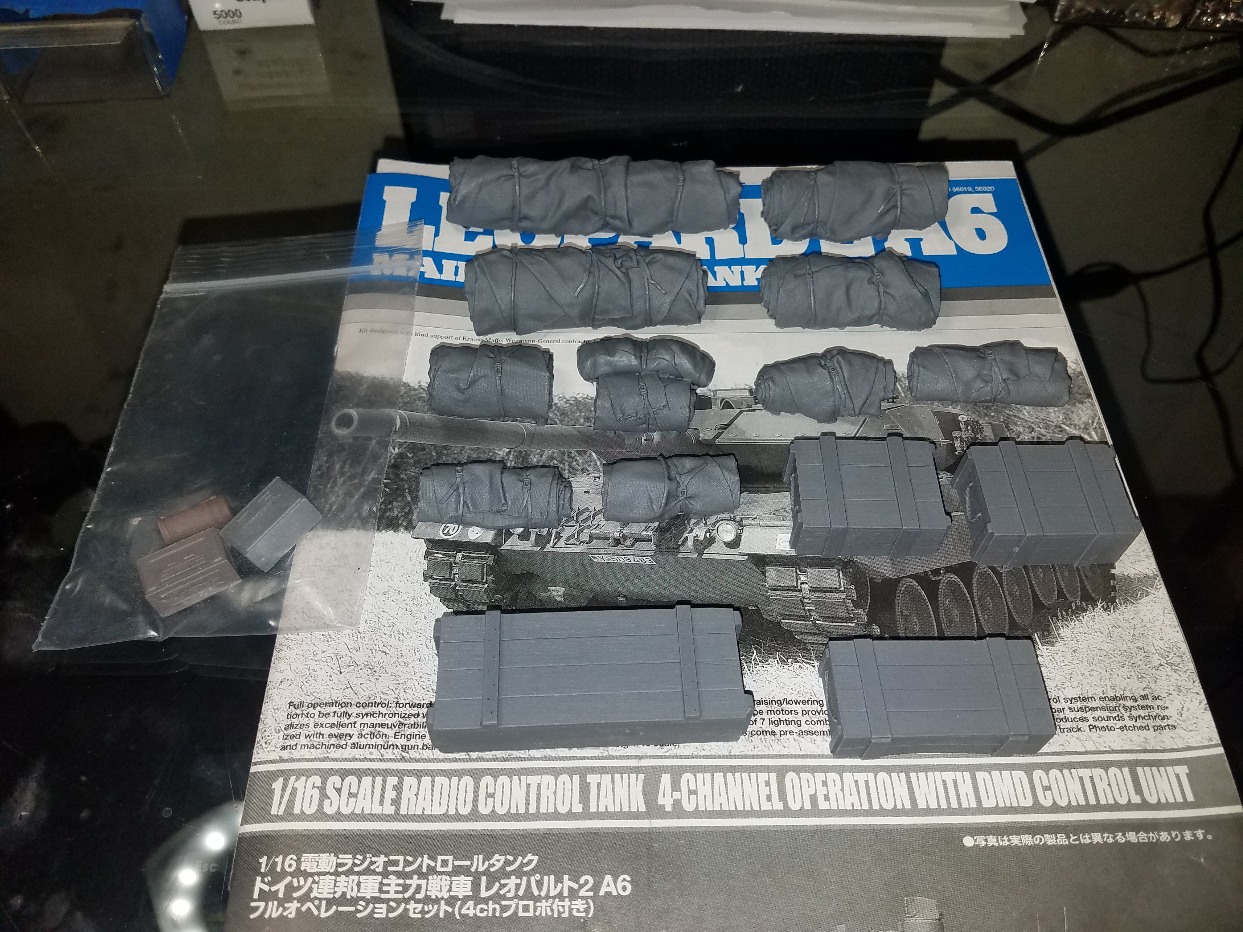

The upper surface is very good, but I'm not sure I like this "open mold" thing. Are the bottoms supposed to look like this? All that flash around the outside? I'm hoping our resident resin guru (Ausf) is watching and will check out the photo and give me his opinion. Something tells me Jeff would scrap these pieces, but I know he's used to the figure painting community and they're a lot more demanding when it comes to quality (at the prices they pay I'd be demanding, too).

There's nothing wrong with open molds as long as the underside is not going to be seen and they are filled consistently without bubbling. I generally don't cast like that because under vacuum, it would be a nightmare for me. If if looks good, by all means, more power to him.
In terms of price, I think 14 pieces for $24 shipped is a heck of a deal.
Keep in mind, the materials aren't cheap, I just spent about $400 on resin and silicone in the past two weeks. Just by eyeballing what you dumped out of that bag, my guess it's about 200-250ml. Going with 200, that means less than 20 set per gallon. The resin I use is a little over a $100 a gallon shipped. So, you're looking about $5 a set and that doesn't include the silicone for the mold (stuff I use is over $200 per gallon kit shipped).
If you think of it another way, ask yourself how long would it take you to make your own tarp (or 14 of them), then ask if $24 is worth your time.

Lay a sheet of sandpaper on a table or glass (or glass table) an just rub it back and forth until it's as flat as you want it. If you use coarse paper like 100-200, you'll get a rough surface that'll give the glue an area to grab.
The rough area is where the resin is wicking by capillary action around the rim. Plus the surface tension breaks when it cures, so it drops a bit. I hear you that you don't like it, I usually don't either but in this case if poses no issue.
It's actually harder to cast that way in my opinion since you really have to be on top of how much your filling it. If you overfill, then the chunk becomes too thick to easily sand. basically it's harder to design a mold that isn't open, but it's easier to cast in.
If you sand them, to avoid dust, keep a bowl of water next to it, dunk a piece, sand, dunk and check. Technically resin is inert once set, but the particles can be particularly irritating and isocynates trigger sensitizing in the lungs, so no need to go out of your way to expose them to it.
The up side to what you have there is you can readily see he casting bubble free, you're not going to have a monster void lurking under the surface.

By the way, don't sand too much before you check. Typical resin has a shore hardness around 80D, so it sands fast, especially with 150.

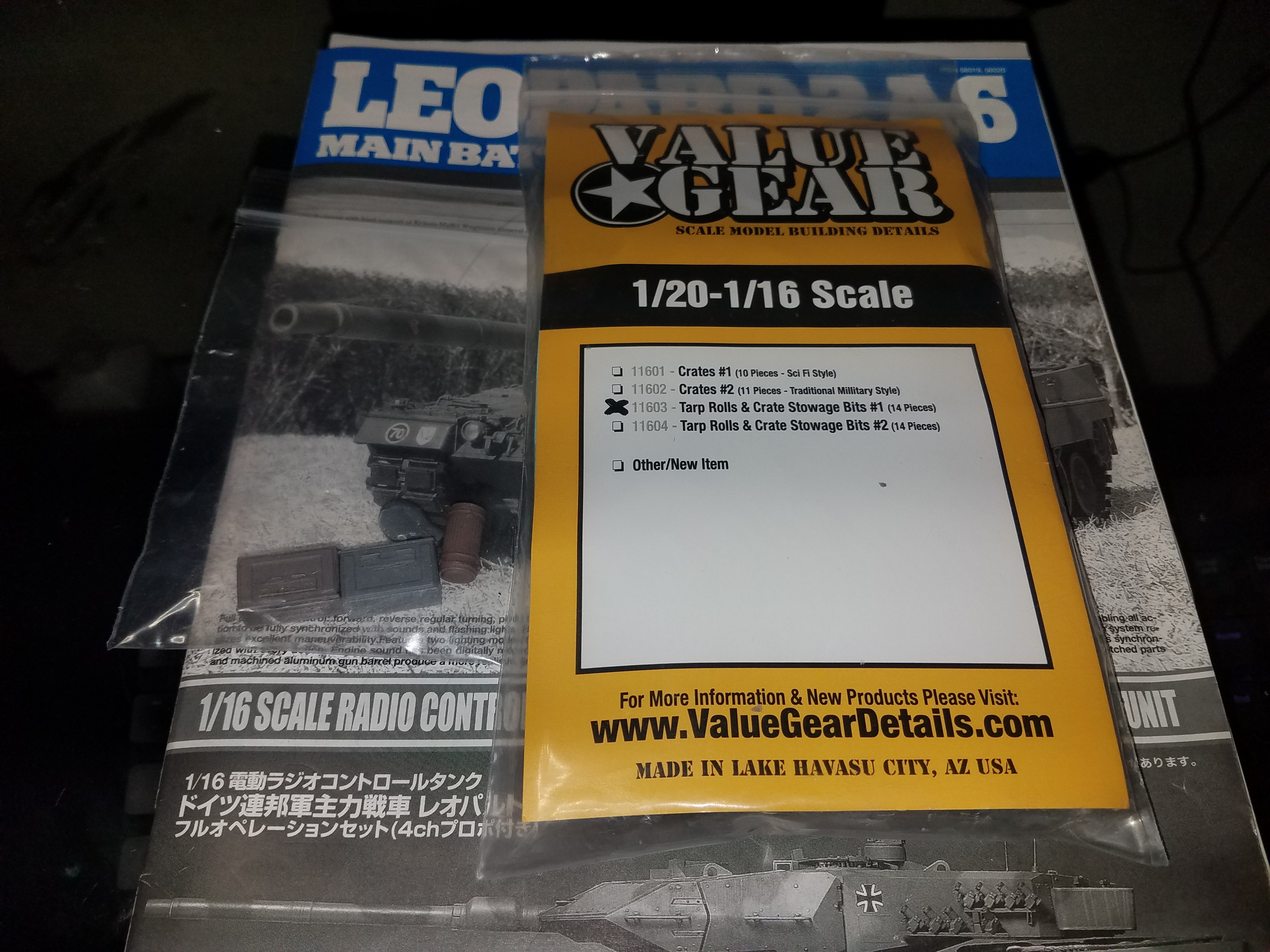

ID:	2207749   Click image for larger version
