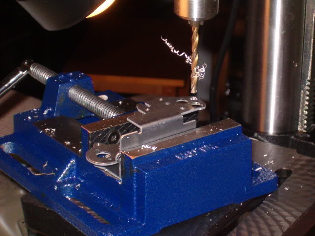

As long as we're talking about the plates that go under the gearbox right, and not this modification:
[ATTACH]2210727[/IMG]
[ATTACH]2210728[/IMG]

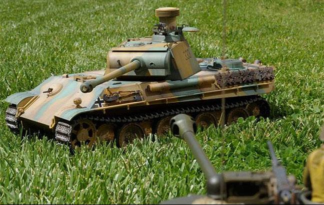

My first 2 Tamiya rc tank kit builds, done almost 14 years ago now, were built carefully out of the box and worked good. That is until I compared my builds to the running performance of similar Tamiya rc tanks at the local rc tank club.
What I quickly discovered is that if your aspirations are to join in on IR RC tank club fighting, in that type of setting, you will probably need some if not all the standard modifications to be competitive and have trouble free battle day fun. FYI, that is why the various parts were developed after all over the last decade and a half.
Unless your model is a show piece and you want more accurate looking metal tracks for presentation, I would not recommend metal tracks for IR fighting and or running around on your wife’s carpets and floors for that matter.

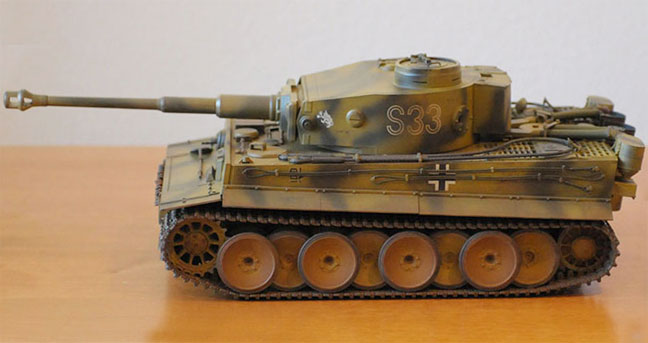

The case for upgrades:
1. My Pershing’s plastic elevation arm failed after about a year of gentle use and was replaced with a Daryl Turner metal elevation arm. I probably broke the plastic part by locking down the main gun, my bad and a not so gentle use. The metal elevation arm does not fail.
2. The Tiger IE worked great for 3 years and then both the barrel recoil arm and the plastic elevation arm failed and was replaced with ETO Armor parts. I added a metal barrel at that time, because the Tiger IE kit's barrel is/was to short and the replacement metal barrel is accurate in length. The swap out had nothing to do with filling plastic barrel seems. The barrel is the heart of a model tank and for sure that is the one thing you want right. The correct length metal barrel just looks better on the Tamiya Tiger IE.
3. The Tamiya King Tiger kit's idler setup simply does not work very well. That is why better alternatives are offered. The stock KT hull does flex and distort running hard on outdoor terrain and will throw its tracks. That is why you spec a gearbox mount brace to keep things aligned and your tracks on. My KT kit’s plastic barrel was replaced with a better looking scale metal barrel.
4. Both the Tiger and KT are kinda to fast built out of the box, so for that reason gear reduction is often used on the Tamiya Gearboxes along with 400 motors or larger motors to help keep you moving after 7 or 8 IR hits.
5. Several years ago I built my Tamiya Panther G without road wheel bearings and my Tamiya Jagdpanther with road wheel bearings. The Jagdpanther was a noticeably better and smoother runner, but I am not sure if that fact really translates in to any meaningful performance advantage in an IR fight
6, With my Sherman 105mm, I built it stock and a couple of years later significantly improved its out door terrain running ability by adding aftermarket Impact Idlers, rear side hull braces, metal elevation arm, a gear box mount brace and 400 motors. The tank could now climb outdoor inclines, run through grass and still move when being clobbered by Axis heavy panzers hits.
In conclusion, the various upgrades make a well built Tamiya rc tank kit that much better and way more fun to drive over outdoor terrain.
John

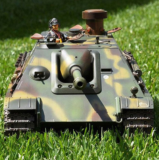

These are my basher builds and purposed for the family and local interested kids. Perhaps a better choice for a child's rc basher tank, just saying.

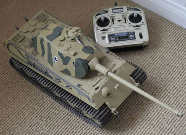

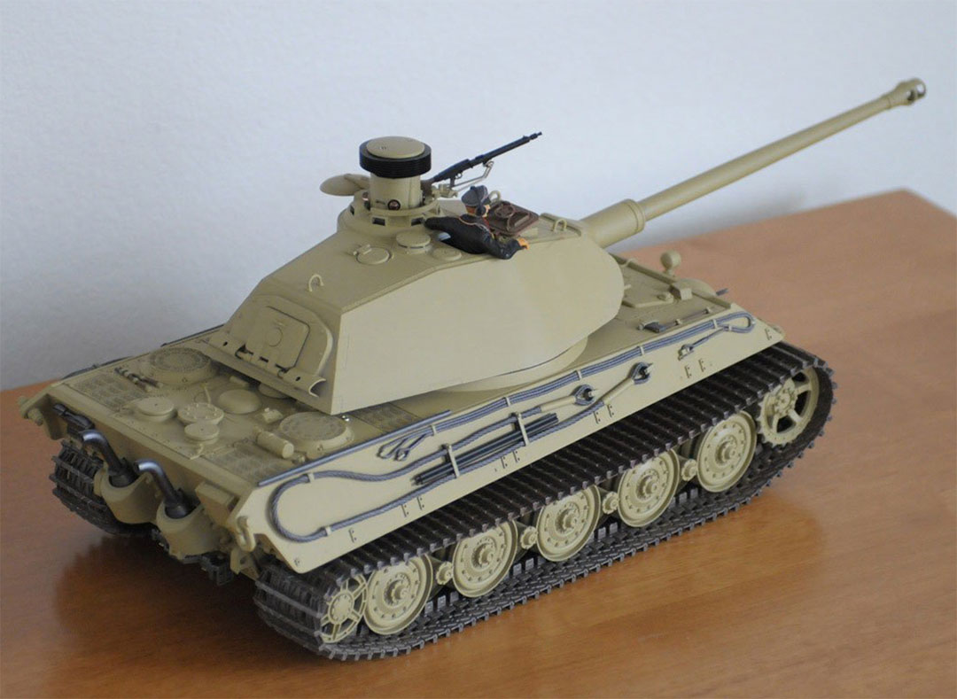

About the king tiger hull flex, where does it exactly flexes? Just on the gearbox area and with a brace would be enough? Or some hull braces like the taigen tanks are needed?
Agreed, I am on the other side of the country and not a Danville player. I observed a while ago that their normal gaming style (at least viewed in their You Tube videos) was not for me.
King Tiger Hull Bracing: The hull flexes longitudinally (a twist) along the length of the hull. The photo is of the Tamiya Porsche Tiger II Hull Conversion (same hull as the KT Production Turret Kit). This is the masterful commissioned custom work by Daryl Turner. One of his best mechanical design efforts, converting the static display kit's hull to FO IR RC. FYI, this hull flex stuff is old news gents.

Pcomm: Woah! That king tiger of yours looks bulletproof. I imagined the hull twist would be like that, but I was not 100% sure. I've read that it was way way worst in the older models. The "new" model has an extra angled plate on each side that helps a lot to prevent that torsion.
BennyB: Yep. I've done combat IR. Not at any tank club but with friends and my sons. The Danville battle area looks great and Im sure it is fun to drive through it but still dont like the way people battles. Yep. I know its just a laser tag game and people is playing with (expensive) toy tanks, but I would try to make the battles as realistic as possible.
Of course I imagine there is no way to tell people how to control their tanks reallistically...
Anyway, heading back to the topic: I think im boing to install the DKLM gearbox braces due to Im one of those guys who drive the tanks over rocks and drive my tanks for hours and hours, and its allways better to prevent than to cure.
