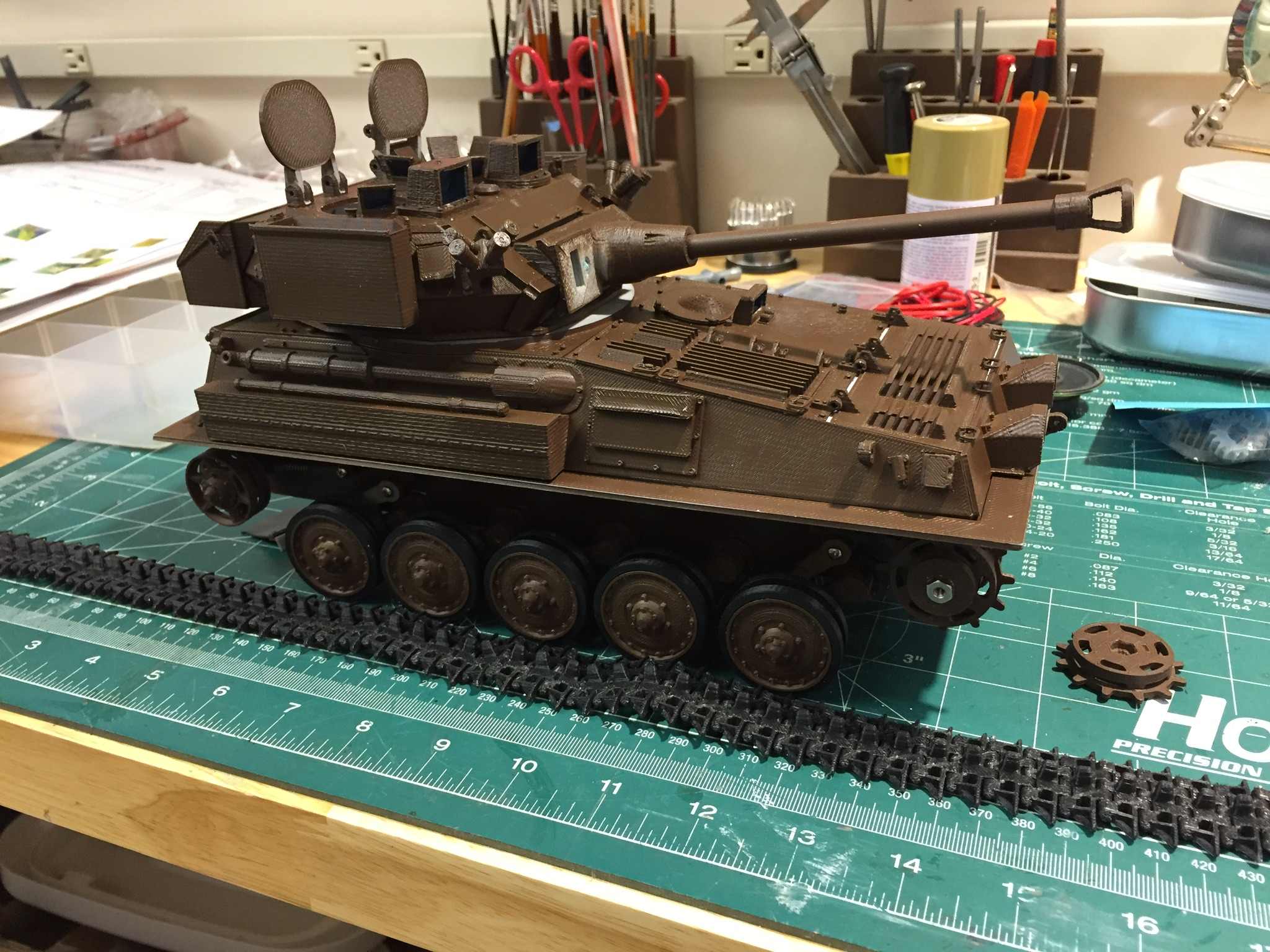

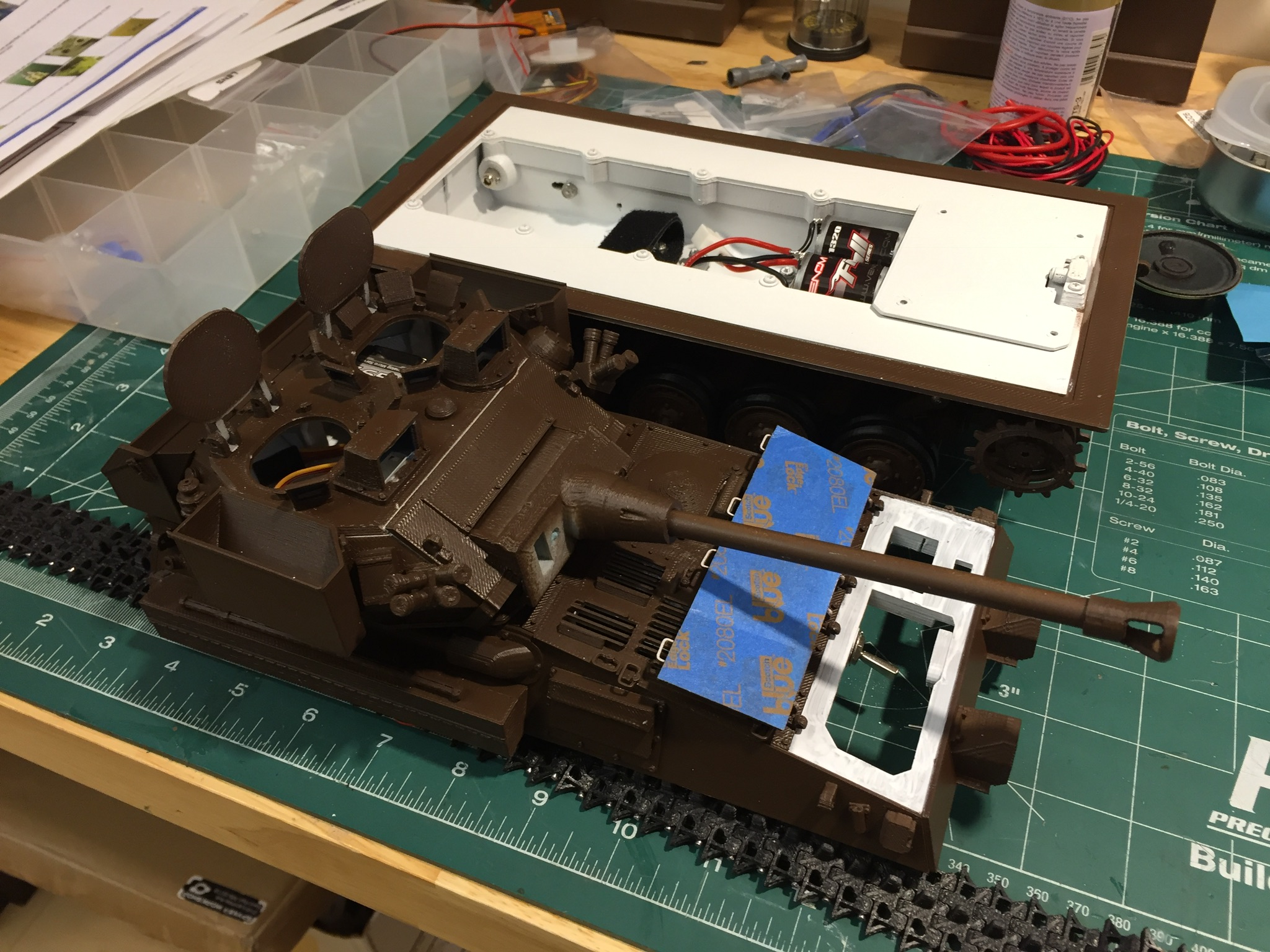

3D printing is not perfect, but is does make creating tanks easier. I never would have scratch built this myself. I purposely did not fill any of the surfaces to show the 3D printing (its a feature!). Sheet styrene or filler could have cleaned it up for the rivet counters. I am already thinking of adapting some of the techniques from this model to existing tanks - 3D printed internal frame for rigtity and mounting of components.
