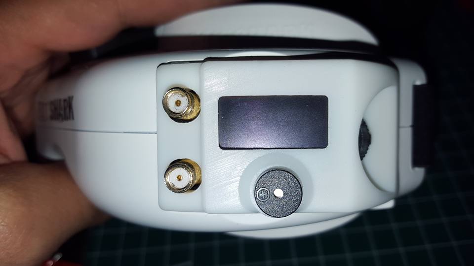

You should look into STL printing if you are worried about resolution. Laser printing with resin is quite nice, I've got parts so smooth you can barely see the lines. Shapeways although pretty expensive mostly does STL printing, though I like 3D Hubs for the ability to get something from a local maker and you can get communication with them on what you want and/or need. 3D Hubs also offers a design service if I remember correctly, I think that depends on the shop though, I could be wrong there.

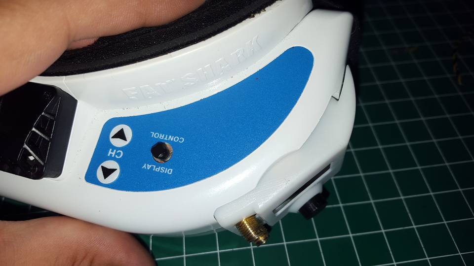

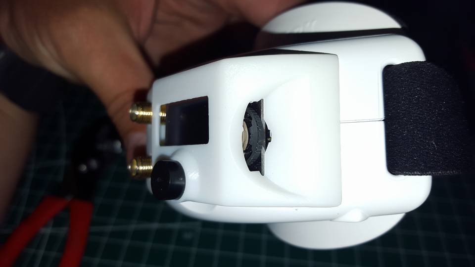

This is an example of one of those prints, sorry for the crappy lighting, it was taken a few months ago at night when I got it. It is a case for a RealACC Fat Shark module that I added a beeper and custom firmware to. Looking at it more than a few inches away it is almost impossible to tell it was 3d printed and that wasn't even the highest resolution either!

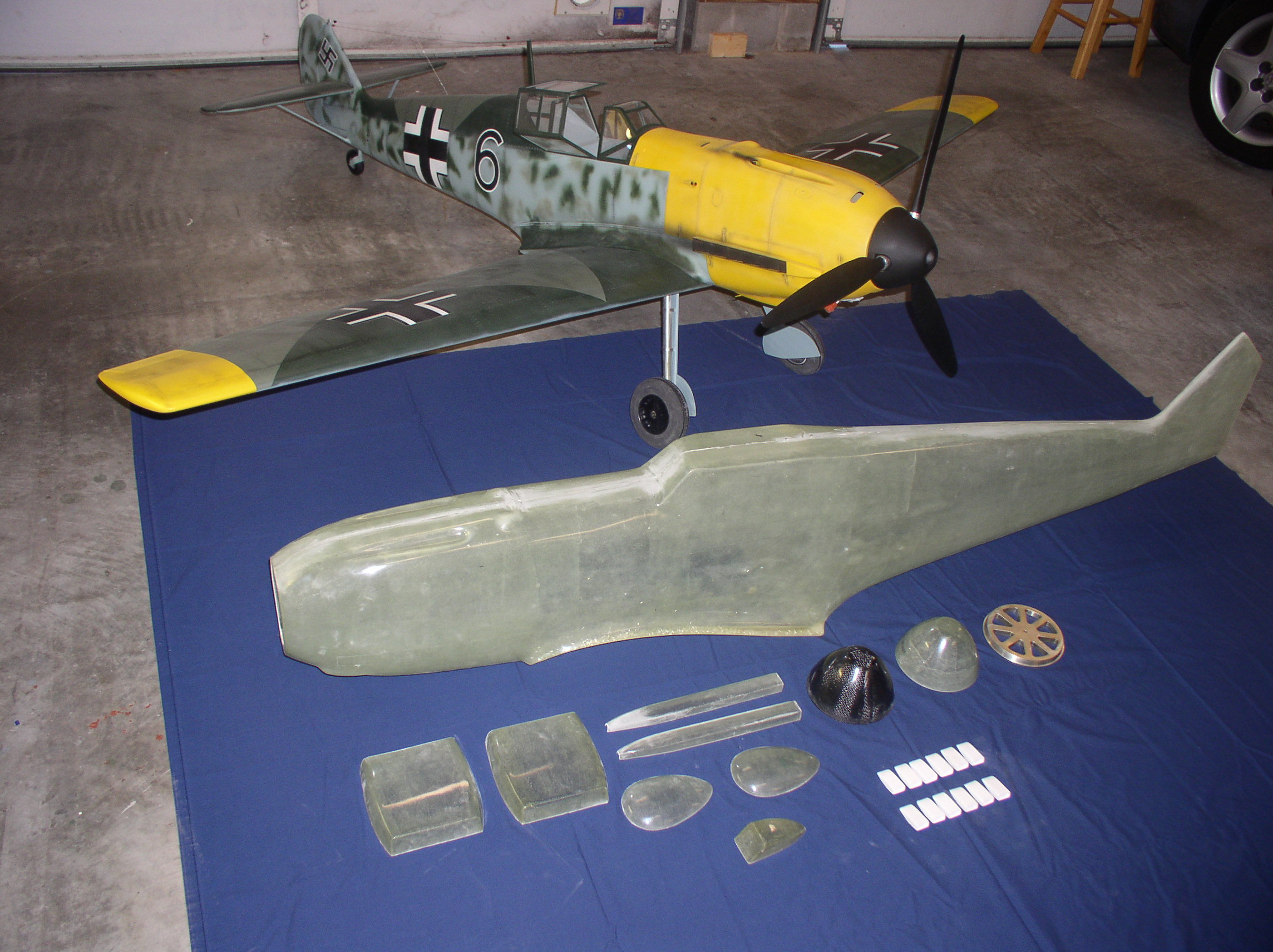

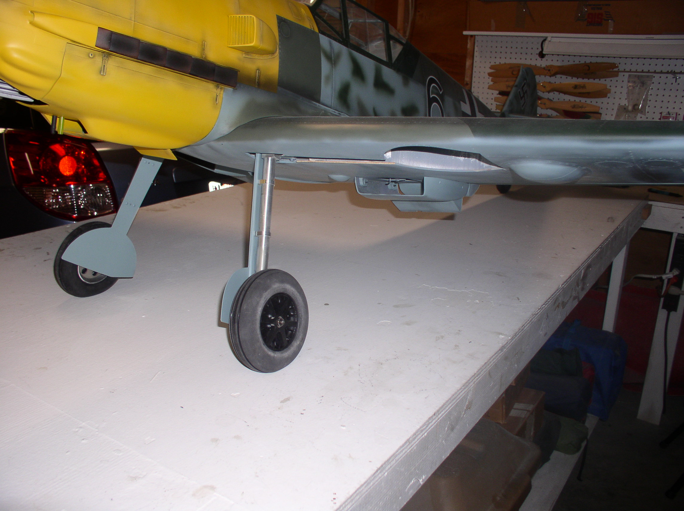

Old 09-28-2017 | 09:47 AM
Joined: Jun 2017
Posts: 206
Received 44 Likes on 34 Posts
Go to the Micro Mark Tools web site and put in "casting resin" under the search block. I have used this stuff for scale R/C airplane parts like exhaust stacks and also a scratch built Nautilus from 20,000 Leagues Under the Sea. The Nautilus has 48 teeth which needed to be cast.
The kit comes with the rubber you will need to make your molds and the resin, if your doing small parts this stuff will go a long way. The only issue I have run into is that the molds do not last much more than 15 or 20 parts then you will need to make another mold.
Its a really cool process and the results are usually pretty good.

Old 09-28-2017 | 02:06 PM
Joined: Jun 2017
Posts: 206
The full kit for casting resin parts is just under $100, and the resin alone is $36 for the 32oz bottles. It does have a shelf life and as of yet I have not used up all the resin before it went bad. I don't really do all that much casting, mostly the Bf-109E exhaust stacks for the kit I sell & thats only 12 exhaust parts per kit.
I would think it might be pretty easy to mold small tank parts or accessories like oil drums and gas cans with the resin. You do need a "plug" or a "master" part in order to make the mold, and then from there it's just a matter of casting all the parts you want.
