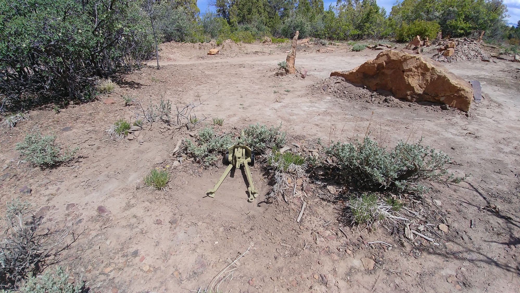

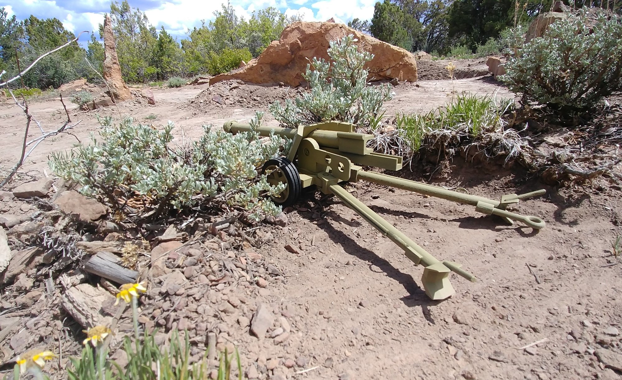

Hey Gary, No I do not have a 3d printer. I have a friend in Calif. who's business owns an industrial size one who printed the fuel drums for me. I also sent him the STL file for the Pak 40 you sent me. They can print it, but I asked them to hold off till I can tweak the file enough to fix the wheels and gun barrel. Both are "off" a bit. I did assemble the kit and now have ideas of other changes to the file that will make assembly easier. I downloaded a free 3d CAD program and I am learning the software now. I have 40 years experience in 2d drafting, but the 3d stuff is a little different. My old hippy brain has a flatter learning curve than most. Anybody who can send me by PM, or post here, the correct dimensions for the Pak 40 barrel size, and the correct wheel size, I would be thankful for the help, and can edit the file to fix the inaccuracies.
Here is the Pak 40 assembled and set up in Tankland covering the road to Sidi Bou Zid.
Who can tell us where Sidi Bou Zid is, and why it relates to tanks?

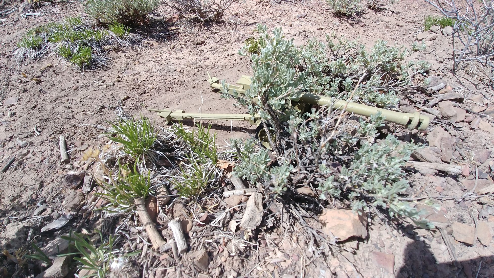

And here it is being reviewed by Rommel. He agrees that the design is not quite ready for battle.

Measuring my 21st Cent example (and scaling up to 1/16)
wheel diameter 55.7mm, 11.25 wide
Barrel overall 191.8mm (excluding breach assembly - that part is 28mm long)
1st barrel segment 61.8mm long diameter tapering from 10.7 to 9.6
second barrel segment 108 long, 7.7 tapering down to 7 at the muzzle break
Muzzle break 25.7mm long
Hope this helps..

Hi Guys. First, I'm really glad to see you were able to do something with the PAK 40, Paco. You did a great job. I think for what it is it should make a nice, cheap battlefield accessory, but we can surely make it better. And thanks to you, Ex-Pat, for the info. I've shown some of your projects around the new shop and all are impressed. When I say you used to live in Detroit the standard response is, "Well, let's get him back here!" If I get time (and who has any of that these days?) I'll try to use the scale features in cura to get the barrel and muzzle break to the correct sizes. Once we get it sorted to your satisfaction, Paco, you could maybe have your buddy do a few, or if you want to invest in a roll of filament I should be able to print you at least 5 or 6 more to scatter around Tankland. All that Allied stuff you've got needs more antagonists, right?

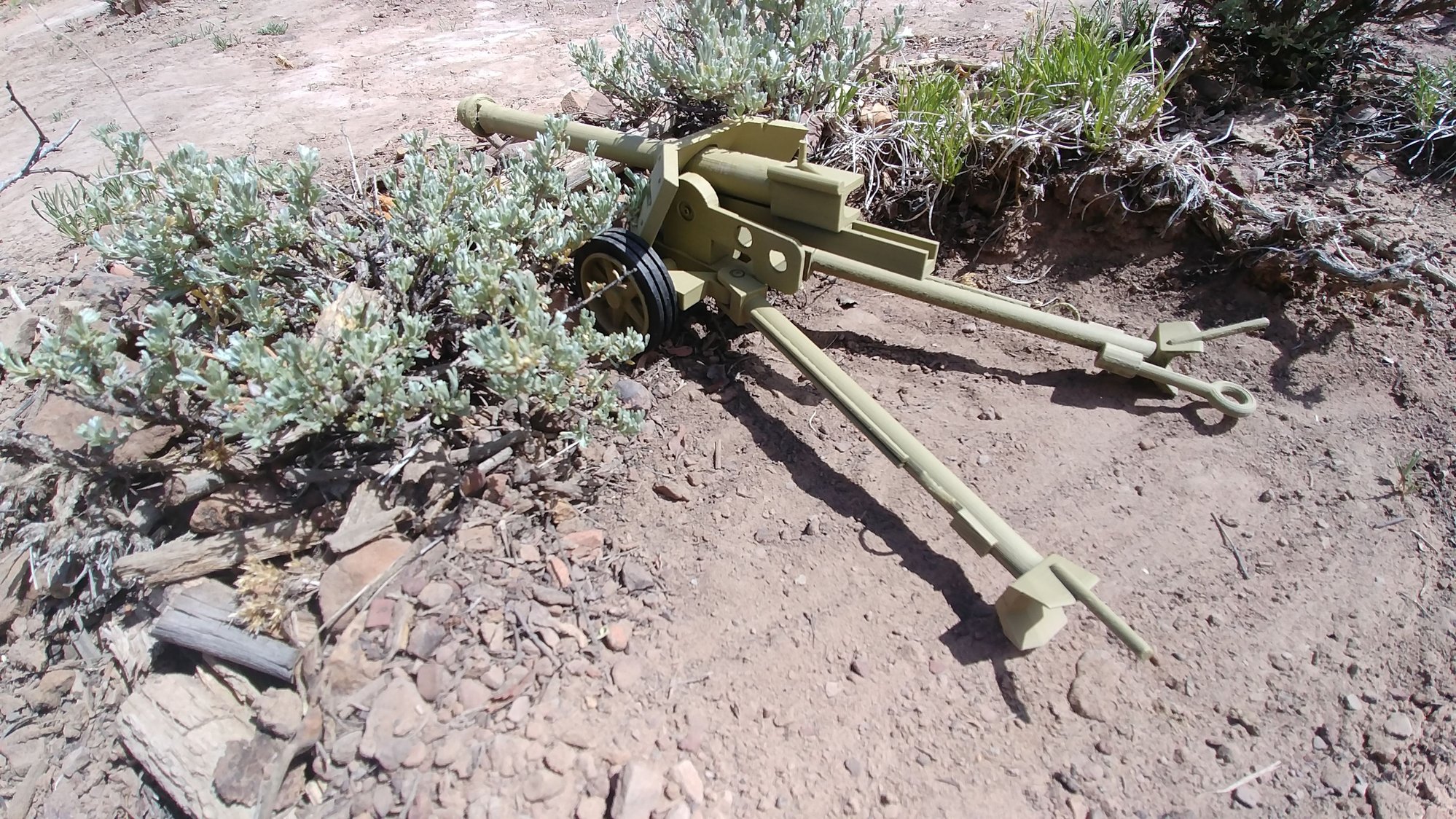

Gary, Is the barrel you printed on the Pak 40 hollow?
I just put it together as is, and did not bother to check if the barrel was hollow, or did I clean up the 3d printing texture, it was more of an exercise in the assembly method. If the barrel is, it would make a great IR field gun. It's low to the ground and easy to camouflage.
I used screws to put the trailing arms on, so they can be in towing mode, or be spread out in firing mode, and used screws to mount the barrel so it elevates. If I can make the wheels turn, it could be towed.

Yeah, it's hollow. It prints upright, as though aiming at the ceiling directly overhead. Takes from 5 to 7 hours to print, depending on how fine the print.
Considering what you had to work with, you did an awesome job. It's a pretty rough kit, with virtually no detail. If I ever get time I'd like to add the little wheels and levers, but for right now it's a "20 footer". Looks fantastic from 20 feet away and that was kind of the point. A quick cheap accessory that will look good on any battlefield. I like your idea of an IR field piece. Now where could we hide a servo to give it a bit of traverse?
