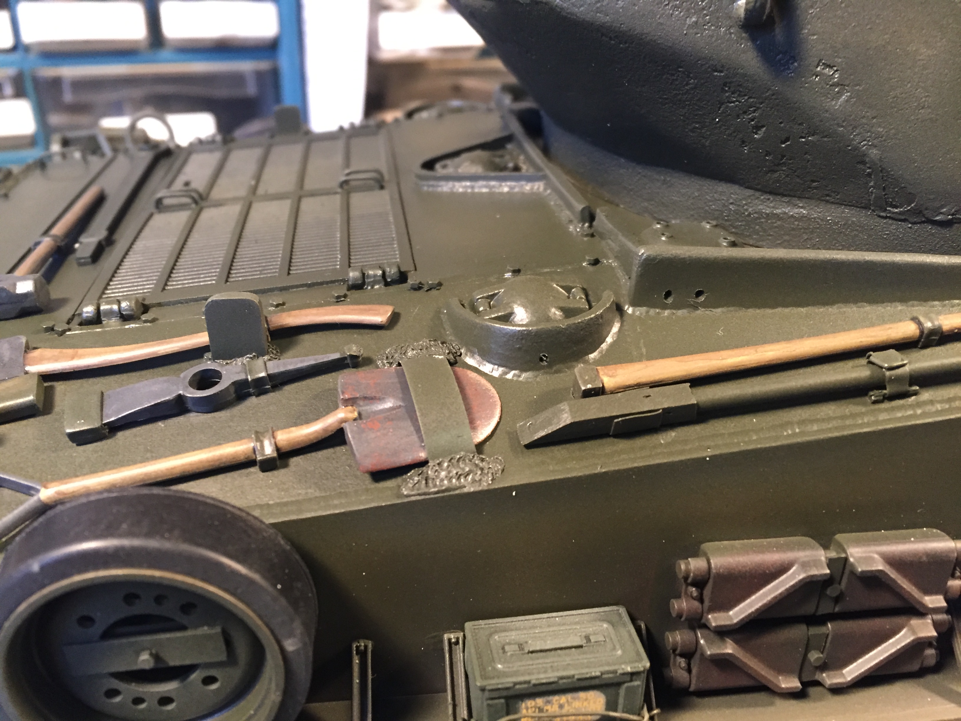

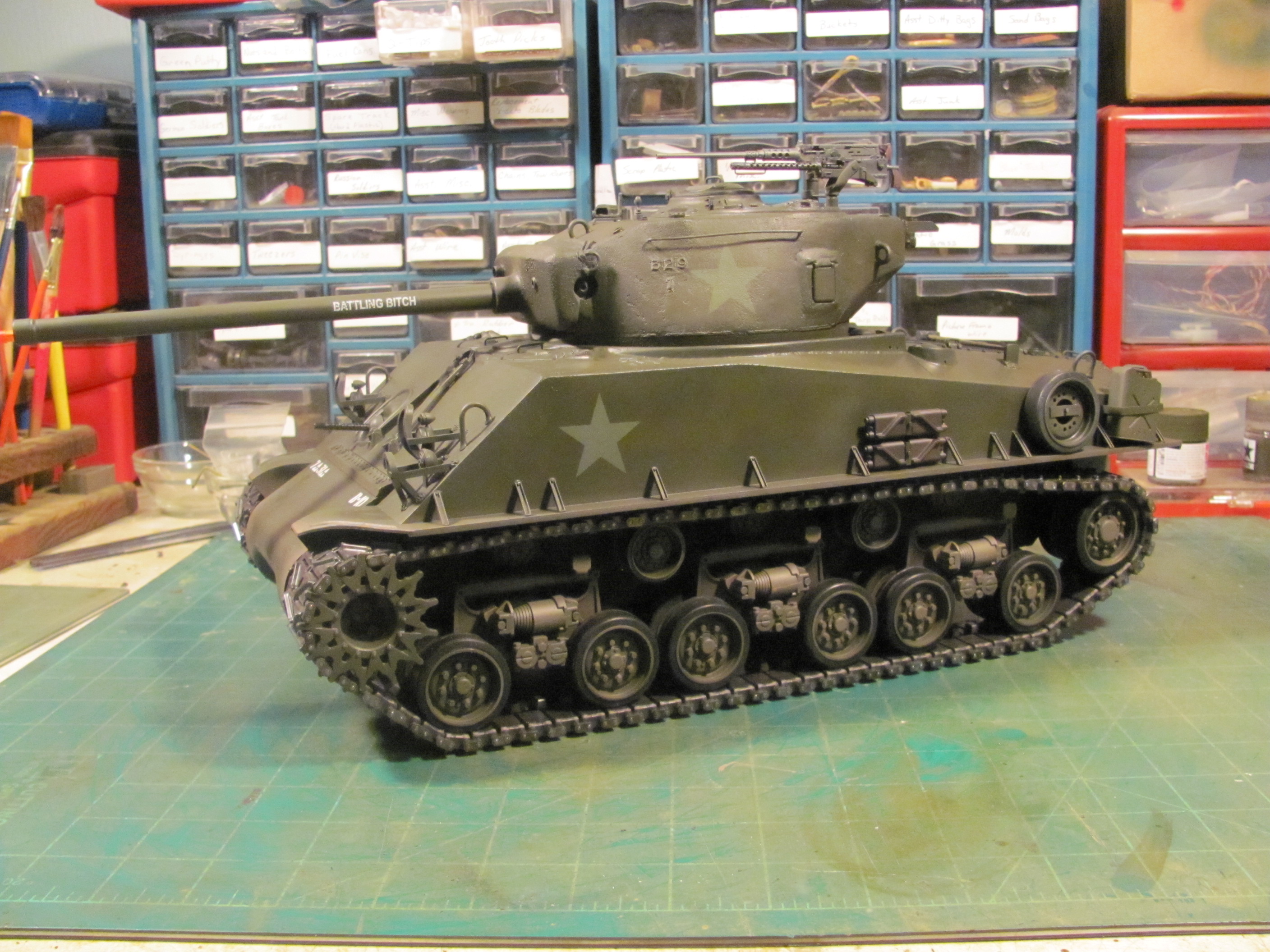

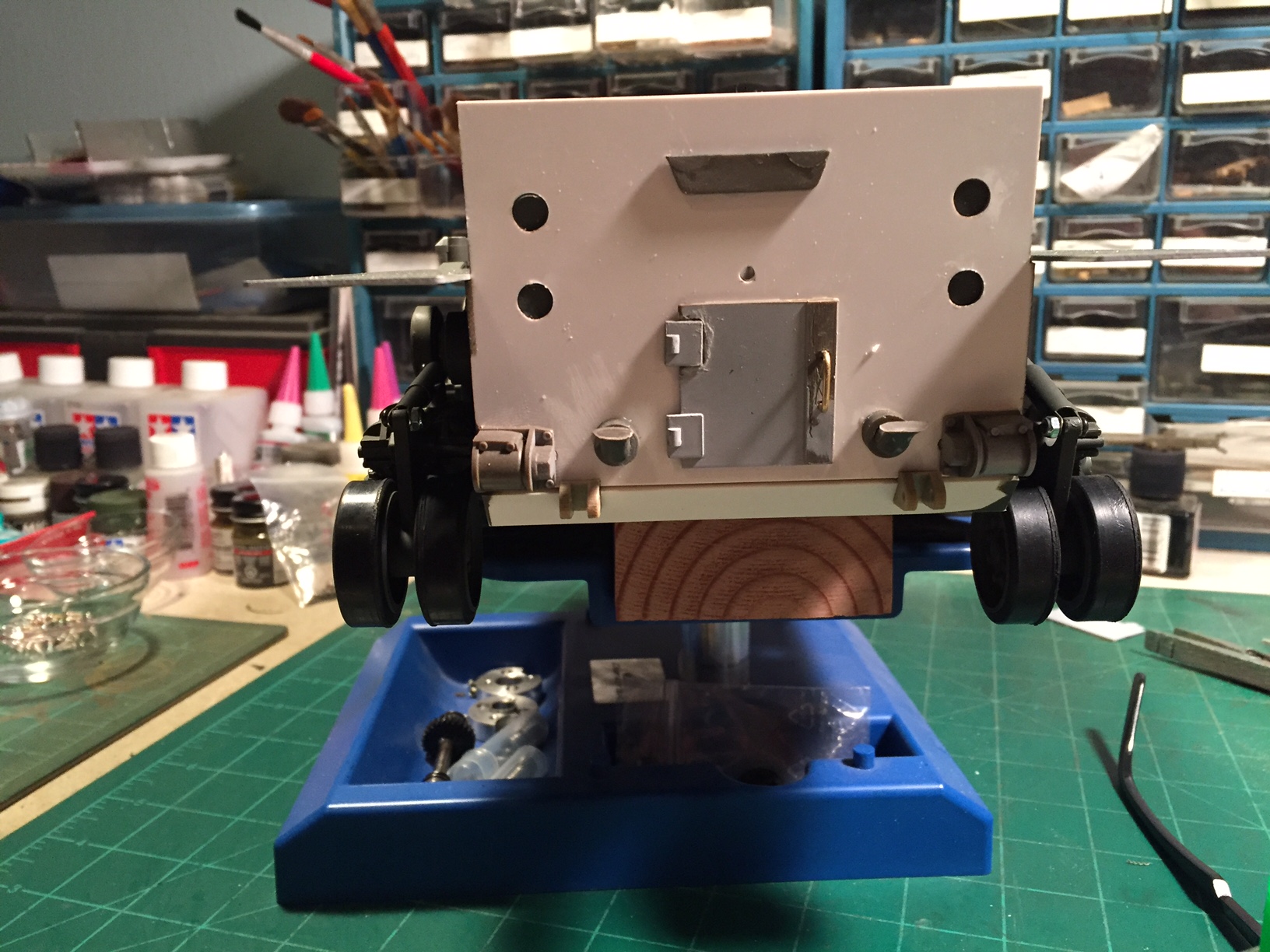

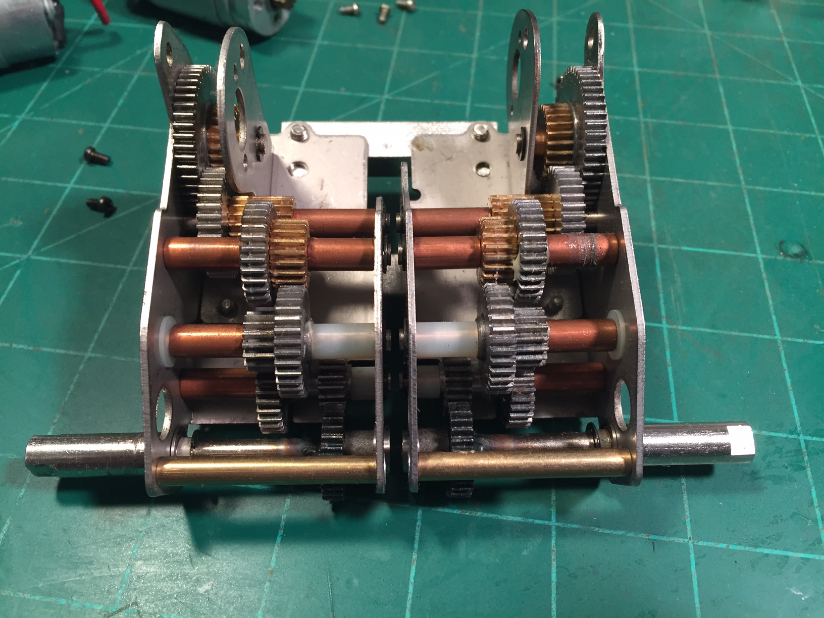

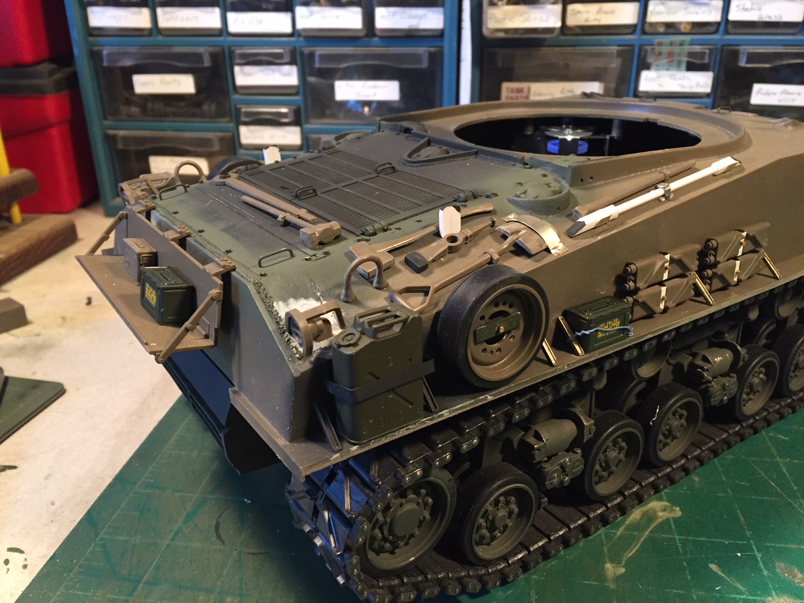

Well, is 2018 the year of the Sherman? seems like we have had a few Sherman builds on here lately, and though I am late to post, here are the pics of my finished EZ8 Sherman. It has Nick's rear deck and turret, ball bearings in the roadwheels and idler wheel, a Very Old set of impact gear boxes i bought from Custom RC models, and some extra detailing. the turret has recoil and the TBU base installed, this tank is battle ready! I did alter the rear hull plate with single access door and lowered exhaust pipes, luckily the defector hides most of it!
here are some pics:

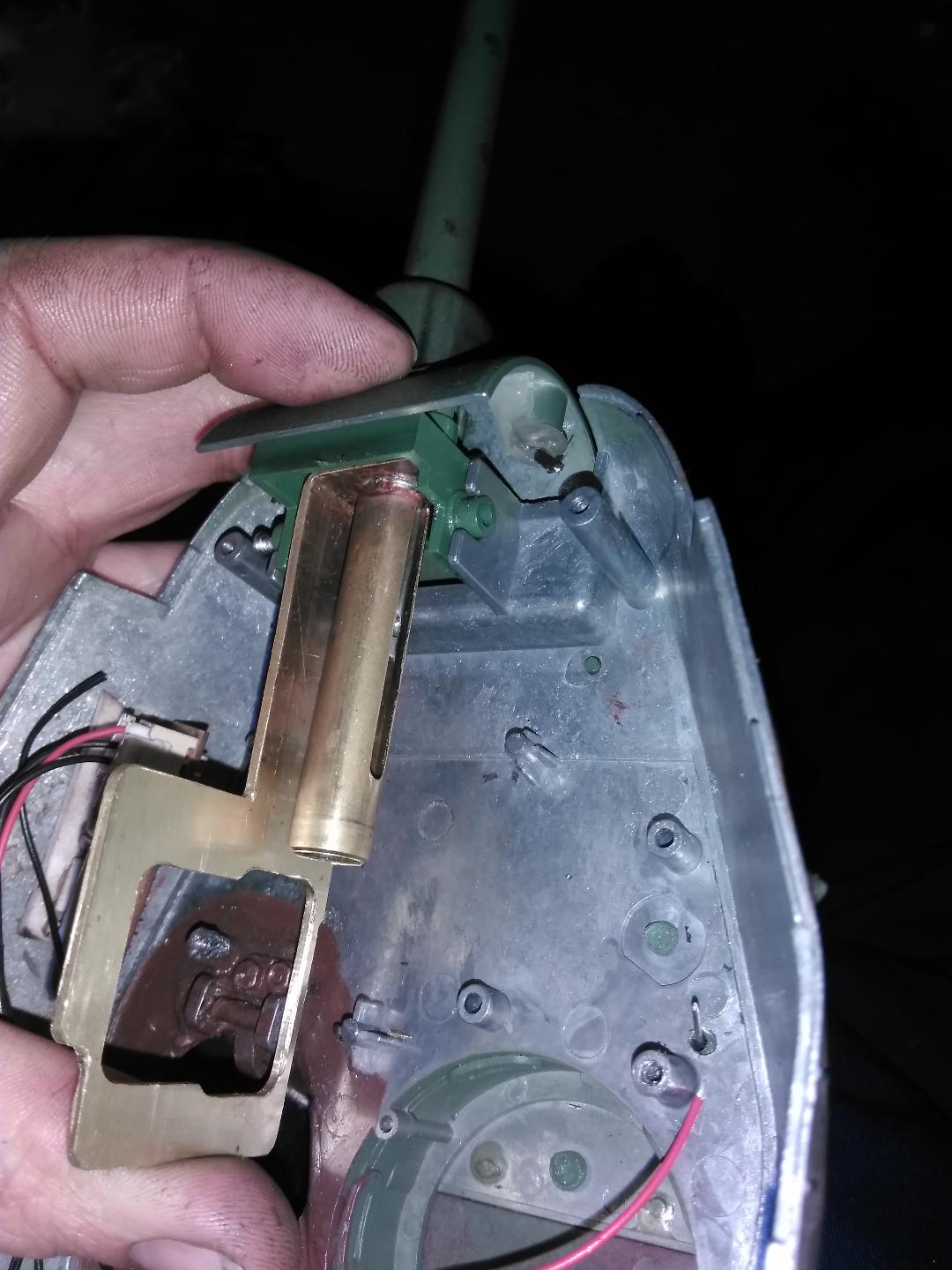

I am still curious on how you guys are doing your servo elevation/recoil brackets in Nicks turret.

This is a t34 I did, but same thing on the Sherman with Nick's turrets.

Very nice Sherman, it sure has a long gun barrel. Driving that around the battle field you will have to be really careful not to hit something! I really like all the extra deck detail you built into the model, very nice.

I forgot to mention I am running the Super Sherman electronics in it, which are OK, not the correct engine sounds, but it works for battling. The turret work I had contracted out, so i cant take the credit for that. The barrel i also had lathed for me, but i designed it with the barrel protector instead of a muzzle brake, that is why there is that bulge at the end of the 76mm gun. I started this build last summer, so it has been on the back burner off and on these past many months. One thing i had to do was to modify the tabs on the bottom of the resin turret, they seem to be too long and i has to sand them down and round the edges, which helped with turret rotation. I did primer the tank in Tamiya NATO black and the used Tamiya Flat white for the highlight before i painted in Tamiya Olive Drab as the base color. Normally I use a black wash and do some chipping and other weathering, but i didn't with this tank. All i did was mist the suspension and lower hull with about 90% thinner and 10% Tamiya Flat Earth with just a few drops of Tamiya Flat clear, then over the whole model i did the mist over the tank with about 90% thinner and 10% Tamiya Buff and a few drops of Tamiya Clear Flat. That was all the weathering i did, i think it came out pretty nice. for the this Sherman, i went with the less is more philosophy of weathering.

Here is a quick and easy little detail to add, there are little drainage holes around the splash guards on the hull, and a pin vise with small drill bit is all it takes to add them.

Nice, I remember Jimmy telling me about this detail, but unsure the A2 had it. Would you know?
Old 03-13-2018 | 03:52 PM
Joined: Mar 2009
Posts: 687
Received 13 Likes on 12 Posts
From: Lone Jack, MO
yes, they had them too!

The various shermans had drain holes all around those guards, some had one small hole, some had two small holes some had one big hole.
Details make the difference
