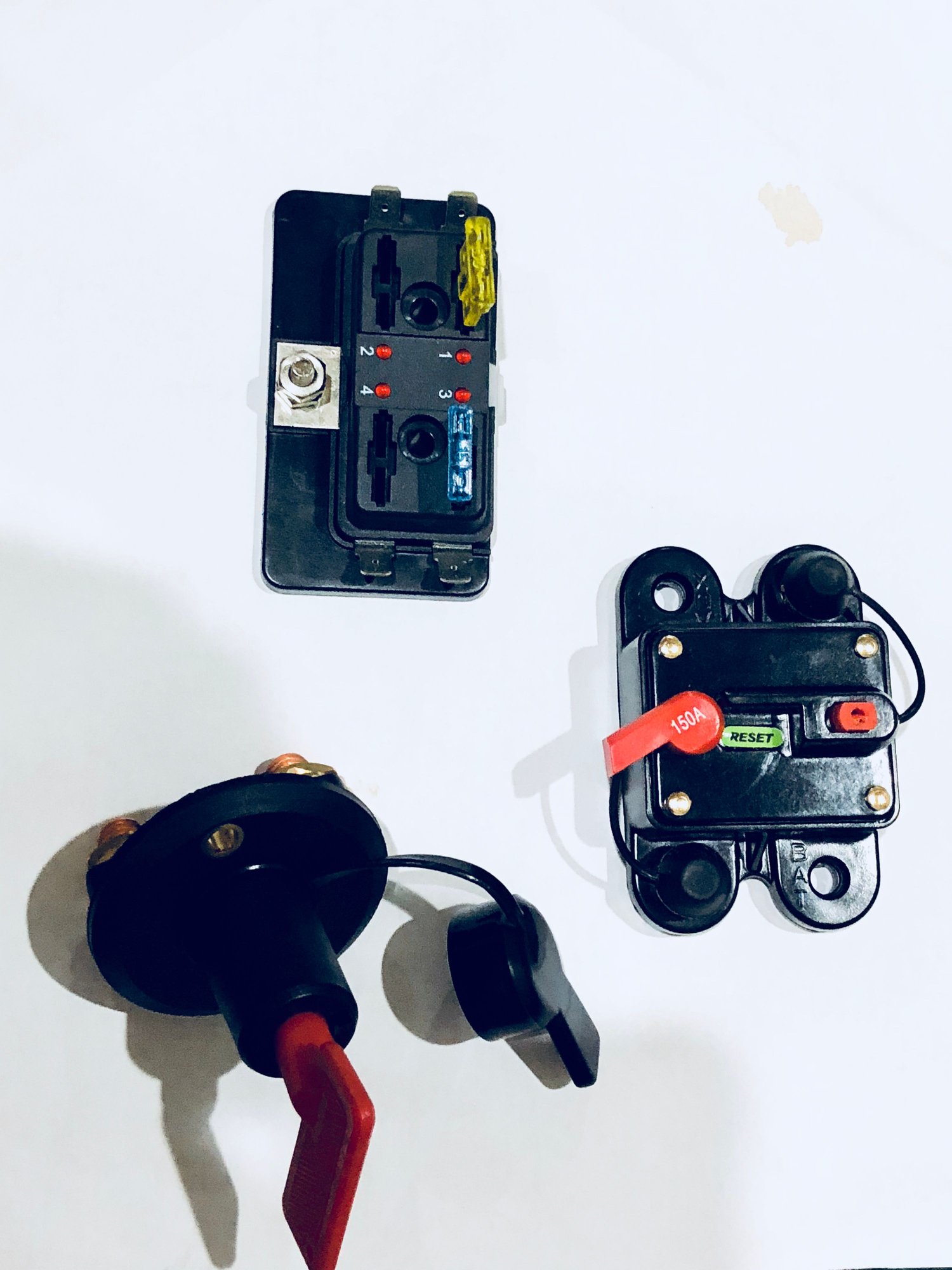

A couple of questions , over the last few days I have gathered some stuff. I got the reset switch and some wire.
I managed to gather some 4,8, 12,14 gage wire and I found a few fuse bars for 8 gage also they are big ! Are these overkill or will it work with the existing wires
12 gage power and 16 to motors . Would a 12 gage work in a 100a fuse block with holes for 8 gage ? I have been reading online but after a while it all starts to make no sense again lol.
i added a photo of where the fuse inverter switch will go.
Cheers Mark

Marcocaster -
You will want the biggest gage size wire from the batteries to the buss-bar, main switch, and power into the ESC. The wire for the motors can be smaller. What is the amp rating of your motors? Do they have a part number on them? Did the original/builder have any fuses on motor wires? What size are the fuses? It looks like the main track motors are 24V, but what amperage raring (MAX or Stall)?
I would start with main track motor amps needed and work back from there. Larger wire is better for carrying power - but at some point the huge wire gets unmanageable because of stiffness, size of terminals etc..
It looks like from the images of the original wiring that the main power wires were 12 gage soldered to the Vantec- so you could stick with that size, or go a little bigger (ie 10 AWG). Larger wire will run cooler (not get hot) and be able to supply more amps easily, as long as it fits into the terminals on the Vantec it should be fine. The motor wires do not need to be as heavy gage of wire (14ga) because their current is regulated by the Vantec speed controller.
You can use smaller wire on larger screw type terminals. I always tin the stripped stranded wires together -you can get higher clamping force on them (from screw type terminals) than smushing small stranded bare wires.
I also think the 150A may be too high a rated breaker for this model. That's a lot of amps going into the Speed controller if something goes wrong - you want to protect the electronics, not have high current ruin them potentially. Those are cheap - I wouldn't think you'd need more than 30-50amp version (or possibly less). The Vantec may have a current limiting shut off. I like the position of the main switch breaker - under the hatch for easy access.
All other secondary motors and servos (gun elevation, recoil, smoker fans etc) should draw much fewer amps than the main motors.
Bob

Bob , thank again and Yes the vantec is 12 gage , and I will stick to that and maybe use a little larger as you suggest.
The original owner had a 30 amp circuit breaker on it. I see what your saying about 150 too much I will find a smaller one.
As for my motors I have no clue ?? All I know is they are 16 pole 4 carbons each ? There is no brand or info on them.
Im
going to draw up a schematic over the next couple of days and see what you think before I begin any actual hook up.
Cheers Mark

When I hear 20, 30, 50 or 100 amps I have to believe very few electrical components of the type usually found in a model, motors especially
won't stand up long to that sort of current flow.. Peak or momentary perhaps. Admittedly I'm not an electric power guy.
I need anywhere from 5-12 amps, momentary to power the self starters in my models. I'm paying attention to this thread as I'm looking to
implement a hybrid transmission in one of my models; main power by a 4 cycle engine and steering via a secondary differential gear ( think Tamiya
Leopard 2 transmission) powered by a torque strong electric motor.
Jerry

Bob. Thanks ! I got up early ran to the marine supply store and got a few inline fuses. The glass type starting at 5 amp. Wires it up as shown in the diagram and nothing ! Could it be because I don’t have a ground to the chassis anymore. Oh boy this stuff is
frustrating. A little break then I will have another go !
Ok , I had another look and a wire wasn’t properly connected, I reworked and ran it on one 12v to test. It worked but the speed was erratic, after hooking the batteries to 24v it seems to have solved that. Holy cow ! I’m not going to get too excited yet lol. Will report back later. Cheers Mark

I hooked it all up it ran for a few seconds and stopped ! But as you advised it was the fuse. I started at 5 amp and it didn’t last long so I have put in 10 amp and so far it goes good slow. I still have one issue to work out when the tank power is turned on it creeps ahead without any stick movement. It’s a pain when trying to stop and turn it off it wants to zoom away, so if I wanted to add an on off toggle where would that go ? I am done the night lol. Going to have a run in the yard to see how it goes under a little speed. Cheers Mark

Its usually something simple if it doesn't work. I solder all terminals on the wires (even though they are crimped etc) to avoid the dreaded partial intermittent connection. 24V motors will need 24V supplied or they will not run correctly - they will not like being starved at 12V. The creeping may because there is some trim adjustment needed on your radio. Whatever channel you are using for the forward motion, adjust the trim down some. If using a spectrum each channel/stick on the radio has a trim button. Try adjusting that button until it doesn't move. It should not creep or move with no stick input. Also make sure you are using a self centering stick for the forward/reverse movement - a tiny amount of stick movement will cause the model to move - like with a ratcheting stick on radio (one that doesn't return to center). If you turn on the power to model w motion controlled by a ratcheting stick, and the stick is tweaked a tiny bit forward - IT WILL TAKE OFF!
One last thought - follow the proper turn on sequence protocol. Make sure radio/receiver is powered on first, then turn on model. Turning on model first can cause movement as well as it is essentially not controlled by anything until the radio is on.

I took it out for its first test run full out ! It’s fast and nimble ! No fuses blew etc I was having a blast !Well for 5 minutes then things stopped acting as they should and it started behaving like a ghost was driving it lol , I believe it’s time to finally look into Lipo batteries. The led acid are huge and if I can get a smaller battery that lasts longer that’s a plus.
I have to look into the Vantec to see if I need to make any changes for Lipo. Then the final thing is to get some sound.
I did find out some more info on my motors they are minertia motor mini series ugtmen-03lph22
A few ?’s first how would I hook the ibu2pro up to use like Gary did on his hetzer?
This is a stretch but could the newest version of Taigen electrics be made to work in the tank ? Since it now works w a hobby radio ? Not for steering but for smoke and sound ?
or maybe I should order an open Panzer board but I have an ibu2 here and would like to use that if possible.
