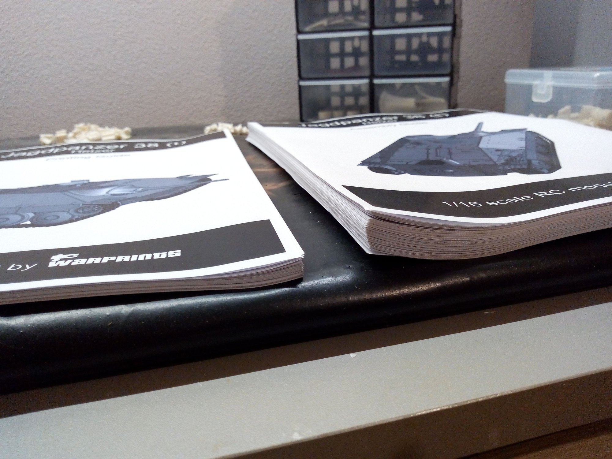

Have prepared printing and assembly guides, It was a huge task.Assembly guide is really big, containing more than 650 pictures.
You can see both assembly guides here:
Assembly guide:
https://drive.google.com/open?id=18L...cBIiZ1xlfTM2r5
Printing guide:
https://drive.google.com/open?id=1or...lPNBsvGUdBGvZj

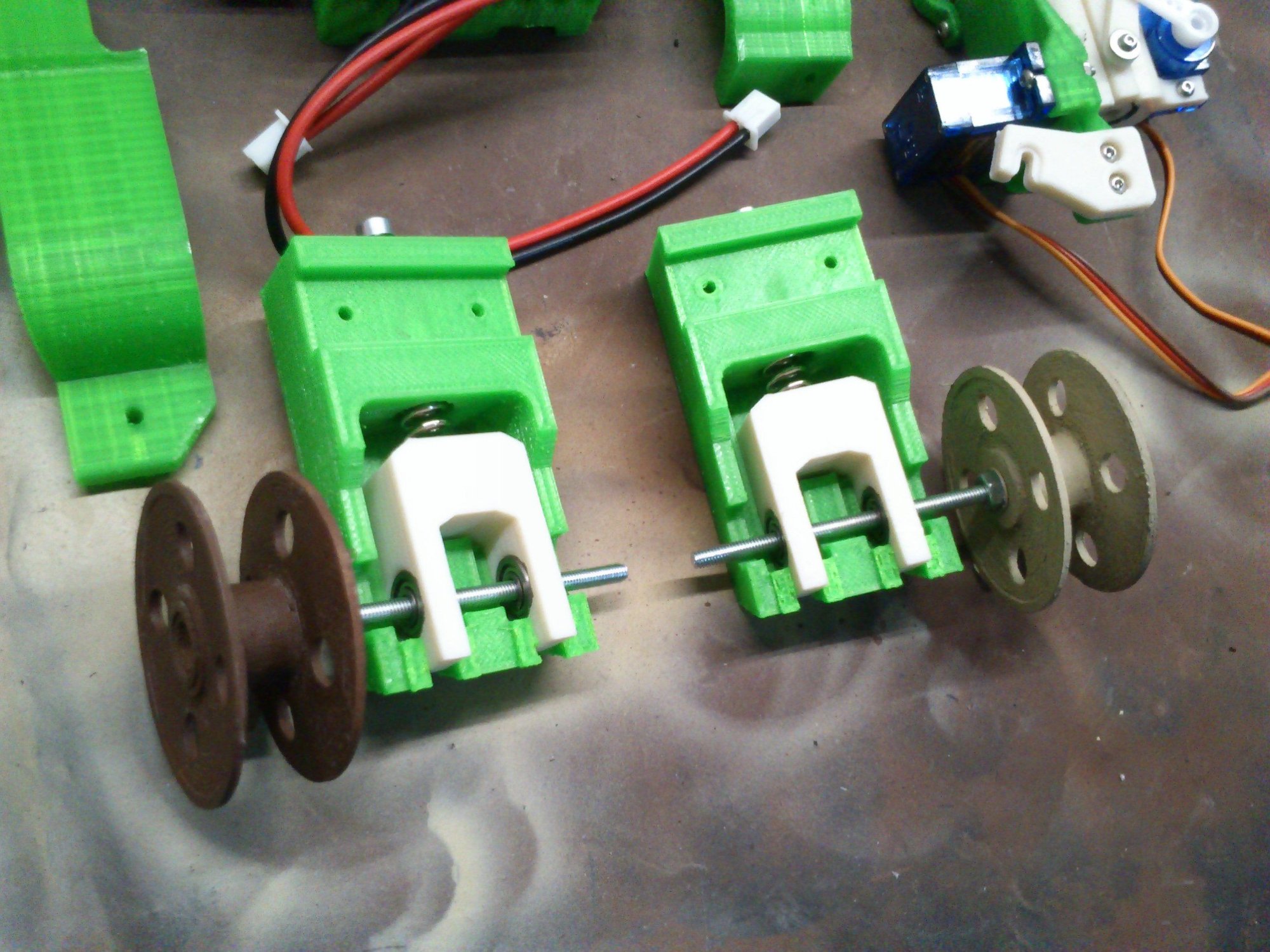

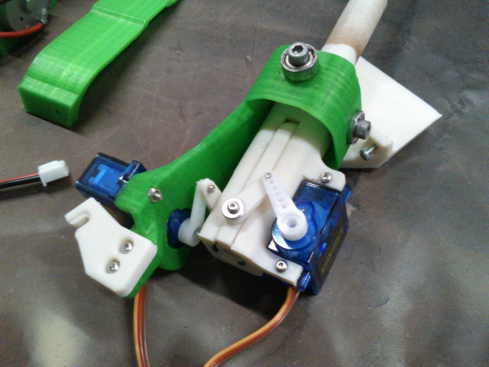

Hetzer is full of features and optional parts.
-all hatches openable
-servo controlled vertical and horizontal movement of the canon
-servo controlled recoil
-movable gunners sight coupled with gun
-alternative (simple) canon for low-end control units
-360° rotating machinegun
-ready for easy installation of the smoke generator
-LED light for the front light
-tracks tensioners
-working suspensions (different rated springs for front and rear)
-detachable spare track links
-rubber rims of roadwheels
-IR adaptor for HL/Torro IR battle system
-some of the most detailed parts comes with versions for DLP printers

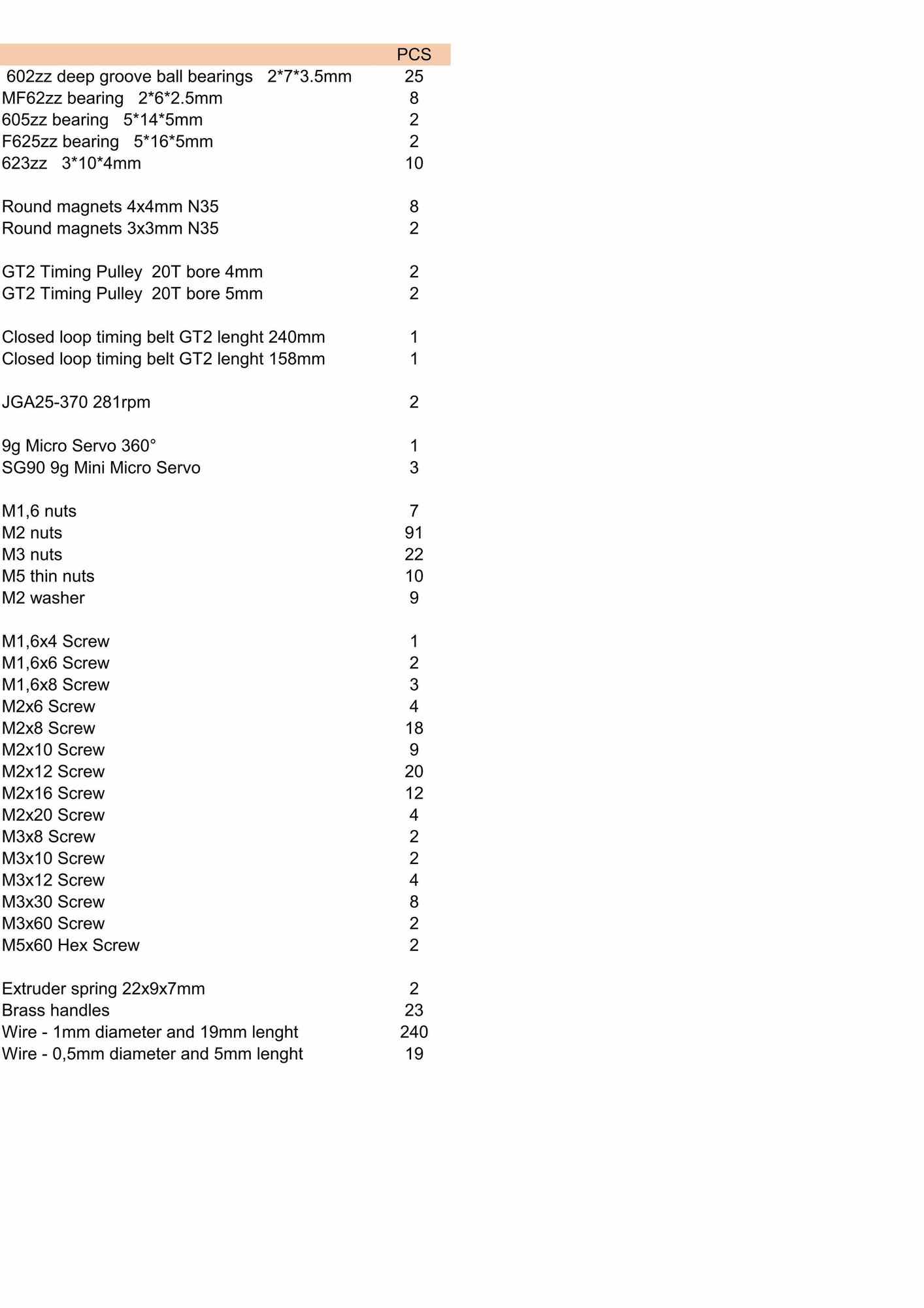

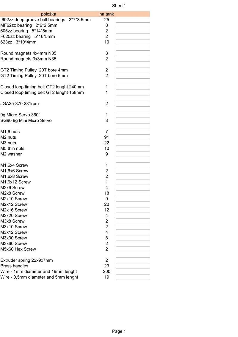

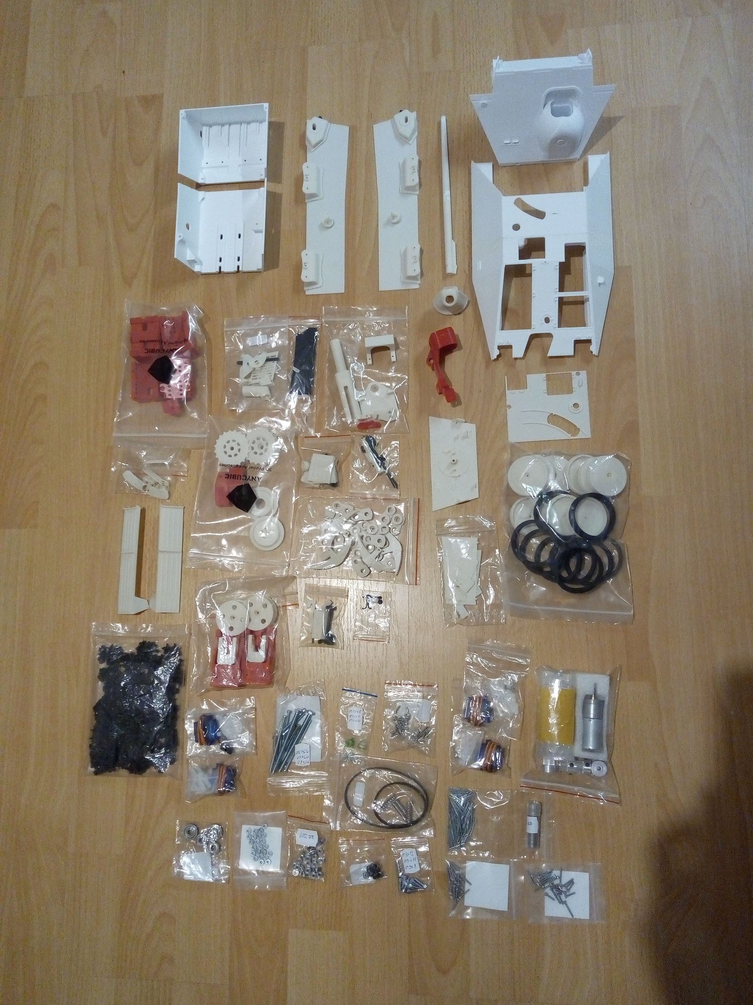

Here is BOM:
Builded vehicle contain more than 200 printed parts, 240 printed tracks links with pins and 345 pieces of various hardware.

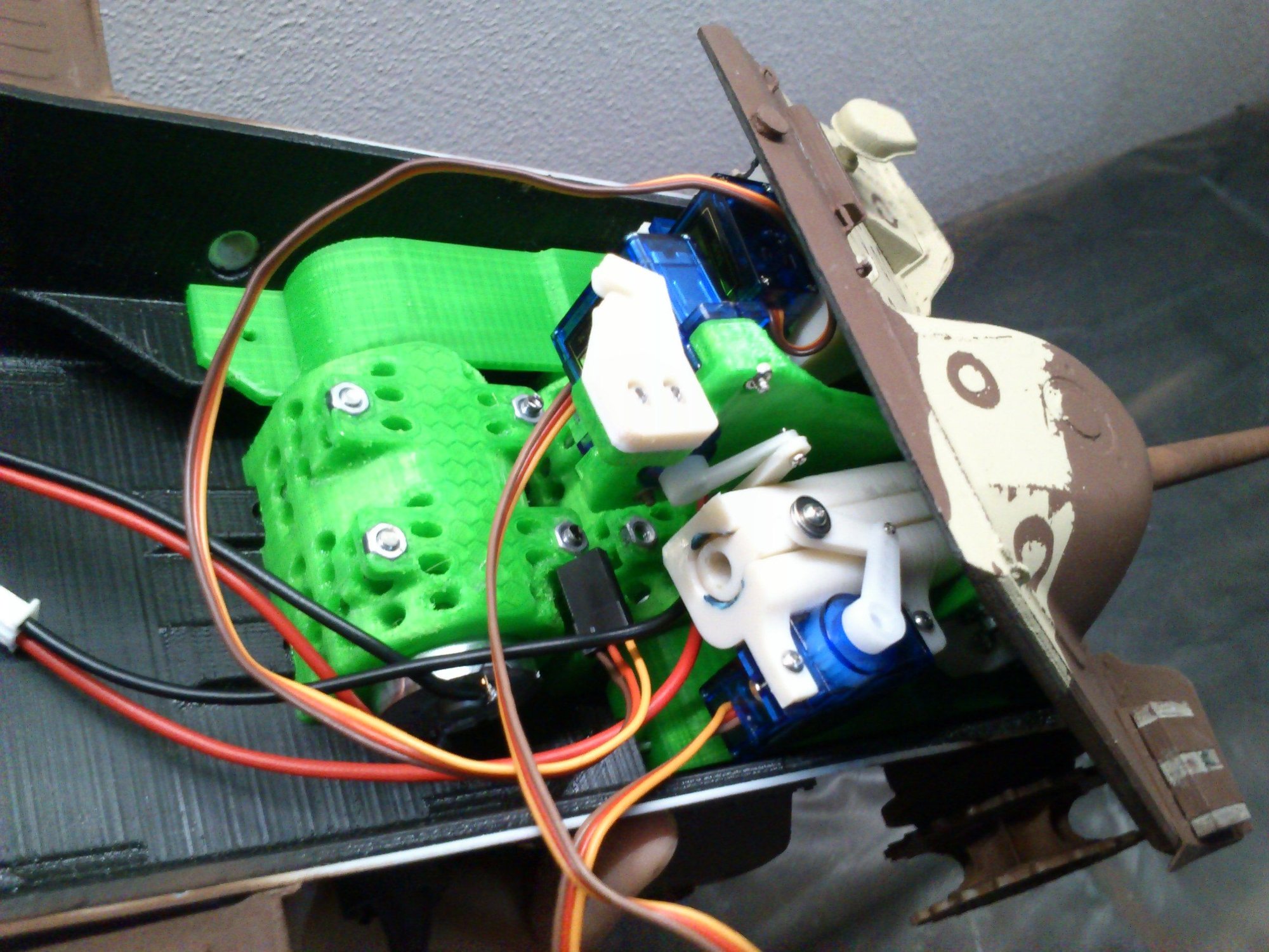

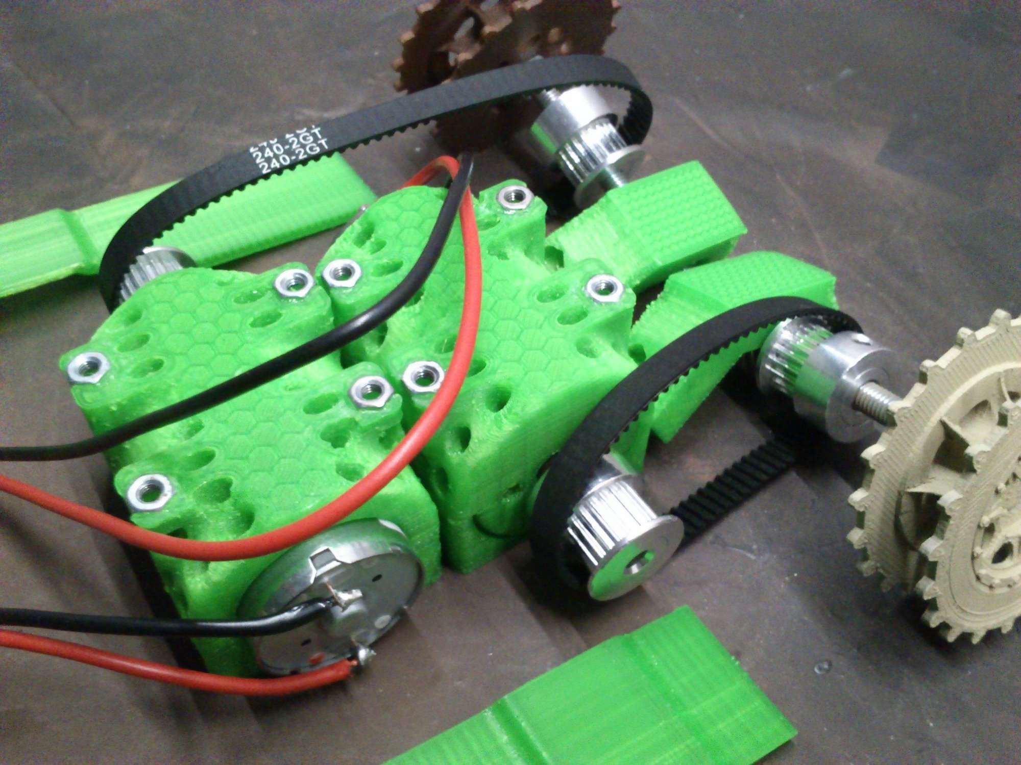

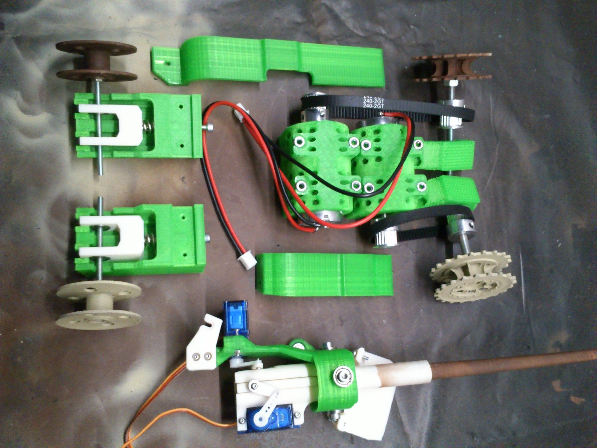

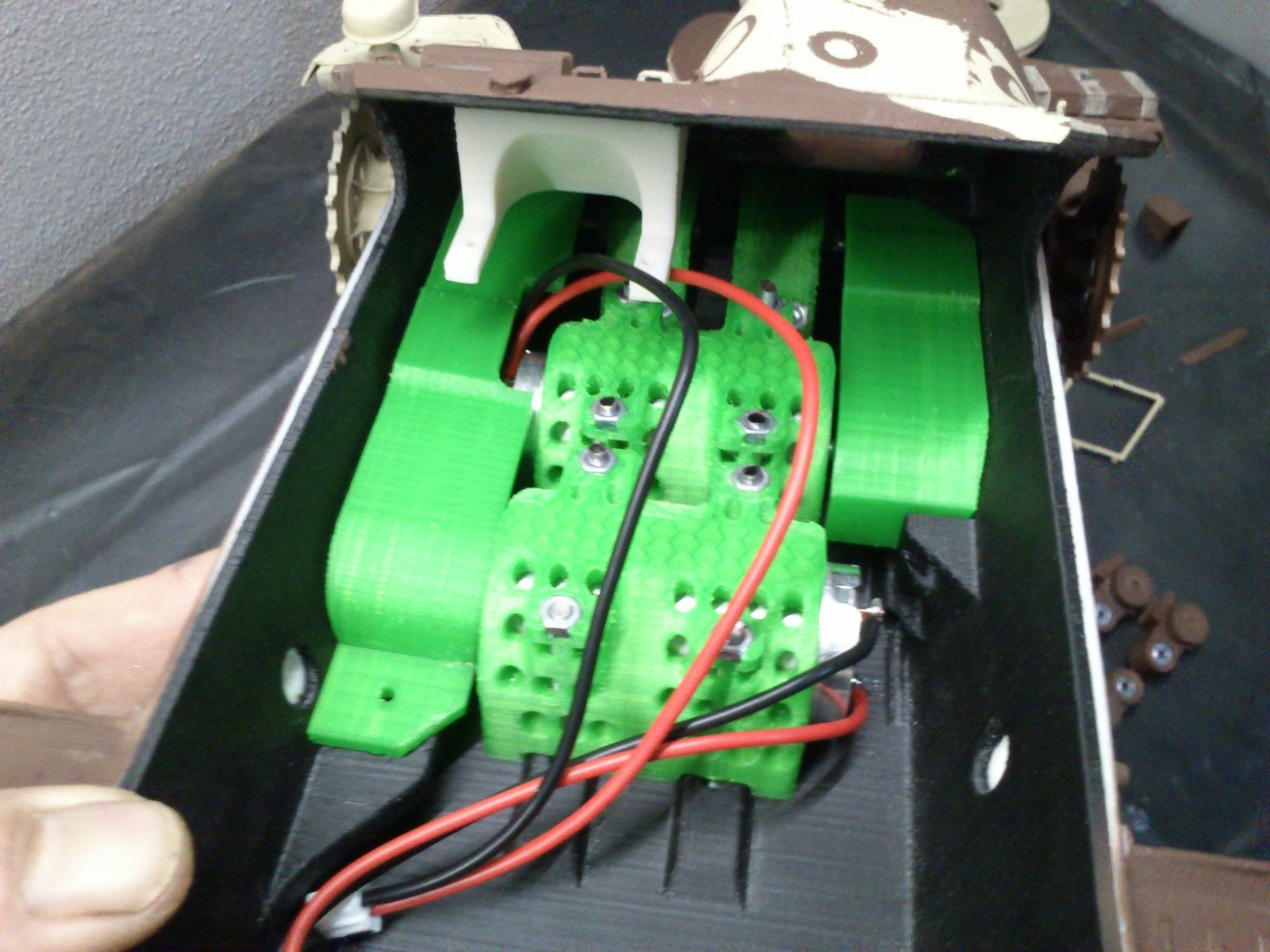

Here you can see some of the internal mechanics:
...and full kit with all hardware:

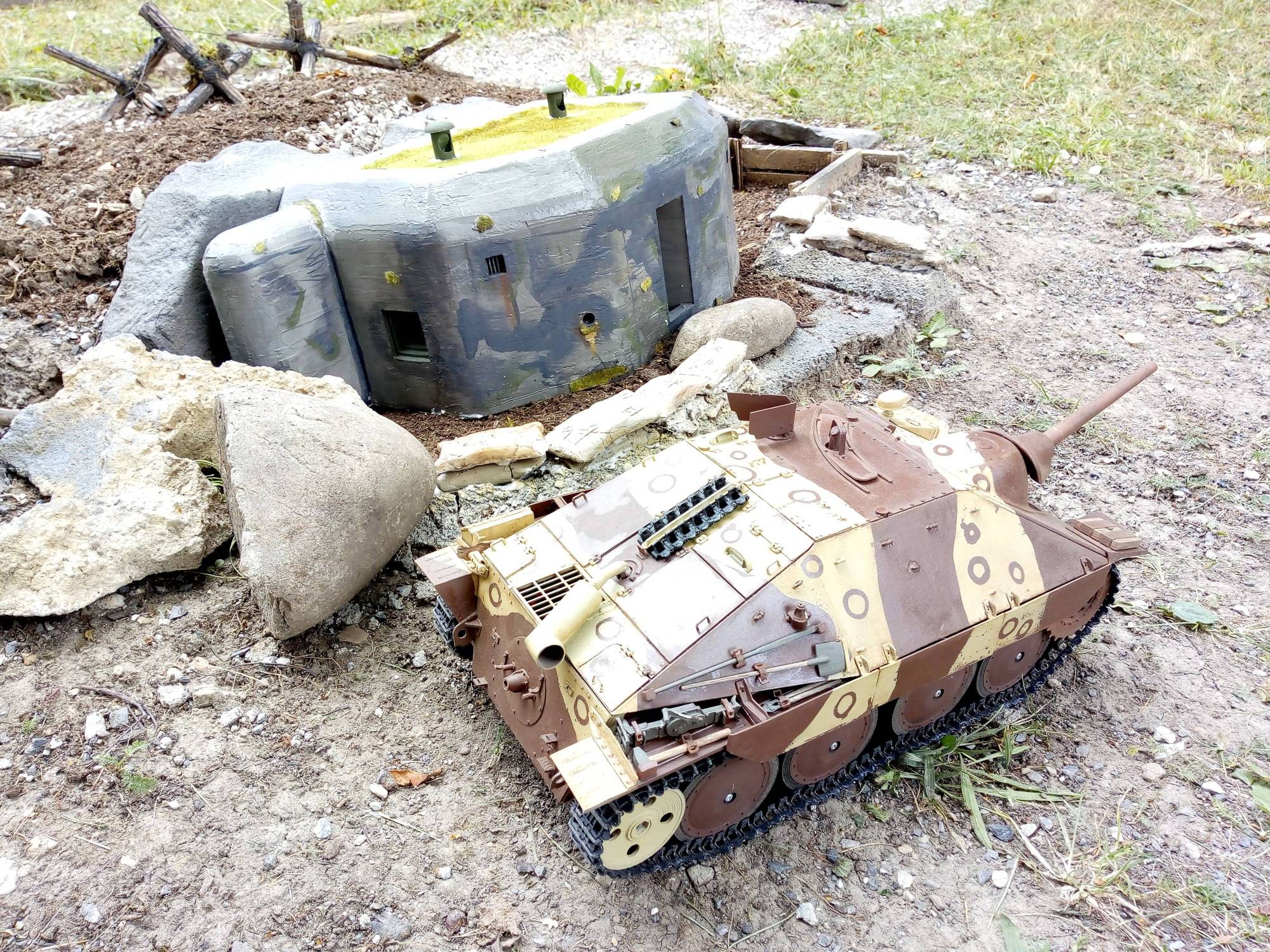

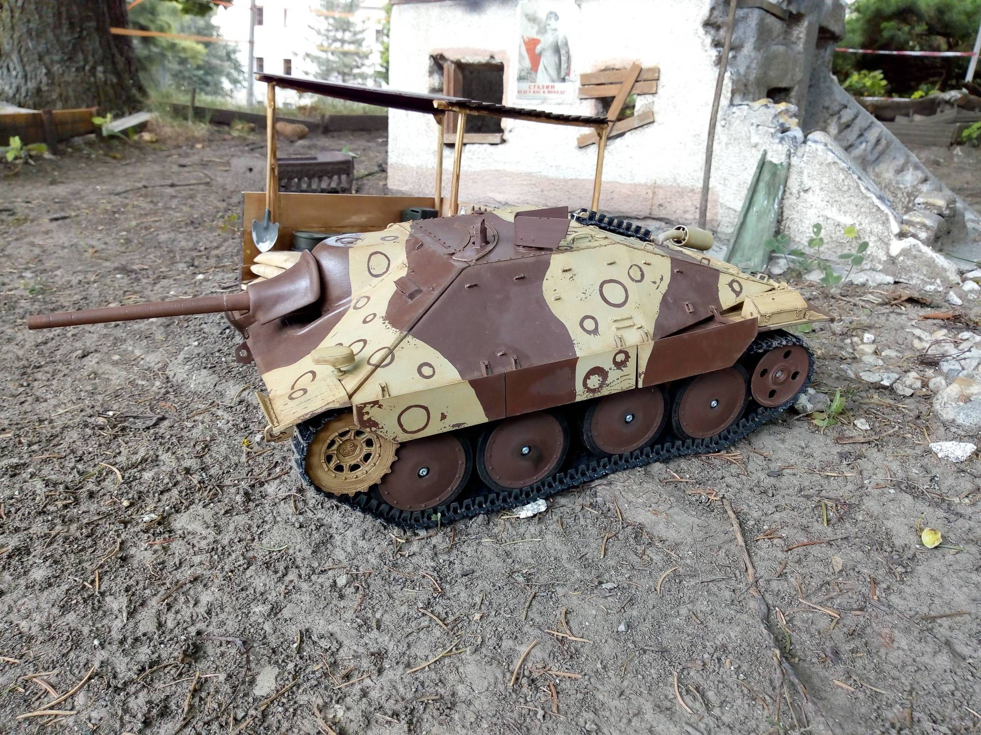

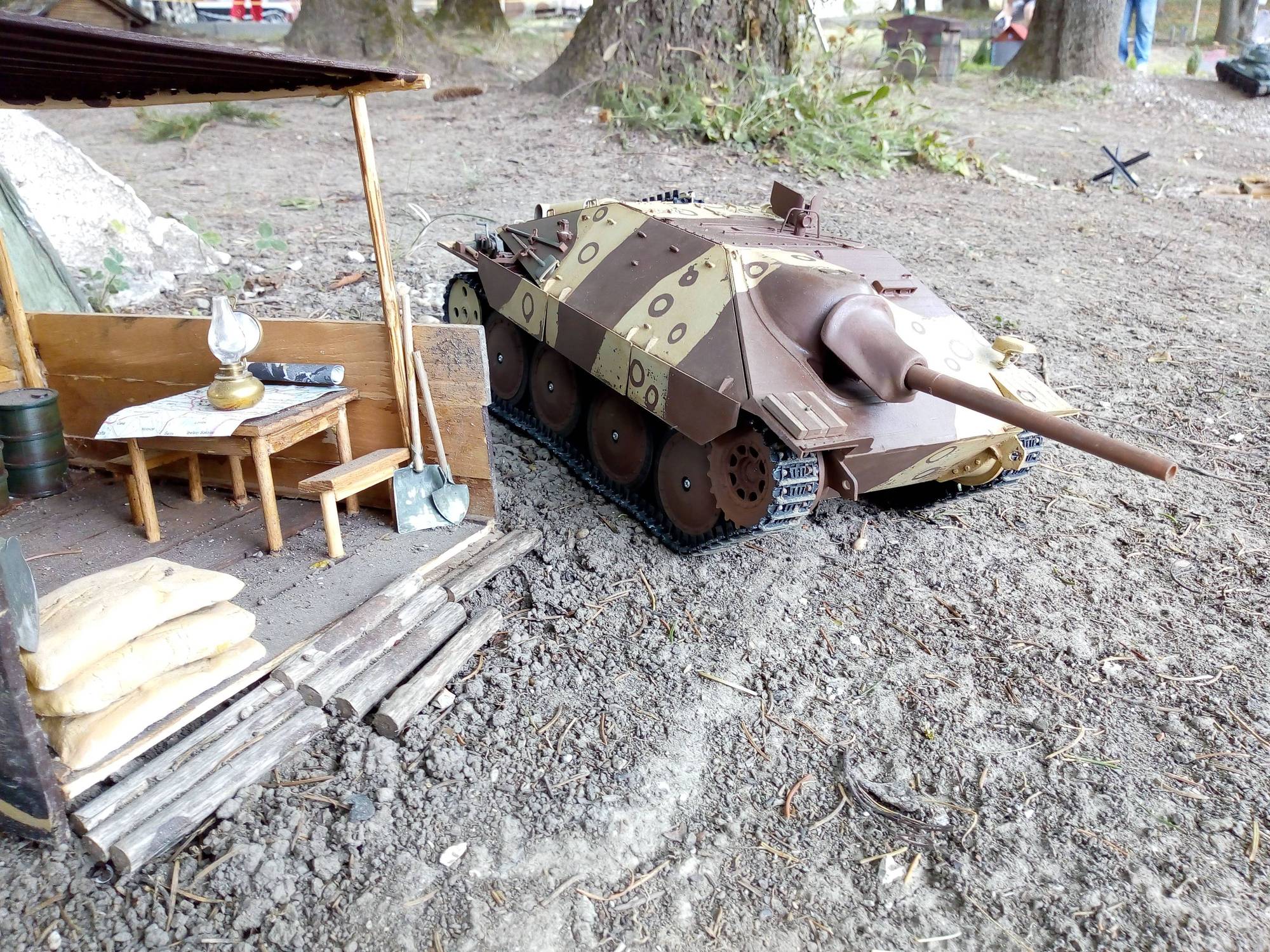

Its enough for one post, i think.Just few last pictures of my prototype Hetzer.

A lot of details are described in assembly/printing guide, something in that poor videos and photos.
What do you want to know exactly?What kind of details?
Be a little bit specific, i can give you all answers.

There are two options:
1. printed kit - contain more than 200 printed parts, 240 printed tracks links with pins and 345 pieces of various hardware (complete BOM).
There is everything for the building inside, including 4 servos and drivetrain.
Excepting control unit, receiver, transmitter, battery, smoke and sound effects.
2. STL files for 3D print
I am using Elmod.I love that control unit.Combined with FlySky th9x with OpenTX firmware.
You can use any control unit, there is even optional (simple) gun for older RX-18 and other low-end boards.
Printed tracks are available only for kits.Sorry.
I can print and send some of the another parts for individuals, but please, no tracks
Every single track part must be cleaned by the hand.Its long and hard work.

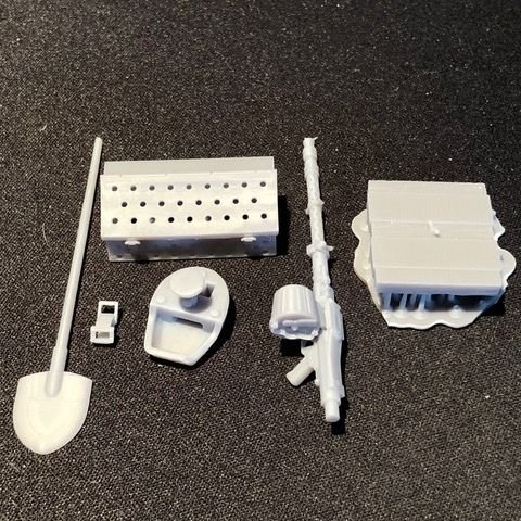

About that resin printers - YES.Definitely.There is even special group of files for DLP/SLA printers.
There are some of the most detailed parts, reworked to be even more detailed and optimized for DLP.
Including MG-34, early toolbox with holes etc.
I am using DLP/SLA printers even for kit.There is a high number of DLP printed parts.

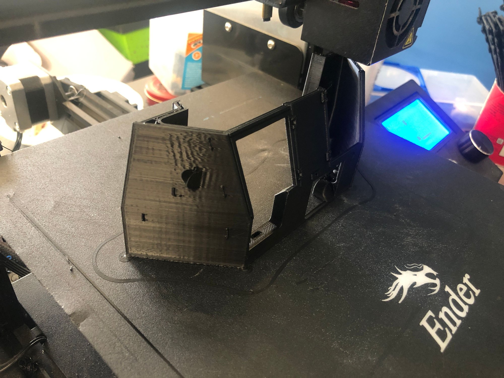

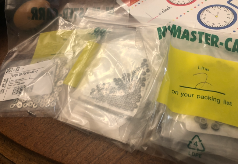

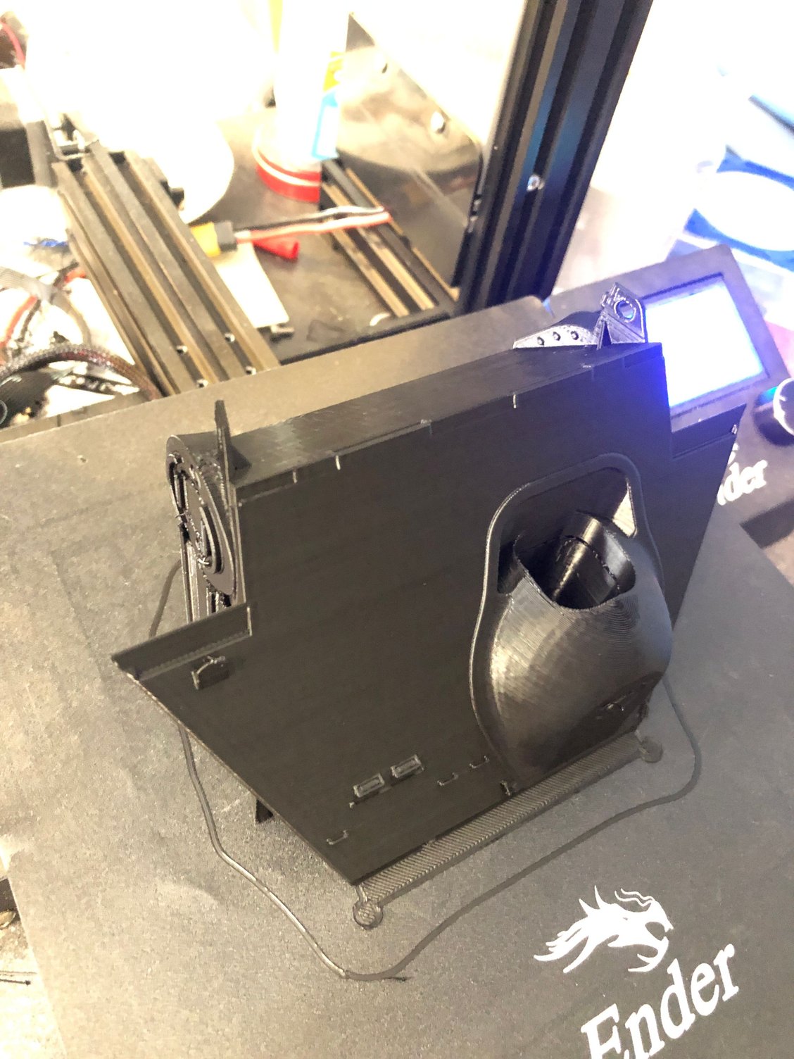

So I started one of these as a side project and a learning tool.... I've printed some of the big pieces and started collecting the hardware.... All I can say so far is WOW....
I started ordering the hardware and bearings off the inter web and holy crow, that's a lot of stuff! I'm about $175 in and haven't even got the motors or servos yet! (I'm ordering enough for two so don't be too alarmed yet....)
Im using my Ender 3 pro and the glacis took me 28 hours to print!!!! (I'm adjusting the setting as I go so bear with me!)

Looks great.Thank you for the pictures.
Yes - there is a lot of hardware.
It can be a little bit hard or pricey to get all that hardware, depends on the country.
Right now and here (Slovakia), price of the hardware for one kit is about 58€ (Chinese stuff).
I have still only limited amount of hardware in stock.
Going to order more and more hardware, because i want to offer complete packages to make building easier and cheaper.
Dont want to make money on this, just make things easier and accessible.I hope it will be available soon.
P.S.: Hardware for the 1/6 version will cost 80-90€ (Chinese stuff).
This is the complete list of the hardware for the 1/16 version.

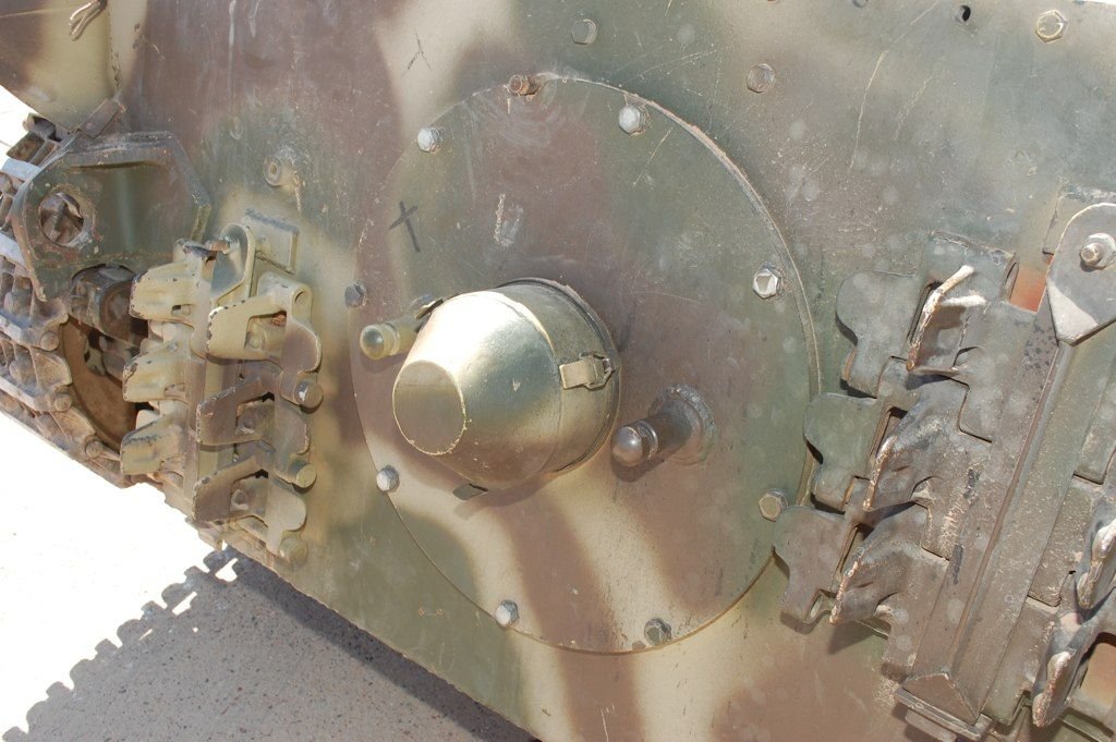

Nice! Love seeing close-ups with details such as that ragged edge of the plate.
I have purchased the tank and I want to try and SL print the tracks in ABS Resin. Any chance of uploading on the purchase site a track link without the support parts? My CAD program is having trouble dealing with the part and I am not up to speed in Fusion 360 yet.
I have already printed some of the detail parts in Resin.
Kevin O. (ksoc007 on Cults)
Thank you. I used a Prusa SL1 and cranked it all the way up. The main gun barrel (not shown) was about 4,000 layers! Took 11 hours but I love the quality.
