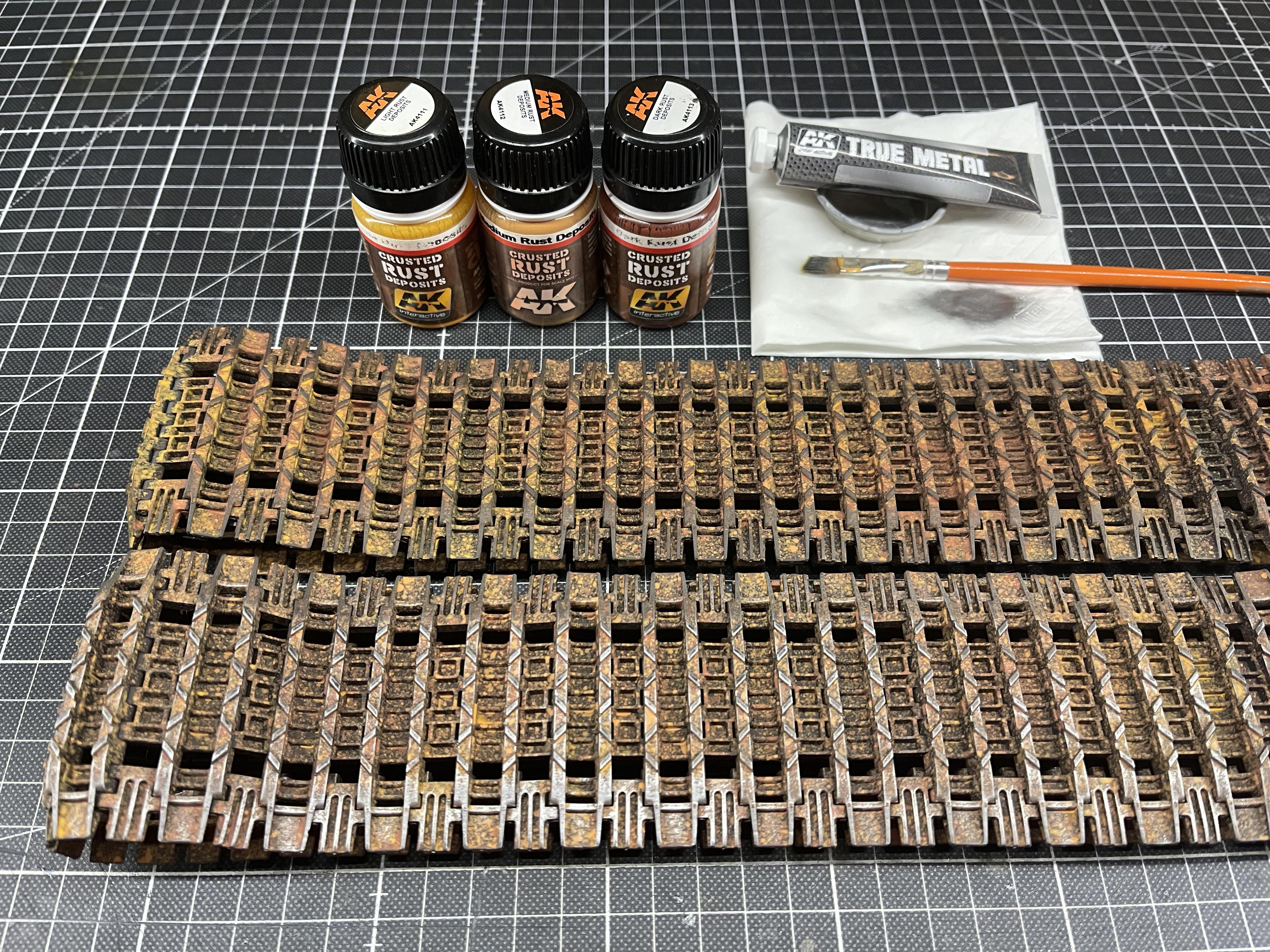

Kinda wondering but every time the Centurion struggles when Rock Climbing with one Track slipping the other Track seems to not be moving obviously hindering the Tank from progressing - Is there perhaps an issue going on?
Just found this gem on the iNet about a "Hush Puppy" Track Variant for the Centurion - Maybe something that could be retrofitted to the current Tracks using 3D Printed / Moulded Pads?
With my E-100 and its cleated Tracks I'd probably be fighting the exact opposite problem of too much traction on any surface other than a wooden/stone floor/table:
I'm expecting the Drive Shafts to immediately be stripping the 3D Printed Drive Sprocket Adapters ( despite their Contact Flats being reinforced with Screws ) if I ever drive it around in the Wilds.
