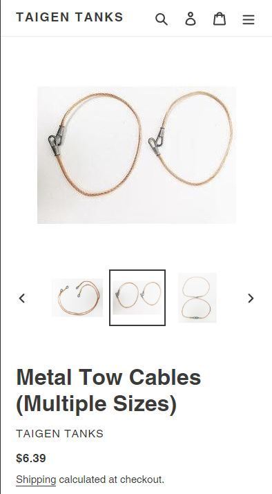

Have you tried Taigen Tanks? They have some very nice Russian cables for just $6.39 a pair. As for chain, ebay is a good source, try searching for doll house chain.

Hmmm, I just checked it and it's working fine for me. I'd send you a link but I don't know how to do that on my phone. I just did a google search for taigen tanks and then clicked on taigen tanks. You can also try imex model company. When I get home I'll post a link to their tow cables.

I've found some crafting or picture hanging wire and jewelry chain from craft or dollar stores works pretty well for 1/16 tow cables and chain, might not be exact but it does the job.
You can get 1/16 Soviet cable heads on Shapeways but they cost more then the whole cable from Taigen.
https://www.shapeways.com/product/RA...ow-cables-set1
https://www.shapeways.com/product/HK...e-heads-set002
EDIT:
Here's the link for Taigen: https://www.taigentanks.com/collecti...multiple-sizes

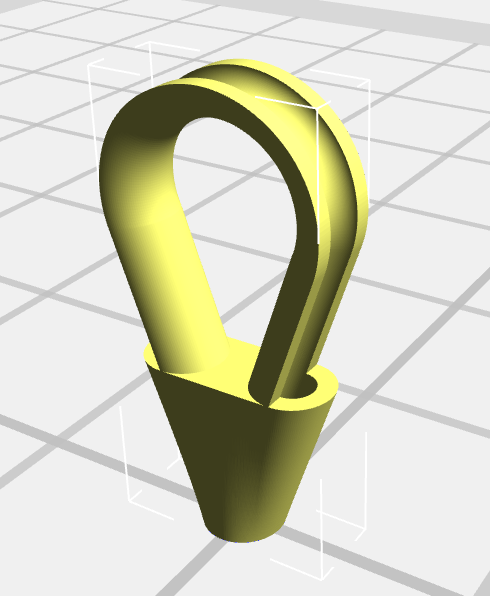

I ended up modeling the end that came with the Heng Long KV-1.
Made up a cable by twisting some copper wire in my drill.
As soon as it finishes printing I'll put it together and post a pic.

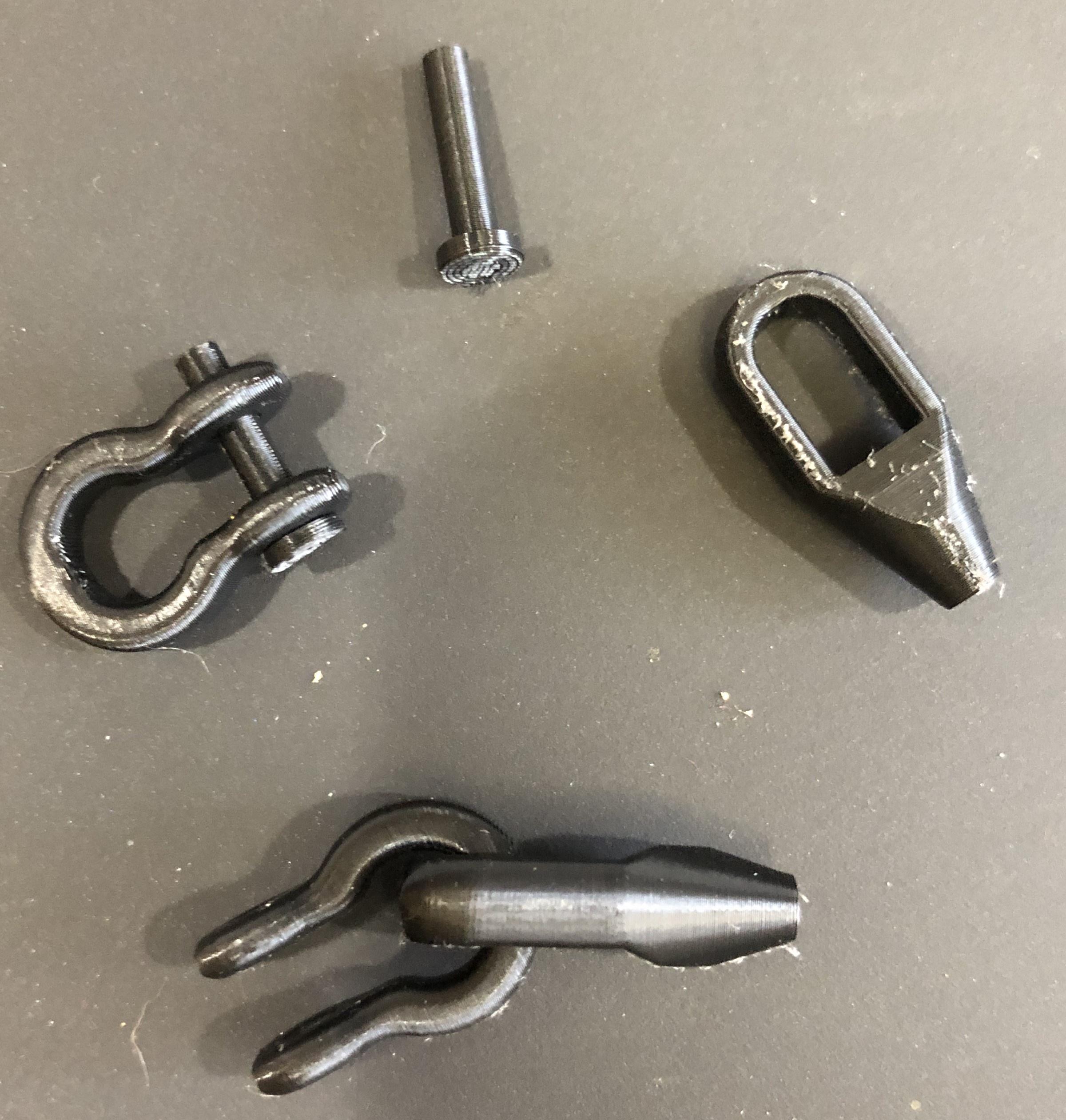

Finished printing them and installing.
I made the eye very slightly bigger so it would actually fit on the Heng Long KV1 tow loop. The stock one broke going on which is why I'm in the fix I'm in.
I'm probably going to modify the design slightly to put a fillet at the base of the cable arch so that it's not so prone to breaking off.

I also printed some new U hooks for my Jagdpanther. These have actual clevis pins (I melted the end to stake it) so hopefully they won't snap off and get lost like the snap-on hooks do.

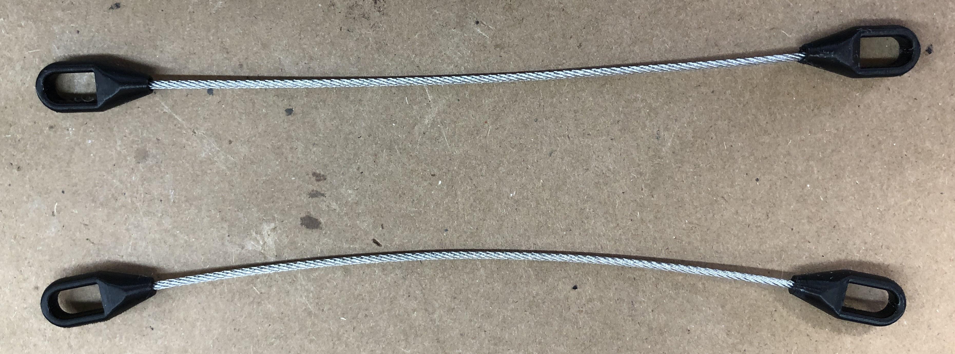

I used the 1/10th scale KV-1 model to get its tow cable ends. I modified them a bit to make them 1/16th scale, and I also added some internal "teeth" to the cable cavity for the superglue to dry and form a plug that won't easily pull out.
I modified the size of the tow hook to easily fit on the Heng Long shackle.
I also modeled up a shackle that uses a pin instead of the snap-on shackle Heng Long provides.
The models are available here:
https://www.thingiverse.com/thing:6528232
