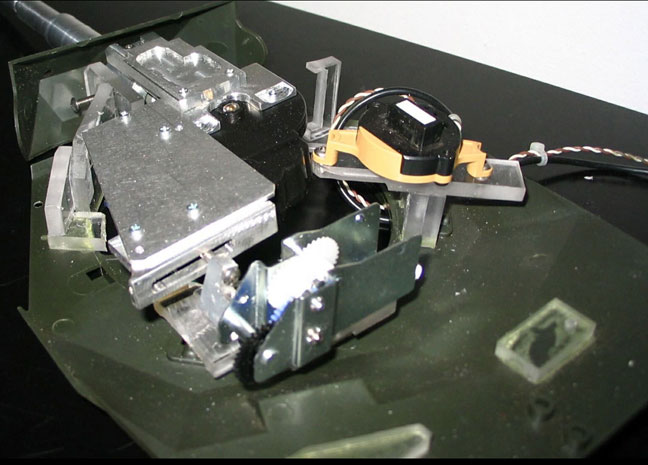

I think the Leopard 2's MFU has a special way of powering the motors so I dont think it will work with conventional gear boxes. One motor turns the tank and one drives it forward and backwards. i cant see this being able to run the way we are used too.
Panther G is right, unless you use the Leopard 2A6 gearbox also, you can't use the Leopard MFU and DMD.

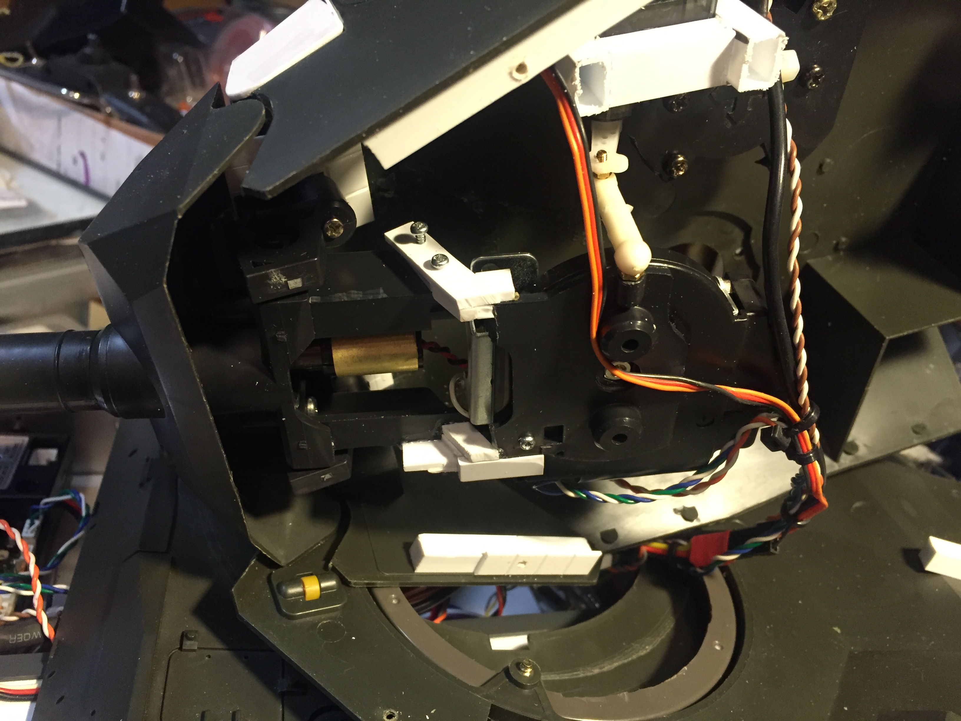

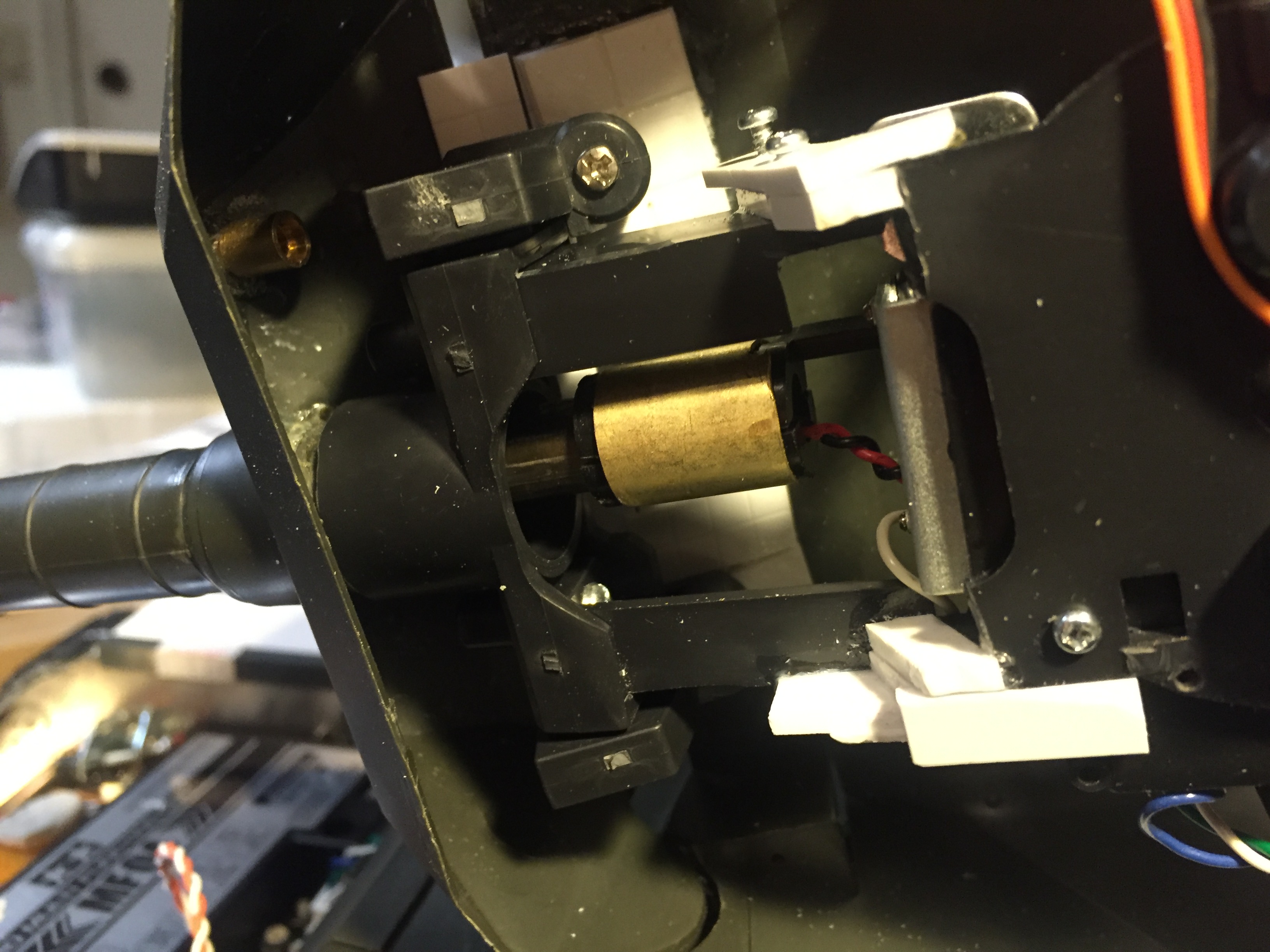

This project was a bit of a curious happenstance as I remember wanting this kit in the early '80s but never really made the effort to own it. I happened upon a good deal on ebay about a year ago with the metal track and I couldn't resist. I added Tamiya Panther Gearboxes and Jagdpanther Electronics (they were on sale--- thank you JR-RC) Servo elevation and upgraded Tamiya traverse with a faster motor. Gun tube was surgically altered and a King Tiger recoil was added (only one in my spares box)
Elevation was replaced with the components from a Tamiya Leopard 2A6 and the recoil tray from the same was altered to align with the gun tube and KT recoil. I tried using the Leo 2 recoil but the motor seemed to only go half speed in its un modified state with the JagdPanther MFU. I used an old WSN speaker and modified the engine deck (drilled holes) and the hull brace to fit. I am never worried about high volume as most of my use is in a social setting.
Battle system mounted in Loaders hatch, used and old Tiger mount and several of those plastic mounts for the Tamiya Sherman external antenna. (I have a dozen spares from over the years.)
Tank runs pretty good for a franken tank. Cosmetic work begins now and should be ready for our Jan 9 event.
Enjoy

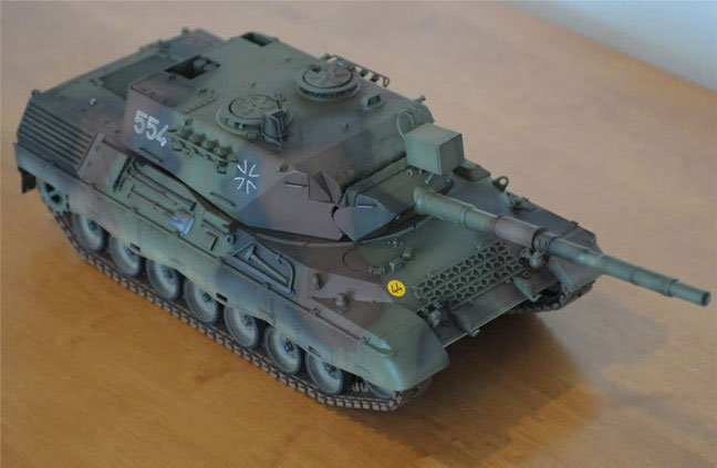

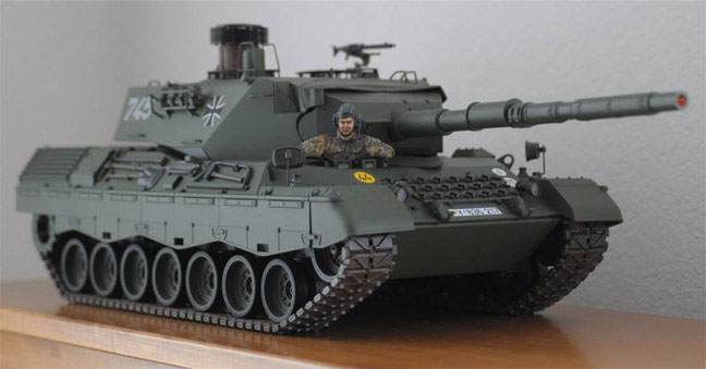

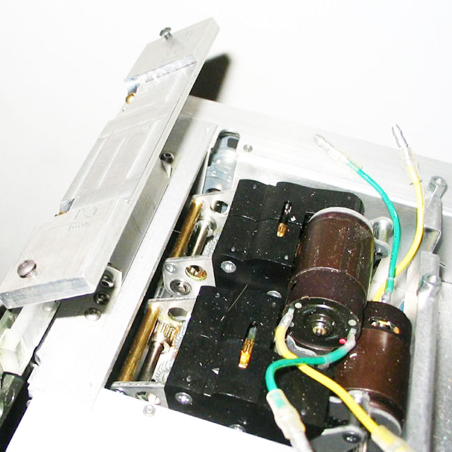

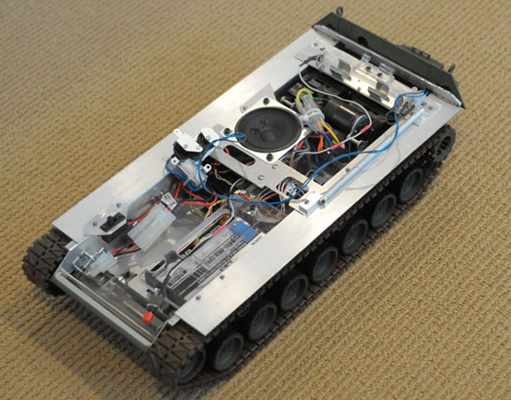

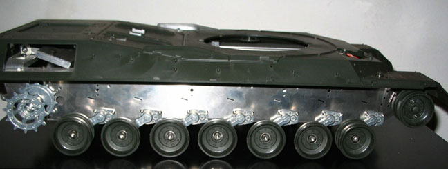

My two Leo 1s, Leo 2 and Gepard build photos are posted here:
1. https://www.rctankwarfare.co.uk/foru...hp?f=21&t=6916
2. http://www.rctankregiment.com/rctank...hp?f=30&t=2247
The threads are older, have a lot of views
and mark the beginning of my shift away from WWII tank builds to modern armor.
The models were all commissioned collaboration efforts for the metal, "one off design" and fabricated parts, between friend Daryl Turner and me
Another Leo 1 is on the bench, hence my interest in what you are up too.
Enjoy, John

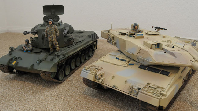

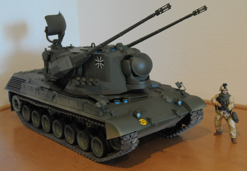

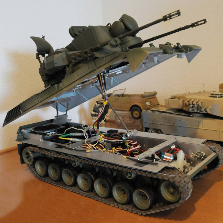

Want to hear a sad DT Tamiya Gepard Flakpanzer build story? First, DT's flakpanzer build solutions are fantastic.
About 3 months after finishing and setting up my DT custom one off Gepard Flakpanzer, I showed it to a local rc tank guy. He wanted to buy it then and there, just name the price he said.
I said NO. Six months later he asked again, still NO. Months later, he called and I gave him a price, a big go away number. The collector came back a week later with cash and my wife spent the money.
Sad story, told you.
Merry Christmas, John
