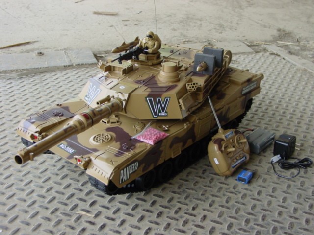

Which M1 did you get?
The first tank that I ordered was delivered to the ether, apparently. FedEx seems to have no idea exactly where it went. [:@]
Since I am not a patient man, I ordered another tank (my Tiger 1), but I could not wait for it to arrive. So, I started talking to guys in the market place about trades for some of my other RC stuff. To make a long story short (too late!), I traded my E-Maxx for a used Tamiya Sherman that is not battle ready (but I want it anyway
) and I traded a park flier for an M1 A1 Abrams that I know nothing about. What can I say, it was late at night and I wanted a tank!!! Both of the guys seem to be older, very trustworthy people and the tanks are now in transit. Soon, I will have four!!!........and ironically, at the start of this fiasco, all I wanted to do was to join in on some electric tank battles, which none of these tanks are even equipped to do!!! [8D] Now, I have to buy the new Tamiya kit. My wife's gonna kill me. [&o]Since I made those two trade-deals, I also bid on a smoke and sound Snow Leopard on Ebay.
I think this is like the M1 that I got, only mine IS an M1. I know that it is not hobby-grade, but what the hay.....the plane was just hanging from my garage ceiling, anyway. [sm=tired.gif]

Okay Ive updated the whole tank story on the yahoo group but Ill give a quick update here
The problem was just the crystal inside the tank, once replaced everything worked great!
Now onto customizing and painting this baby

I finally received my Pershing from Raidentech. Everything is great except te gun doesn't shoot. I emailed Raiden, but they are unresponsive. I might just replace the gun on my own. Does anyone out there know where to get a replacement airsoft gun?
Here is an Ebay link for the gun firing mechanism, but it is in German:
http://search.ebay.de/_W0QQfrppZ50QQ...QQsassZasiatam
What does your gun do, nothing? Any sound or dry-firing? Mine had some of the yellow BBs stuck in the barrel and the gun would not shoot until I ram-rodded it with the end of a broken fishing pole.

I just got the Hen Long pershing no smoke. It drives ok, but doesn't shoot good at all. It jams easy, and gets double shots only going two feet or so. But the most disturbing info I just found out is, that the radio suppied with the tank is on 40 mhz, which is an illegal rc freq. here in the US. I have sent a message to Raiden Tech.
Anyone getting a Hen Long tank should check their Freq. I understand fines can be quite steep for running on an illegal Freq.
