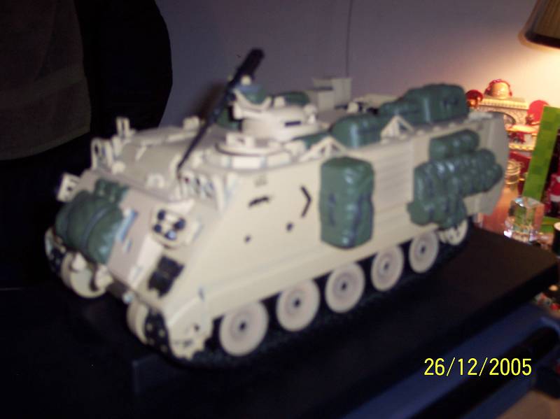

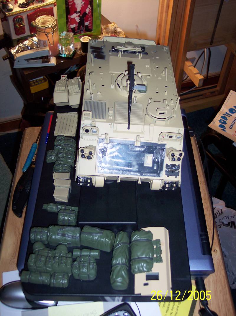

Hi,
I'm Fairly new to this forum and just started to get into tank R/Cs.
My wife had bought me a M113A2 and have decied to modify it. I would like to know where I can buy parts to modify it. It does not have to be actual parts for it but parts that I can easily modify to work on the 113. I plan on turning the 113 into a M1059 Smoke track Generator.
One of the things I would like to get is a smoke generator like they use on the smoking tanks that I have seen. Where can I purchase one of these? My main concern is that it won't generate as much smoke as I would like, it doesn't have to produce as much as the real thing but more than just a puff of smoke, and if that's the case is there any way that I can build my own?
The other thing I want to change it the antenna. The ones I want to change to are the ones that are on the Mauri & Hen Long 1/24 M1A2 Tanks. They are just about the right scale for a real 113 and can be tied down to give a realistic look I can probably get replacements from the manufacture.

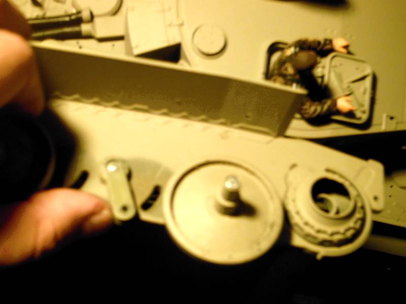

The Hardiest thing to modify would be to add suspension to the road wheels. I've read some post about these and it seems like there is a lot of calculations I have to do to figure out the set up and movement and mounting of the suspension. Is there readily available suspensions? I'm assuming that I will have to go with a customized suspension. I have already started modifing the 113 by removing the some the accesory's that was glued to the top and sides of the 113, moved the atenna from the rear to the front by the drivers hatch and unglued all the hatches so they can open and drilled holes in parts that was supposed to have holes.
If you have any info that can help or links it would be greatly appriciated.
Robert

I really wish that I could be more help, but here is a picture of the suspension (spring-loaded pivot arm with groove for wheel axle), the smoke machine, the 113 motors compared to Hen Long, and the plastic tracks of a basic Hen Long Tiger 1:

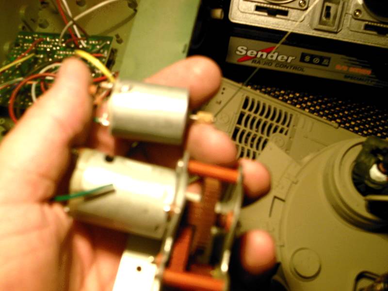

I bought one of these from Wal-Mart. The electronics are basically JUNK- Soooo- Modification time !!
1. The motors and gearbox are ok.
2. Remove everything eccept the motors and gearbox.
3.I only use this at home, so I used some 72mhz aircraft radio equipment.(Shhhhhh !!)
4. Parts
1.GWS 6 channel receiver/ Futaba 6 ch transmitter
2. TWO GWS 5 amp electronic speed controls- one for each track.
3. TWO 7.2vdc 2000 mah Nimh battery packs- on for each track .
4. ONE GWS V-tail mixer for proportinal steering(it mixes the speed controls to work on one stick)
5. TWO micro servos and two micro switches for reversing the battery polarity for reverse.
6. One on/off switch
7. Sepatate battery pack for the receiver- cut the RED wire on the ESc's to disable the BEC.
8. I opened the top rear hatch for access to my on/off switch, and opened the large rear ramp for access to the batterise for
charging.
It works perfectly. It will move so slowly you can barely perceive motion, but will really hauls a-- under full throttle!!
Steering is via the v-tail mixer and works great- I tried using two separate throttles but it was impossible to control, so the
mixer works great. With the big batterise it really has has power. It will climb a 60 degree incline with no problem. Now, if I could
only get rid of the motor/gearbox sound !!!
This set up will work for any vehicle, but be careful of the size (amperage)of electronic speed controls. Actually, a better solution is
using rc car speed controls with built in reverse, thus eliminating the micro swtiches- but it was what I had on hand.
I also removed the battery box (it un-screws) to give me LOTS of space.

ELGEE-- Can you post some photos of your setup? I plan to convert a larger tank to operate the same way using larger motors but all I have in the higher amp rating esc's are forward only. Like to see video of your 113 too. sounds like you've done a great job of converting it.
Mike
Mike
charging.
Ok-
4. Parts
charging.
