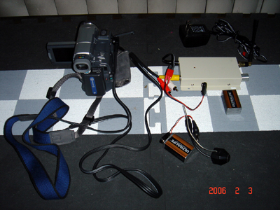

ORIGINAL: tomzag
how can you dirve by camcorder?
The equipment I used is in the attached photo. There is also a short video I named "On Board Enzo Cam" in the following folder with a few of my other videos. That video was taken in one of the LHS. As mentioned earlier, I found it much easier to drive via the camcorder when using the wide angle lens and have a slight view of the front of the RC. I kept running into things when I couldn't see the front end of the RC with the standard lens--the depth perception was really bad running on plain ozite.

Tigger,
are you saying, you still use mini-wireless camer. but instead of hooking the reciever to TV, you hook the reciever to camcorder. you watch the camcorcer to drive the rc, you can record at same time?
or you mount the camcorder onto the rc?
Old 02-04-2006 | 12:24 AM
Tigger N. Bennie's Avatar
Joined: Sep 2003
Posts: 8,396
From: Track
Default RE: security leopard
I watch the camcorder, drive via the screen, and record all at the same time (or at least try to). The only thing that gets mounted on the RC is the wireless camera lens. If you notice, I also spliced a Deans Connection into the wall plug for the camera receiver which also allows the use of a 9v battery instead of the wall plug--more mobile as well.

it make sense now. for the reciever, you can use 8 Sub-c batteries to make 9.6 battery pack. it will last longer. for your sony camcorder, you can use 7.2v battery pack, just make adaptor, I use this setup when i use sony camcorder for reporter turret. I tried those setup before, so it is safe. and it will last much longer.
The Sony camera has it's own 7.2v lithium battery packs. As a matter of fact, I just finished charging one battery pack. Over all, the 9v work fine since I've never really considered taking that long of videos. I used to but I just spent too much time editing and I no longer host any videos on my own website anyway. Thanks for the suggestion anyway.
