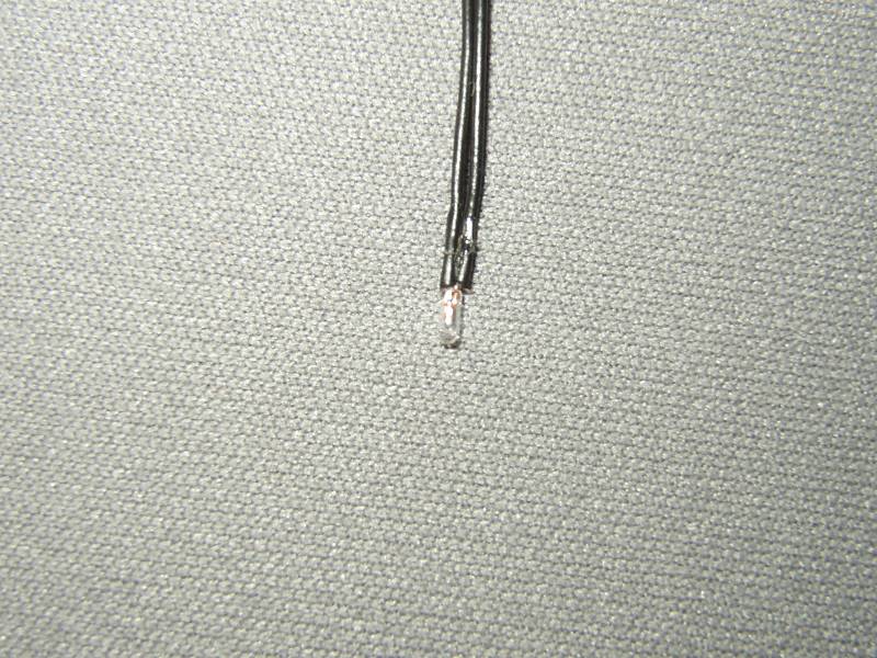

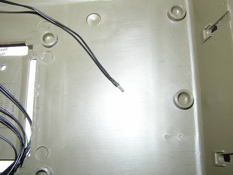

I am building a Tamiya sherman (56014 FO) and while installing the light unit, one of the tiny bulbs broke. I talked with Tamiya and they onlly have the entire light unit as a harness for someting in the neighborhood of $40.00, they said just replcae it with one from an electronics store. Great idea, but they didn't know what voltage, plus these lights are ridiculously tiny. I thought they were LED's, but it looks like they have a filament, plus they are made out of glass. If anybody knows where i can get these lights, or has one they want to get rid of, I'll pay. Any help would be great.

Glad to know I'm not the only one who busted a bulb. But I did buy a spare harness, unfortunately it was for a Pershing and the two are NOT compatible. I'm not even sure the bulbs are the same voltage. I want to test my Sherman to get the output voltage to the lighting array, as all the bulbs are in series, and going from the supply voltage of the MF unit you can make a safe guess at the bulb voltage. The bulbs on the Pershing array are wired oddly, the front two in series, and those in parallel with the rear one, so I doubt they are the same voltage, even if they are the same size.
You CAN short the broken bulb leads, and the remaining four are quite a bit brighter, but I didn't run mine for long because I did not want to blow any for over-voltage.

Wolf, I can' find any smaller LED's than the 3mm either. But I keep seeing those mini bulbs I mentioned earlier, just found some online that are rated at 1.5V I am just afraid to screw up the electronics in the tank if I use the wrong type of bulb/voltage.

If you can wait a day, I'll gather my sherman gear up (its a tad scattered from turret renovations) and I'll put a meter on the output when the lighting array is powered. That will tell us the total voltage to the series, and as there are 5 bulbs, how much each bulb gets.
If I had to make a snap-judgement, and it was my own array, I'd say the 1.5 grain-of-wheat units should be fine, as the stock pack is rated 7.2 volts, and that divided by 5 bulbs is 1.44 volts. I've had mine on briefly with only 4 bulbs in the series, so I'd guess the supply to the array is less than the max pack supply. I'll also try hooking in one of the bulbs that I surplus'd from the Pershing light array, and see how that performs (as I have 3 bulbs harvested there)

the bulb you need is called wheet bulb for HO trains. it is 1.5V 30mA 1.2mm dia, the brand I use is Miniatronics. Model 18-C03-10.

I found some of those exact lights at my LHS (Hobbytown USA), they were $10 for a 10 pack. Hooked one up yesterday and will test it out soon. Thanks for the info. Also thanks to CapnCrunch for the link direct to the Minatronics sight. You can get the same lights from them. I'll let everyone know if the bulb works, cause it apears to be a perfect match.
